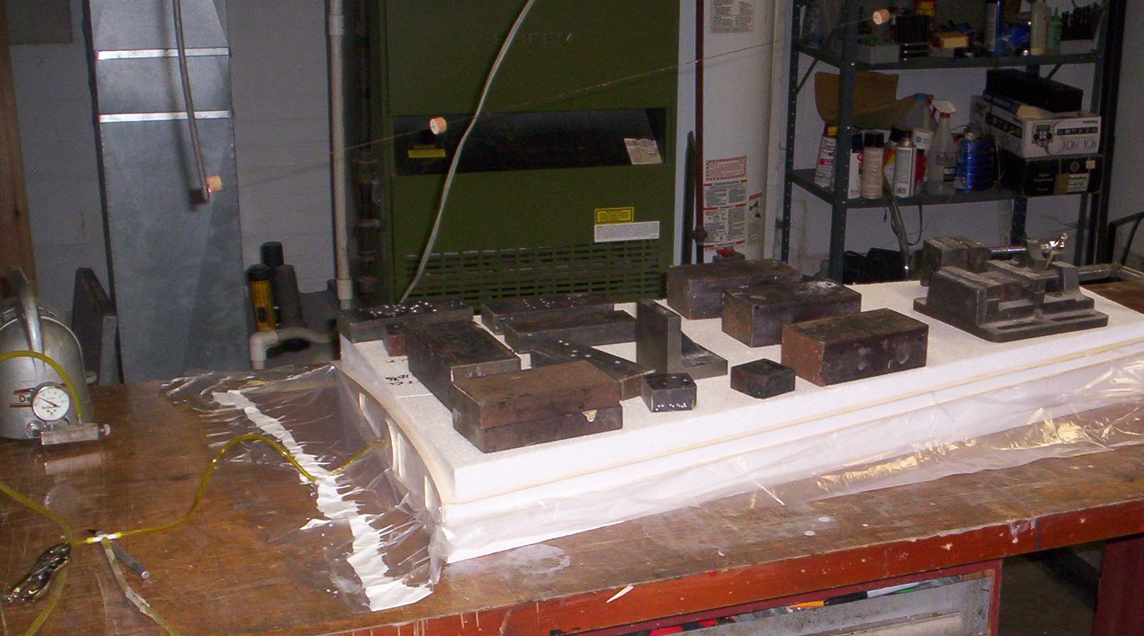

Stop carrying 60 lbs stones around. Fill many and mean many large ziplock bags with play sand it’s easy and cheap. Your back will than you.

The system I use is very simple, vacuum pump with bleeder valve and gauge, fuel tubing, 2 mil drop cloth and cheap caulk make the bag. Pump runs continuously while glue is curing set at 5" hg. Pump was bought at flee market 35 years ago, $15. The largest wing was bagged was 8'. Haven't done much foam work lately however

Yes Snoop, that would be a much better idea for me. Actually has me thinking (something I don't do much of :().

In talking to him about putting weight on my parts he told me that he has bags of pea gravel he was willing to bring down for me. I am going to get him to bring some and do as Snoop has said. My back can not take much more of this!! :msn_slap:
Yes if I was doing more of these that would be the way to go!

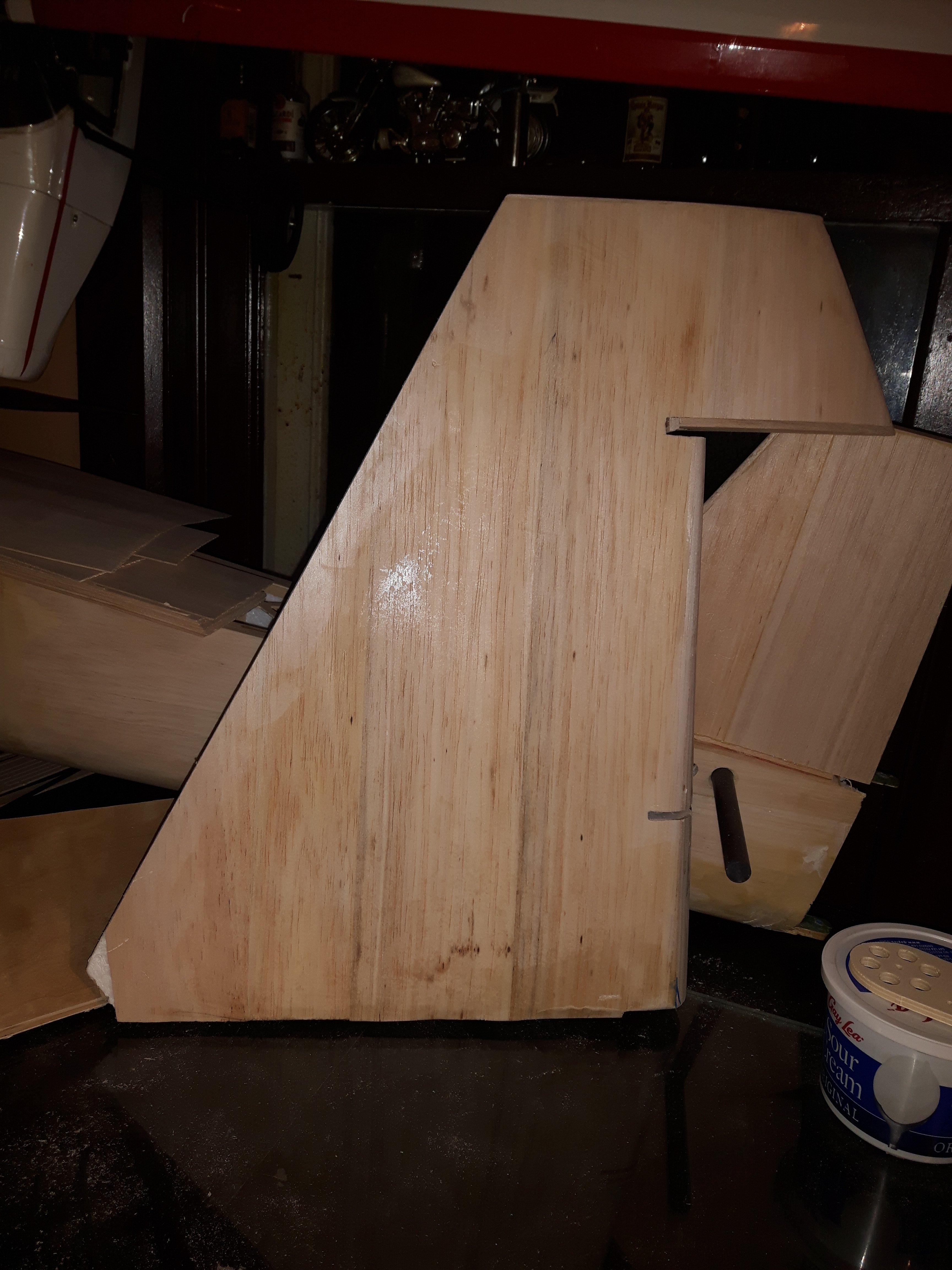

What I did wrong was to sand a slight taper on the bottom of the rudder not thinking of when it goes into the blank/chuck or whatever you want to call it does not match, dumb. I also had to much epoxy on the one skin so I just wiped it onto to the other skin, again, dumb because I forgot the other skin had to be flipped! So I quickly wiped off as much as I could, covered it with wax paper and put the epoxy on the right side. Just gave myself more sanding work. This first piece taught me!
