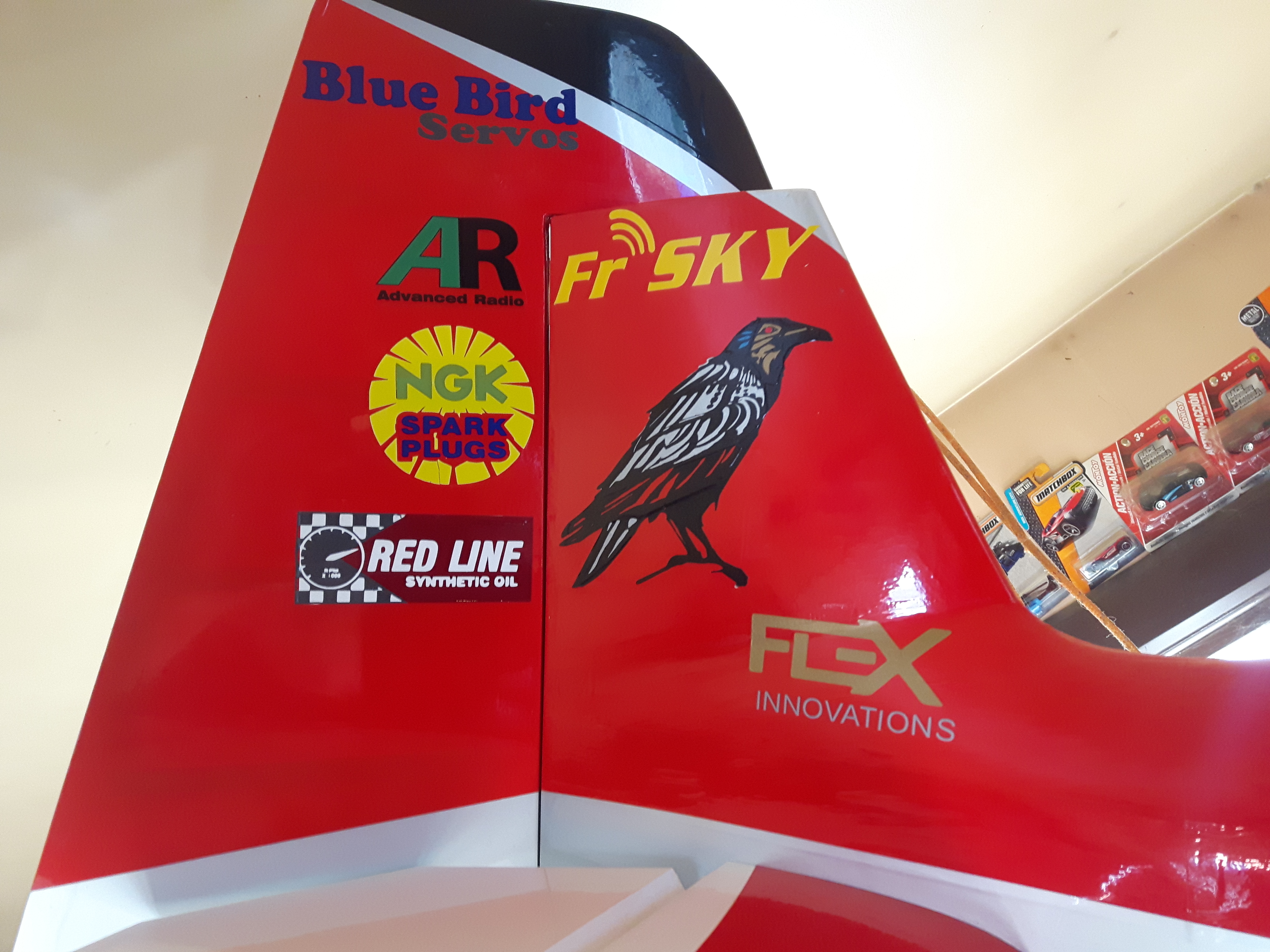

  5. Vinyl is far heavier than anything we cover our planes with. I have heard of some people adding a pound to their planes if they get really carried away.
    These on the tail on my raven were all cut out with the silhouette.
    All were cut out on the silhouette using the scrap vinyl from my friend. Like 3D printing, it almost turns into a hobby on its own! Plus my wife has found uses for it as well !

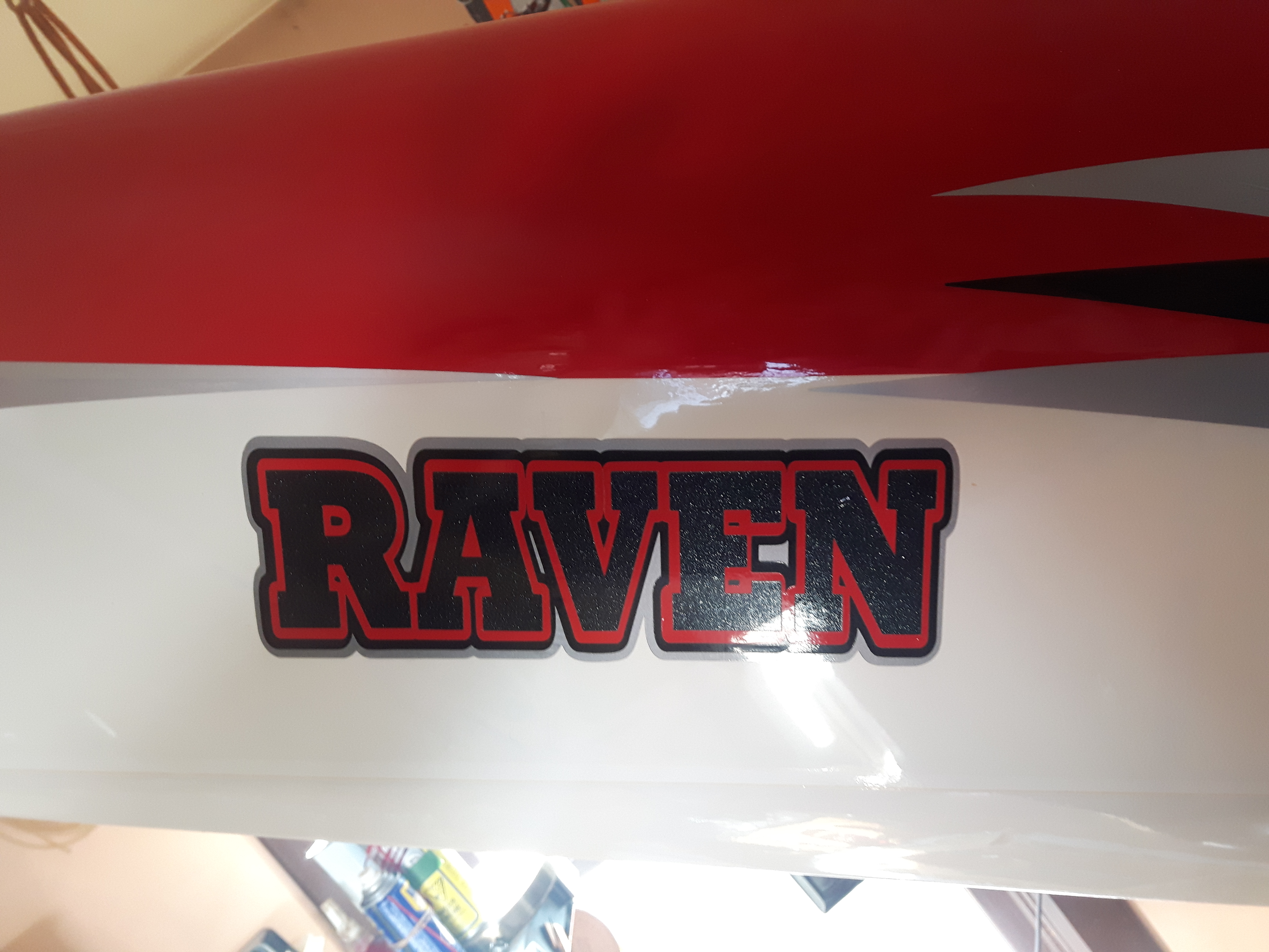

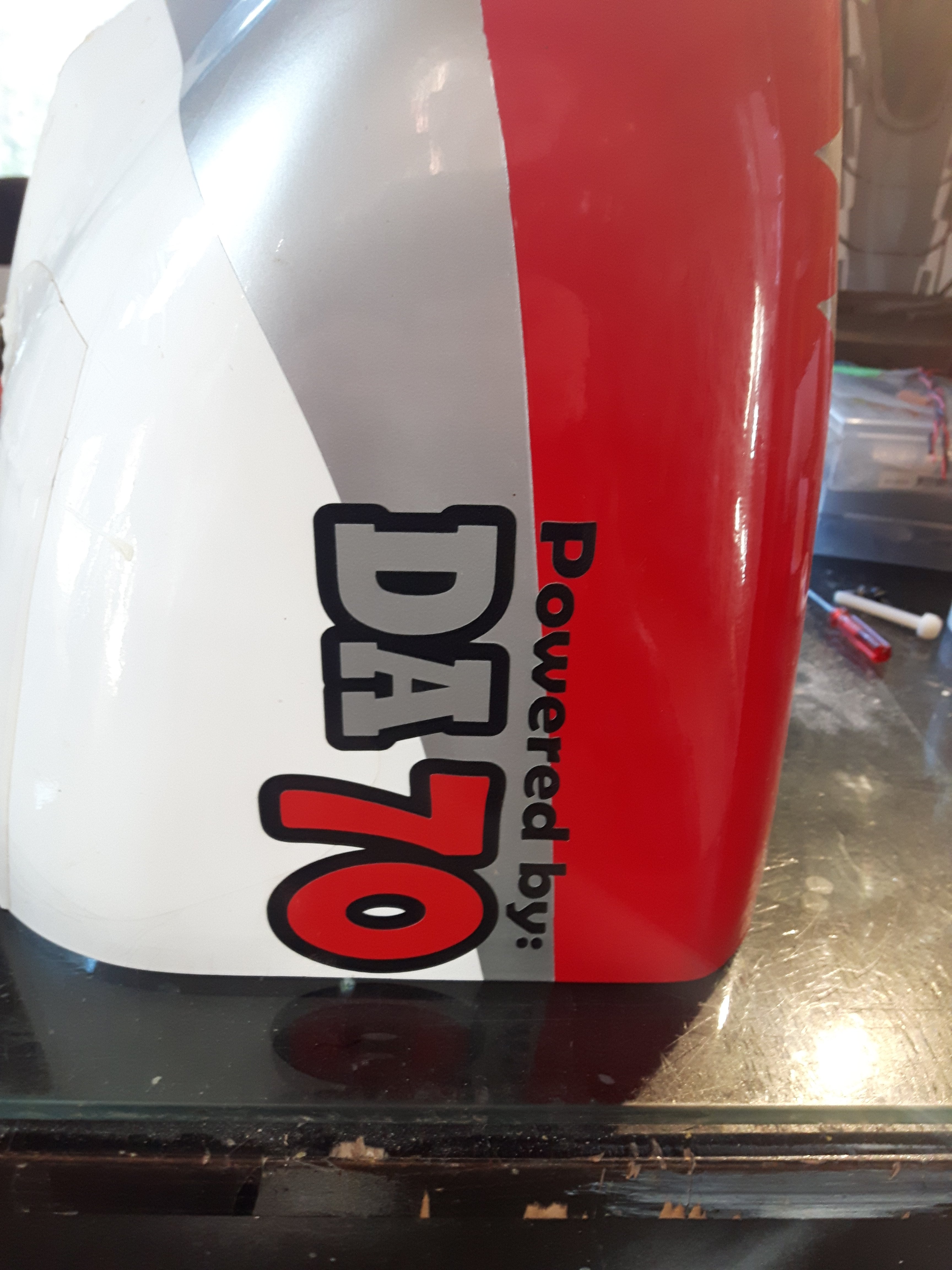

  7. Yes, multiple colours on some. The Raven logo has three separate colours.
    I haven't played much with this yet but if you get a very high resolution from the internet, lets say a watch, you can put it in the silhouette program and add register marks to in when you print it out on your ink jet printer. The silhouette program does work with your printer so you can resize, move it or delete parts of the image. After you print it out on a good peel and stick paper and give it coats of clear you can put it back in the silhouette. It will read the register marks and cut just the image. It is a fun machine!
