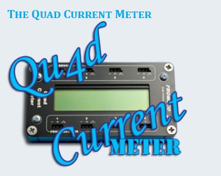

For a few more $$ you can get the Fromeco Amp Meter that can set 4 servos simultaneously: http://www.fromeco.org/Products/05FRCQCM/View attachment 48796

If you have the Smartfly with the programmable servo outputs, you will be able to program the servo centers and end points.
The Fromeco Amp Meter is a measuring device, not a programming device. It tells you how hard each servo is working at any given point. The process involves programming each servo output to minimize the Amp reading on each output. The meter in installed in series between the servos and the receiver (or Smarfly).
