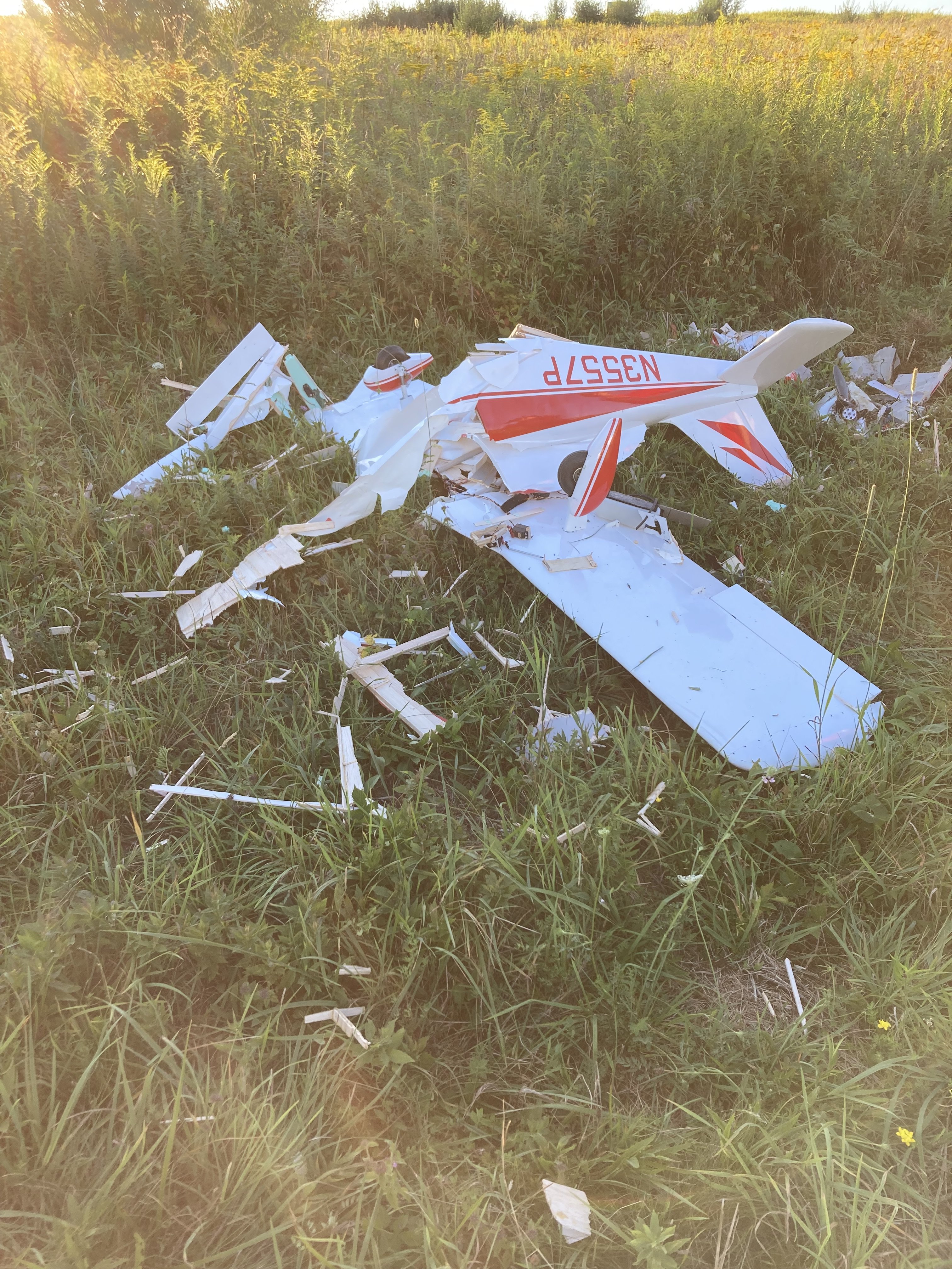

Ordered the wood for the replacement build this morning from National Balsa. I emailed them a while ago and ask if I could purchase the 3/8" laser cut firewall only due to an accident, they sent me one for free, great people to deal with. I still have about 50% of the original laser cut kit since I changed most of the construction from the original design.

Oh man, sorry about the maiden. You have a very positive attitude (and vision for the future)!
