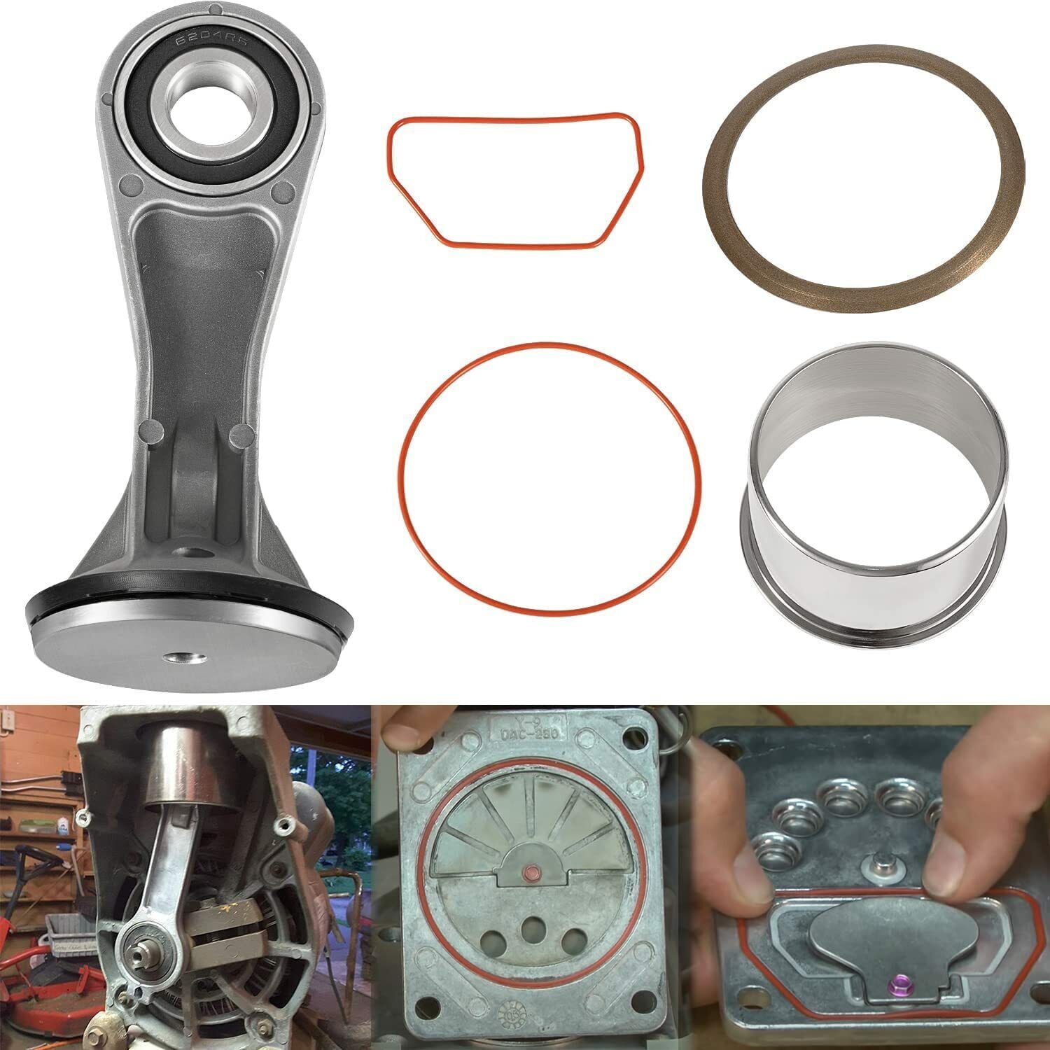

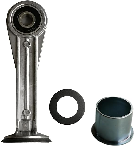

I have 6 molds ready for PVA however my compressor has failed. It is a Craftsman oil less compressor, it was rebuilt in Novermer, put a new sleeve and piston ring in, cleaned up the reeds and plate. Worked good when the fuselage was primed twice in December, last time PVA was sprayed just ran constantly and would not build pressure, I assumed the reed valve plate was bad so I ordered one. Nope, the piston ring failed. Have replacement coming today.

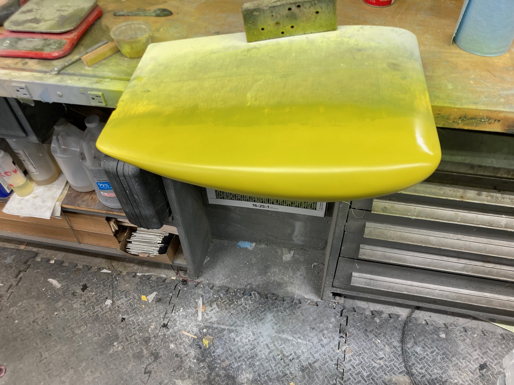

Have the color on the right wing tip, had trouble with the darn ratter can paint lifting. Might be ready to mount on the parting by the weekend.

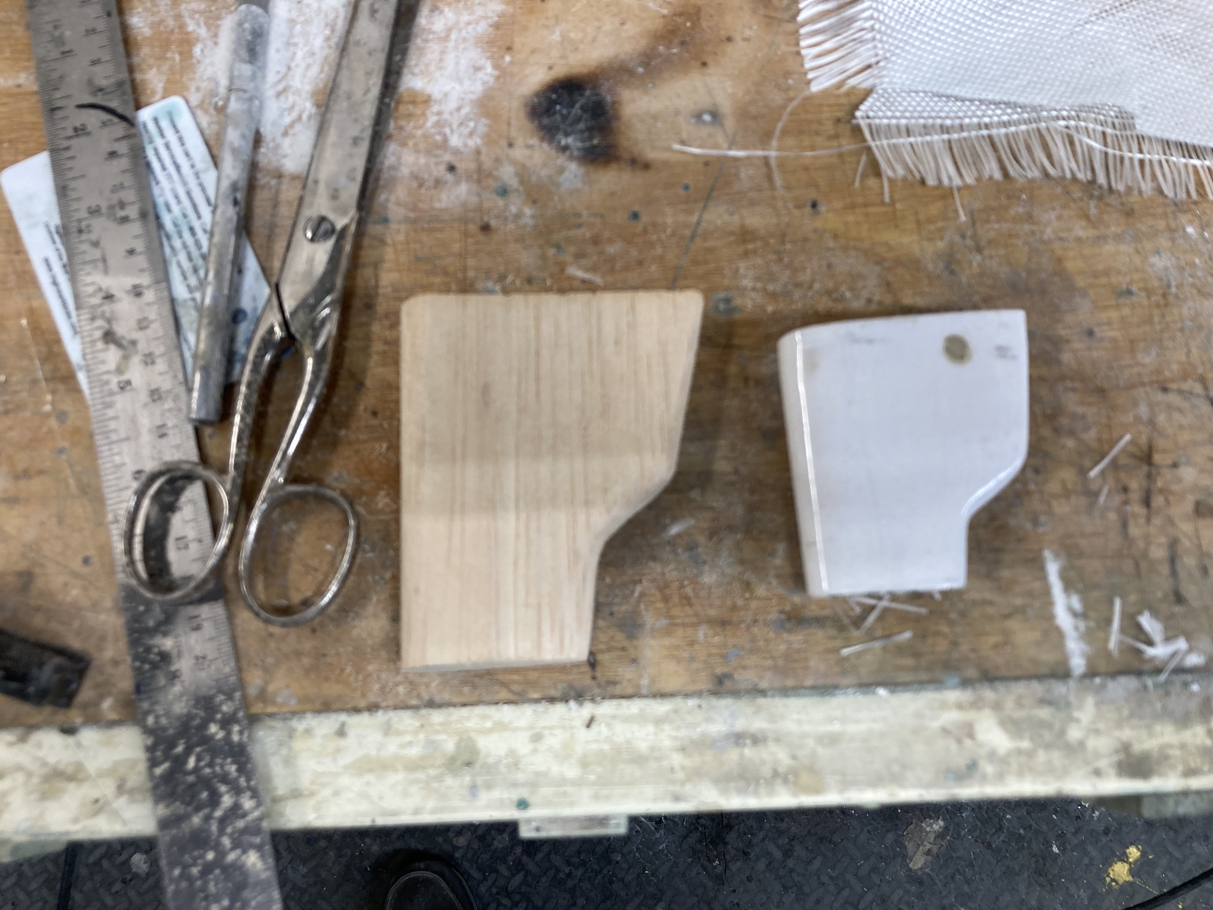

Working on the nose wheel pant as well, might be ready for paint by the weekend. Plan to use KELVAR while laying up the pant, thinking this is what wheel pants should be made of for us grass flyers. Carbon and glass is stronger but not as tough as KELVAR. Pretty sure every wheel pant I have or had developed cracks in the corners or near the mount area. Thinking 2 ounce glass, 8 ounce KELVAR, topped with 4 ounce glass. If all goes well will make a mold for the main pants and lay that with KELVAR.

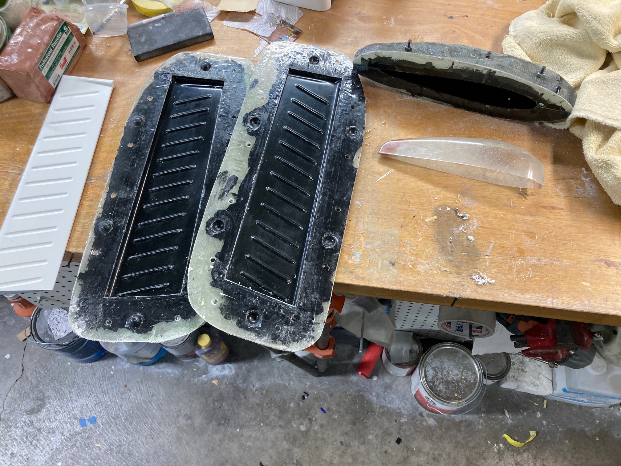

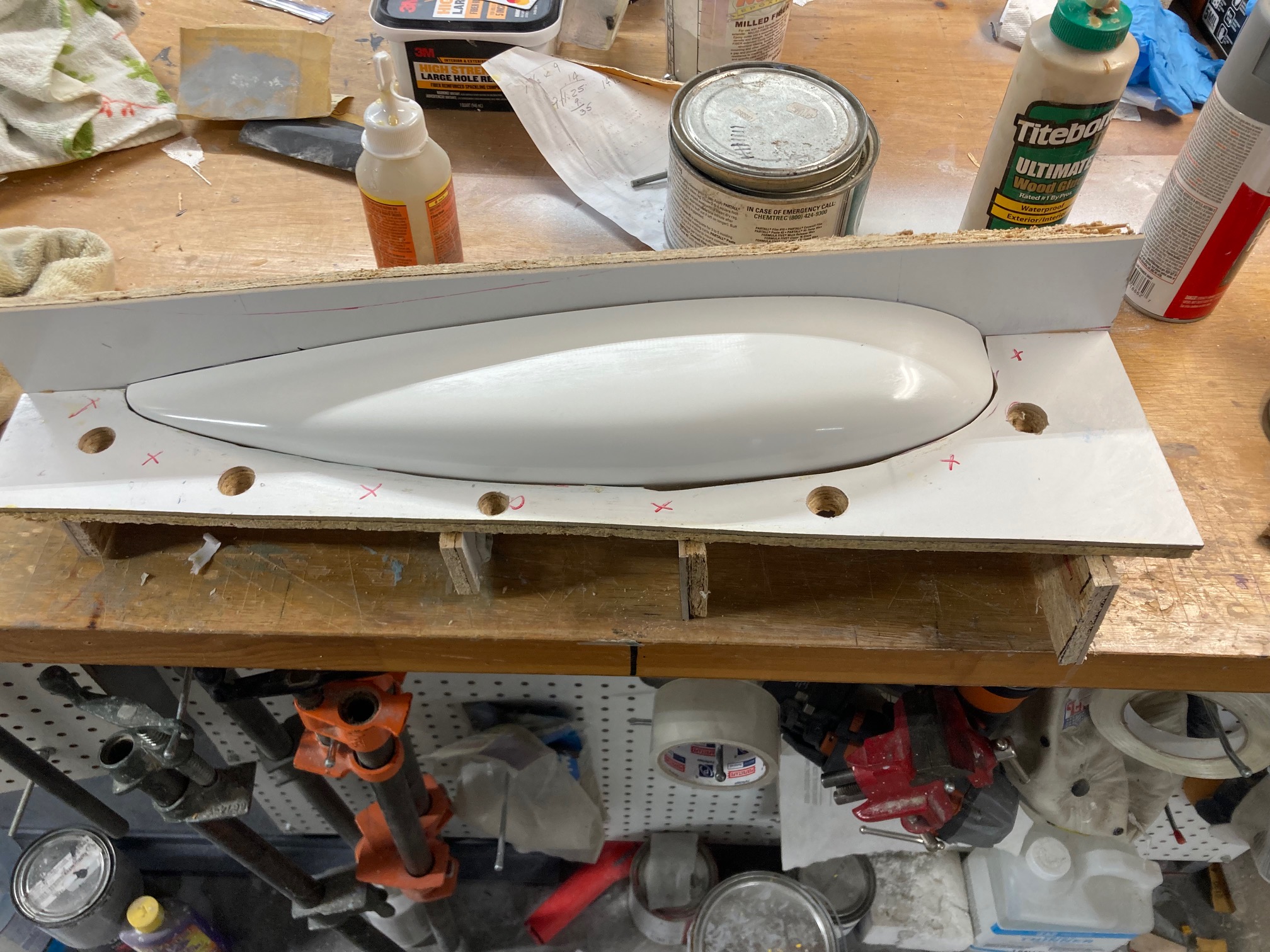

In the first photo, the mold for the main gear fairing is from the previous build. The shape and details were
copied from the RC guys Cherokee, it's not exactly scale so I'm trying to rework the part and make a new mold.

Quick update on the air compressor. In November I installed the ring as shown in the first photo, it made sense to me that the cup would face the pressure to aide sealing. Yesterday a photo popped up showing the ring installed the opposite direction. I turned over and it seems to pump OK so will keep an eye on it. I hate the noise the compressor makes but do enjoy the oil free air.

Can you explain the use of non-hardening clay verses just using a plaster/epoxy/or hardening molding clay instead? Just about every time I read your posts I continue to learn something new. I love your builds!
TonyHallo

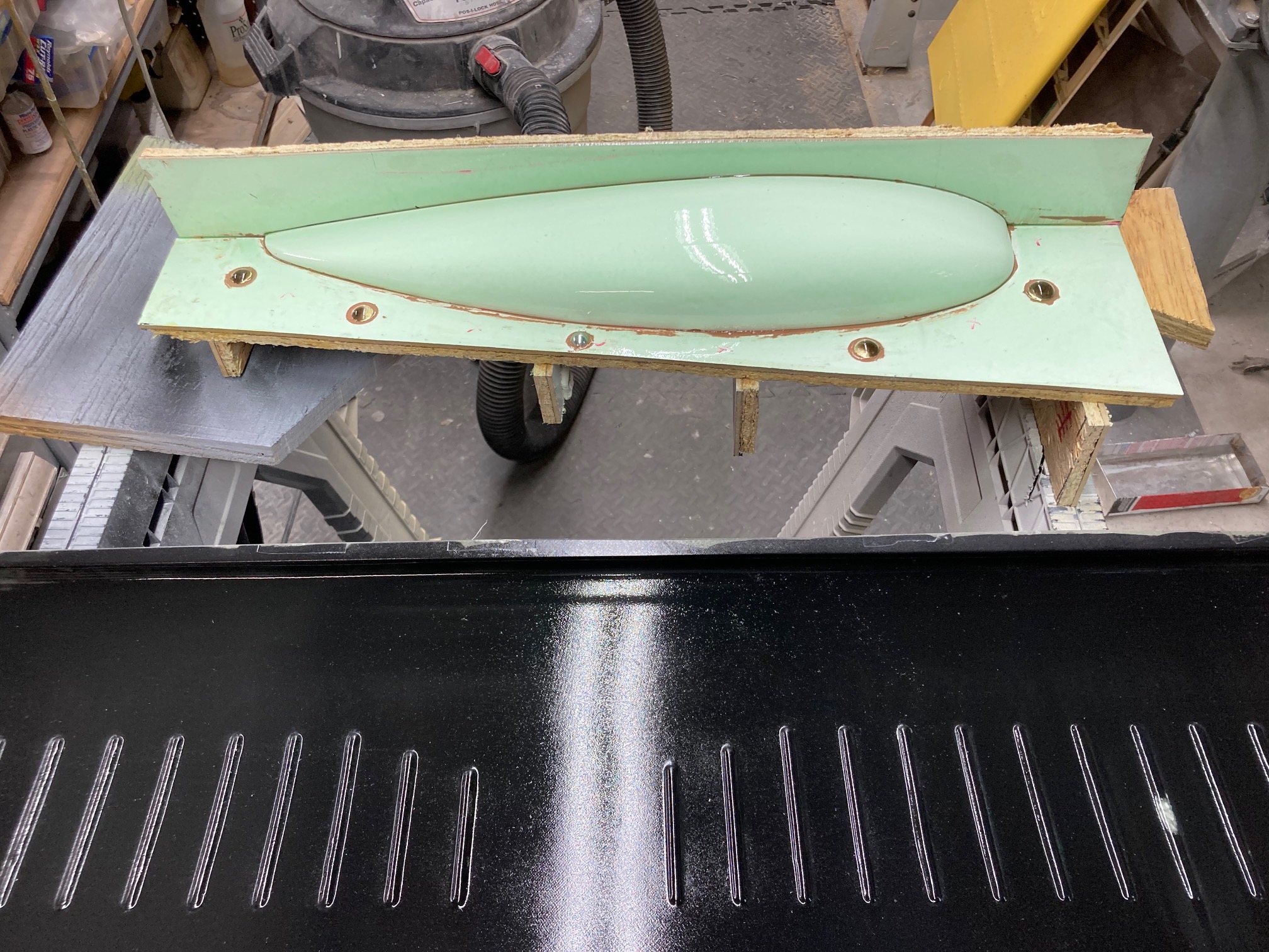

The board with the alignment marbles will be removed after the top half of the mold is complete so the non hardening clay makes removal easier. Whatever you use you must be able to remove it without damaging the plug. When doing the rudder I though hot melt glue would be an excellent way to hold the plug in place, turned out to be a mistake, pulled the paint right off, had to rework it. I have read that some folks use paraffin to seal the gap, dam it up and pour it. I suspect the hot paraffin may cause the same problem when using rattle can paint.
The Chavant clay seems smoother than the Playdough clay so it seems to work with..
It is all waxed, clayed and PVA'ed in the photo ready for tooling coat

Found an old can of Kyron fluorescent yellow paint and decided to use it up. Sprays much better than the current Kyron Fusion paint that I'm using. It does dull as it dries and hoping it shine up with fine wet sanding and polishing.
