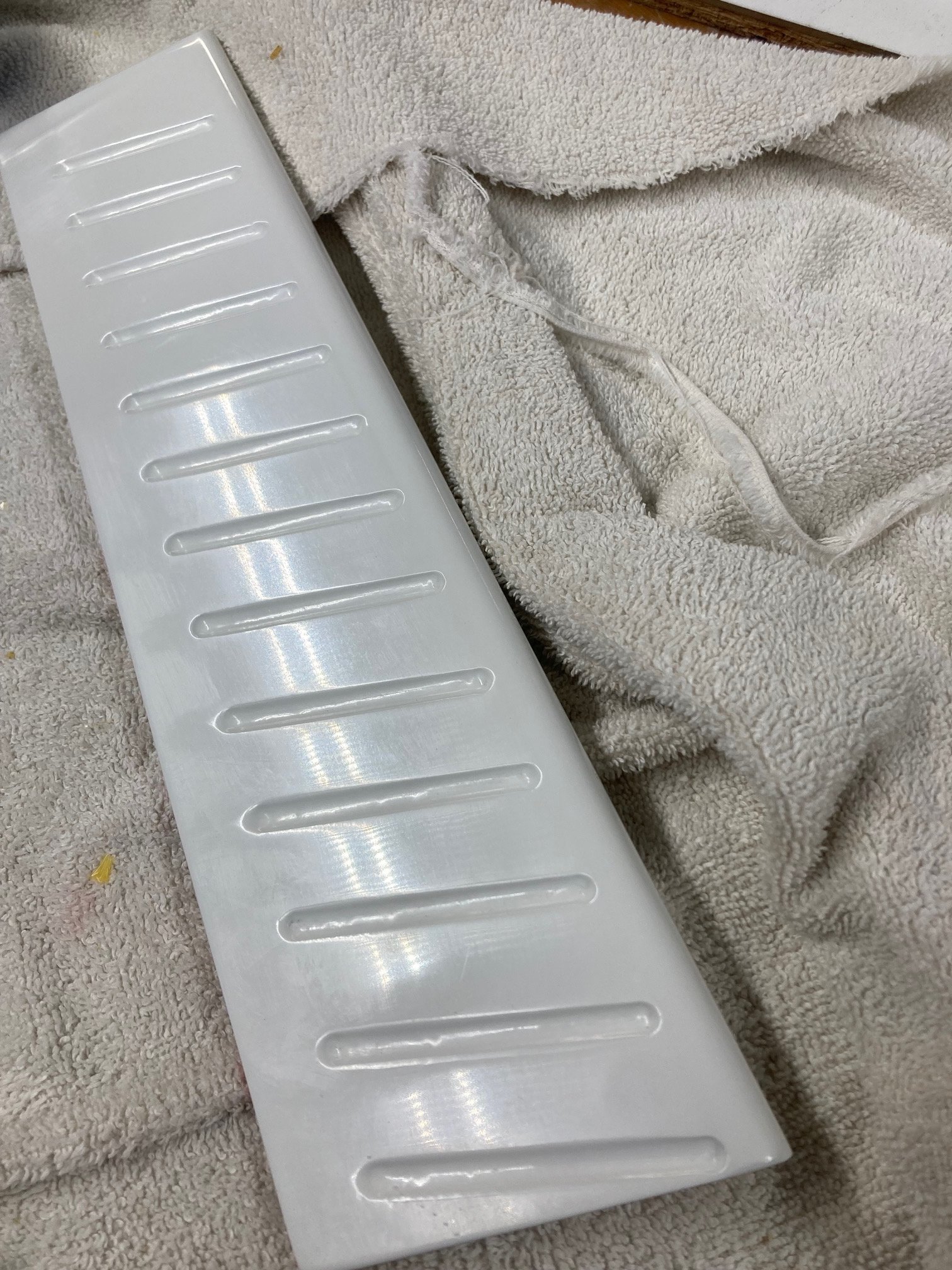

Working on the remainder of the plugs, have the final color coat on the stabalator skin plug. Found the best way to sand the corrugations was using Scotbrite pads. Much faster and better than sandpaper. The stab tip plug is just about ready for color coat and the wing tip plug is glassed and ready to prime. Painting indoors with rattle cans has slowed the progress but hey moving forward.

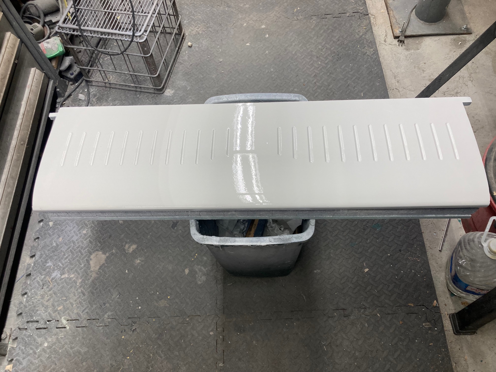

Put the color to the rudder plug this morning. Two down, three to go excluding the yoke. I think the stab tip will be ready to paint this weekend, the wing tips need a lot of work yet. Would like to have the molds completed by end of the month so that I can devote my time to Champ wings and have everything ready for paint by the end of March. Let's see, Cherokee fuselage plug, BUSA Super Cub fuselage and parts, two Champ wings an ailerons, will be a busy April in the makeshift spray booth.

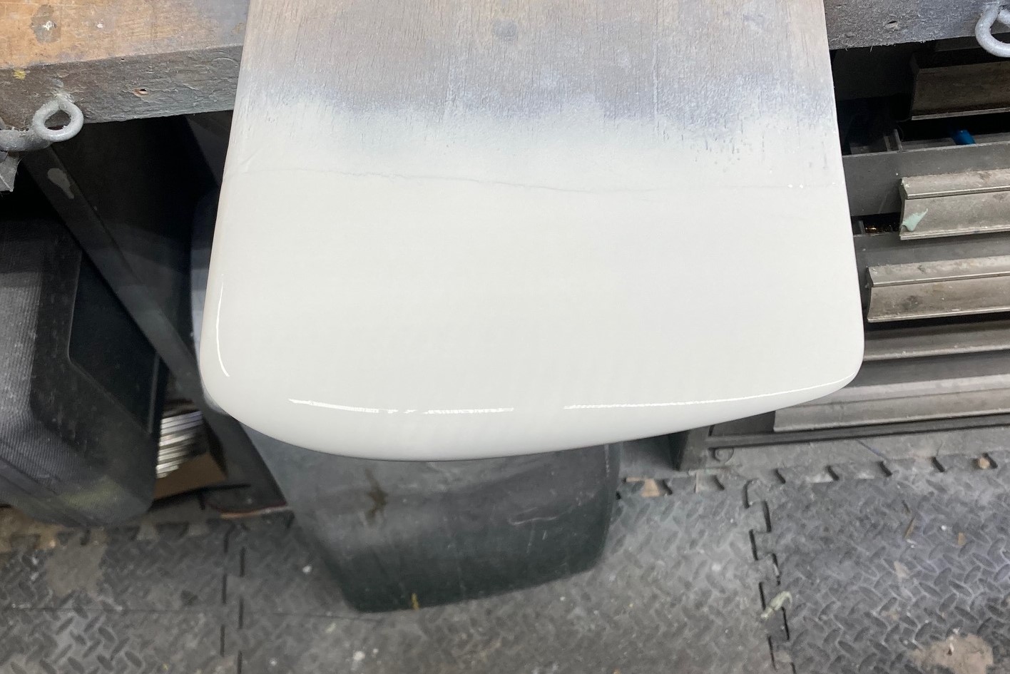

I picked up 2000 and 2500 at the local autobody supply and found 3000 and 5000 grit soft touch pads at Auto Zone. The 3000 and 5000 barely remove any material, no apparent color was on the sanding pad. One final hand buff with McGuiars Diamond Cut and the plug was ready for wax. Put 8 coats of wax on yesterday and will finish the last two this morning then spray the PVA on. The rudder has air dried for two days so that will get sanded and buffed as well. Tomorrow I can sand and buff the stab tip. Started waxing the parting boards, wax on, wax off.

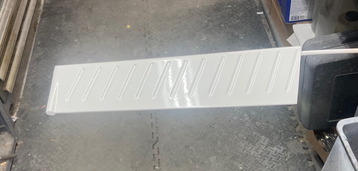

I sanded all the orange peel and defects with 1500, then the rest of the paper goes fast to 5000. In this photo I got in a hurry and put the first coat of wax on before rubbing with Diamond Cut. It has plenty of shine. You can see each LED in the shop light.
