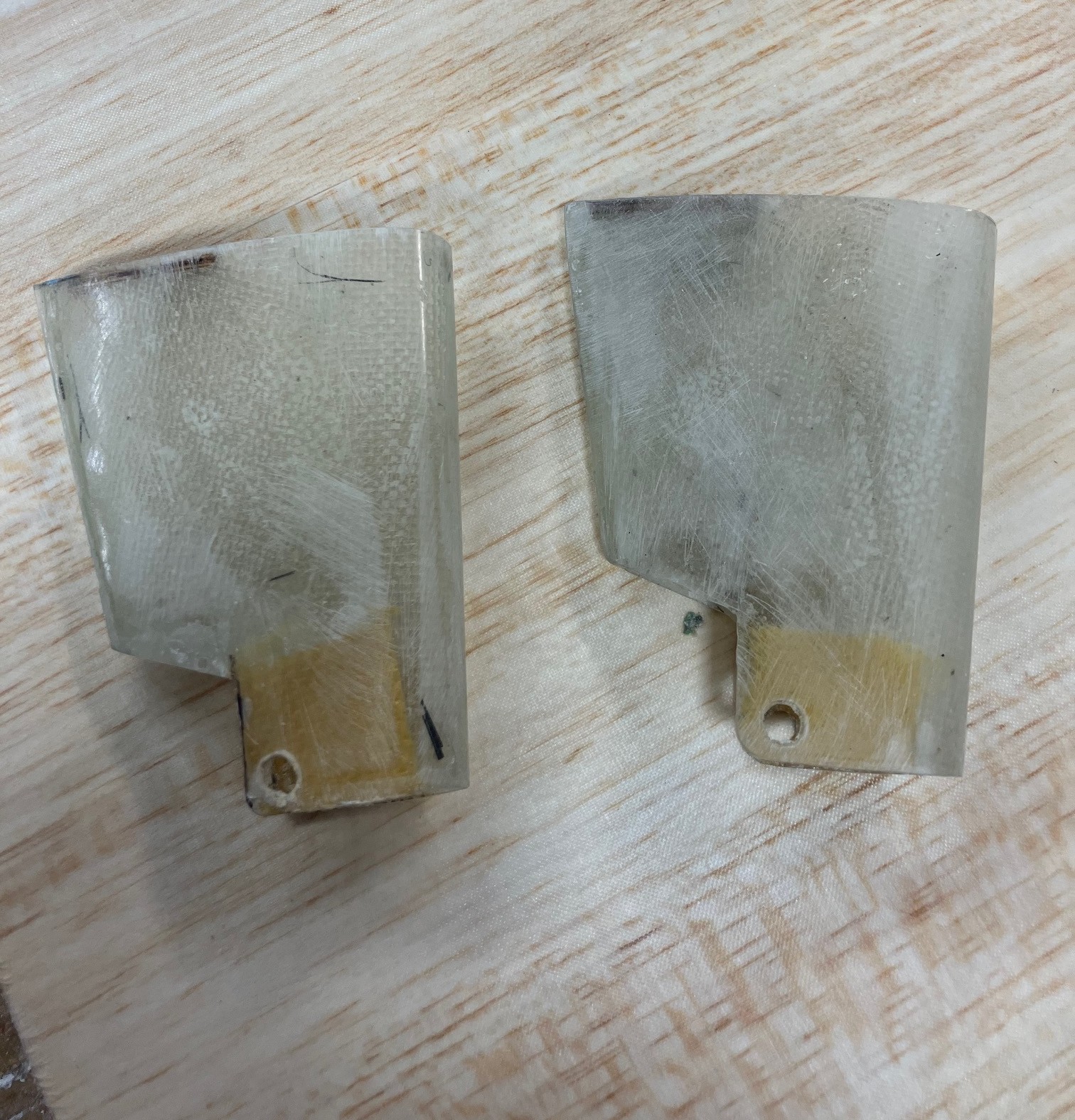

It became obvious in short order that the hole on the backside of the fairing was going to be a problem, matter of fact I broke out the second hole while drilling. A second pair with Kevlar reinforcement was laid up, Kevlar is amazing, can't say here what it reminds me of. It is a pain to work with, yoy drill a hole through it and end up with a hole filled with fuss, try to sand it and make more fuss. Hardening the fuss with CA or epoxy does help.

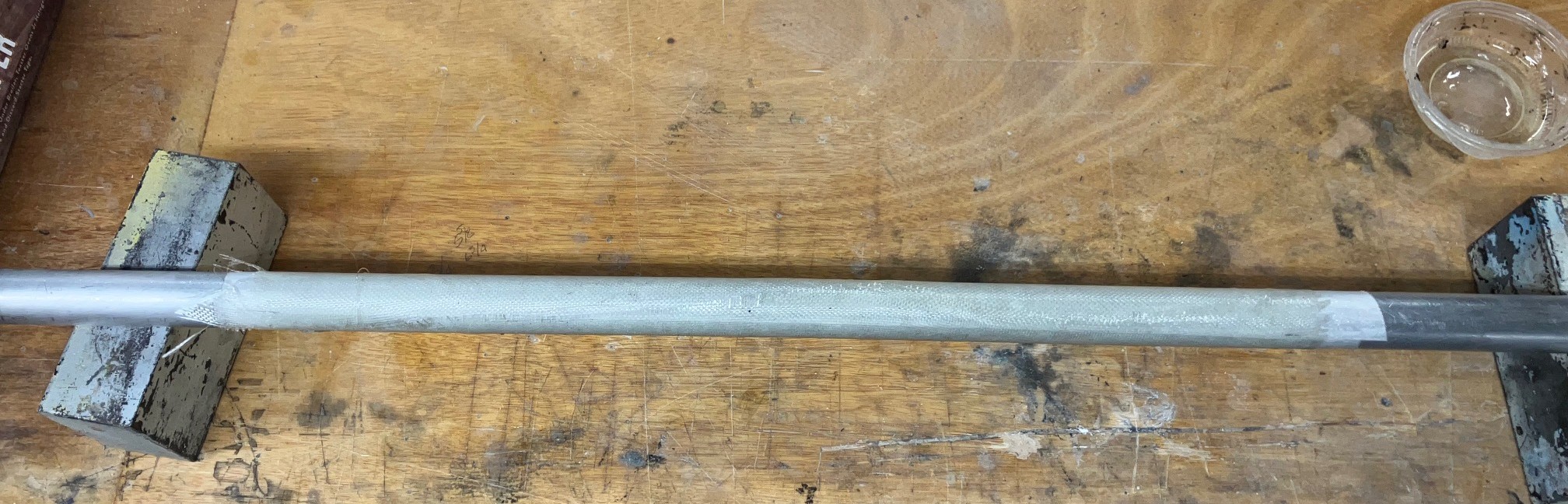

I have been hauling the fuselage around in the back of my van since last month's IFC club meeting. Out of work on the wings so it's back on the bench, laid out the wing tube hole today. I was hoping the new wing tube will be here today but the USPS seems to have taken a liking to it. Left St Louis on the 14th and still traveling to next destination! Need to mount the wings before moving forward.

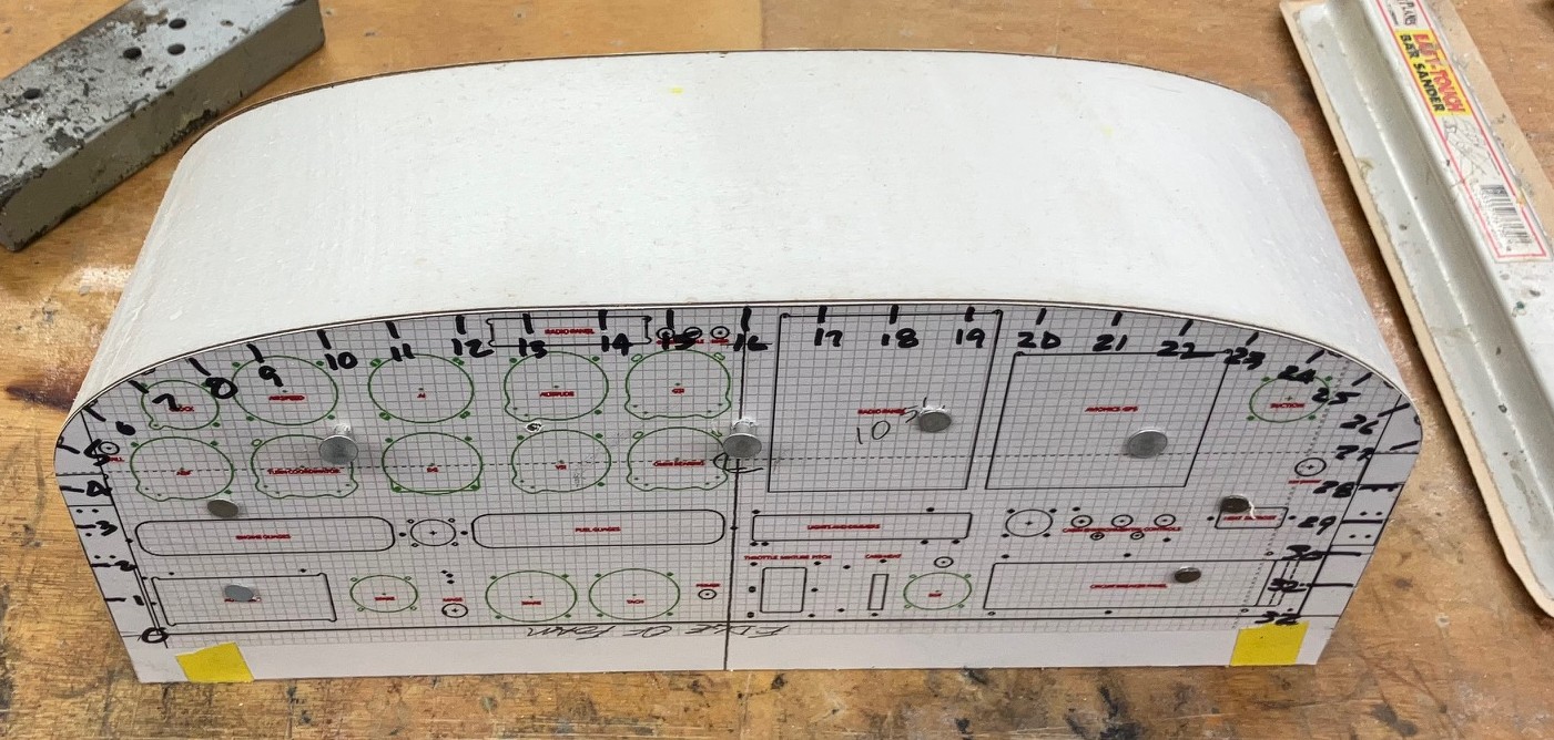

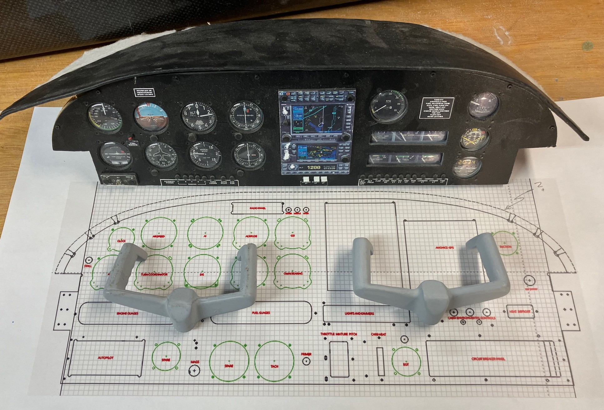

Started thinking about the dash. Found a nice outline drawing online of the dash and had Staples increase the size to the proper scale. The dash salvaged from the original Cherokee isn't deep enough to accommodate the yokes so it looks a new dash is needed. Thinking I will cut the dash panel shape from left over foam, cover 1/16" balsa with Naugahyde rolled over the overhang above the dash before vacuum bagging the balsa in place. I forgot how nice the original dash finish off. It's a work in progress.

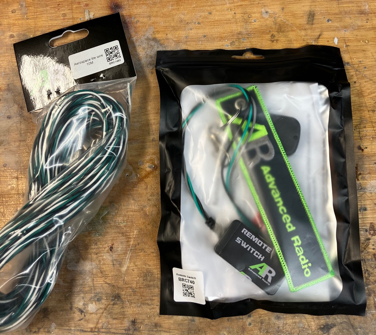

The remote switch and 10 meters of servo wire arrived yesterday. Let's see, a new color combination to figure out, Futaba red, black, white. JR, red, brown, yellow. Hitec, red, black, yellow. Power Box, red, blue, white. And now AR, could use Black hot, white neutral (Ground) green signal? No that doesn't make sense, black negative, white signal, that leaves green positive. Not good either. Any thoughts?

Green Positive, Black Negative and White Signal is the way I'd go. It's basically the Futaba pattern except substituting the red for green. IMO, that's the only pattern that makes any kind of sense at all.

Black - negative
Green - positive
White - neutral
The item description shows green/black power, if you look at the premade wire, the green is in the middle position (positive)

I've used Power Box before, it was the .5mm2 for the power and ,35mm2 for the signal. The insulation is thinner and even though the .5mm2 wire is about 20 gauge it crimped and slide into the housing easily I don't think Power Box offers that wire any longer, only 3 x.35mm@, I could be wrong but I couldn't find it. Advanced Radio however offers both. I just bought the 3x.35 since there are no crazy servos in use.

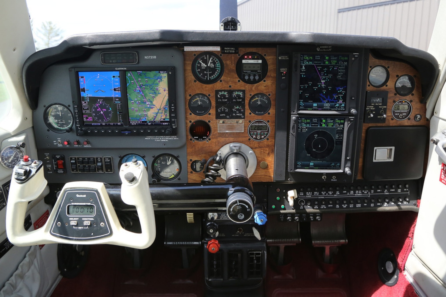

WMcNabb

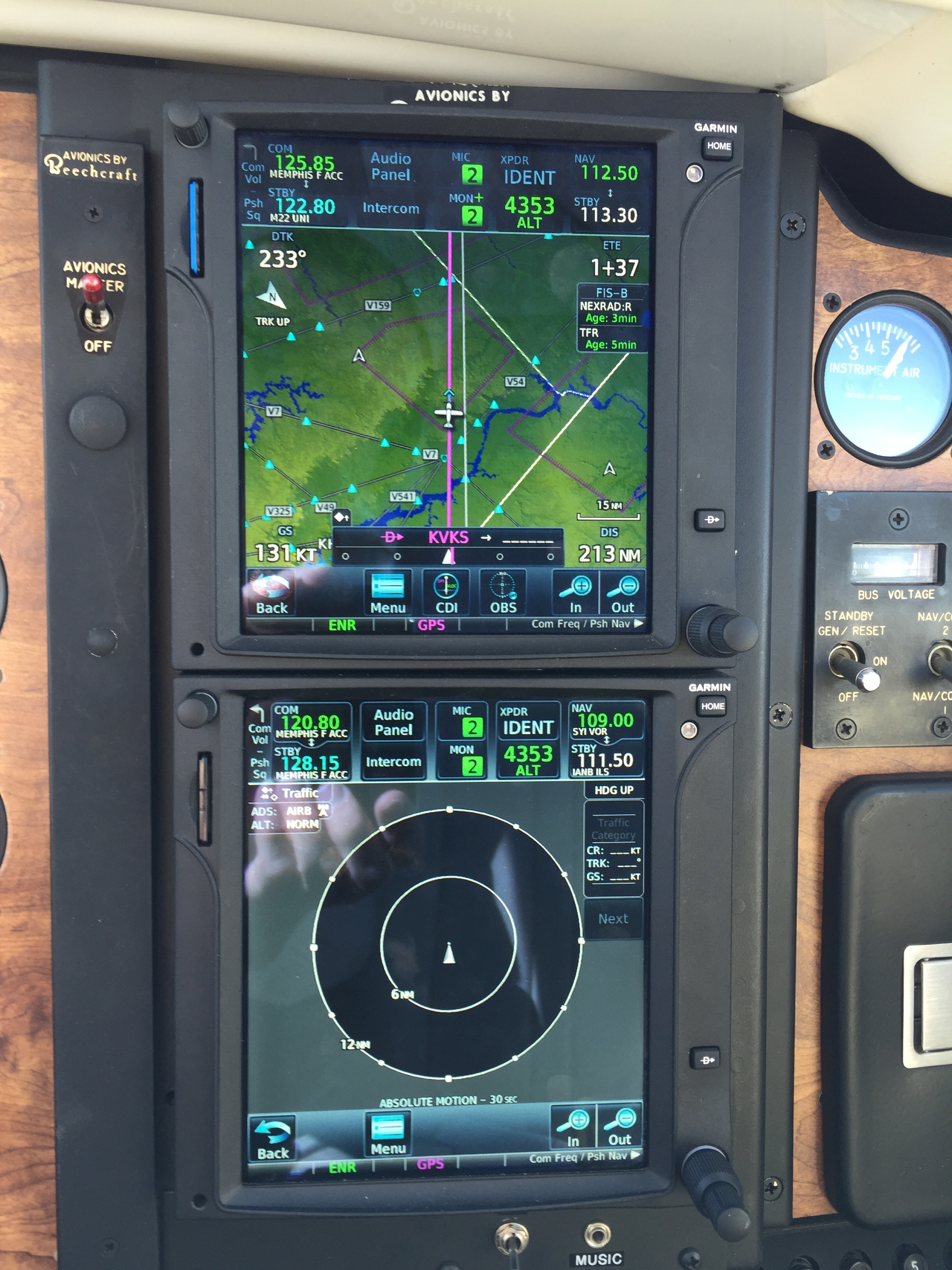

You can’t put obsolete radios in that beautiful model! :) Try an upgrade in the main stack to dual 750s or if space won’t allow a 750 and a 650. They‘re now touchscreen with remote mounted audio panel and transponder. Great images on the garmin website HERE. Images below from a Bonanza I was flying a few years ago. The owner spared no expense on this pampered airplane!
Another neat device is the 275 HERE which puts an affordable upgrade into a classic panel.
