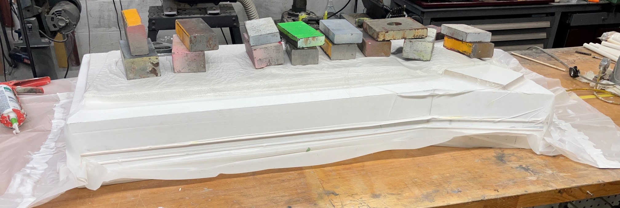

My method is layered foam cores, poly glue rolled until only a sheen, balsa skins lightly misted with water, the foam core shucks, all assembled inside pieces of 3/4" MDF and clamped vigorously. The Poly glue will expand into the balsa and foam leaving a crazy strong bond. I've only had separation success with a claw hammer. Testing of course.

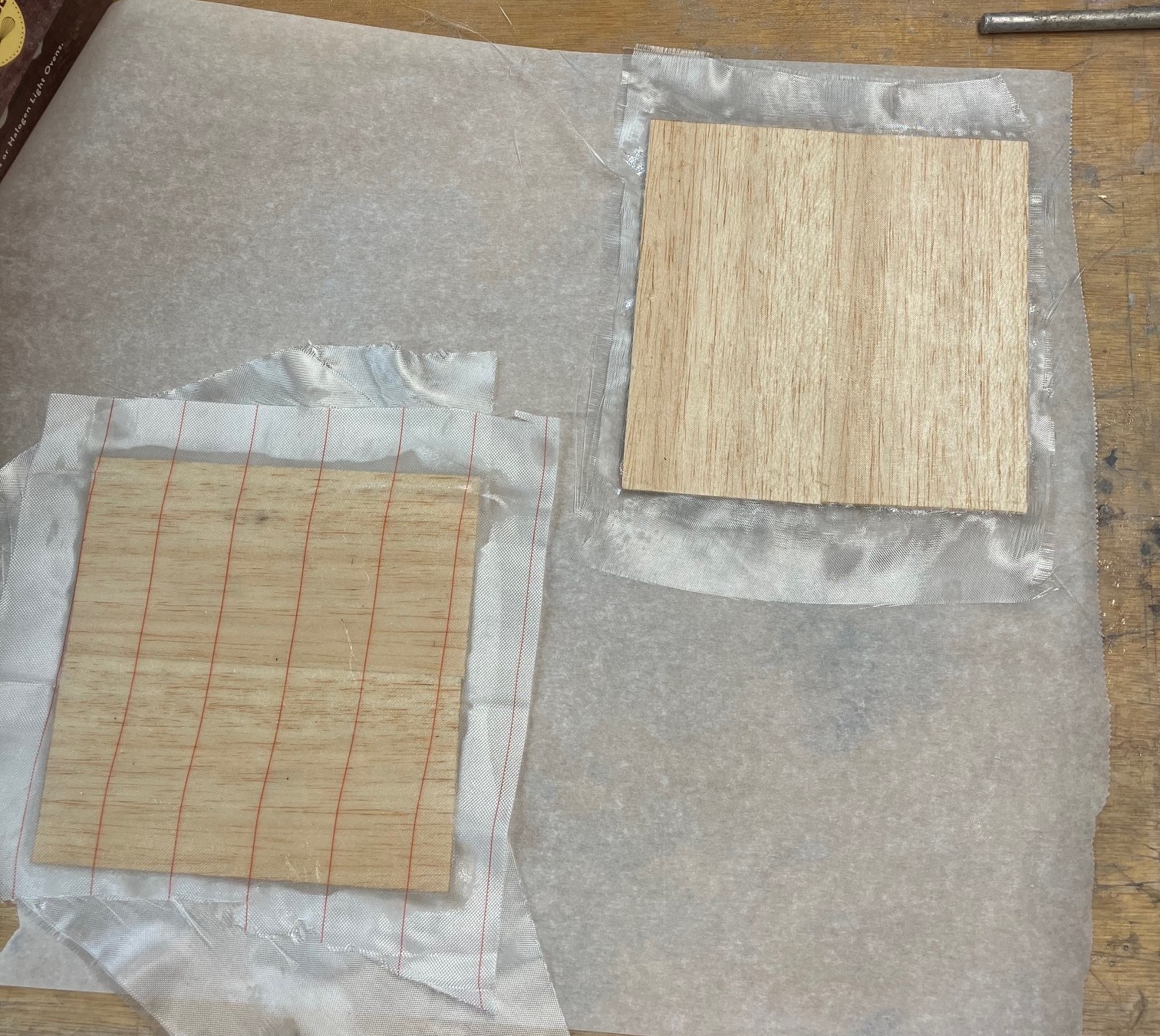

Conducting a test to determine the difference between 1 1/2 ounce cloth applied with epoxy and peel ply verses a 3/4 ounce applied with epoxy thinned 100% with alcohol and the weave filled with the same the following day. I learned about the thinned epoxy from a fellow named Dan Parsons who sold .56 ounce cloth before it became popular. I think I bought a 10 yard roll that came with the thinning instructions, had to be the late 80's, I used the cloth to finish a Piper Twin Comanche, .40 size glow. This plane taught me about tail heavy. Took off and flew fine however on landing the tail suddenly dropped and I was looking at the bottom of the airplane, you know what happened next.
The balsa squares are 6" x 6", each weighted 25 grams before. 1 gram accuracy should be fine, .036 ounce per gram. In an ideal world the 1 1/2 ounce sample should weight about 2 1/2 grams more and the .75 should be a little over 1 gram. I suspect the 3/4 ounce will come out heavier since the weave is being filled with epoxy.

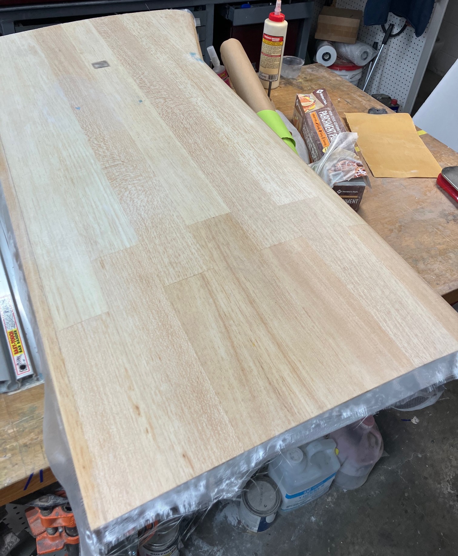

Decided to go with 3/4 ounce cloth. The 1 1/2 ounce would add 8 ounces. The bottom of the left wing is glassed, may get the top later today. The 3/4 ounce cloth is easier to work with than the .56 ounce cloth. Carving the trailing edge on the right wing,
