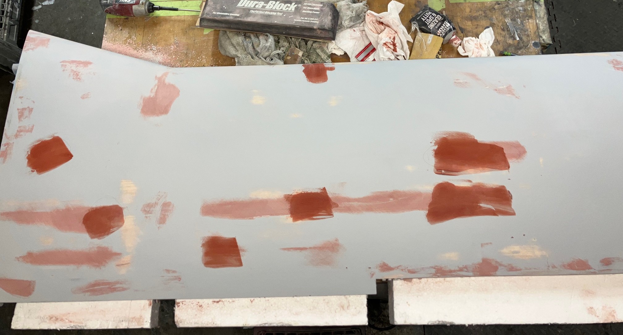

Third application of putty, hope the wings are ready for guide coat next priming session.

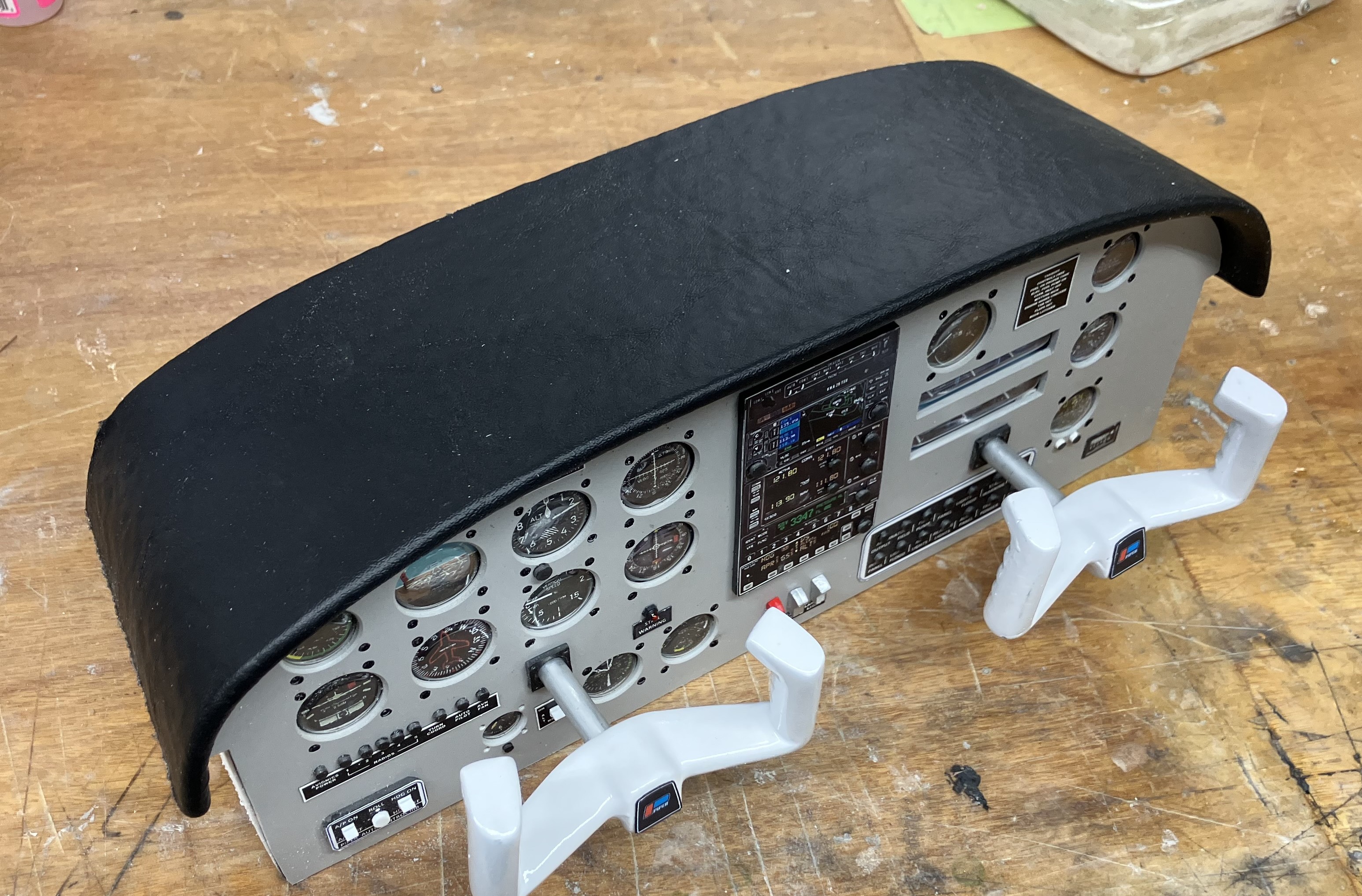

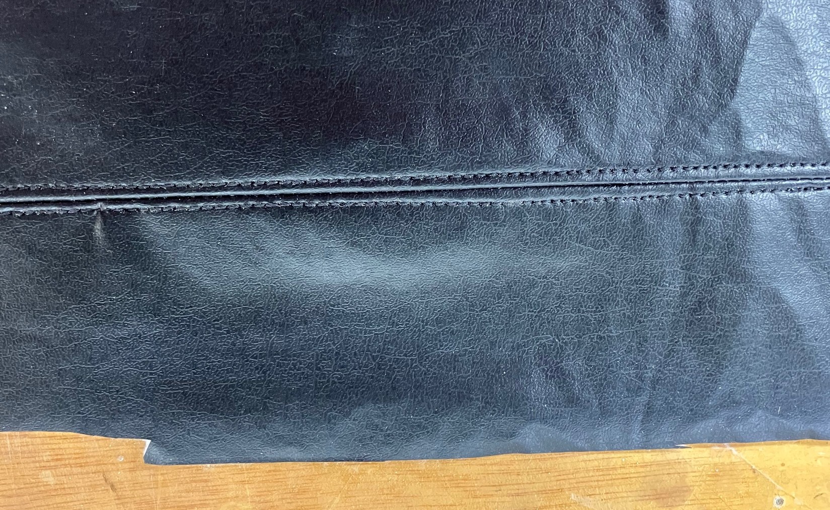

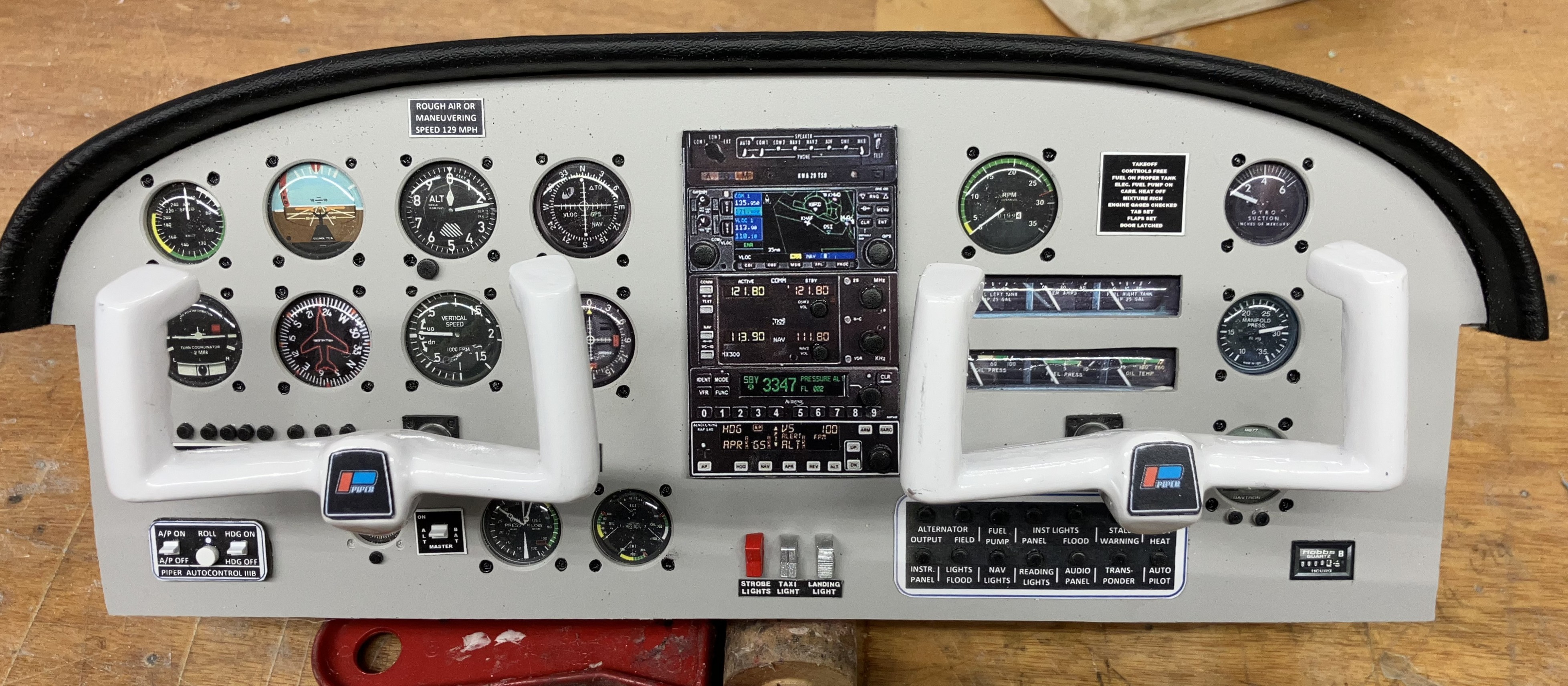

Wasn't happy with the dash pad I had made, just didn't compliment the dash panel. Came across the photo below on Trade-a-Plane and thought I can do that, this will eliminate the need to stretch the material. Making a new balsa wood cover, the previous ones were 3/16" thick pieces about 5" long edge glued together, had a hard time getting a nice radius while sanding across the grain and around the dach cover. This time laminating 3 pieces of 1/16" sheeting together to form the curves, hoping it is easier to sand the radius. The center seam is sewn to the contour of the edge of the dash pad so hopefully it glues down without any puckering. We shall see.

My sewing skills were not up to the task so I ended up covering it with one piece, found different material at the local JoAnn Fabrics before it closed it's doors. Was able to glue the top then stretch the material around the nose with a heat gun set at 200 f. It's not perfect but better than the previous. I like it.

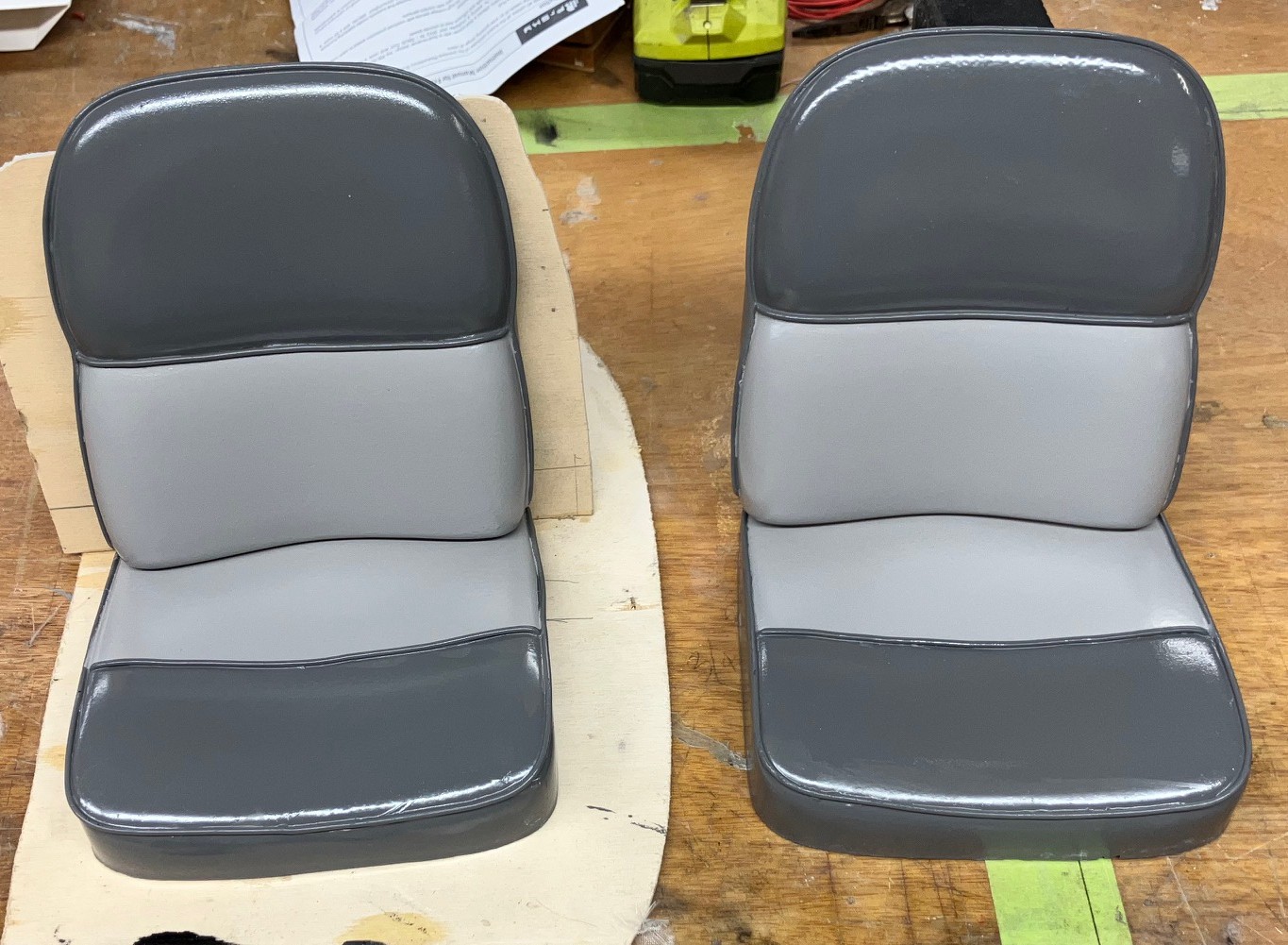

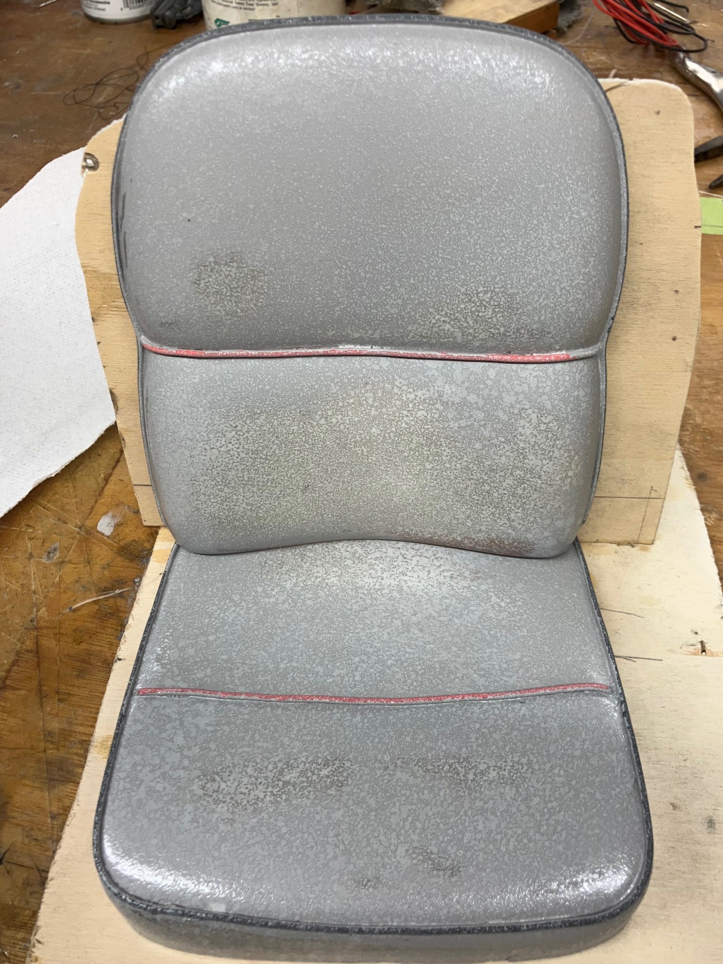

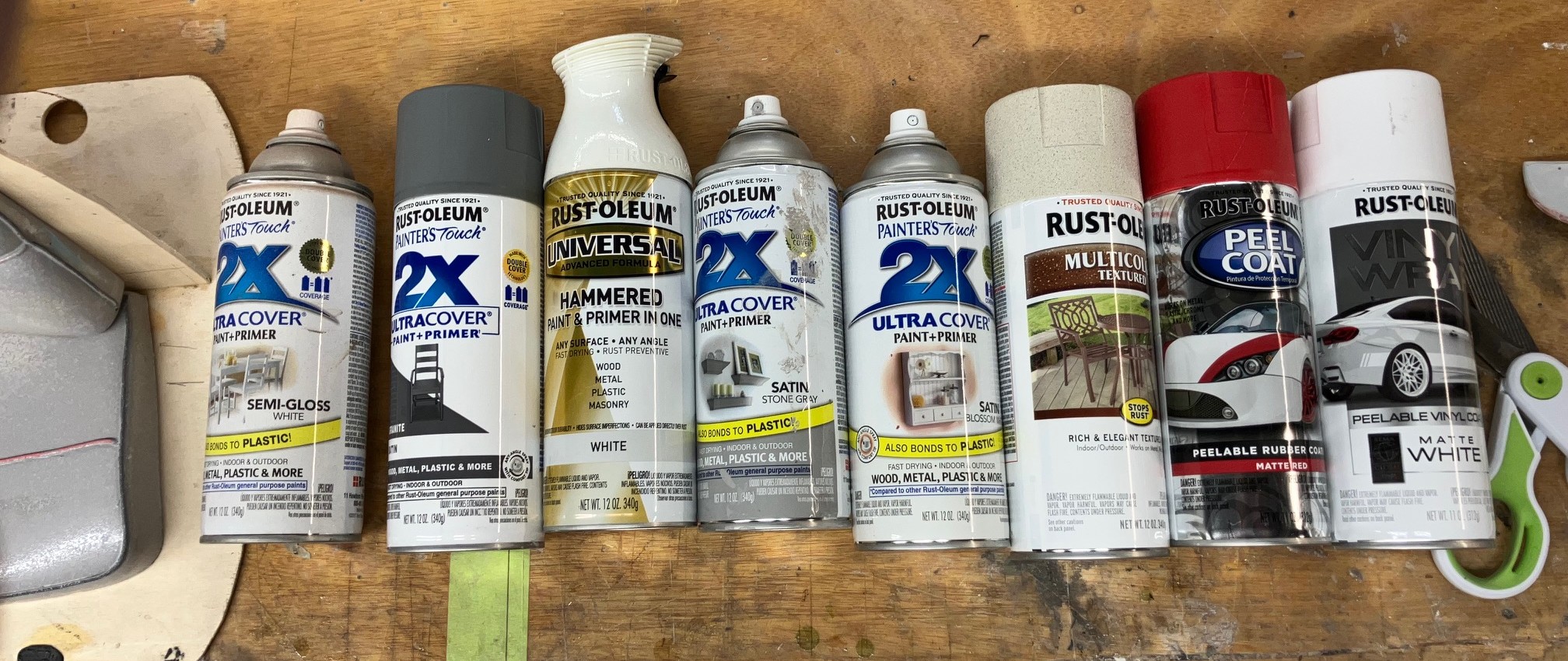

Still trying to figure out the seats, the red and white peel coat is out, thinking gray and white now, better semi gloss finish. Current plan subject to change, install the piping, paint the seats gray, then brush the white panel. Of course this may (Probably) change!

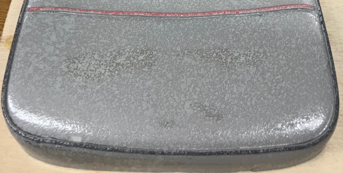

Not sure what plan this is, know it's not A or B! From right to left the various coating s tried, red and and white peel coat (No), multi texture paint coated with peel coat (No), satin finish stone gray (Too light and no depth), hammered white paint (texture too large), hammered white dusted on from 18" away (Think it's a winner), this will get covered with granite gray and white
Used 20 gauge wire for the simulated piping, this is attached with thin CA. Going to let this dry for a couple days before spraying the gray on,
