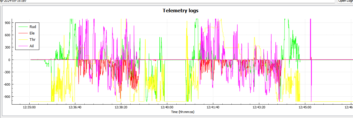

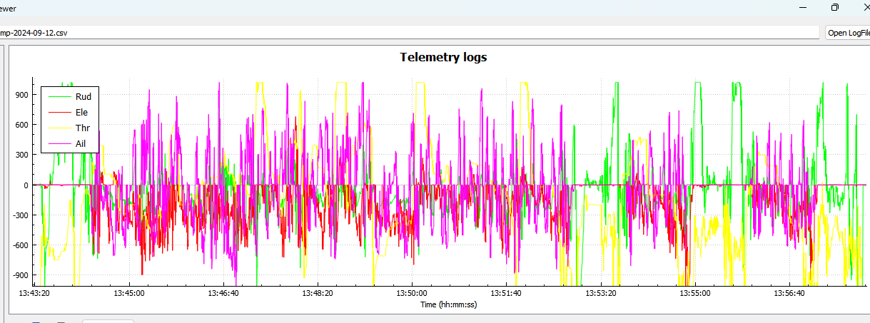

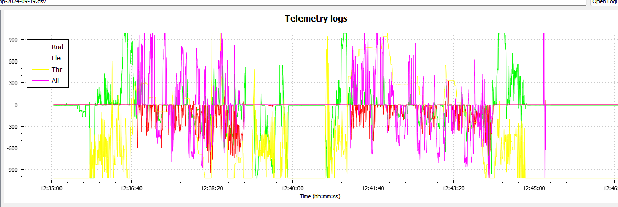

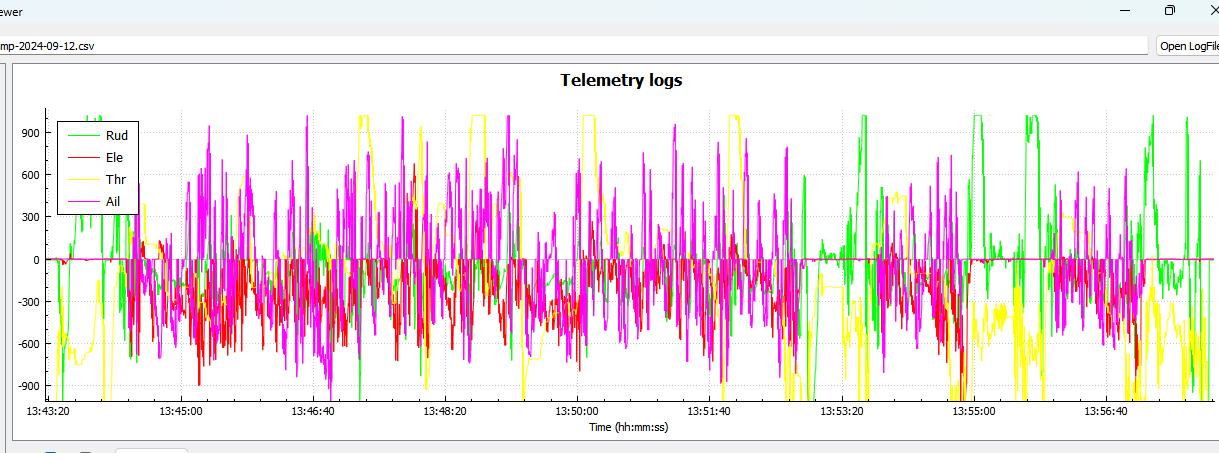

My second experience is with the Eagletree Guardian. I had one in my quarter scale Cherokee, put it in to play with and found it to be rather nice, the plane flew the same with or without it it was just less work with it on. Sometimes I would just to to land using throttle only, get the plane lined up and ease it in by controlling the throttle only. You need a laptop to tune it. After flying in the NASA Fall Classic with 7MPH cross wind on three days I decided to put one in the Champ. The company is gone so I had to find the program online off another user. I only put a half dozen flights on it after the install. Below are two telemetry logs before and after the installation, I made the logs the same time length about 13 minutes, the top one was during the contest. I apparently landed midway during the second flight and took off again. Which one looks like less work? I found two Guardian online and purchased those.
