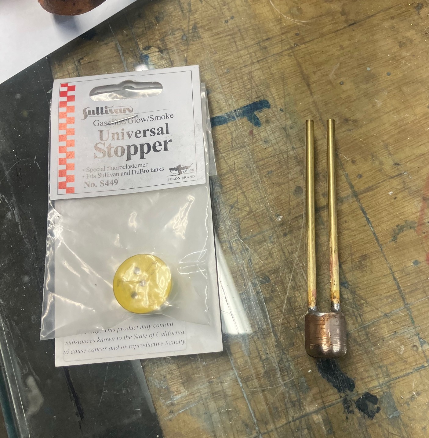

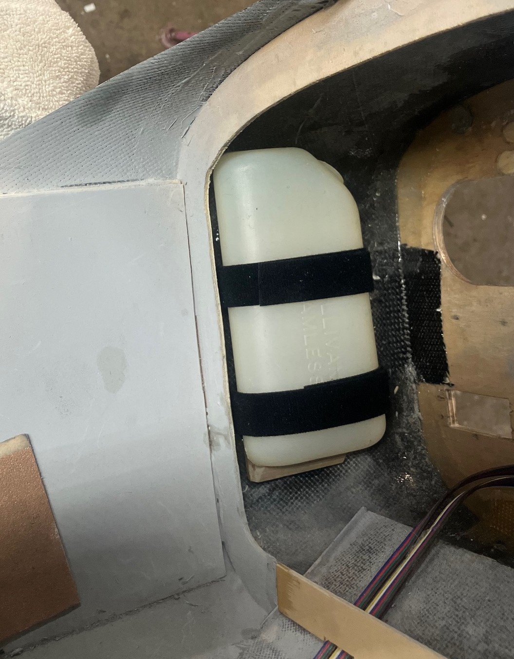

On to the fuel tank. Decided to use a 10 ounce Sullivan oval tank mounted in an unconventional manner. It is vertically mounted ahead of former 2. I use three line tanks and was thinking that two clunks might get tangled up so I make a two line clunk. The tank will get finished with a Sullivan S449 viton tank stopper.

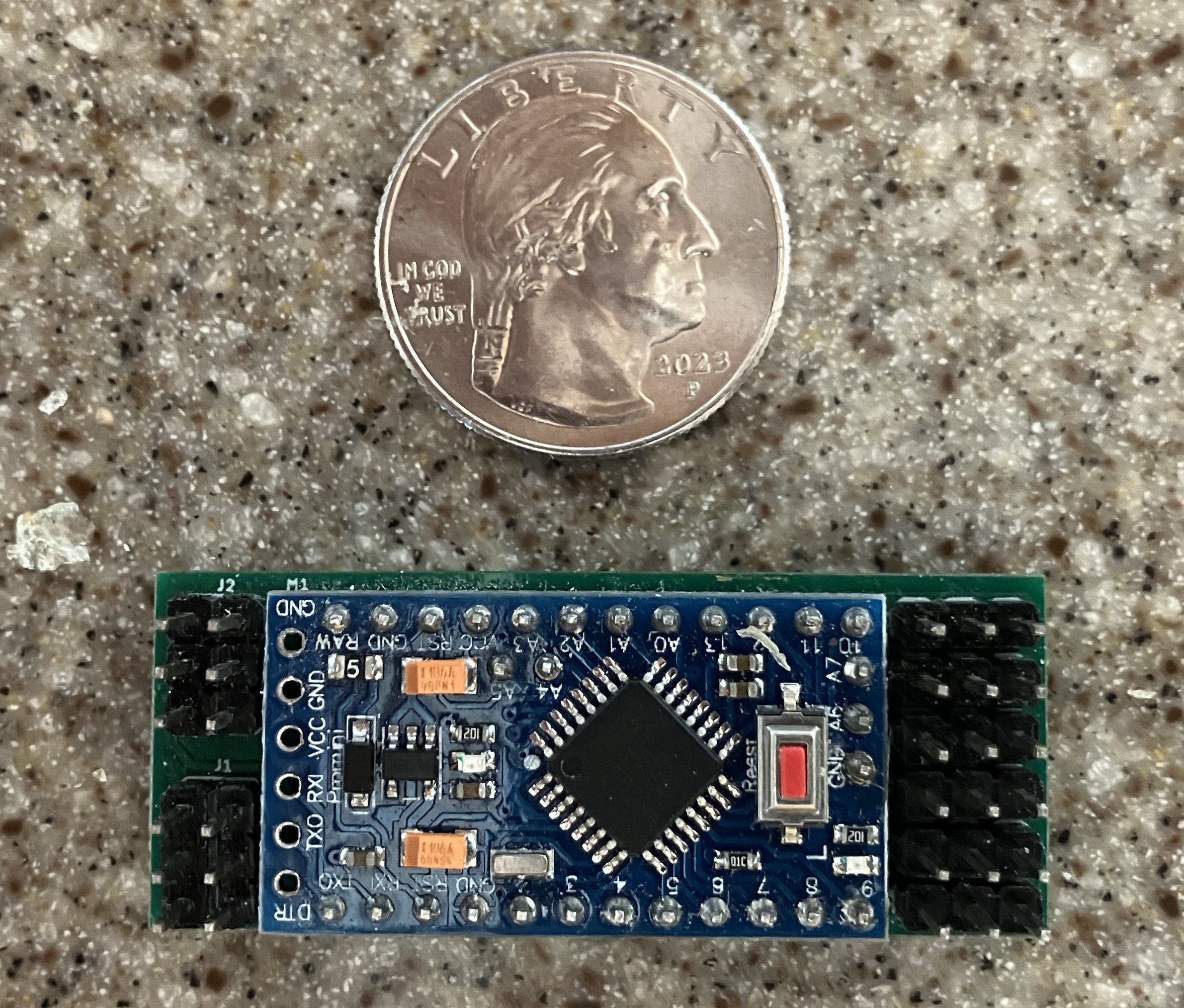

A while ago I made a sensor hub from a Seeeduino XIAO board, I soon discover the problem with that board is it is limited to 5 volt input and I accidently plugged it in to 7.4 volts. I recently discovered the Arduino Mini Pro board handles 5 to 12 volt input so I ordered a few of those to make a new hub. Then I remembered the AT-VI sensor boards that I currency use have a Mini Pro board.
On the right side starting from the bottom are two temperature inputs, a blank input and three voltage inputs. The bottom left side are two SPORT outputs and above that is a RPM input on the left and the plug on the right is used to turn a 5 volt supply on and off. With an ohm meter I was able to sort out where each pin is connected and wrote an Arduino sketch to add the third temperature input to the blank input on the right stack. The instructions for the AT-VI indicate that firmware was being developed for the third temp input but that never happened.
