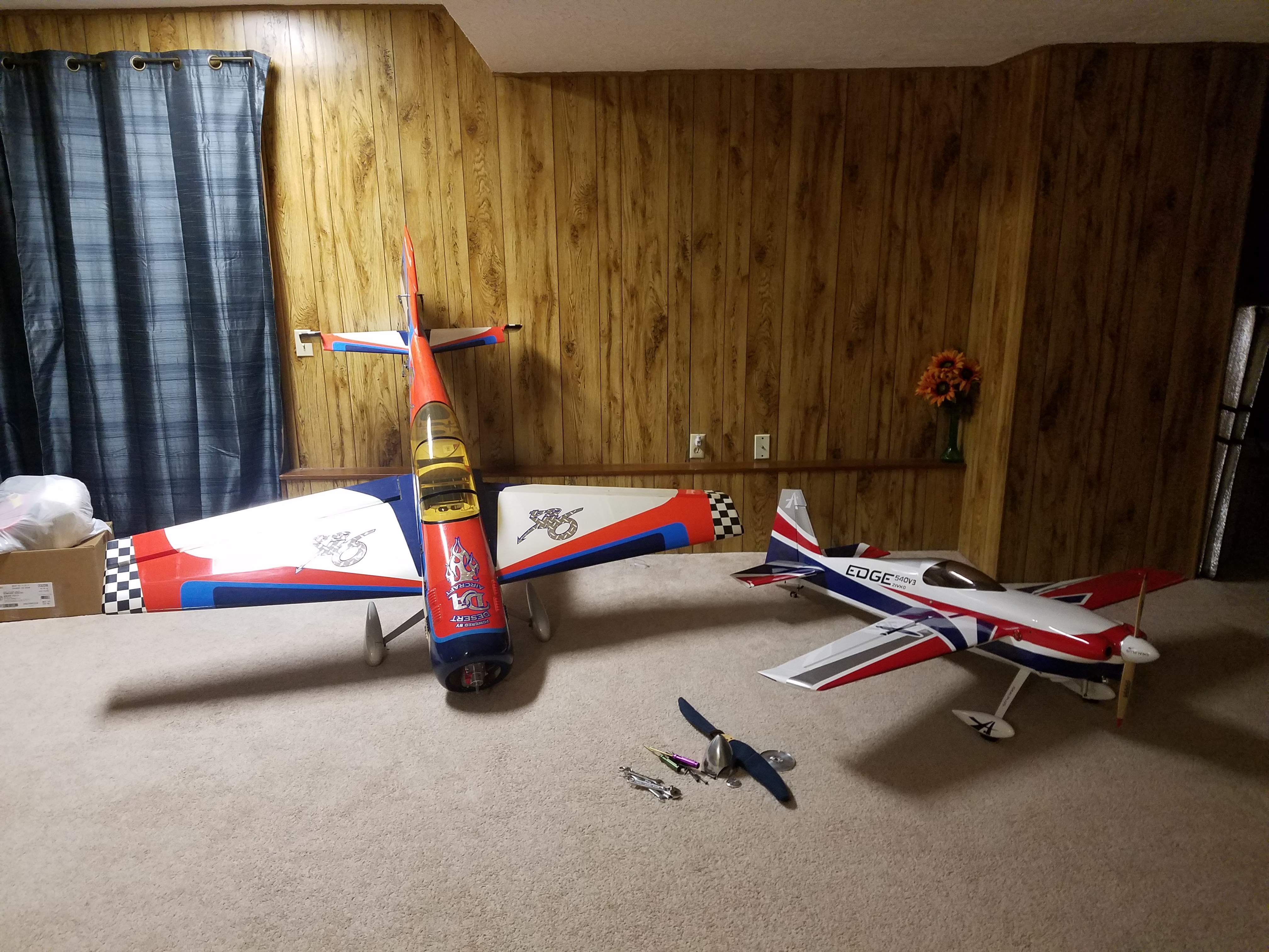

Thanks guys that's what I was looking for. Now just to get it all put back together. It's a used plane but new to me so switching and updating all the electronics and replacing all the fuel components.

I also went with the TDRC tank I also used one in my Edge. I really like them. I didn't replace the inner lines but I did add a short lengh of hard tubing and put felt clunks in both. I use TDRCs red fuel tubing just because I can't stand yellow haha. I found a good deal on the plane just a few minor things to fix I had my first go at repairing a canopy... I removed the canopy and then the pilot figure, replaced the foam cockpit floor and did my best to clean up the plastic cockpit. Letting everything dry for a couple days then I'll glue the canopy back on.
