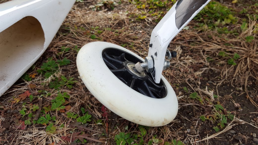

Experiment 52-7. "Operation groundloop". So here is how the wheels fair when you skid sideways. Wheel.....perfect. Landing gear........paint flakey but perfect. Axle.......not so good but they bent and in my opinion saved the plane from damage. Ordering up new pau axles.

The loop was my fault. I have not modified the tailwheel spring for more athority in a crosswind. It's lumpy on one part of our grass field and the back wheel bounces like a pinball. I may do the rubber tubing setup.

I am actually glad I inadvertently got to test out the strength of the gear and the axles with the skinny inline wheels. I think I will take the bearings out and clean the grease out of the bearings and let them get rusty so the plane doesn't roll out so long.
