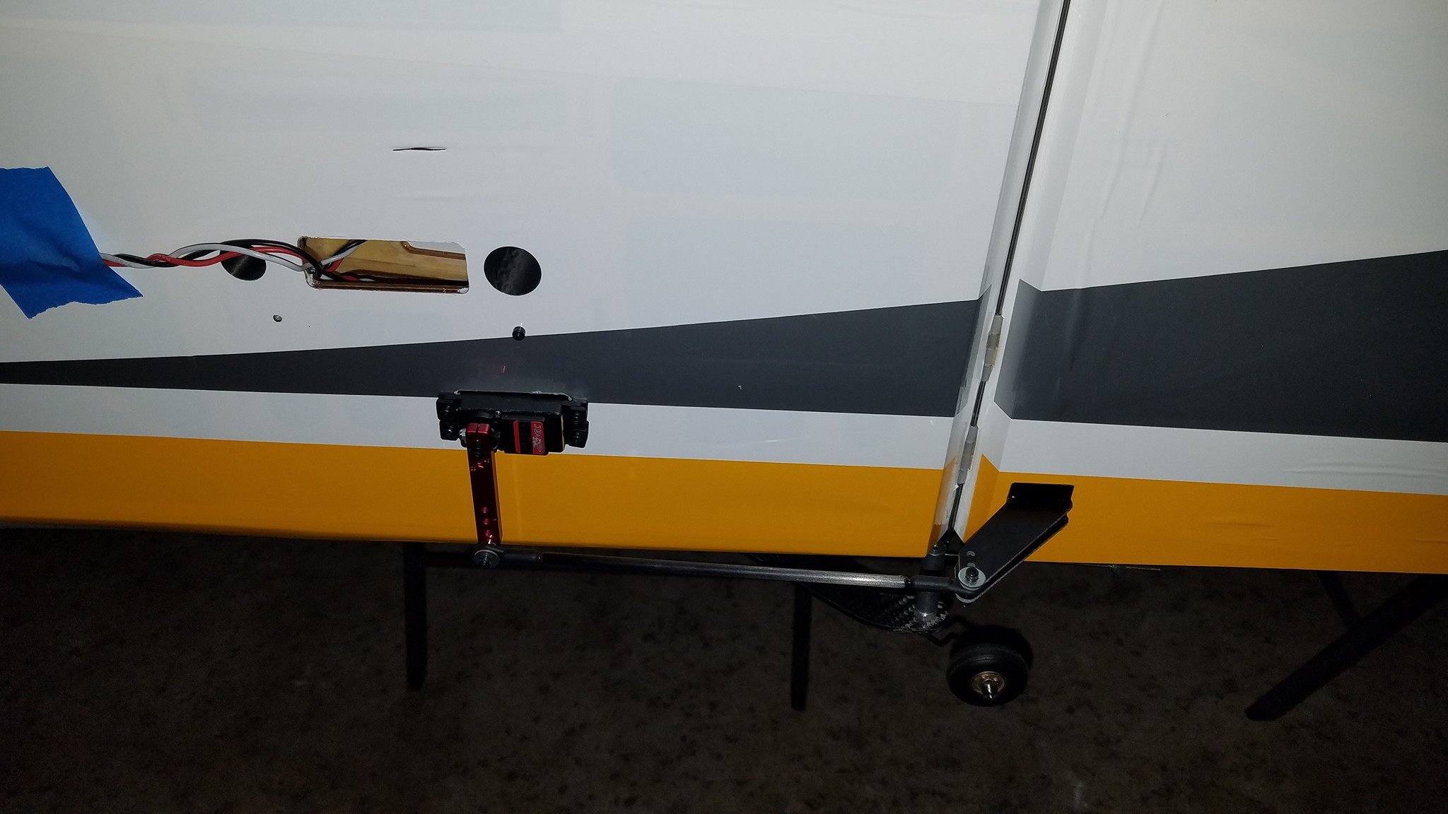

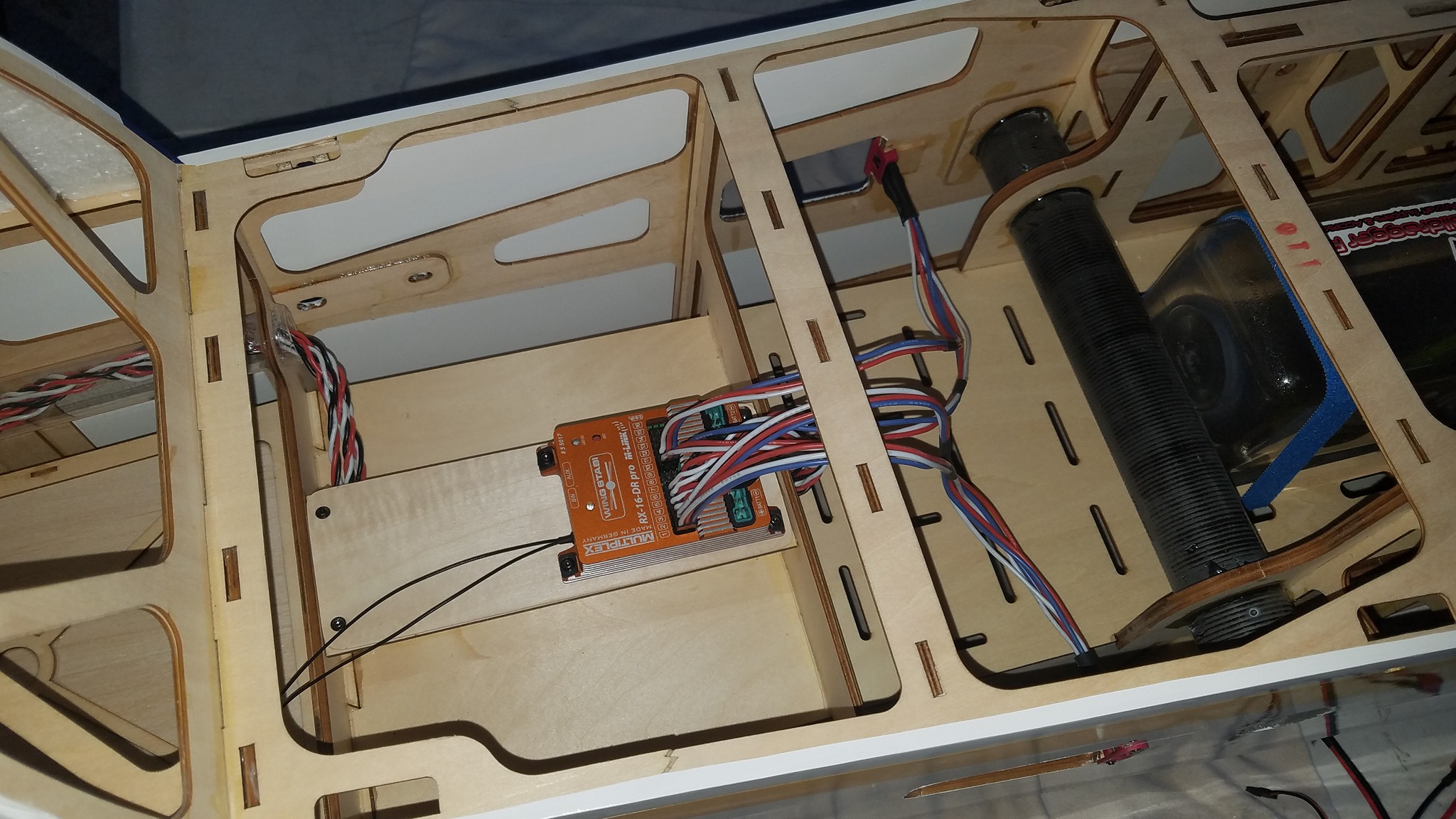

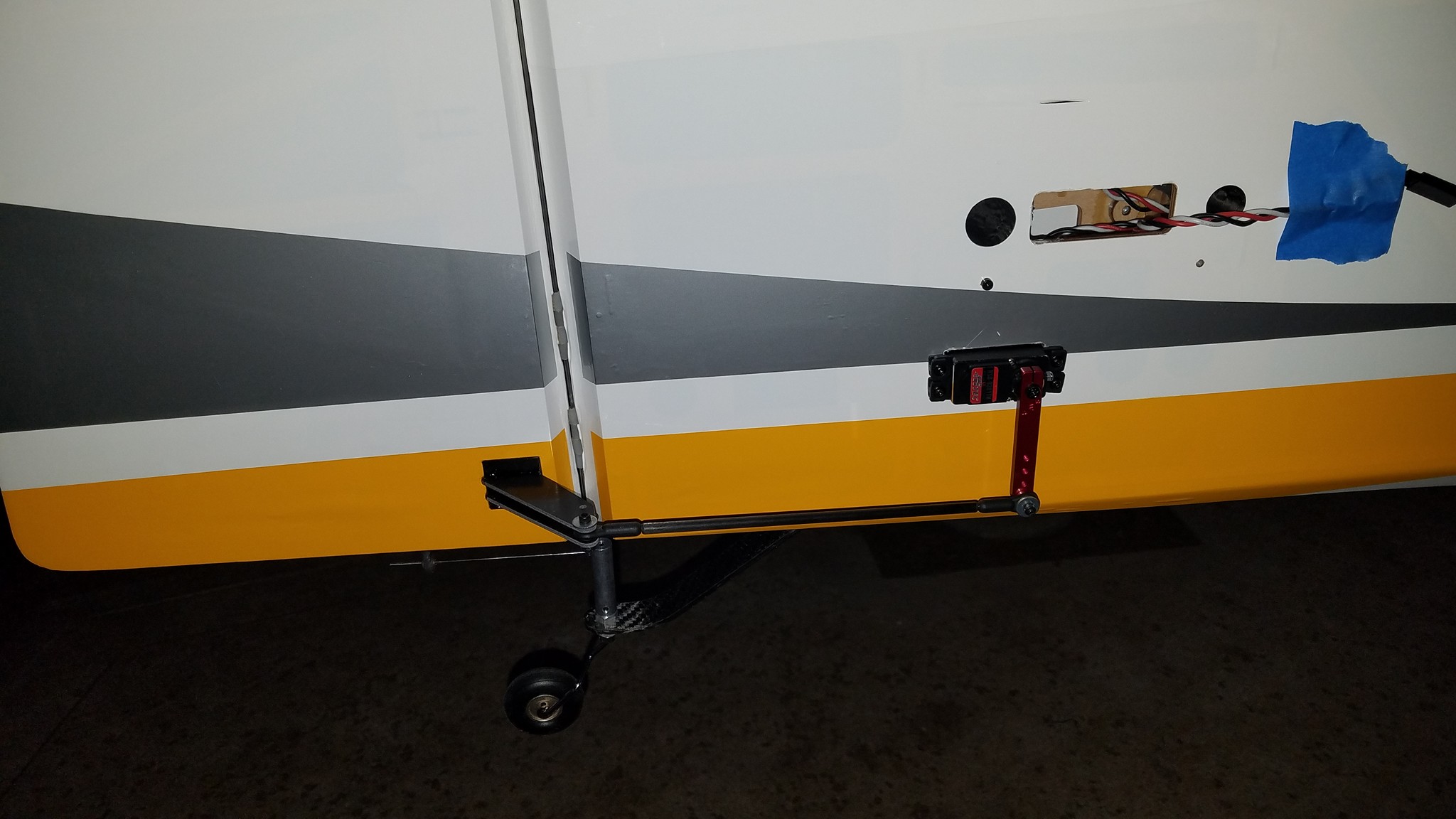

Installed the Multiplex Wingstabi 16ch gyro/rx last night and installed the aileron harnesses into the fuselage. I might end up moving these elsewhere, just depends on how I'm feeling.
The Wingstabi has all gyro functions disabled, I played with them in the past and still prefer a pure airplane experience.

Being I'm no longer a "Purist" or if that I really ever was (lol) could you try to get that wingstabi dialed up for just some fun? I have seen these units hover and torque roll a plane hands off completely! Yea I know....but at my age I need all the "fun" help I can get these days :). Not only am "I CHEAP" but "I CHEAT" too :big-grin:.
If you like cheap stuff then the Wingstabi is not for you ;)
This particular unit retails for $479 :oblong:

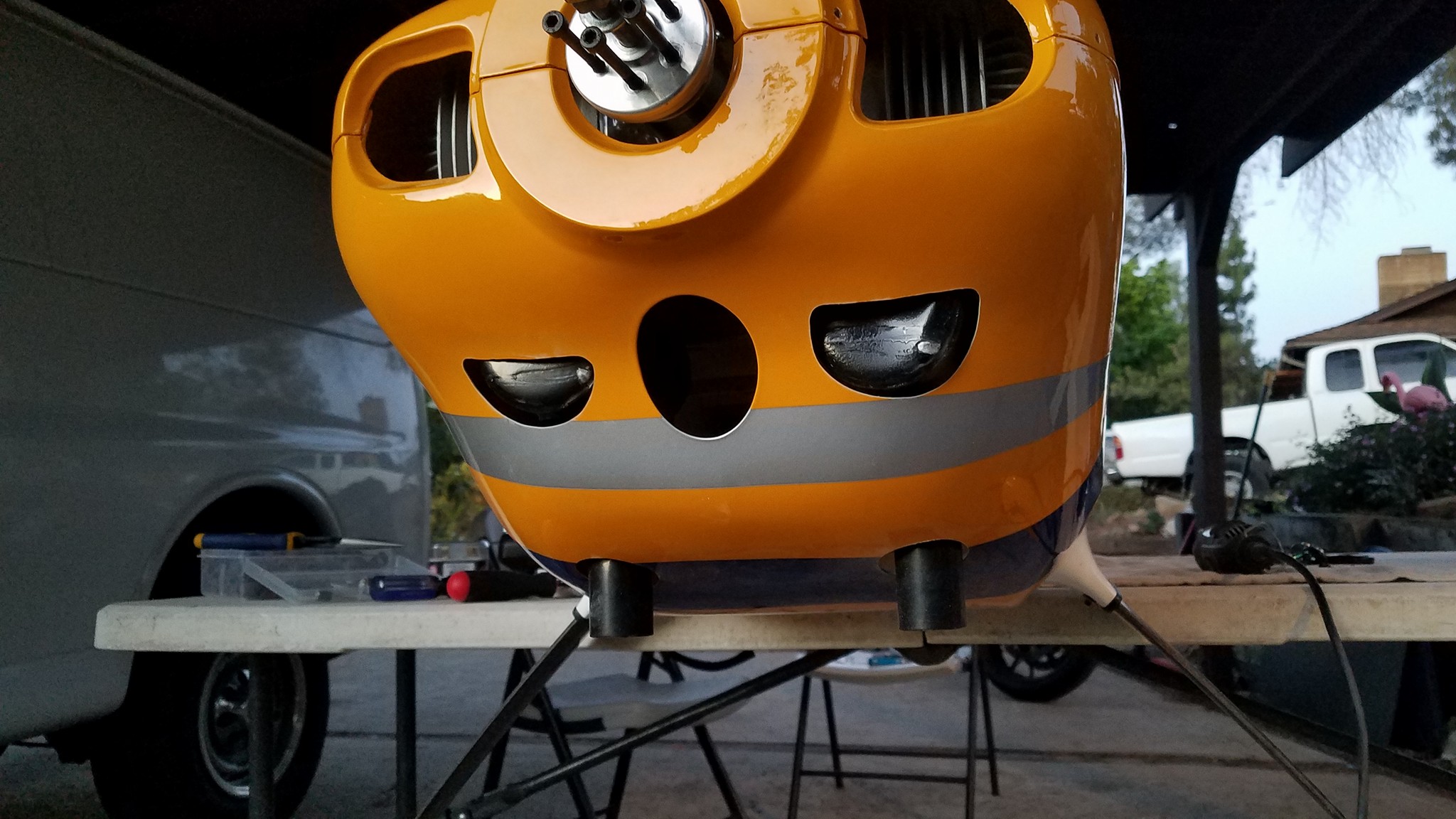

After evaluating the time I have left to get this bird flying the weekend before June 9-10 (1st huckfest of the year), it was decided that I had to cut and clearance the cowl for the JMB keg mufflers I have for the ZDZ180. Originally I was going to go with canisters but I'm just out of time now.
Realistically I still have 1.5 weeks worth of final assembly and adjustments to make before I can fly the airplane, plus the weekend of Memorial Day I am out to New Mexico to visit the girlfriends parents. Gives me 1, maybe 2 weekends to give the airplane a shakedown and make any adjustments necessary before it's time to throw down :confused::cool:
