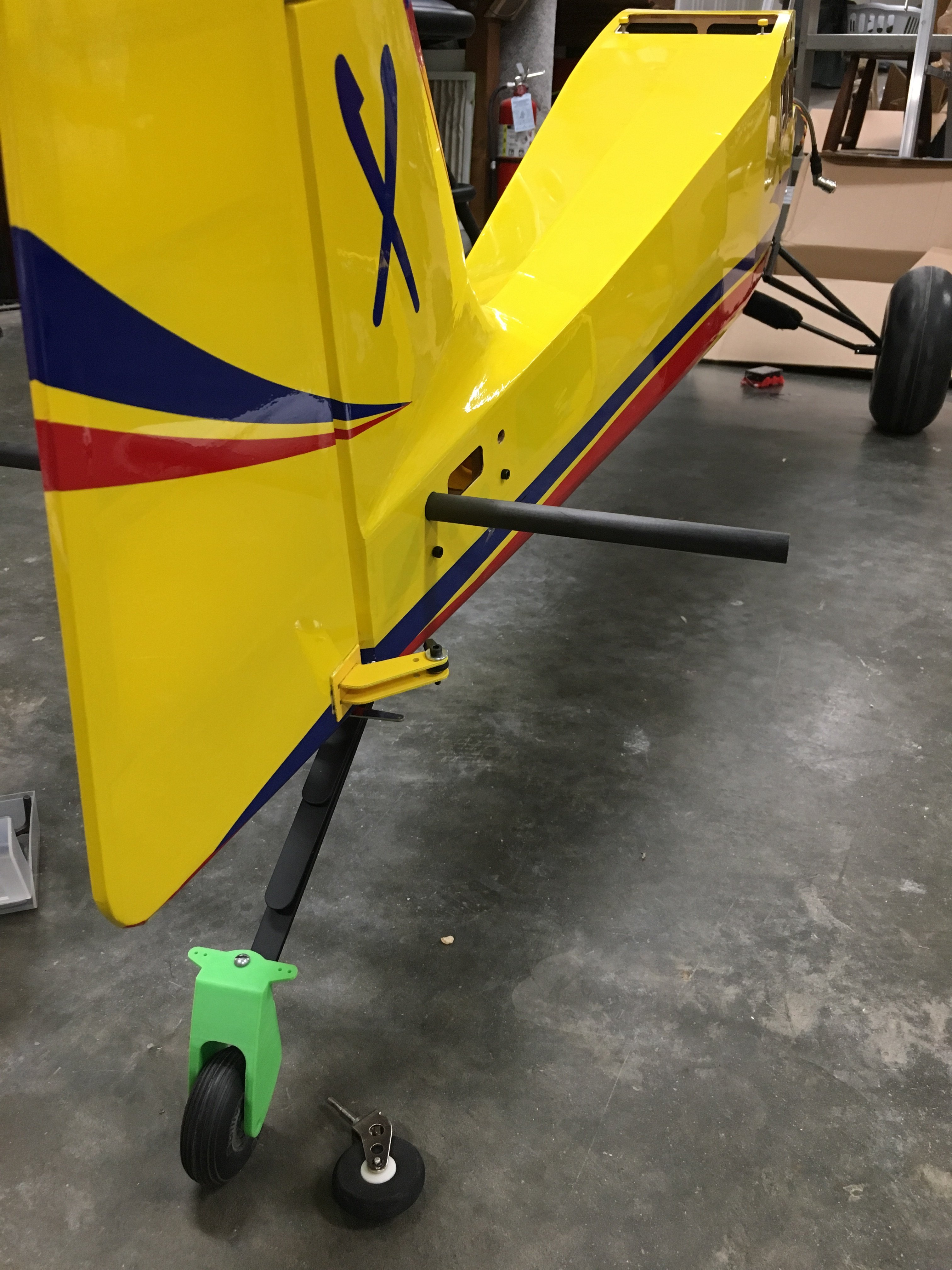

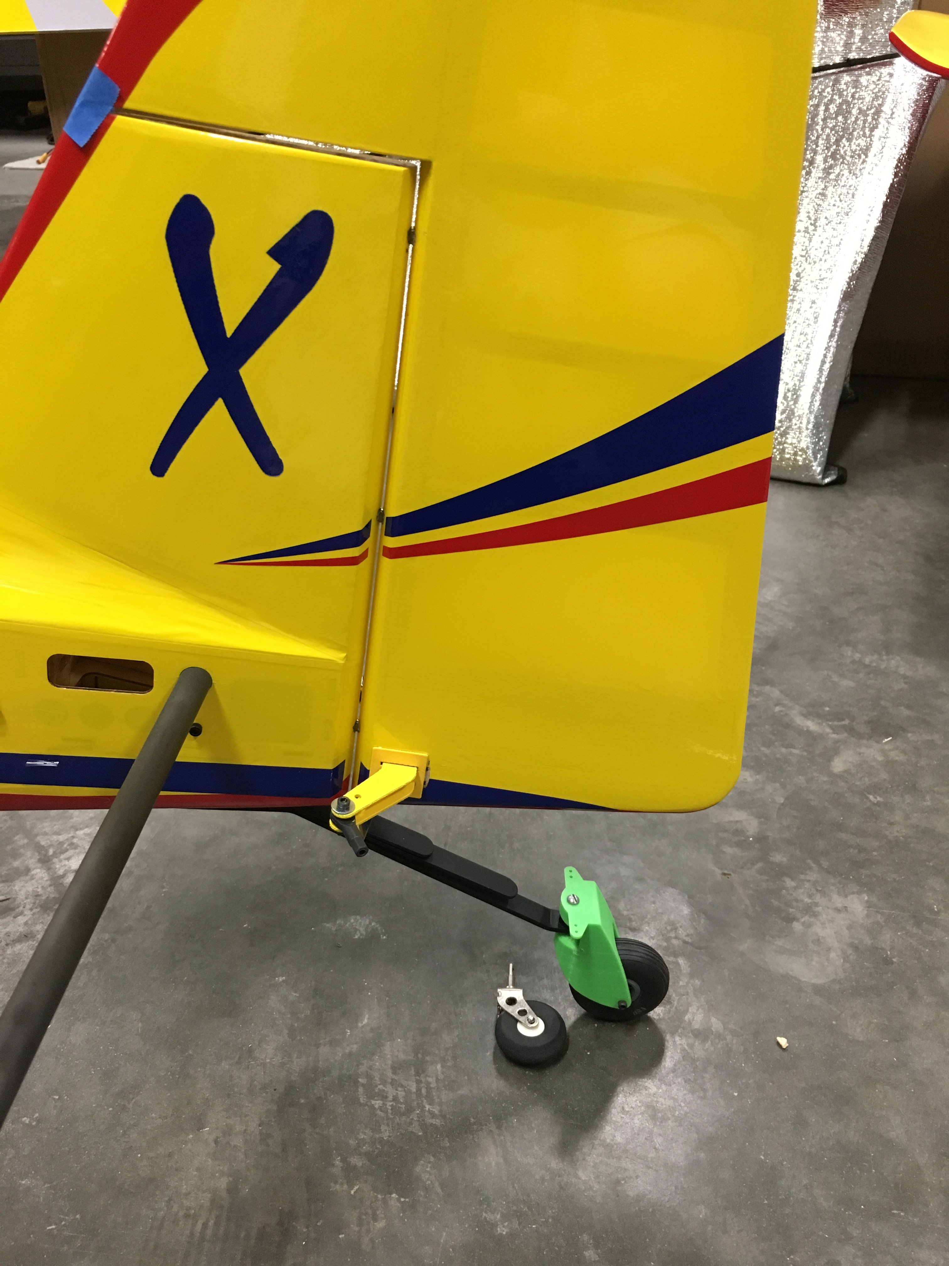

All I can say is that it’s a tank. Need to trim it up and make it smaller/thinner. My concept design works though! Looking at a 2” wheel in there. It will be printed in silver eventually

My mother always said if do not have something nice to say keep quiet, sorry nick but that Tailwheel looks out of place maybe it’s the colour. But it needs something.
LOL! I said it was a TANK. WAY too big. It's on a diet in CAD and being reprinted in silver as a version 2. I still think it'll be an improvement over the stock hard foam wheel, and it's cheap.... the optional scale tail wheel is expensive, so I'm making my own ha ha.
