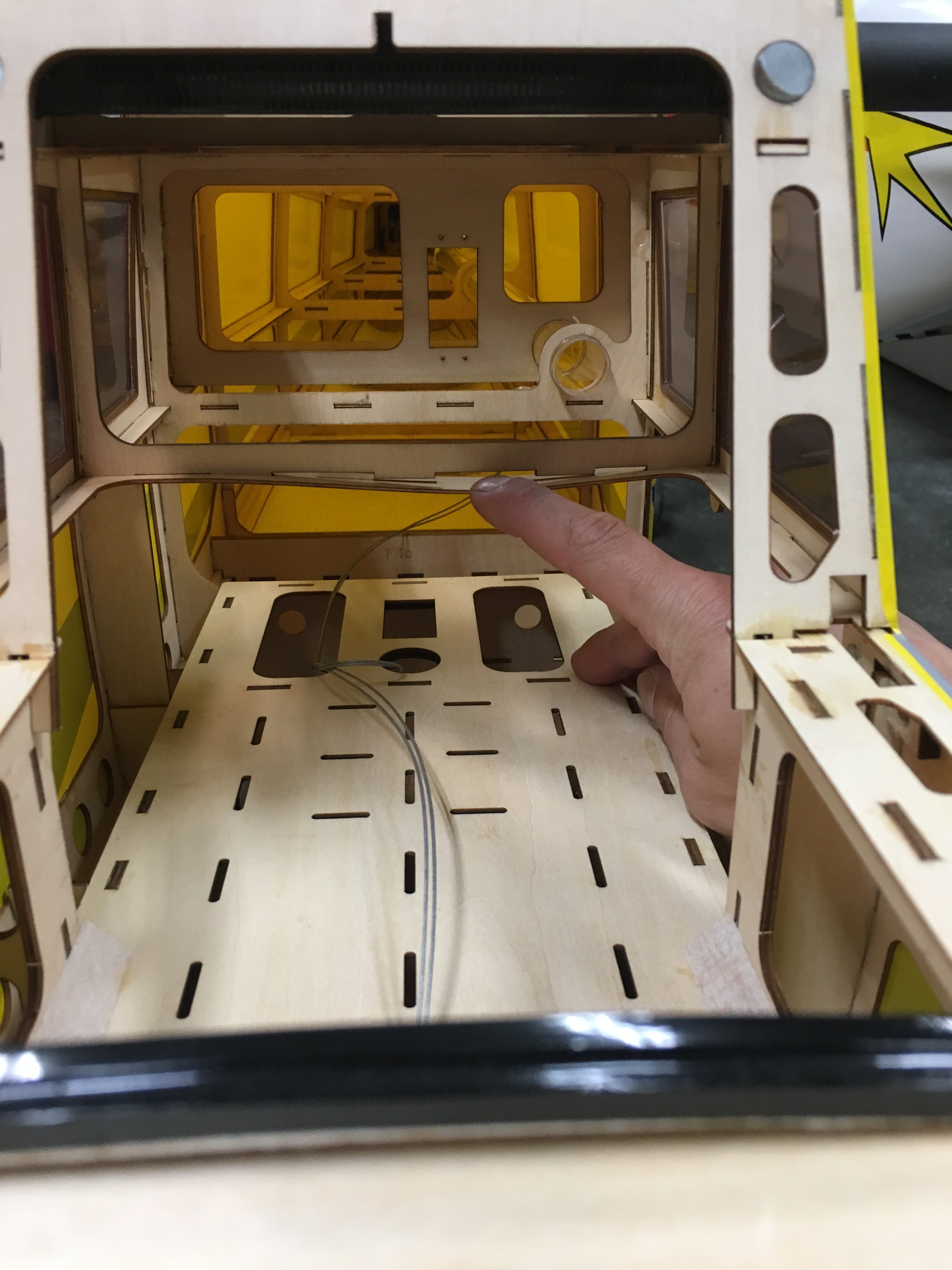

Got the tail assembly on.
Here’s another PSA reminder to check all the joints:
There is quite a few gaps in all the seams. Pick up a nice bottle of Thin/medium/ and dare I say thick CA to go over all the joints. Like I said the fit of the plywood interlocking parts are kinda poor. It’ll work though!!

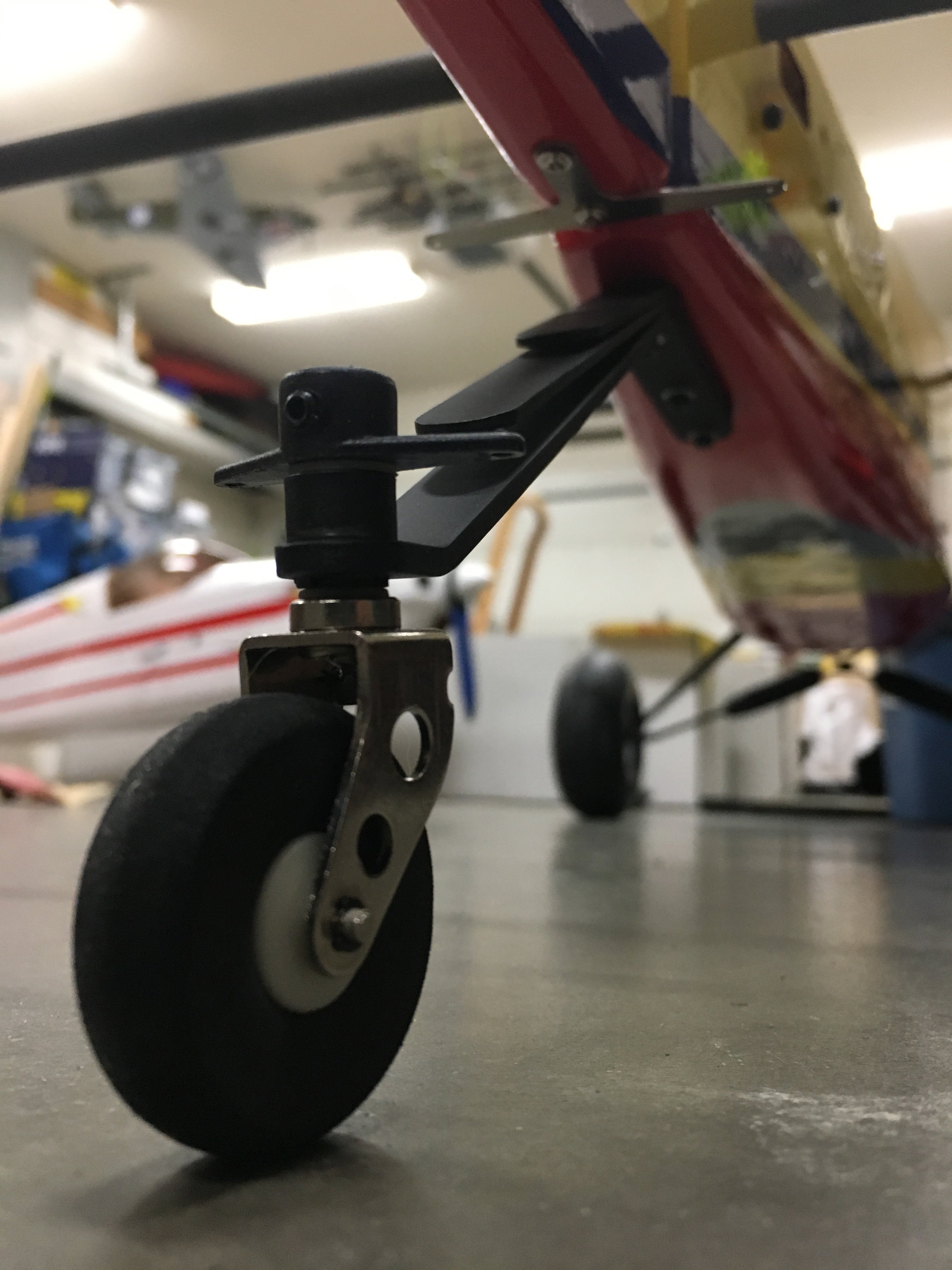

Does this tail wheel come with the kit or is it a after market Tailwheel to match the large front wheels.
Yup! Stock tailgear is sandblasted. I cleaned it up and painted it black. Unfortunately we’re stuck with the wheel size. Been thinking of how to make a new fork for a larger wheel....
Picture of the Tailwheel and fork to see what you are describing.

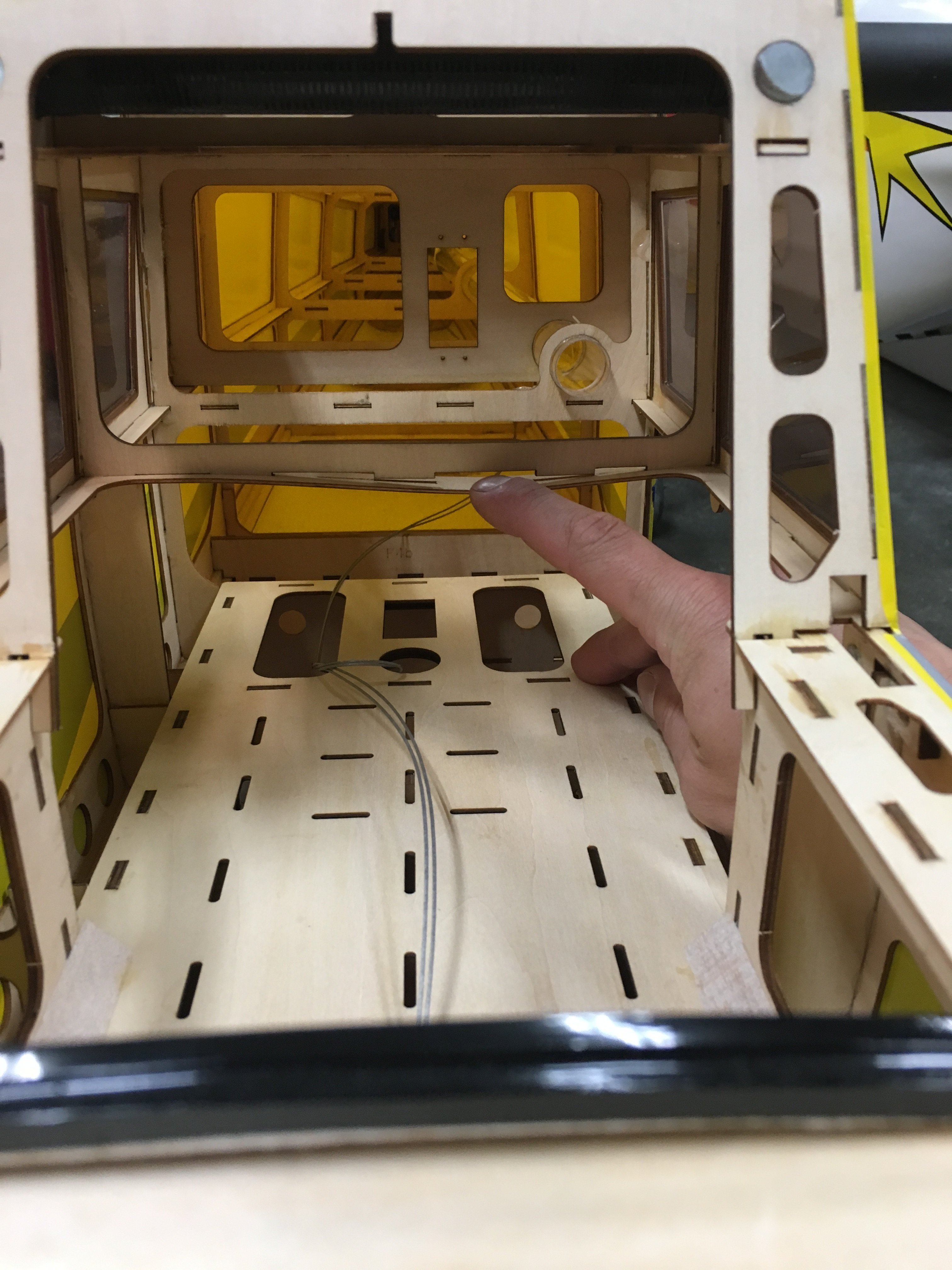

How easy is it to reach down the fuselage to get to all the joints
AKNick
Oh and it’s not too bad. Would be easier if 4lbs wasn’t on one side of the fuse... hit it with glue first! You get to learn from my findings! Ha ha.
