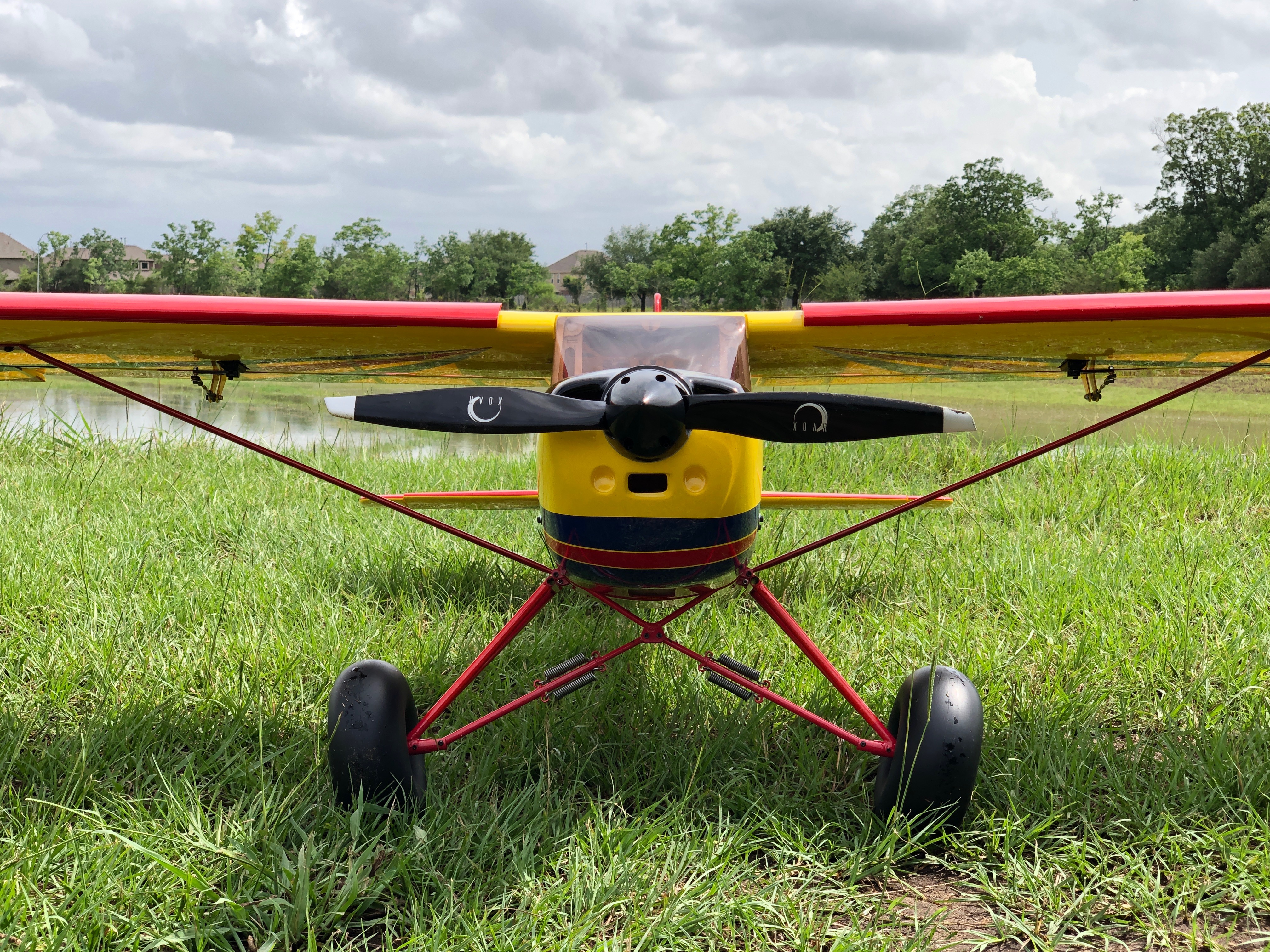

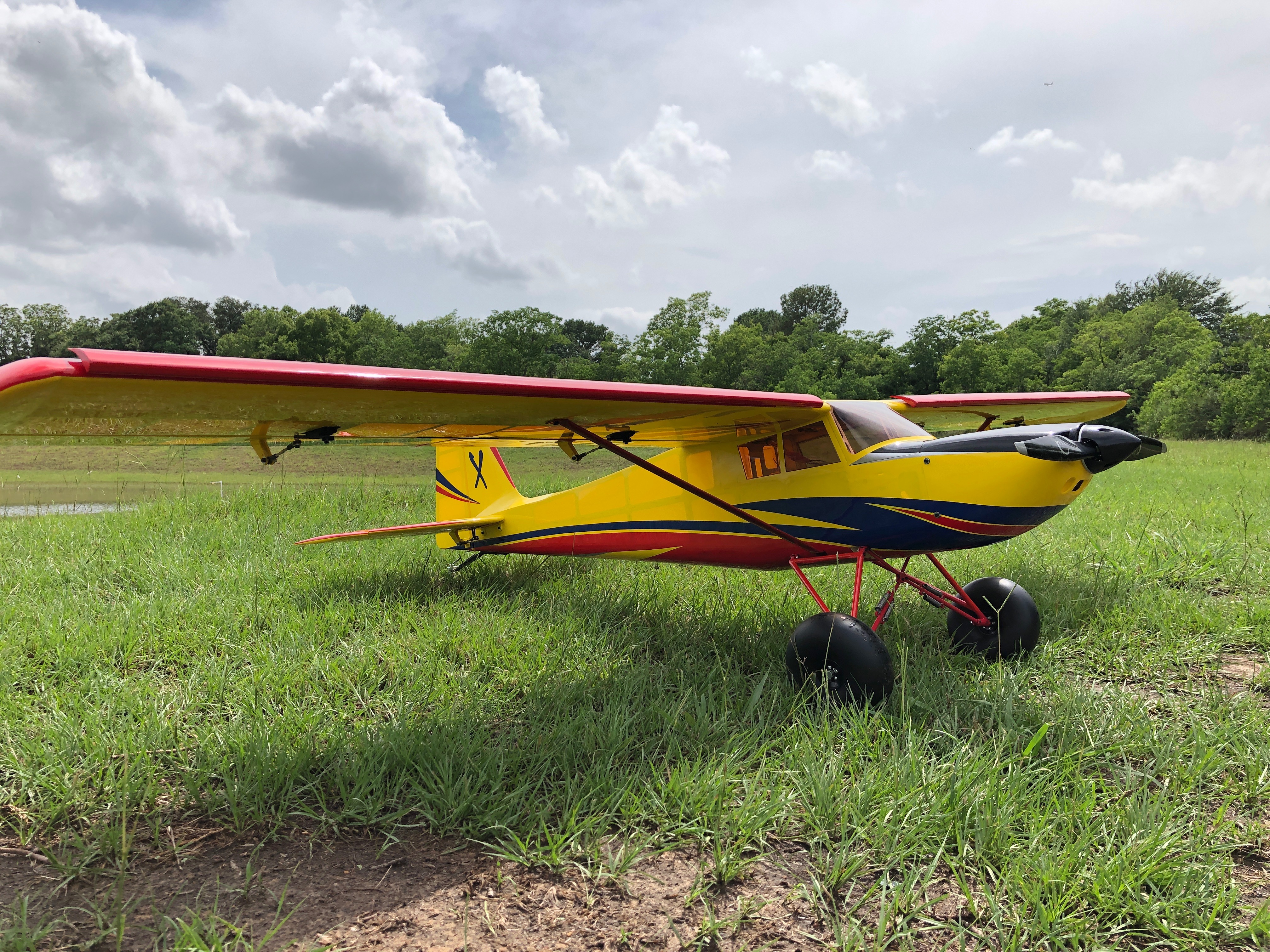

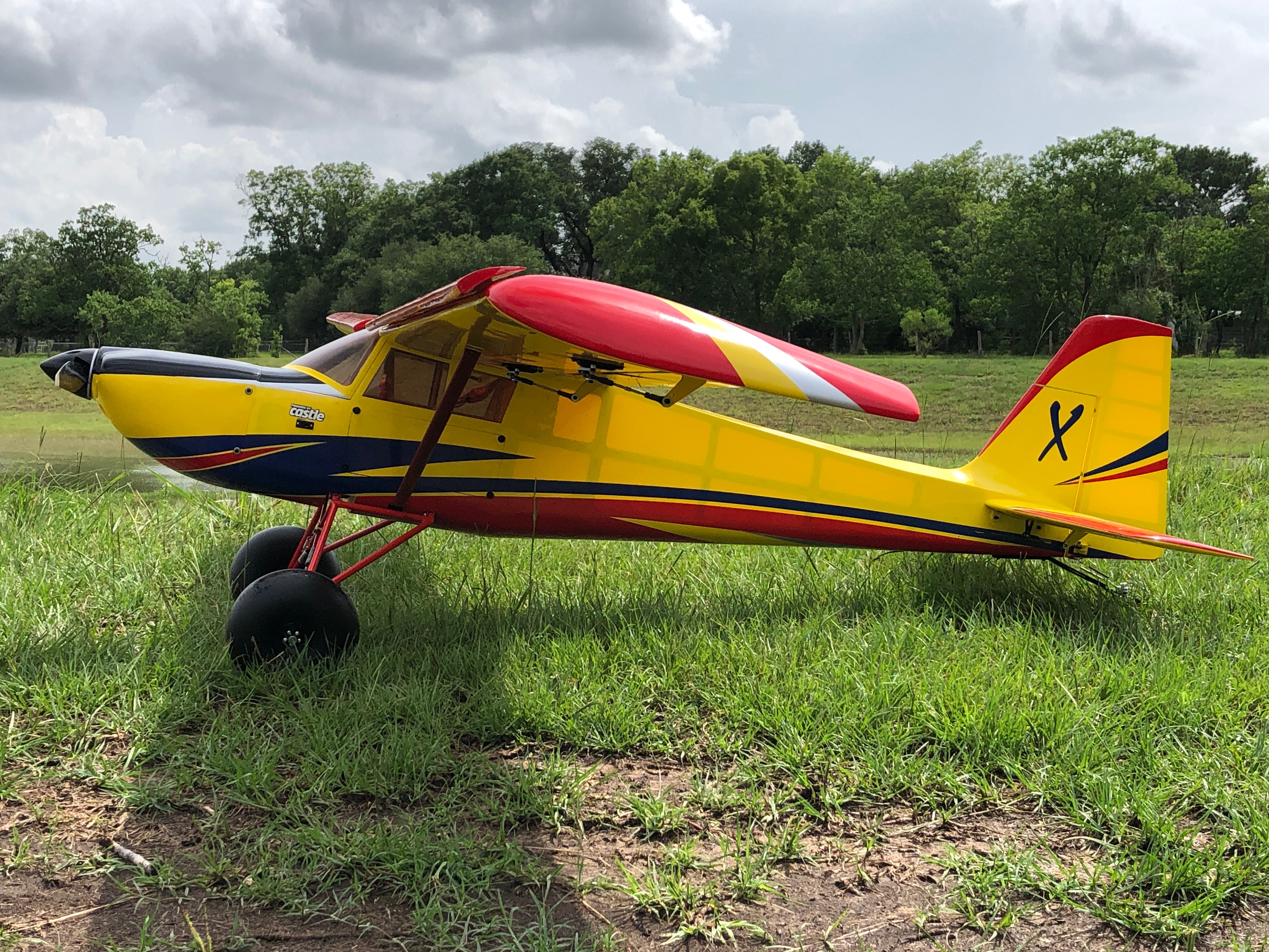

  7. I have them installed on mine and I LOVE the way it flies! I can literally bring my plane in slower than my TBM and just plop her down on the gear and with the bungee gear mod to the Xcub gear, it looks exactly like a full scale STOL/Bush plane coming in for a VERY short landing! flight characteristics are great! VERY scale-like and smooth, but still allow for sport flying.
    -Clint
    Ken., SjtStriker and WMcNabb like this.
  8. Snoopy1
    Snoopy1 640cc Uber Pimp
    6,099
    8,343
    Canada
    Thanks for that. Do you have pictures how does it look on the plane.
    FlyingClint likes this.
  9. I do. I need to get some videos of it flying and some of my landings, but here are some pics:
    Ken., BSteeve, AKNick and 4 others like this.
