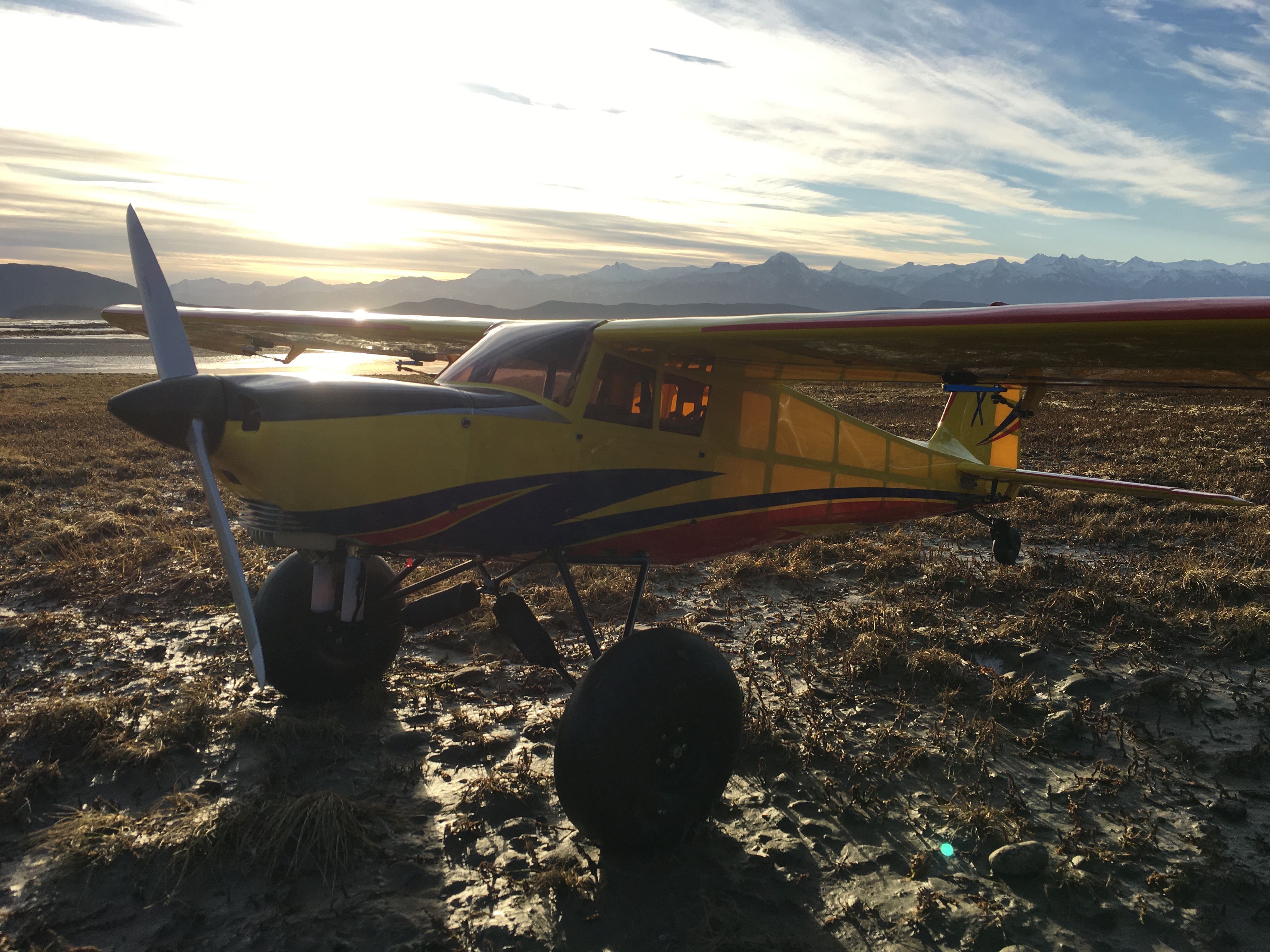

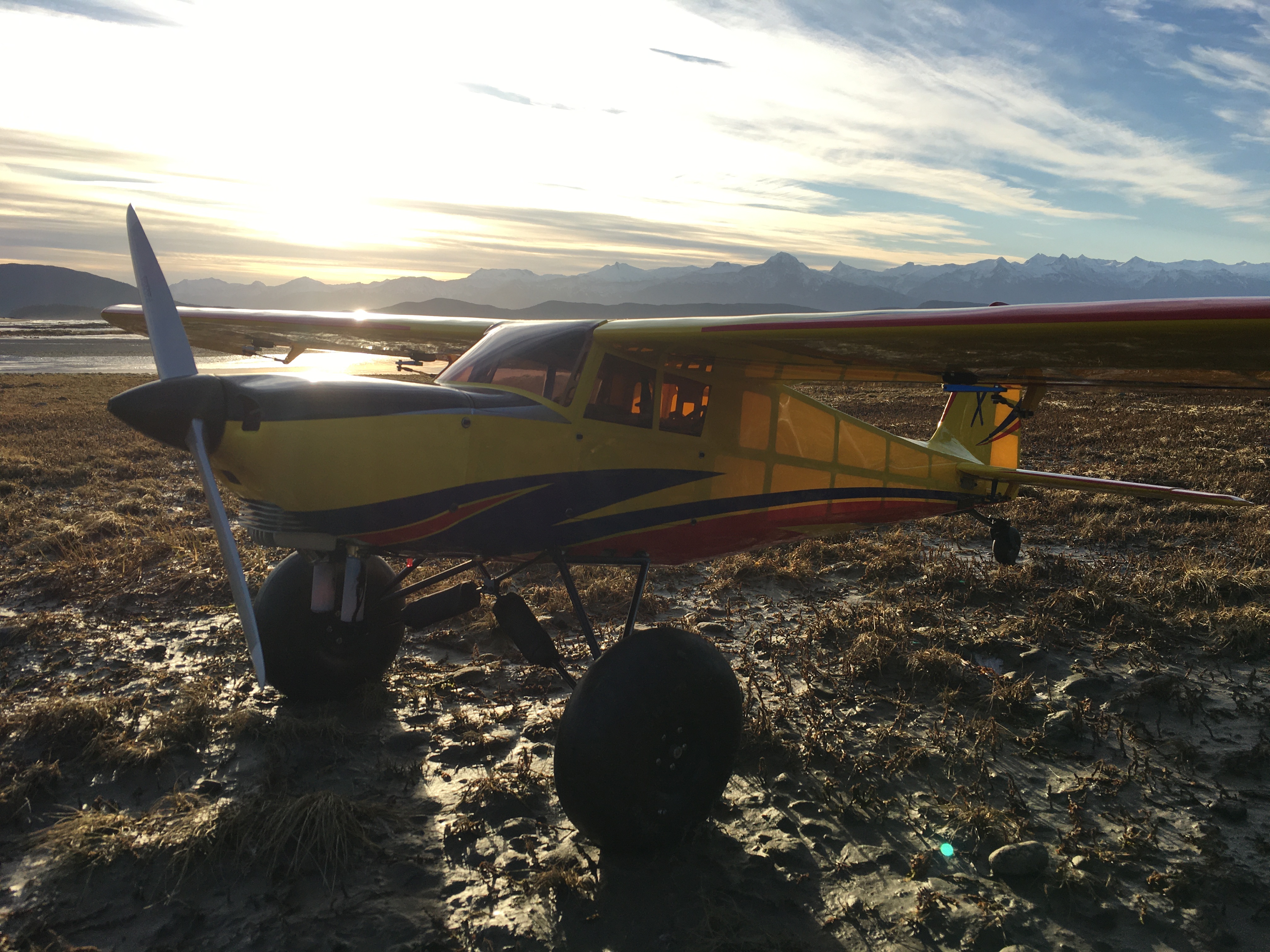

    Flew it over some tougher terrain. Handled great!
  4. Very nice!!!

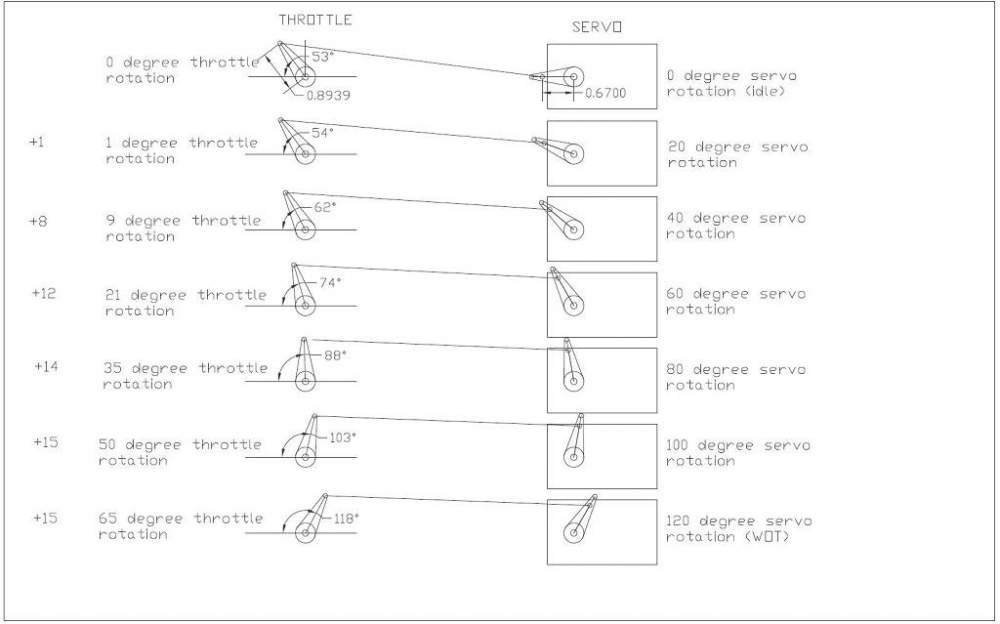

    I think my throttle curve is mostly mechanical. I try to follow this guideline as much as possible for a linear response.
    [​IMG]
    I'm using a Futaba 18SZ, not sure what you system is. I use a splined throttle curve to get the response I desire through the AFR menu. Which usually equates to a gradual increase from idle (so the plane doesn't jump on you during take offs and you can feather a little throttle bumps on landings), a small plateau for hovering so you can maintain altitude, and a steep increase from around 70-100% input as our walbro carbs do not really have much effect there (have already achieved WOT past 70%). If you do a mechanical curve you'll be very close with minor adjustments.
    As for a throttle delay, none. I do have an idle up switch set up, but I rarely use it for this plane. I'm not doing insane aerobatics and this engine has been very reliable for me.
