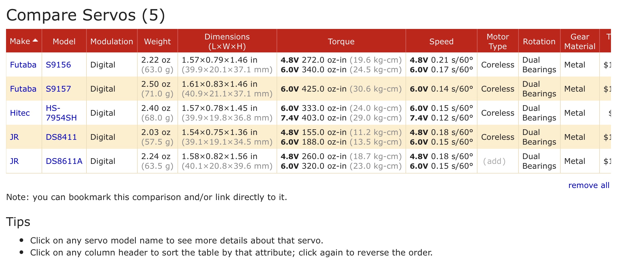

  3. Thank you, I plan on using the recommended arms as well. I hadn't heard of anyone using them yet and was curious how they worked. What sort of deflection numbers are you seeing on surfaces?
  4. Thanks Nick, I hear what your saying about rudder and full span ailerons. I might go a bit bigger on the rudder servo. At this moment I won't be able to run full span due to channel restrictions, only an 8 ch. (For now) I've also picked up a power expander (smart fly competition 12) so I can get (and keep) good voltage (8.4) to all my servos at the same time. Thank you for your help! I hope to work on it this weekend. I'll keep y'all posted!! Thanks again!
    AKNick likes this.
  5. Thanks for the info on the servo spreadsheet! That was great to look at all of them on the same page. Appreciate it!
    WMcNabb likes this.
