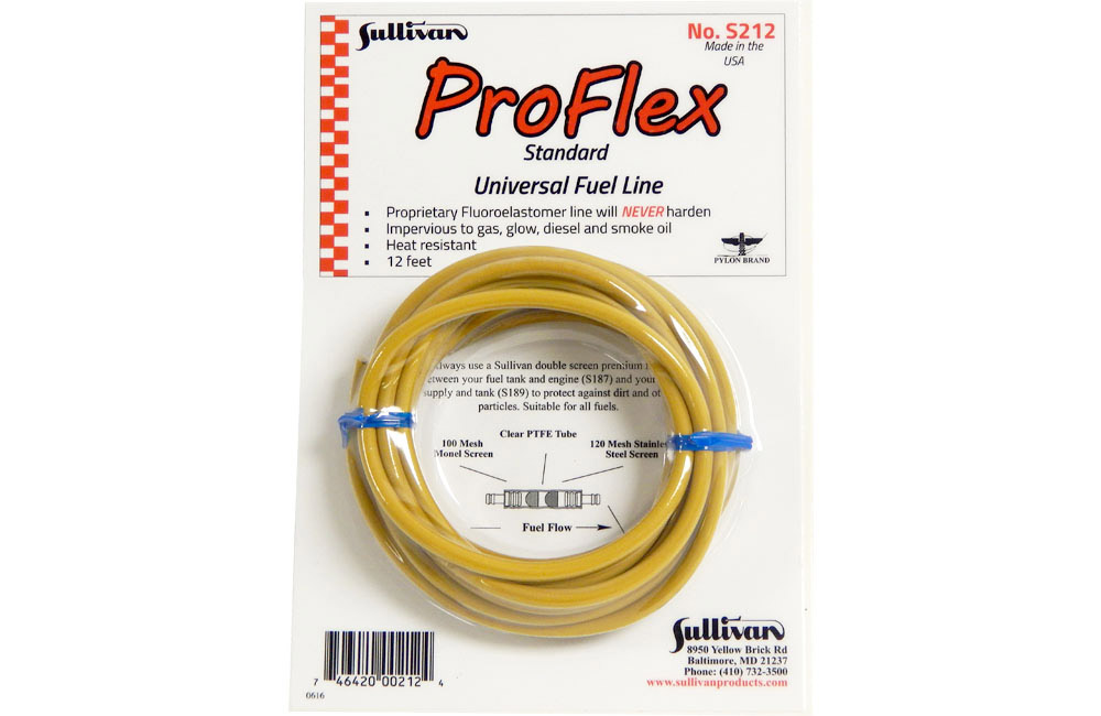

I have a small 10oz tank and re-plumed it with the new Sullivan Pro-Flex fuel line. Seems to be working great but it's not in a 3D plane.
Love the stuff been using it for a couple of year and will never go back to Viton if you do not the correct hardness in Viton it will split and get you in to trouble like it did to me. Cost me a plane.
OUCH! Hate it when that happens. I too have created problems when trying to solve them o_O.

The Sullivan Pro Flex is definitely more flexible than Viton. But if you stretch it at all to get it on a fitting it will split, so mind the fitting size's closely.
Interesting I moved to ProFlex because I had some problems with Viton splitting, I know it has to do with hardness, but have not seen any difficulties with the ProFlex up to now but will keep an eye on it now that you mentioned it.
