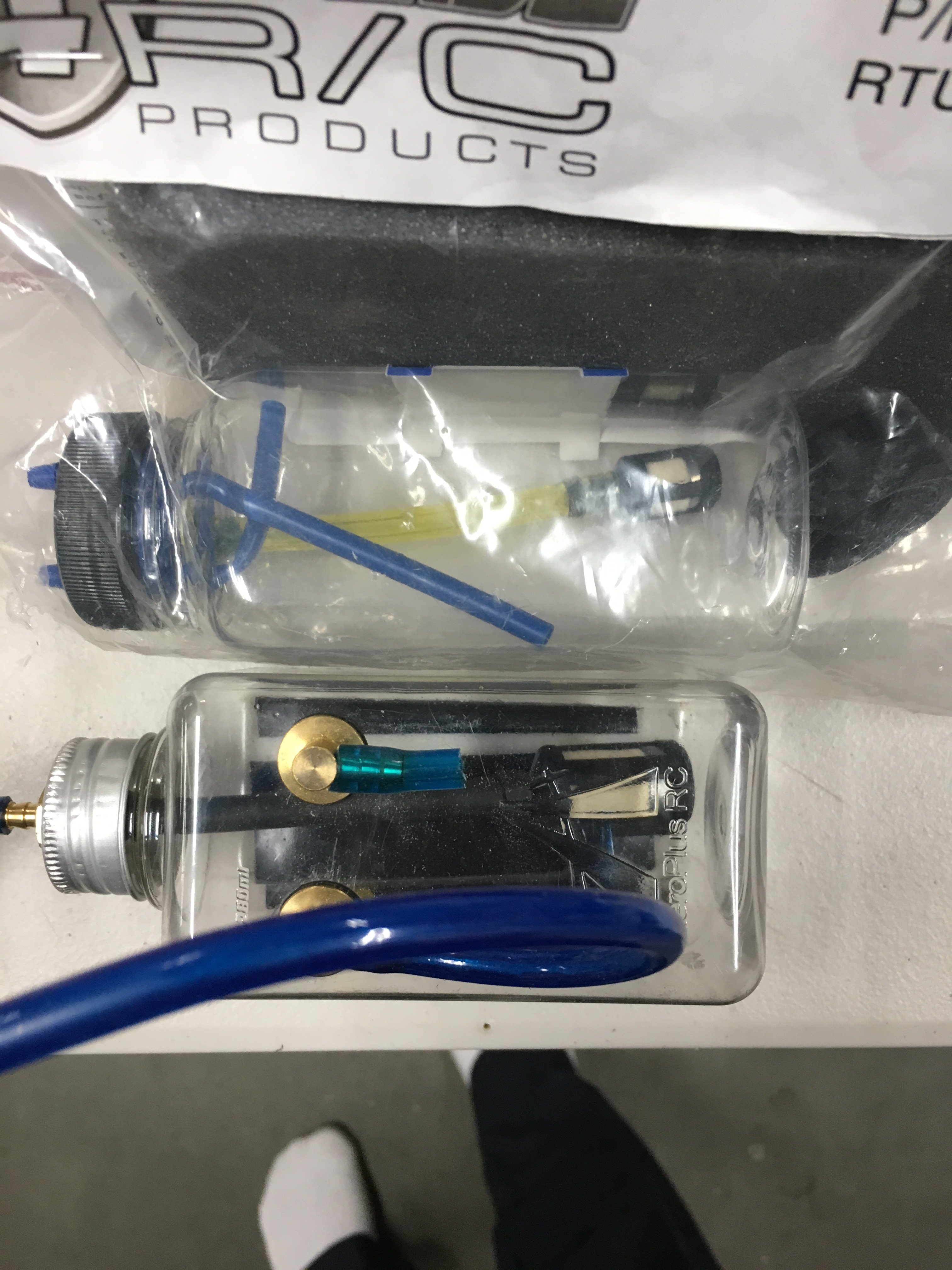

Also here is an 8oz fortitude tank next to an AeroPlus tank.

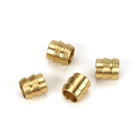

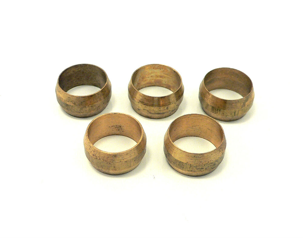

Instead of using barb fittings use compression ferrules. Soft tubing will slide right over with out splitting and any tension on the ferrule will not cut into the tubing like barbs can.
