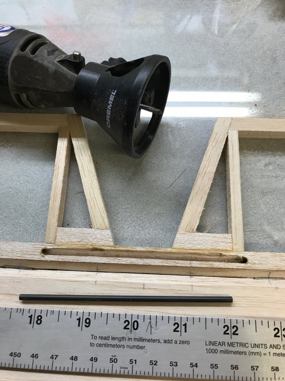

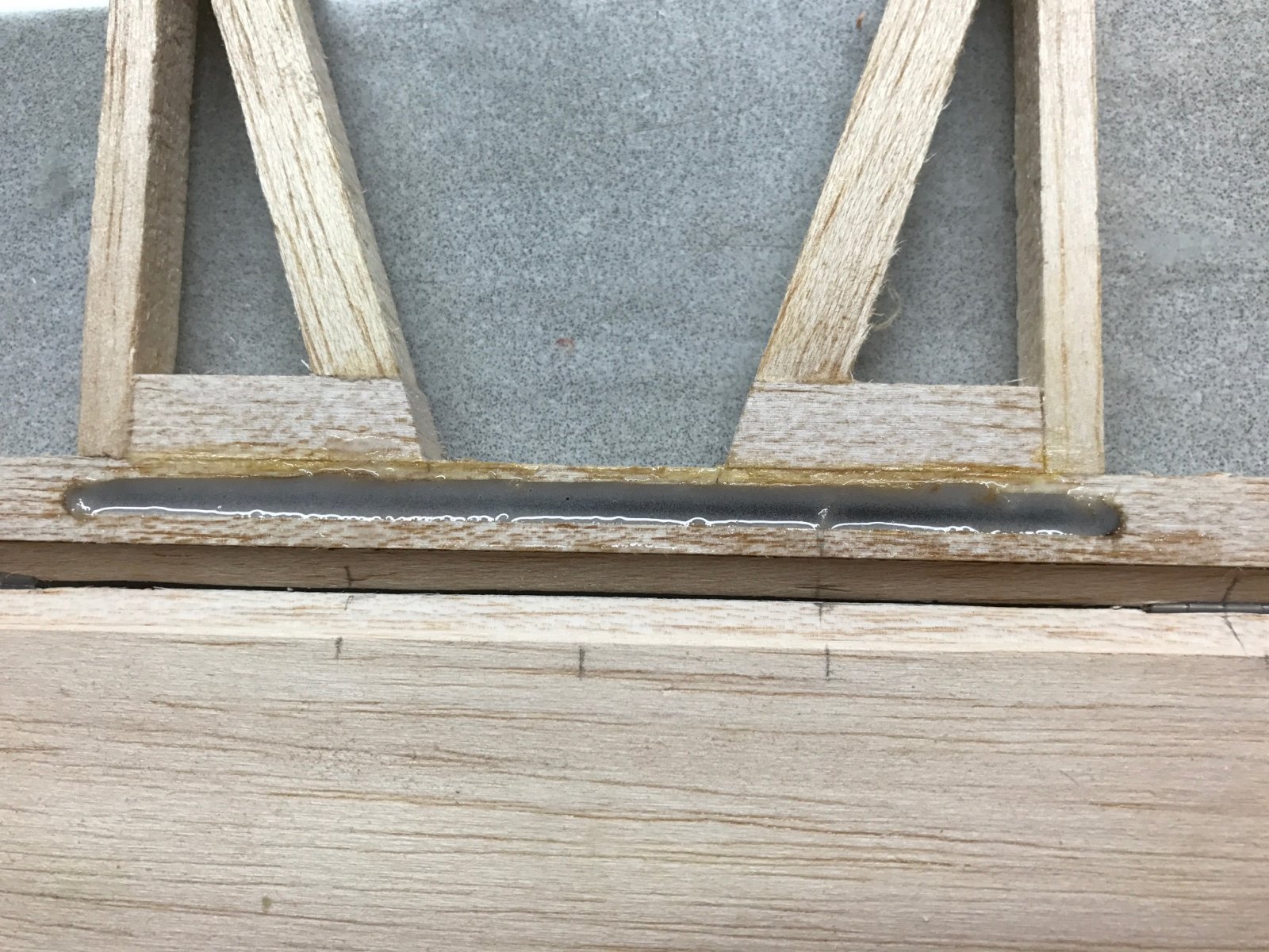

  5. BalsaDust
    BalsaDust Moderator
    Used my dremel tool to rout a groove in the elevator right where the two halves meet. Then epoxied in a 1/8" carbon rod.

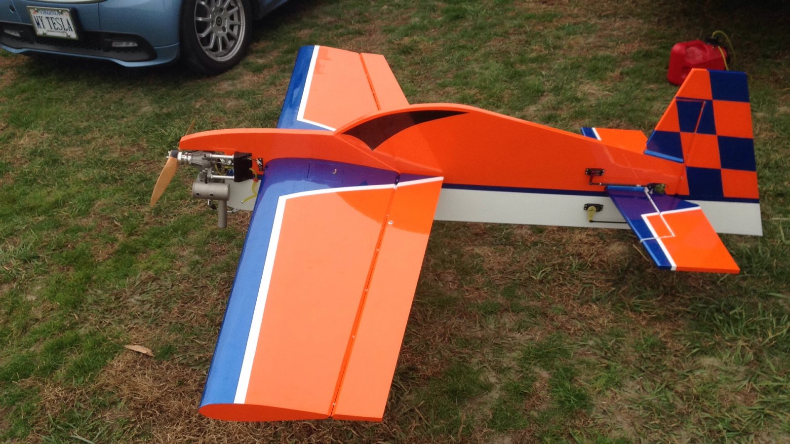

    Have a question have ever given it any thought of making the slab fuselage out styrofoam sheet and then sheeting it.
  8. BalsaDust
    BalsaDust Moderator
    IMG_0343.JPG I did this one that way. Thought about it on this but I decided against it. The way I fly on 20cc and smaller I fly them hard and dork them a lot. A built up fuse with a tube is easy to repair after a dork where as the foam fuse will not be.
    Pretty much a guarantee that anything 30cc and larger though that I build as a slab will get a foam fuse.
    I can link my probro build thread for the big edge if you would like to look at it.
    Alky6, 49dimes, Snoopy1 and 1 other person like this.
