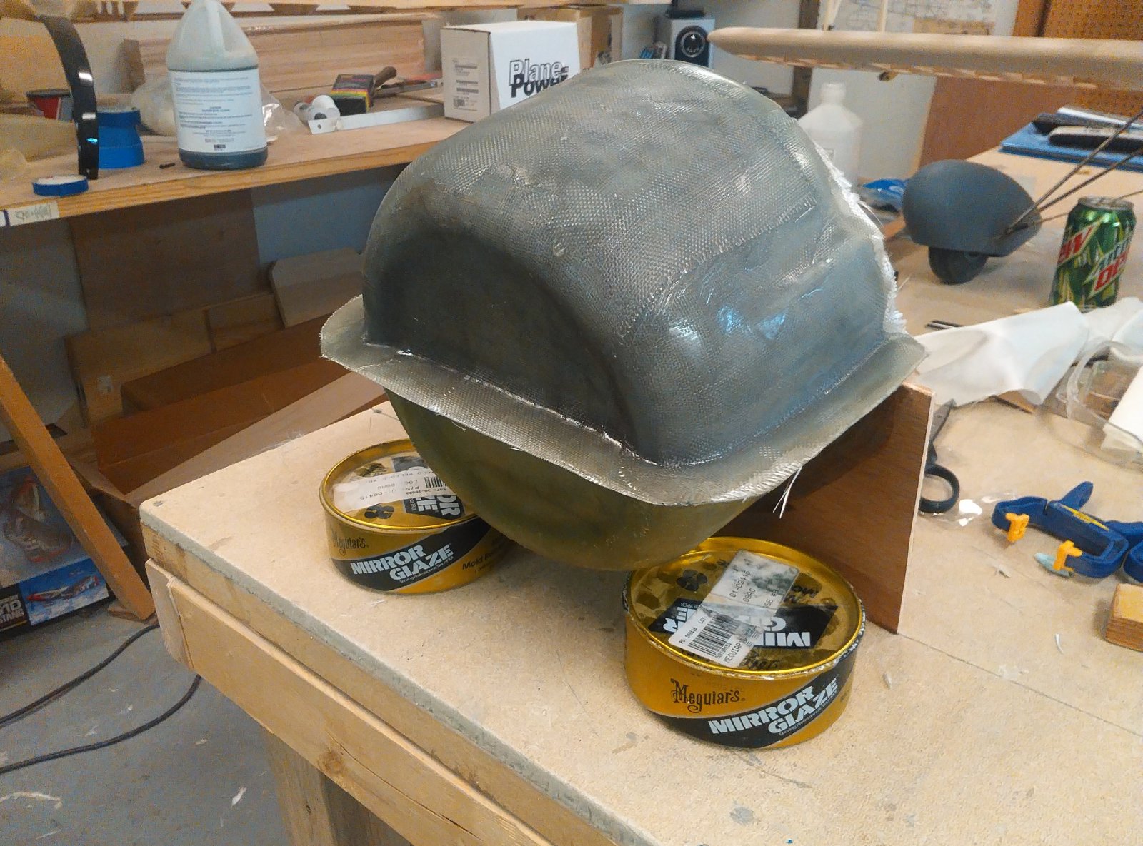

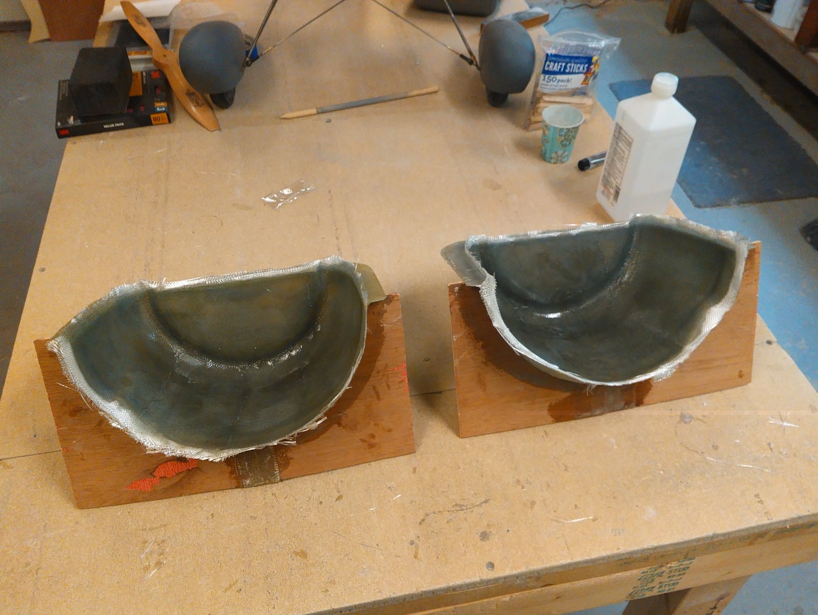

I have an air wedge, which freed up most of it but it was just stuck to hard at that one spot. I'm suspecting that there was a pin hole there that I didn't see and the resin got down to the cloth on the plug and grabbed it.
I was wondering if you might need to stiffen the mold some as it's fairly large.
Doc
If I wasn't as cheap and got some 9oz Rutan Cloth and put 6 or 7 layers on it I could have got away without the wood brace. But I have a bunch of 3 to 8oz E-Glass so it gets a wood brace lol

Yeah it takes a lot of glass sometimes to make a large mold really stiff and like you said the ply works and saves some materials(money). Sometimes that aerocell stuff can help but I'm no expert.

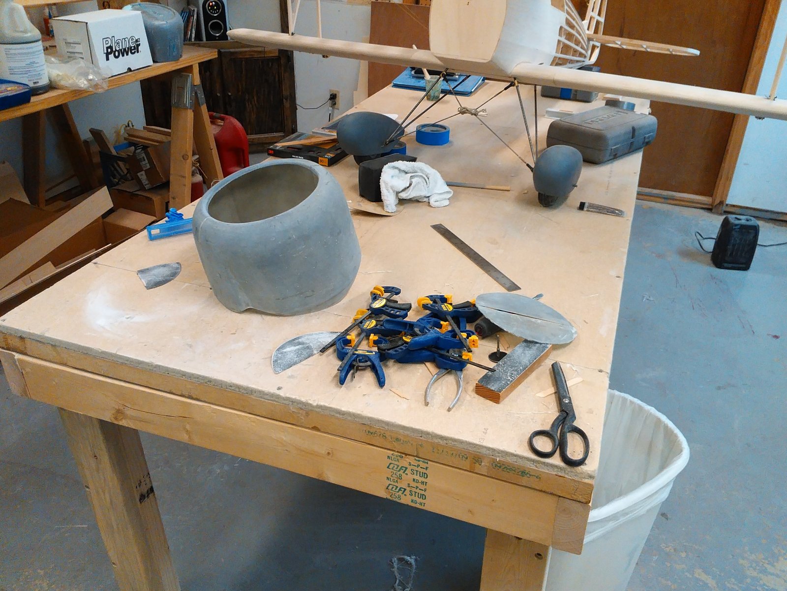

Huston we have a cowling!
After some headaches with the mold and the resin I used to lay up the part I finally have a cowl. So the resin issue was I used non waxed polyester resin and couldn't get it to fully surface cure. after a couple of hours reading on some Corvette forums I learned that if you cover the sticky resin with some saran wrap it to seal it off from the air it will surface cure. I thought that just heat would cause a cascade effect to cure the surface. Guess you learn something new everyday, like I'm going back to using vinyl ester resins lol.

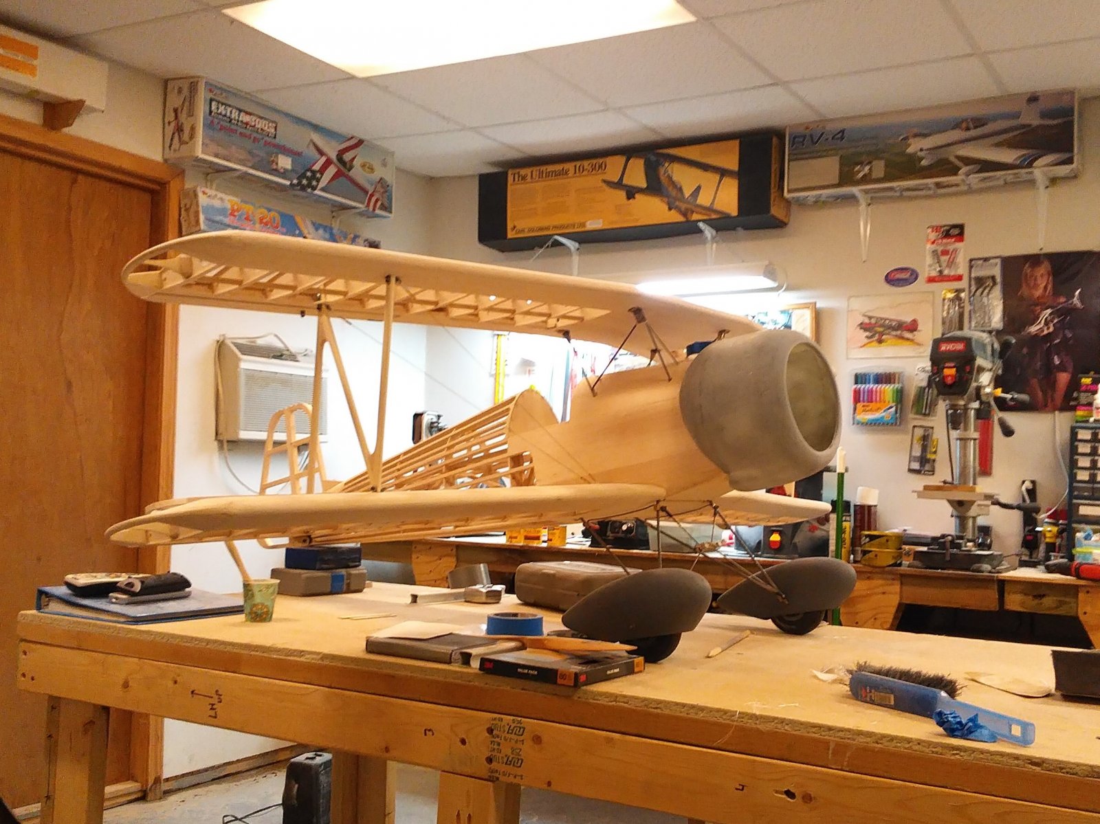

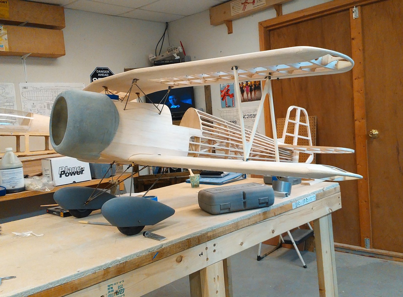

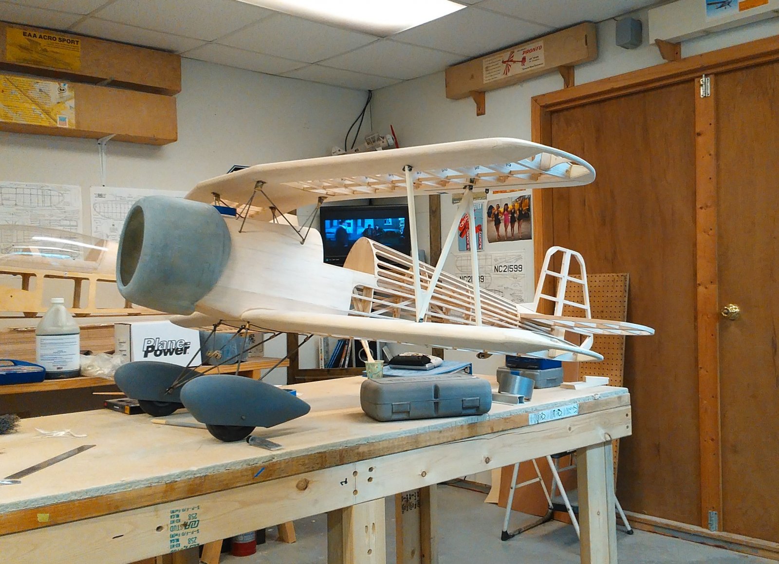

Then I mocked the cowl up on the fuse and about had a heat attack as it looked like crap to me, just seemed like it didn't fit correctly in any direction, and looked like a tin pot slapped on the nose. I was starting to think I was going to have to start over from square one. Then I got the ruler out.
I realized that the cowl was sitting almost a full inch to far forward, I pushed it back to where it was supposed to be and wahlah!

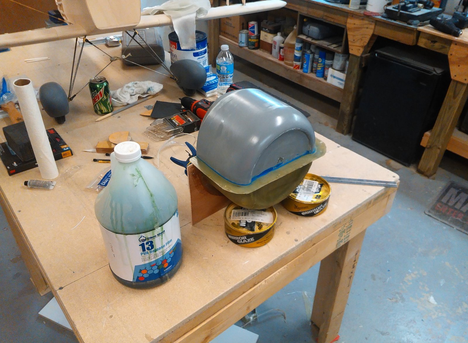

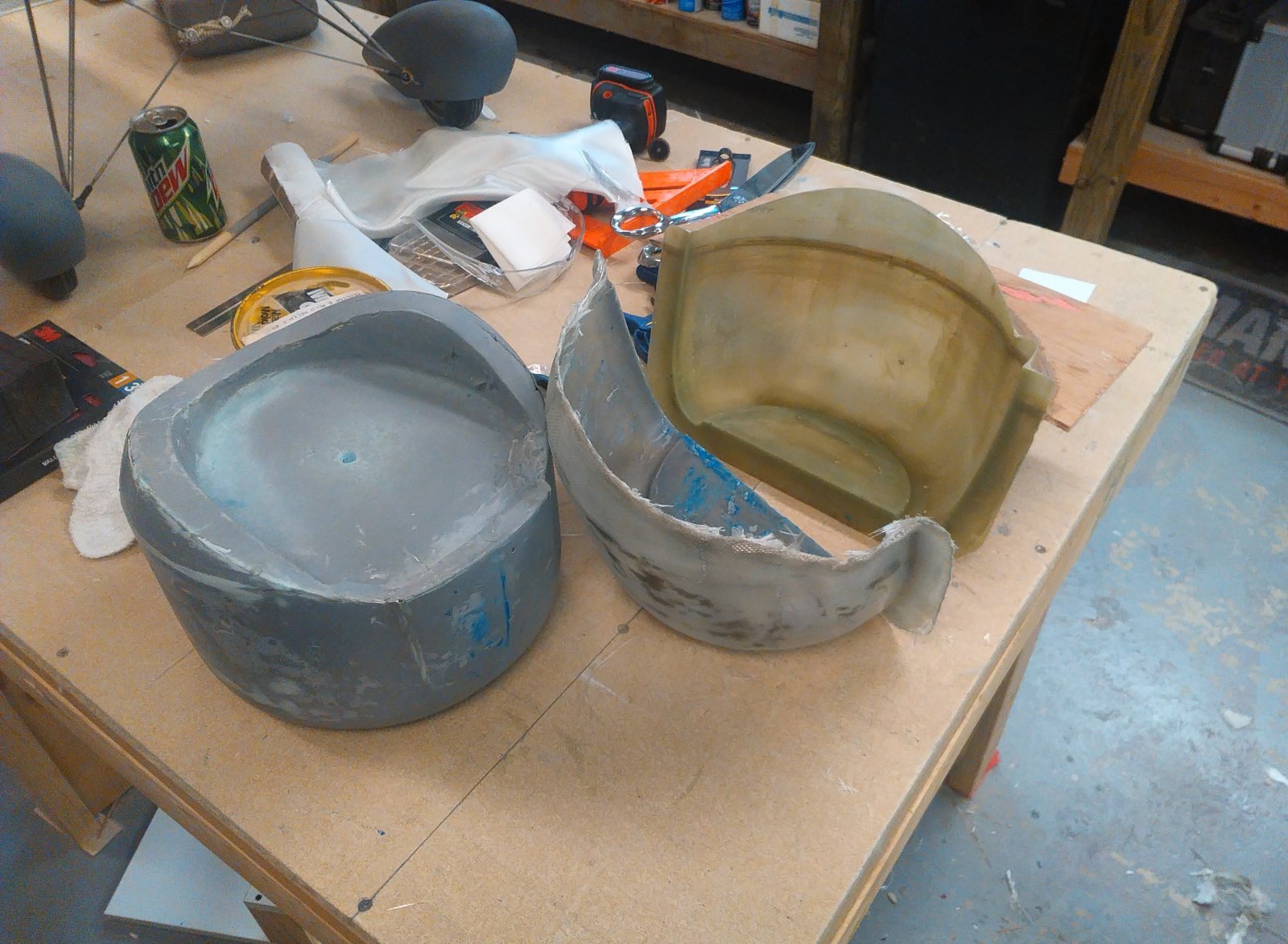

Getting ready to lay up the second half of the mold. After the release problems I had with the first side, I broke out the PVA, even though I hate the stuff! lol
Second half of the mold laid up and curing, I laid up the second half right on top of the first half.
Second half pulled off the plug, still had a little stick but nothing a credit card blank wouldn't scrape off. After this It was just trimming, wet sanding and waxing.
The cowl halves are laid up and curing, I fist brushed some resin and thixo into the mold to make a gel coat and then used 2 layers of unidirectional cloth on 30 degrees followed by 2 layers of bidirectional.

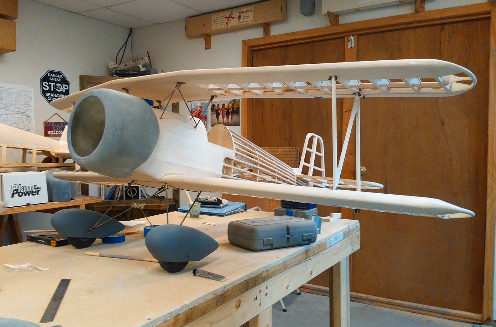

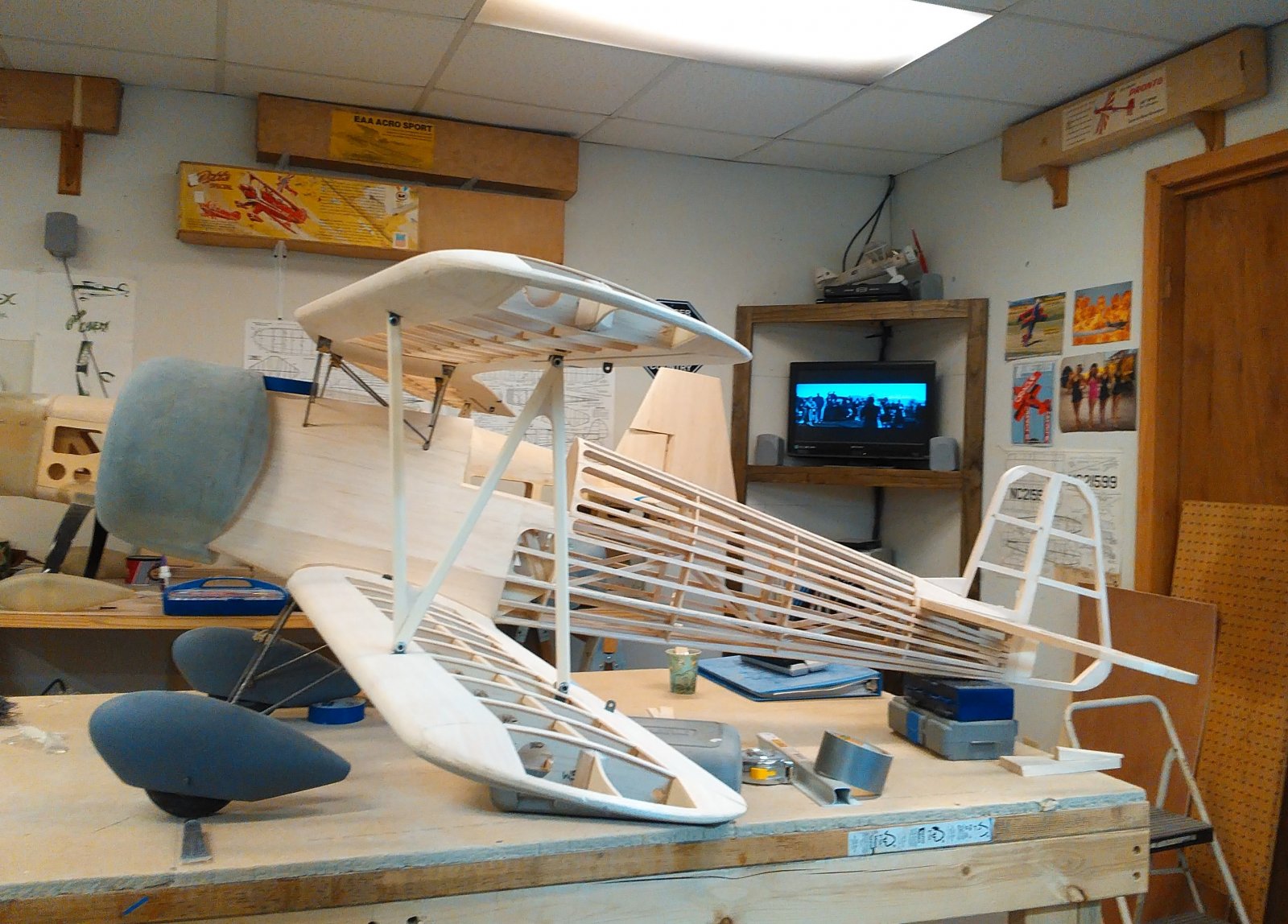

Cowl out of the mold and joined. These 2 pictures are before I found that it was sitting forward almost and inch to far. At least to me the cowl doesn't look like it fits the rest of the airplane, looks way to big until I pushed it back were it belongs.
With the cowl pushed back where it belongs, now it looks right! And now I'm quite happy :D
