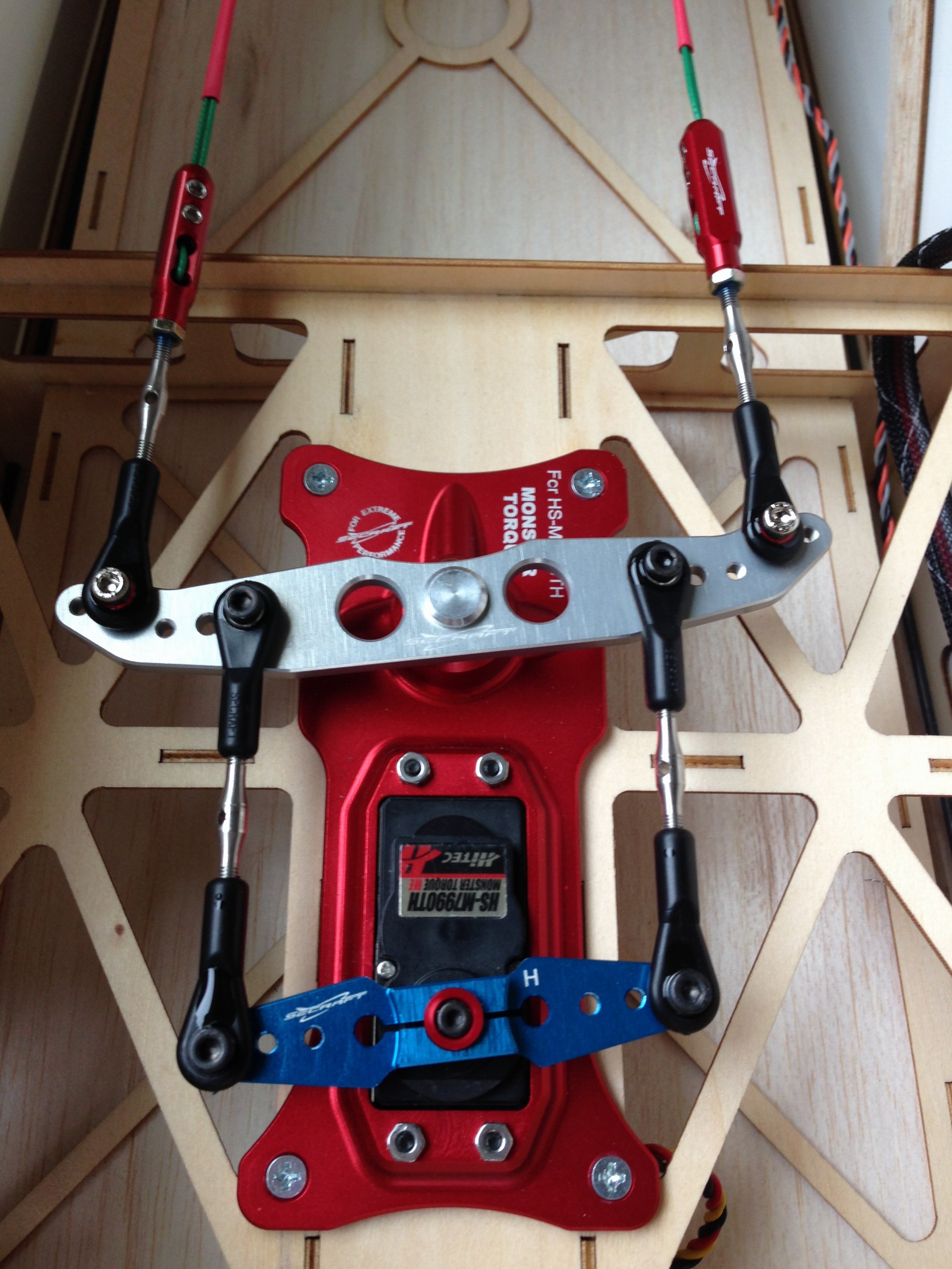

Last night I completed the rudder setup and I think this is one of the best Rudder setups I have done...Also neat and clean...I am happy with it...

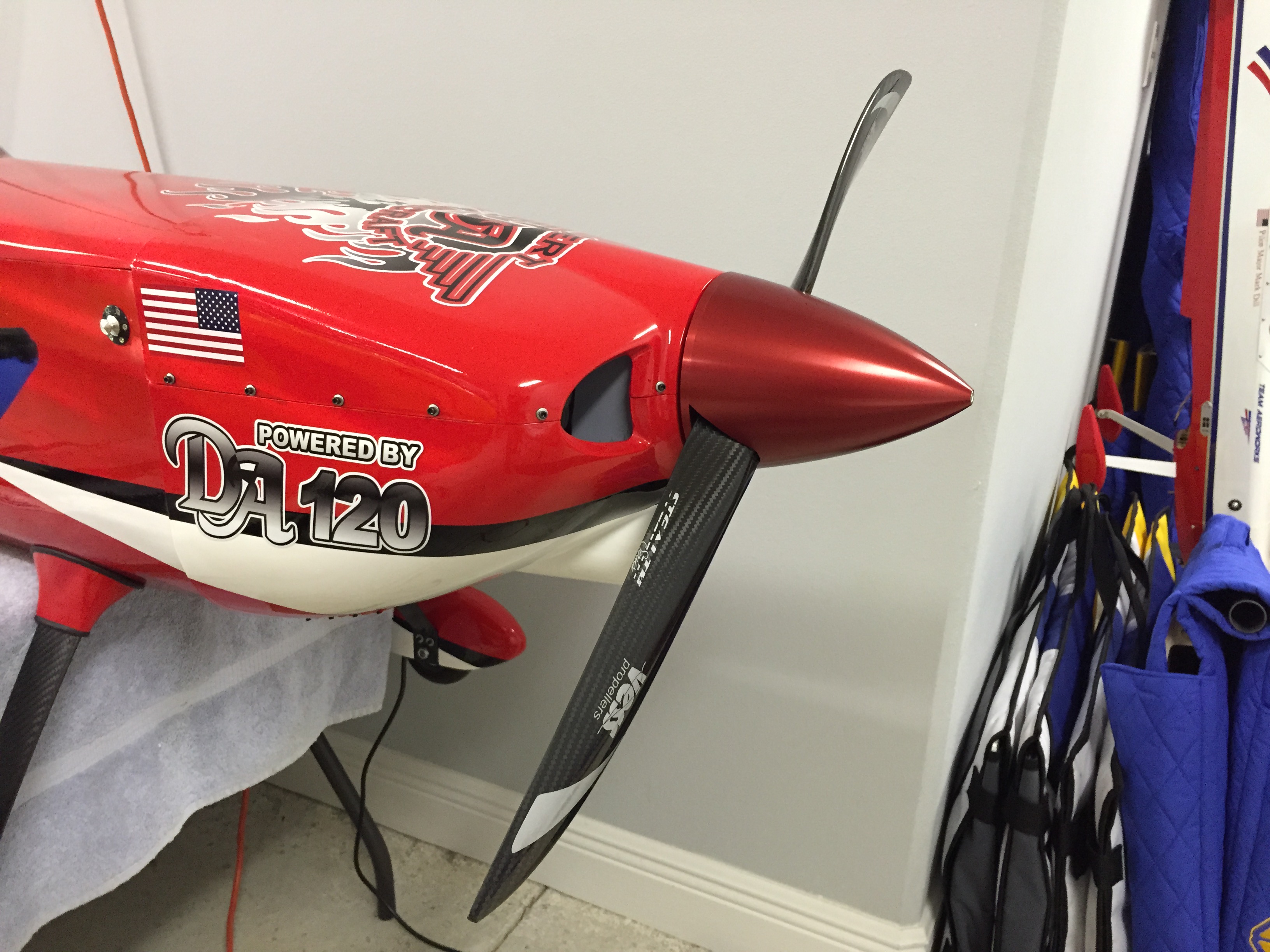

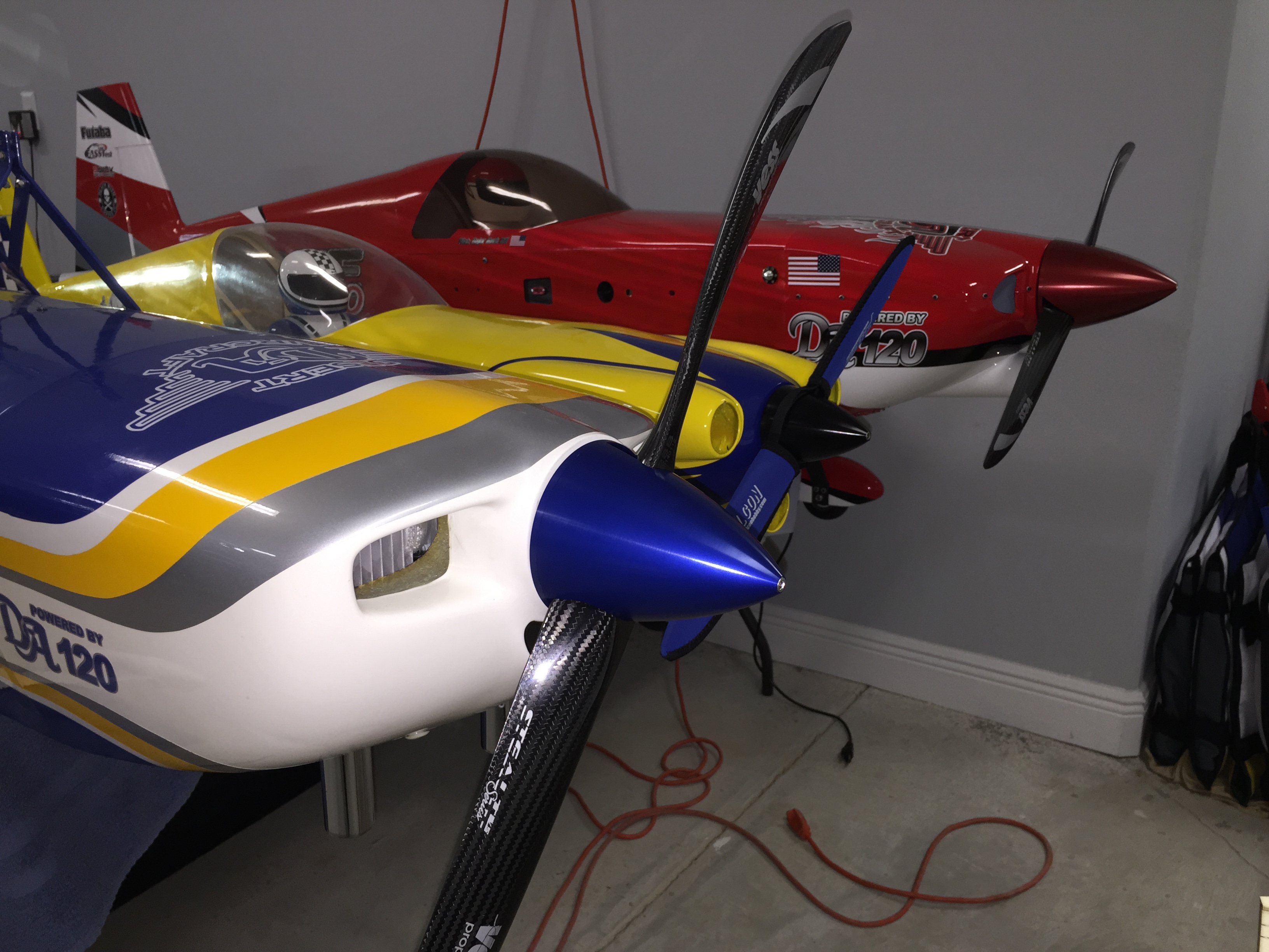

BPS00-3W is hand written on label. I think..see for yourself...Engine building trumps Penmanship
I just called DA direct when out of town and said DA-120 drilled 5" TureTurn back plate....took my address and CC number. When I got back in town it was at the house. I freaked a bit when I saw the part number was BPS00-3W and check fitment as soon as posiable. So don't freak with the 3W in part number....I thought it was for a 3W.

You could get a BLACK anodized back plate to match a bit better if desired as well, FWIW. They stock the various colors. ;)
I ended up swapping out to a full Tru-turn in red. Just prefer them...as you can see. :p:cool:

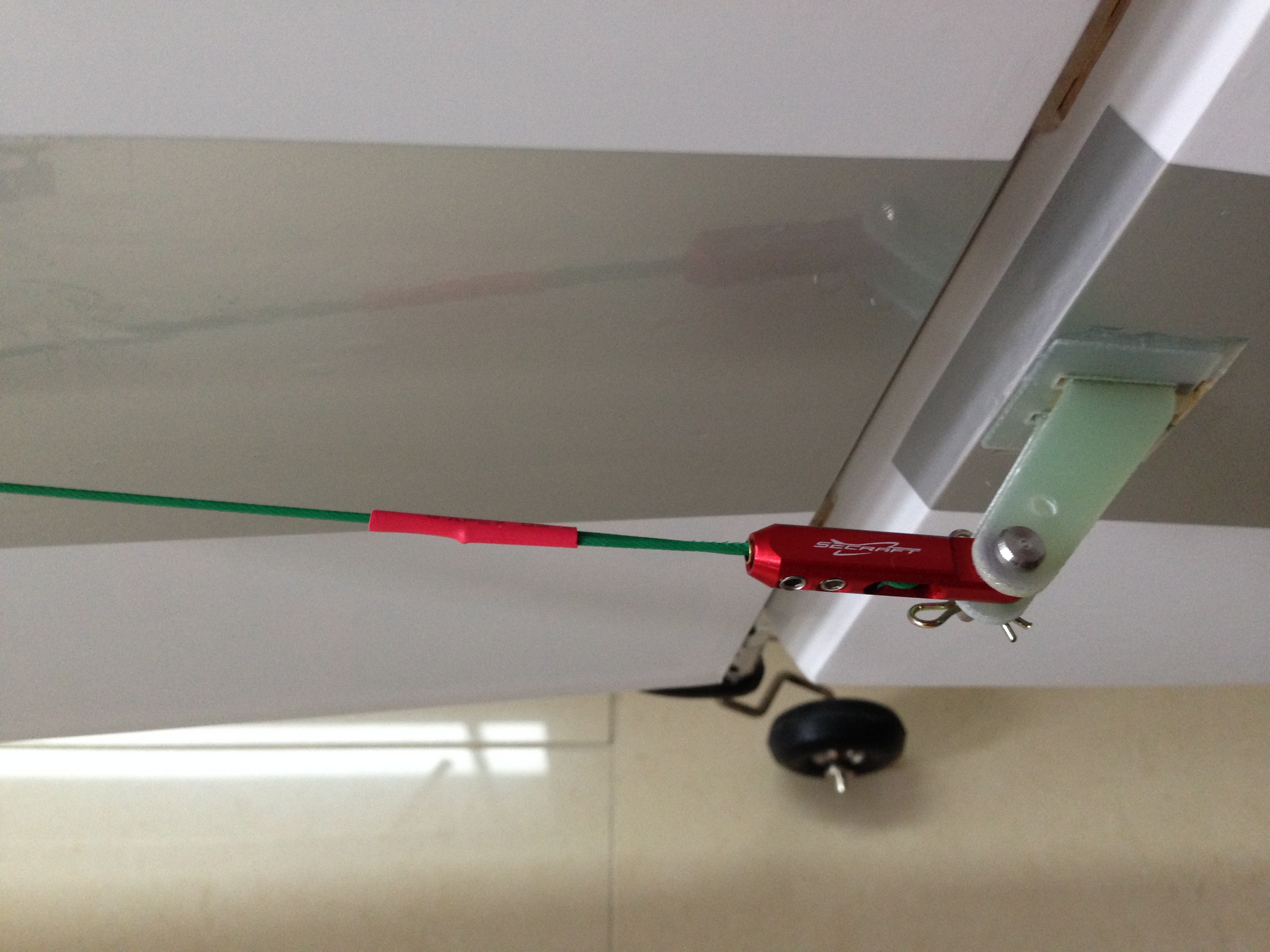

Charlie,
It's probably overkill, but I place a small flat washer on the top and button of the removable rudder pin, and for spacing I put one in the middle. This keeps the control arm from having to pinch down on the secraft coupler... Can't tell from the pics if yours are pinching at all.
That rudder servo looks awesome.
-G
Yowzilla
Thanks for the tip Gary...With these Secraft rear rudder setups you have the choice to space everything out or use both cotter pin holes. The cotter pins are loosey goosey and practically fall out. So I am set up now with two of the cotter pins. With that said, I am getting some squeaking door sounds going on in rudder area. I wonder if it is the phenolic horns that are tapered to use the upper pin hole. I will set up with washers to see if the old house squeaks go away.

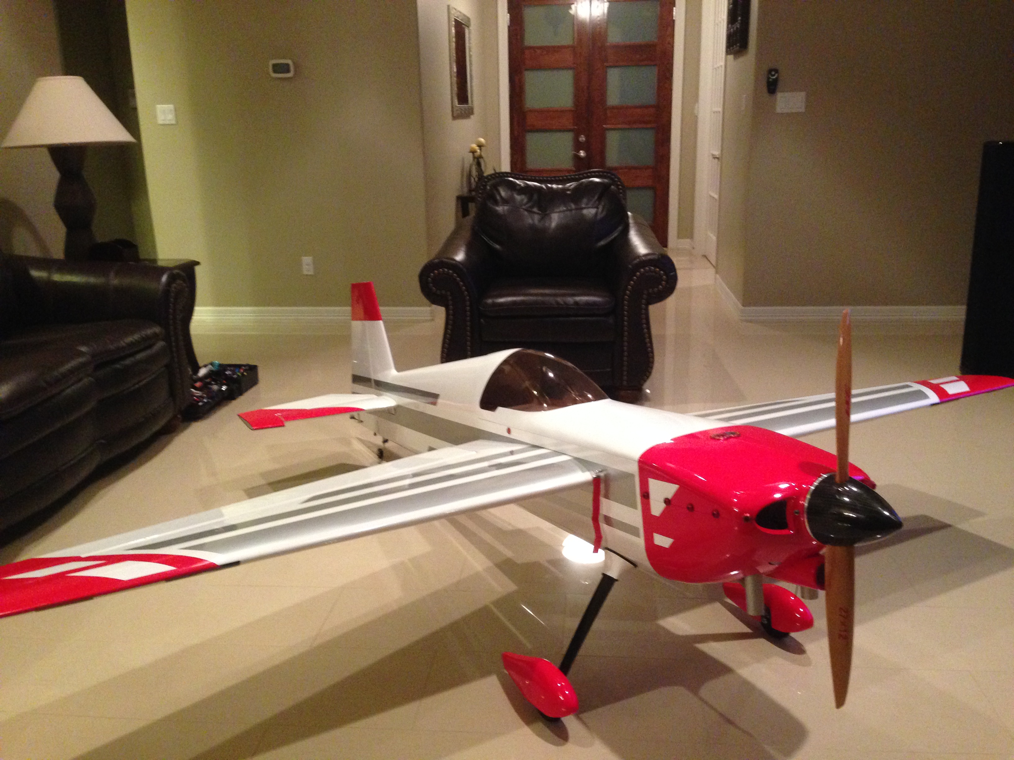

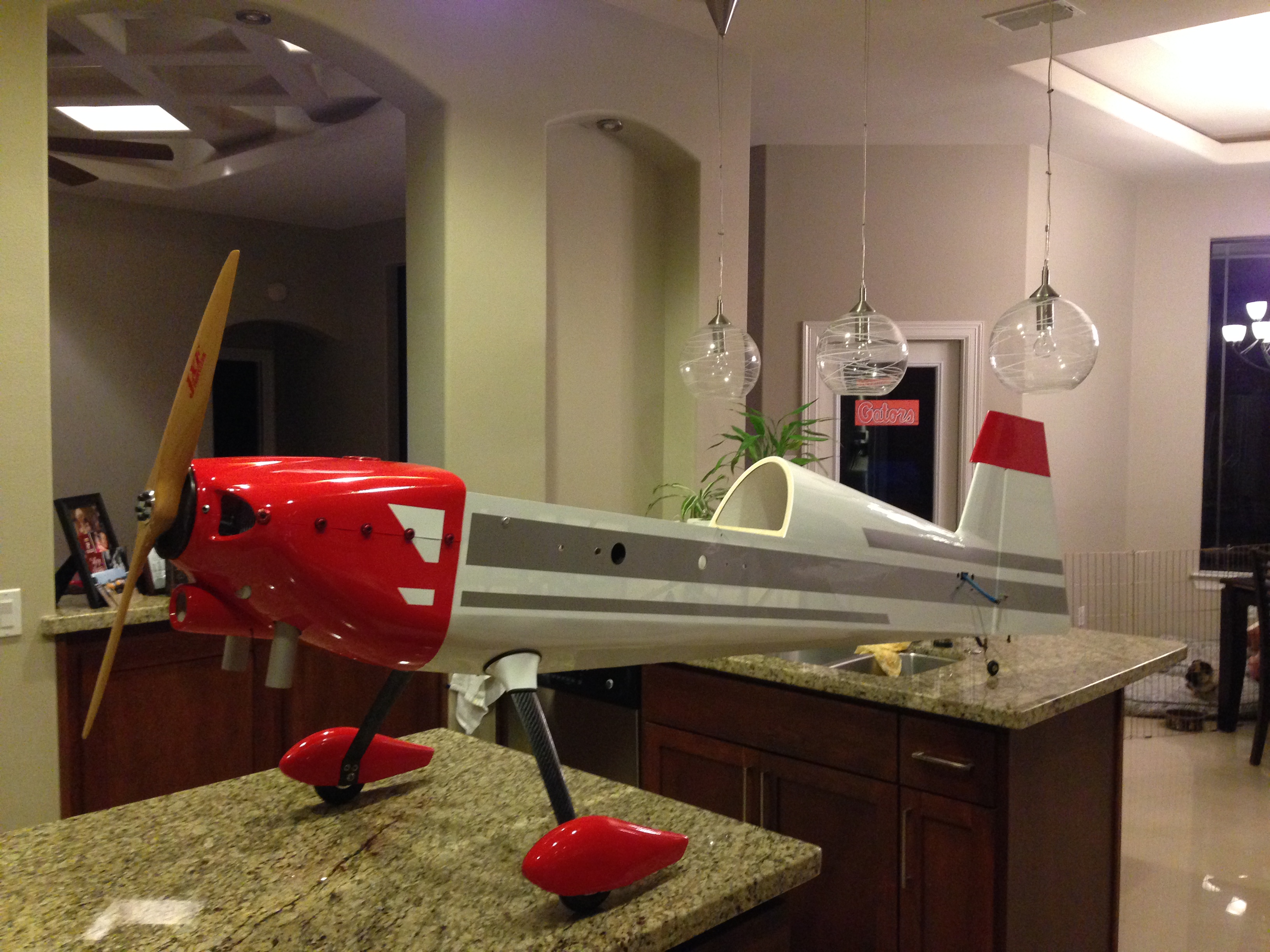

Finally DONE! This thing is amazing in size. Pictures do it no justice. It truly is an amazing looking aircraft.
I am still playing around on the vinyl locations. I will most likely get a handful of flights before I cover up the clean lines...

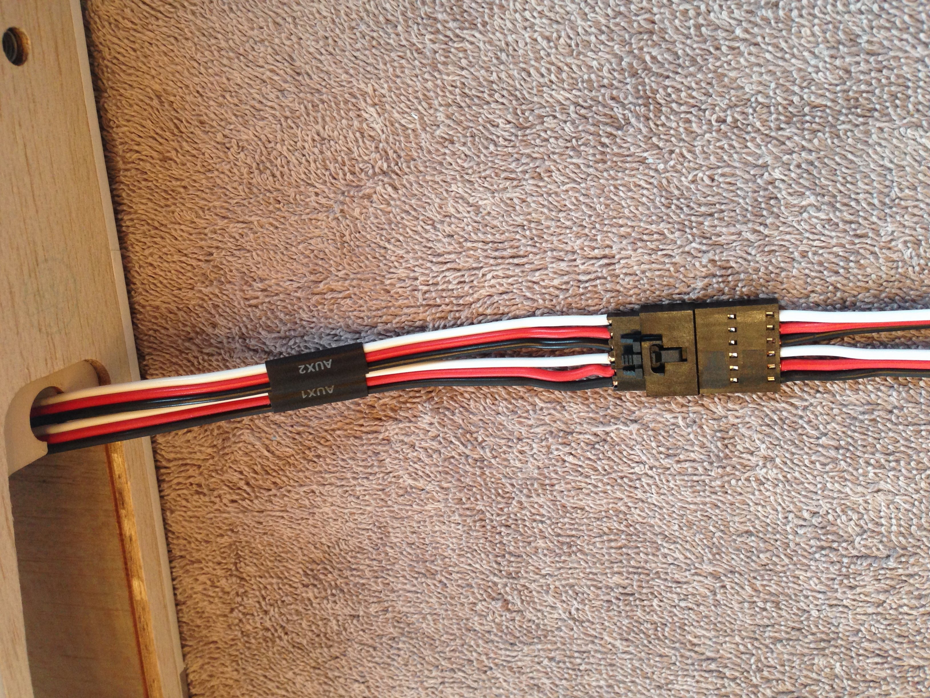

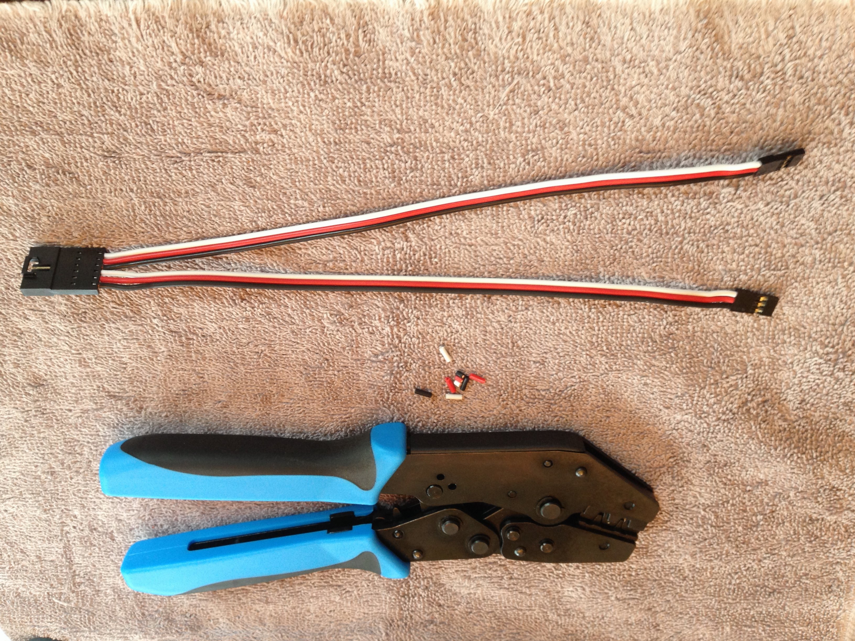

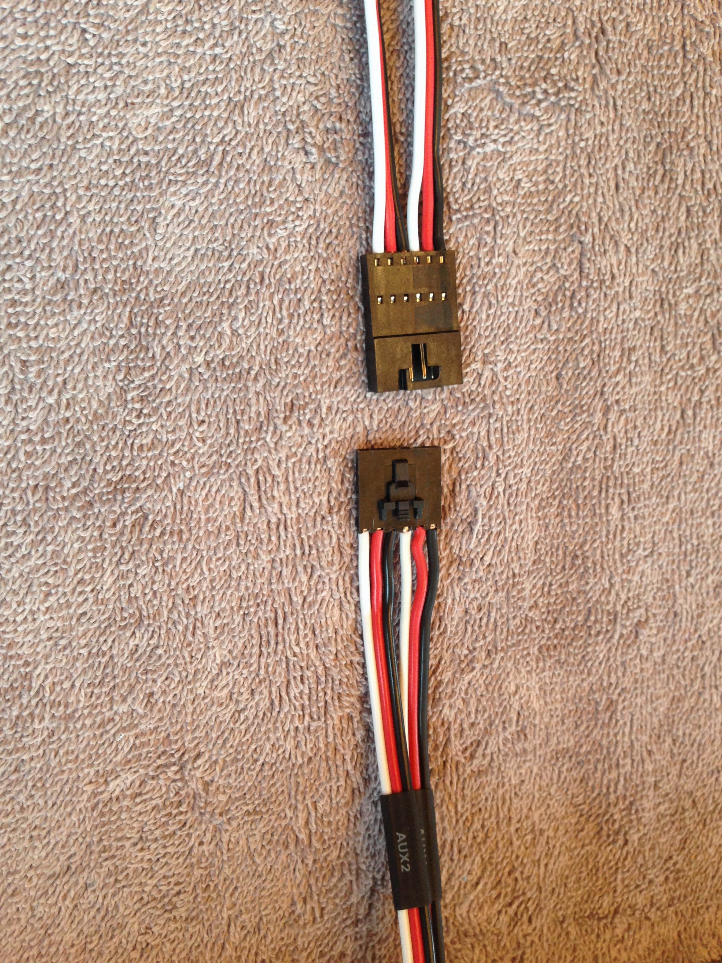

Sorry I keep posting but wanted to show you guys the servo extensions I made using the Hansen Hobbies 1x6 and 1x3 connectors. A little work to make but makes it super simple to connect the two servos for Ailerons at once.
The rubber grommets are not shown in picture but are in place on each wing now.....I know someone will catch that...

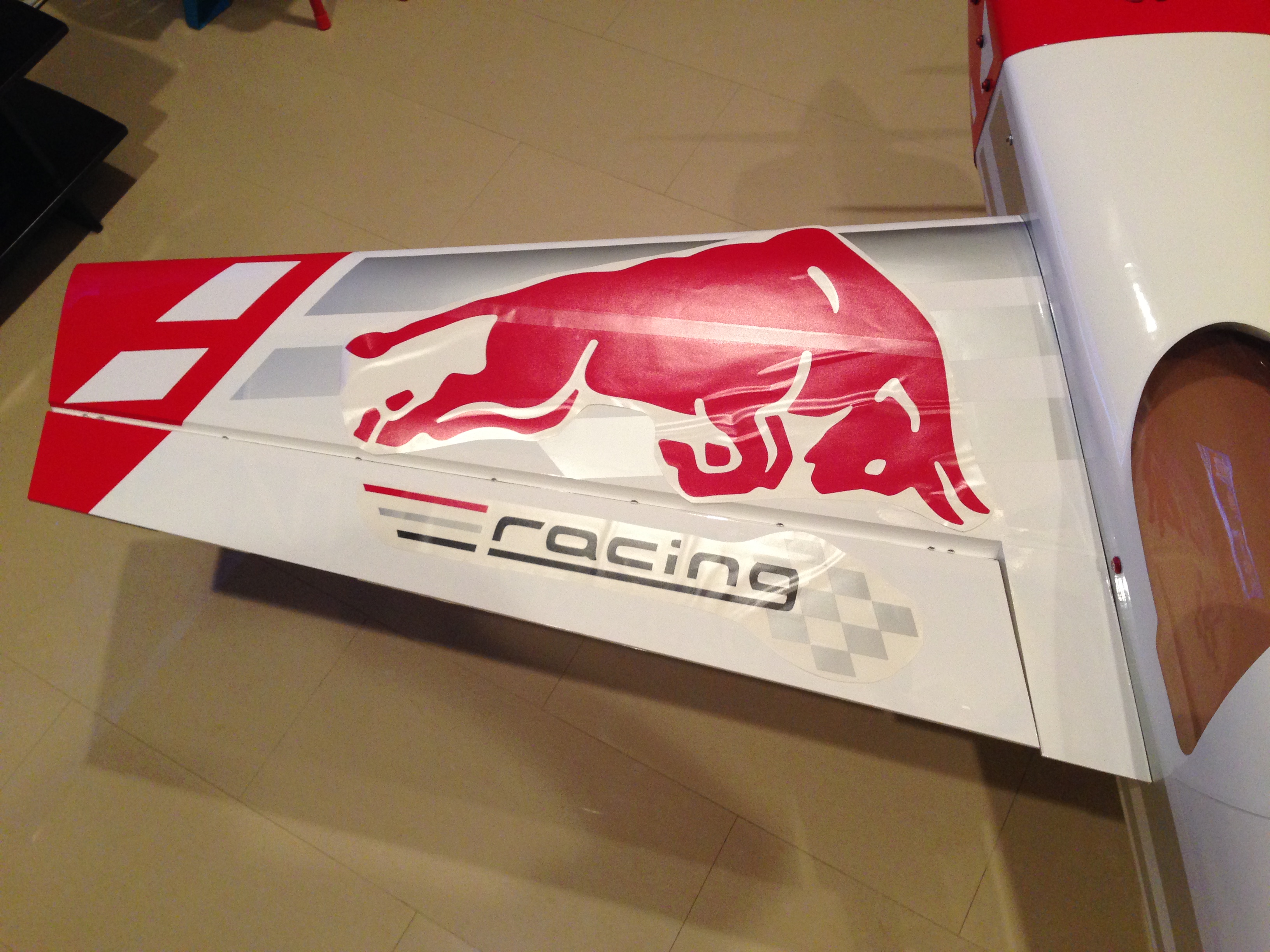

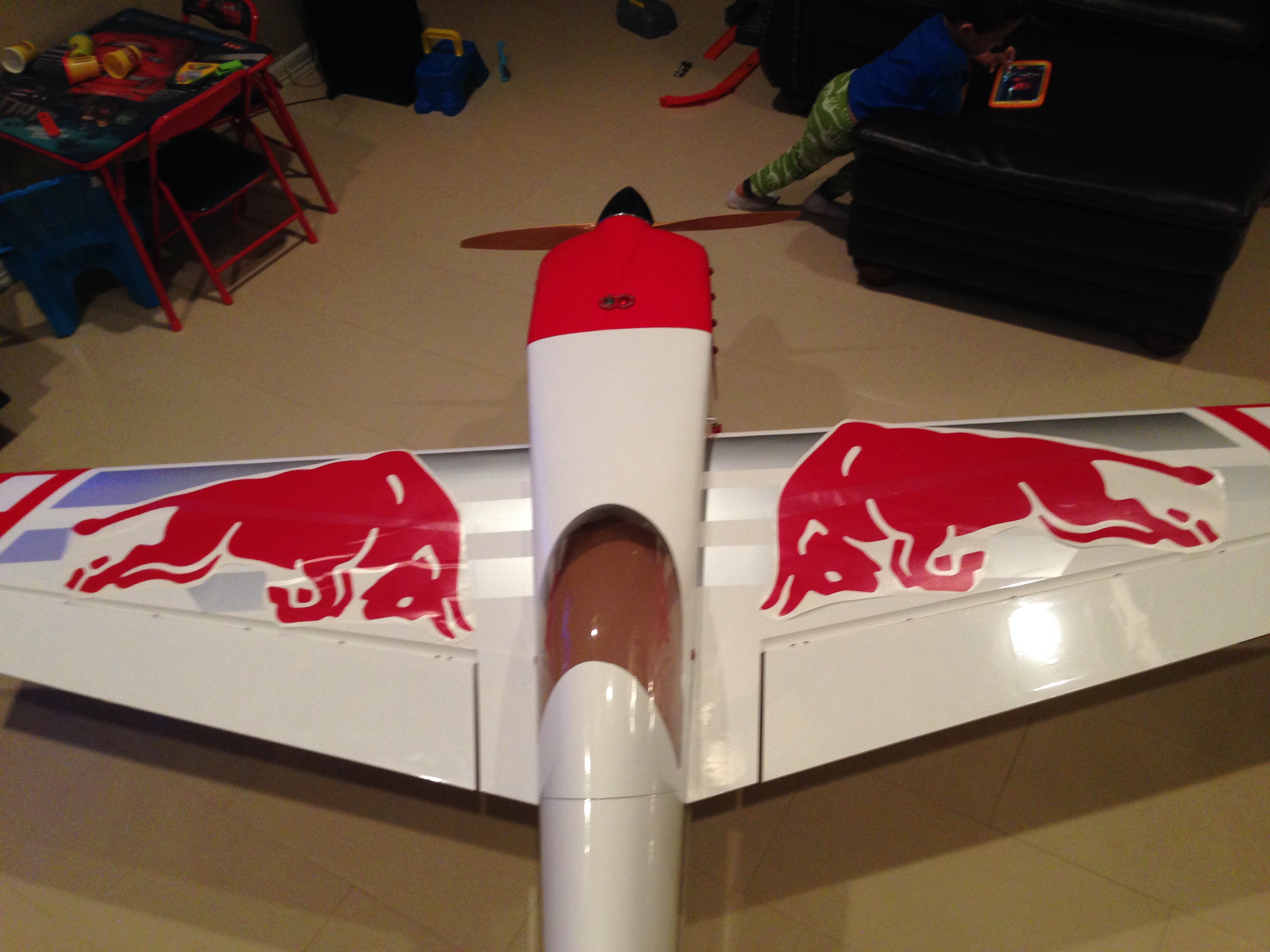

Yea I did the Bulls on my white 92" with inspiration from Supatims 92 last year. I am not sure if it is just the size or indoor light but the silver stripes pop a lot more and while I will make this my plane at some point I want to live the stock look for a bit.
