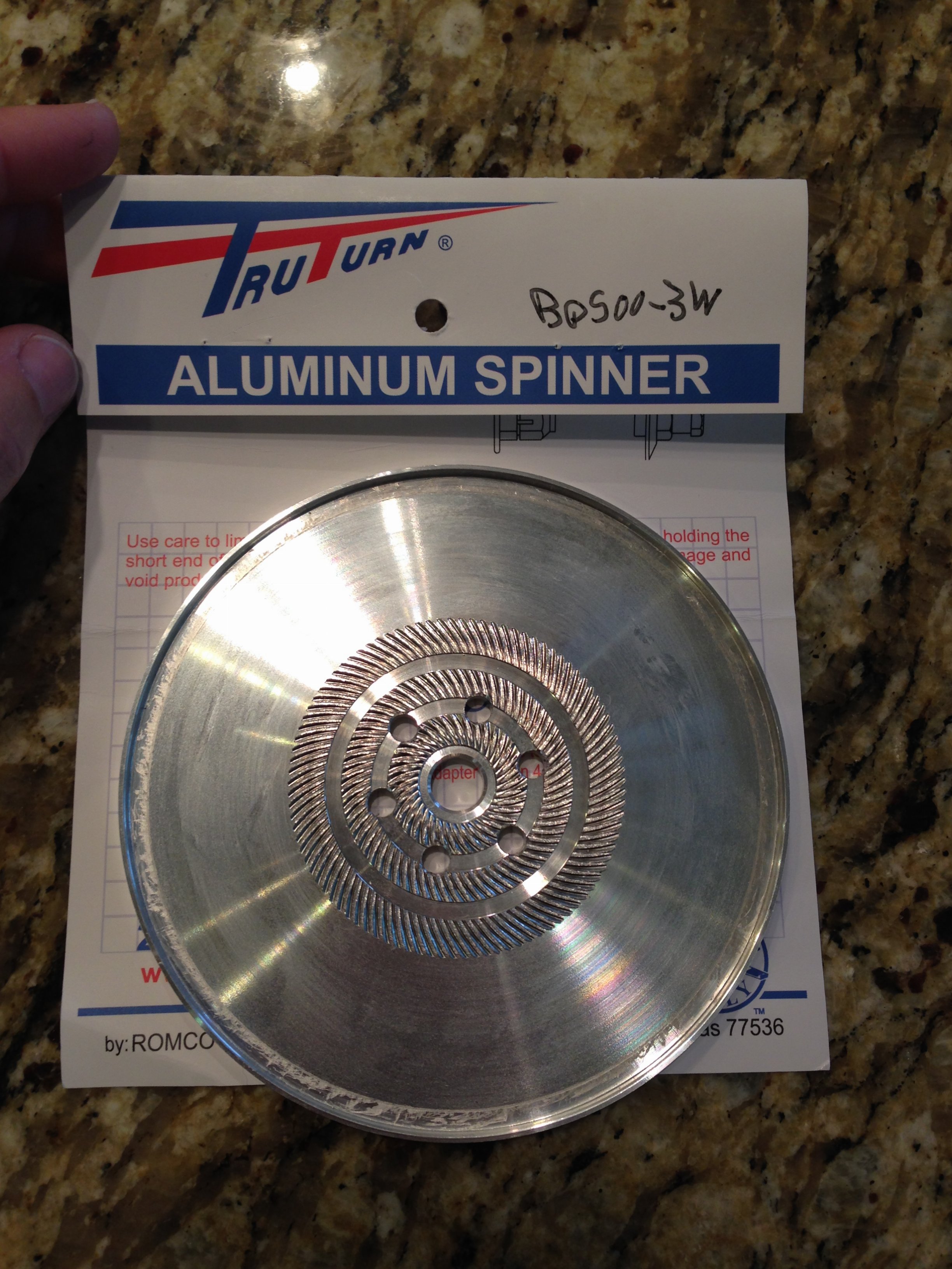

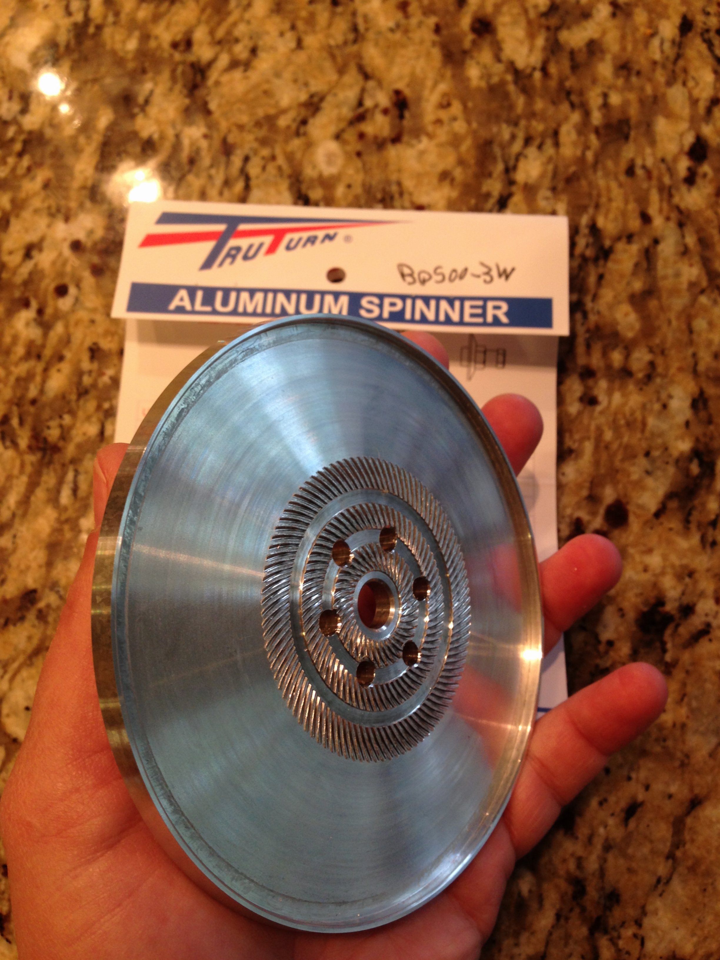

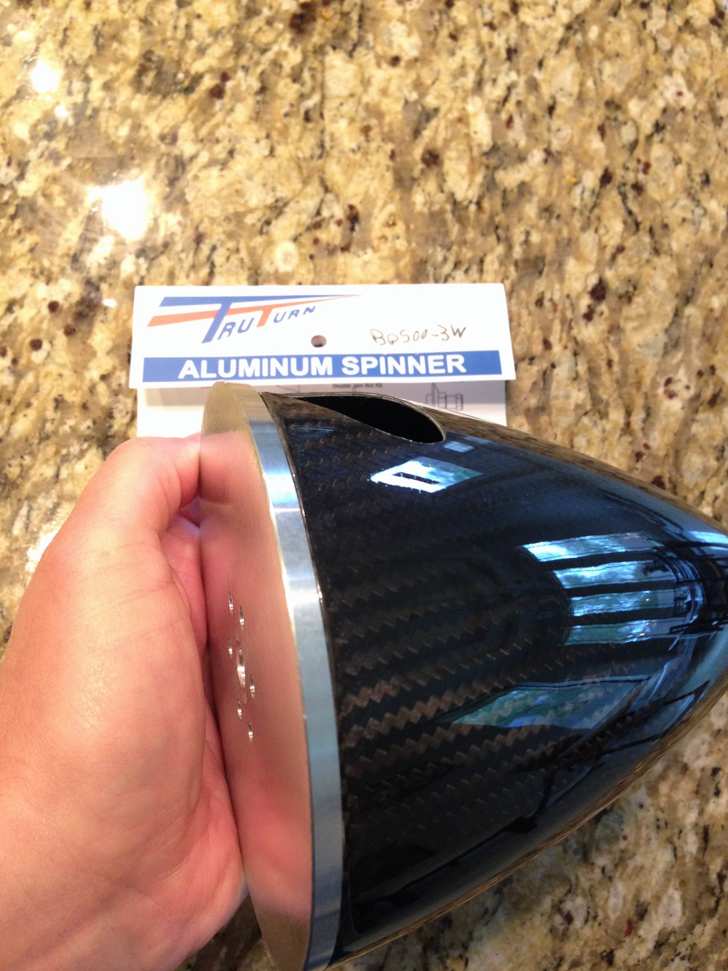

It looks like both of you have the stock carbon spinner back plate. Over the holiday I read too much on carbon back plates that I freaked myself out and purchased a 5" trueturn from DA. FYI- Fits perfect with the 3DHS kit included carbon spinner.

So what is the story with the true turn back plate? (or did you get the whole spinner?)

The FingGiants forum has tons of horror stories about twins and carbon back plates throwing a prop or loosing spinner into wings along with years of opinions. From what I gather it is a chain reaction. The most credible guys seam to say the engine heat breaks down the carbon back plate layers, so prop bolt loosen, so prop shears bolts.
My take is a carbon back plate will work if quality part. But it is easy to mess up on one of the many process steps to a quality carbon part. Epoxy chemistry and ratio mixing, layup, vacuum, oven temp...bla bla bla....
On my experience side as a engineer that glues things together. Most if not all epoxies can not take 350F. I assume layers of carbon increase that number. But anyway...I got conservative and purchased a $32 Aluminum TrueTurn back plate...and plan on using nord locks on prop bolts...

BPS00-3W is hand written on label. I think..see for yourself...Engine building trumps Penmanship
I just called DA direct when out of town and said DA-120 drilled 5" TureTurn back plate....took my address and CC number. When I got back in town it was at the house. I freaked a bit when I saw the part number was BPS00-3W and check fitment as soon as posiable. So don't freak with the 3W in part number....I thought it was for a 3W.
