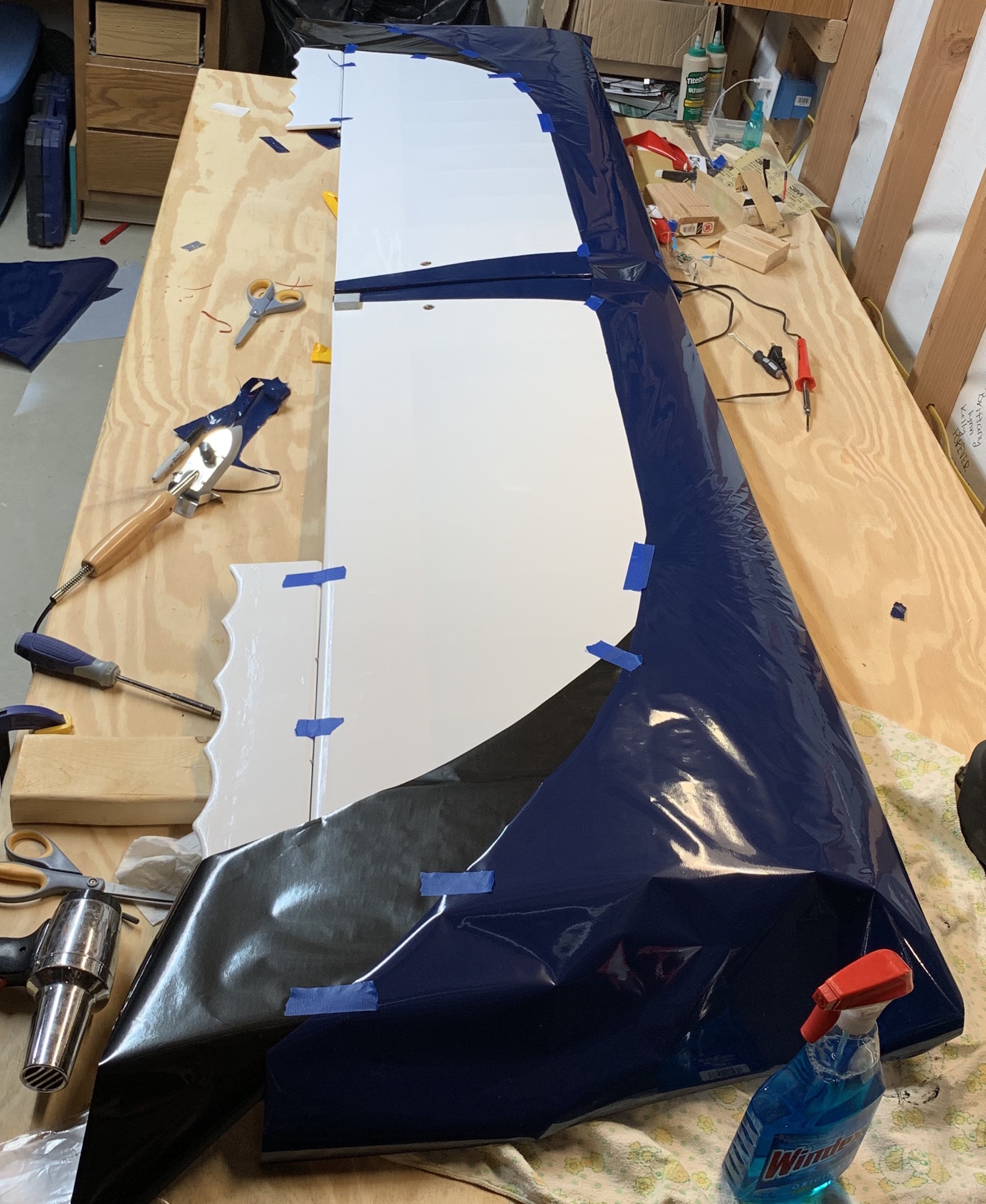

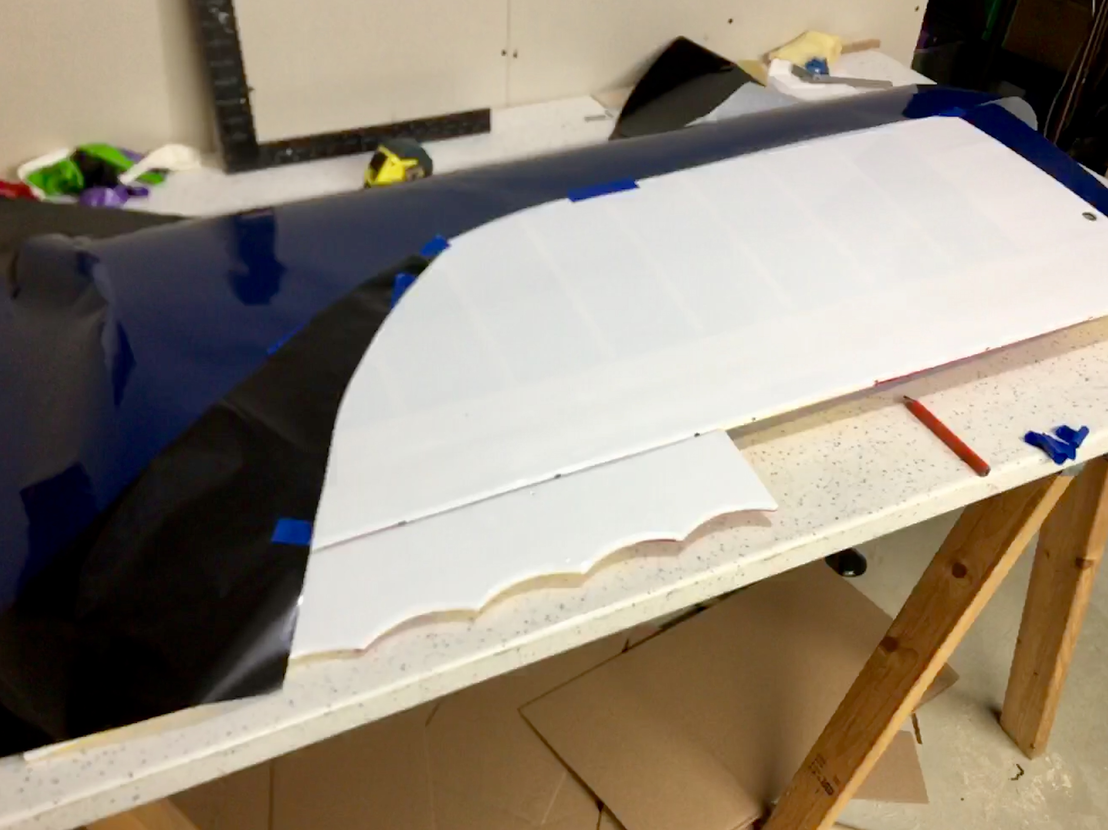

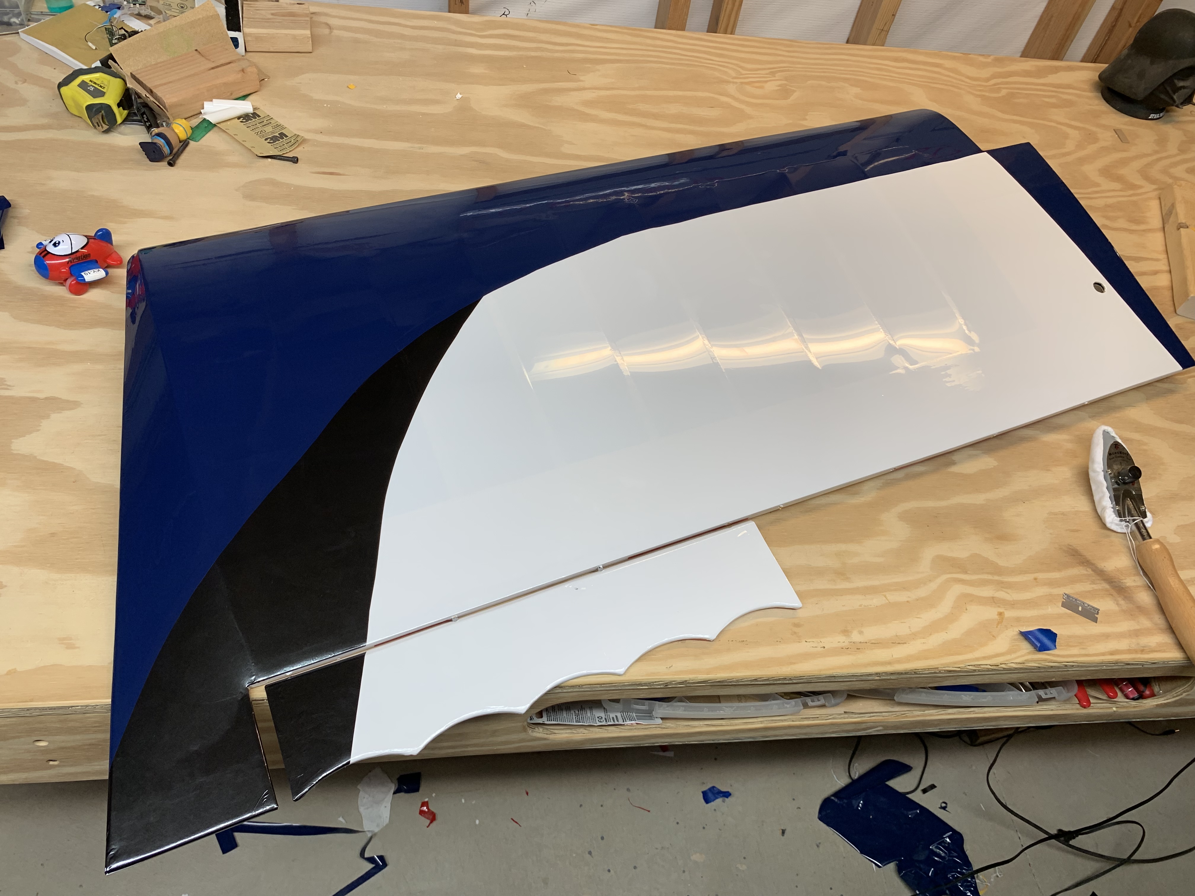

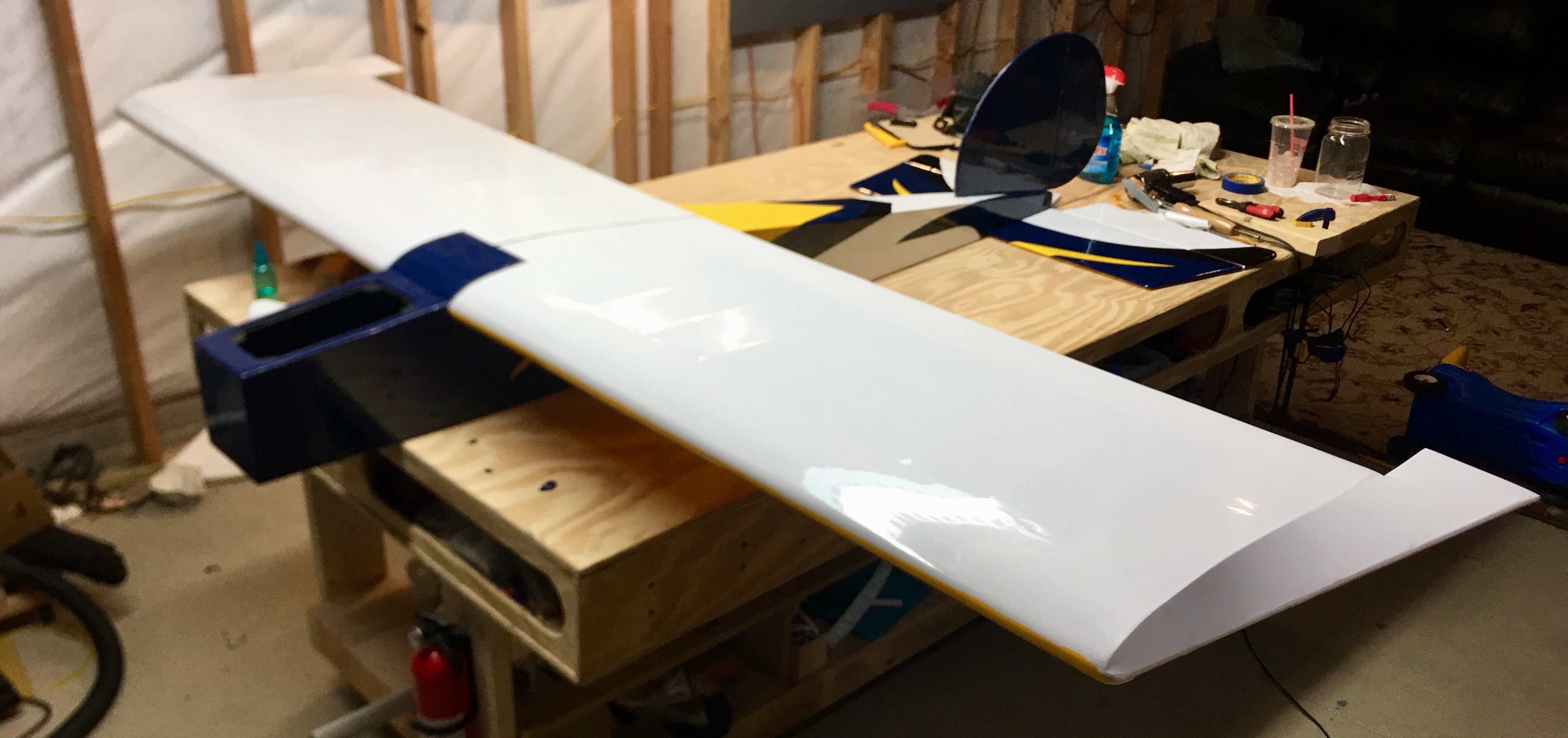

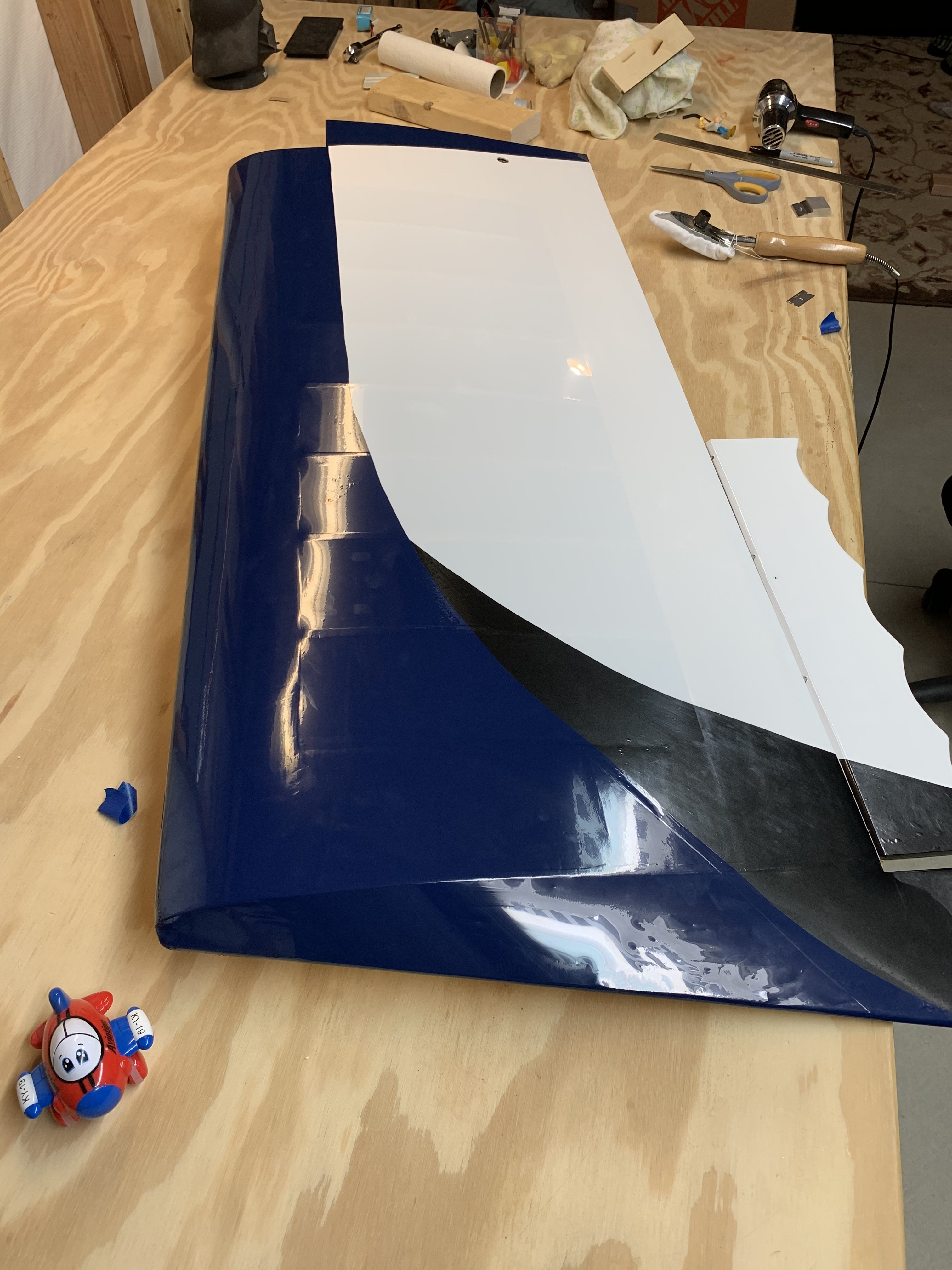

    The wing itself was covered pretty much just how you described it so we are on the same page
    Where the issue with the tip lies in the total chord of just the wing tip that is glued to the wing is wider than the 24” wide covering I have. So I have to have a seam at the edge of the wing structure to the edge of the wing tip. I did get the white on the tip so the whole wing is covered. Most of the white seam will be covered by darker colors so it should be fairly well hidden. Another step closer today:dancing-chicken:

    Ah, ok. I got you. That makes perfect sense. So, you are all covered up then? That is good. I ran into the same issue when I covered my 330 wings. As they are beyond Behemoth. What I have done in the past is "skew" the sheet of covering so that I can reach from one corner to the opposite corner. In essence an example would be from the tip of the root leading edge to the tip of the wing tip trailing edge. Yes, it eats up a lot of covering doing it like this. But I just hate seams. And if I can get away with not having any and it costs me a little extra in covering, it is worth it. Especially since I can add that extra amount left over to my stash stock. LOL
    Glad you got it done. Really liking your thread by the way.

    I looked at trying one sheet and just wasn't going to work... It's too bad but looking at the .60 sized stik my dad built in the early 90s it has the same seam.
    Now just on to sanding the other wing so I can get the base colors on there, then it's trim and assembly! Have a trip to Nashville for the first part of next week and am hoping in the rest of my week off I can really get some good progress. All will depend on the weather because if it's flying weather I will be at the field :D
