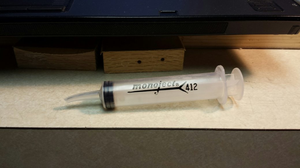

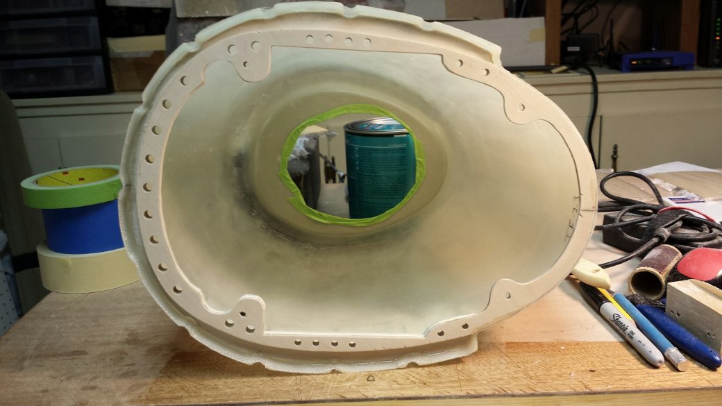

I installed the cowl ring tonight. First I sanded the inside of the cowl and cleaned it with alcohol. Then I tacked it in with CA and glued it in with Goop. I used a syringe to lay a bead of Goop around the edges, a tip I stole from Terry.

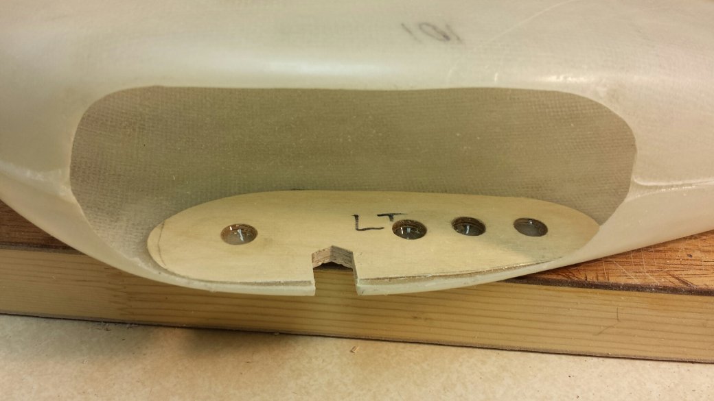

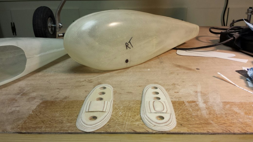

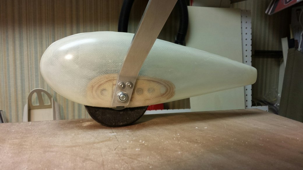

I've been working on my wheel pants and axles. The axles are just standard DuBro so nothing trick there, but the wheel pants are massive. Normally I would just install a piece of plywood around the axle big enough to mount the blind nuts that hold the pant on. This time I decided to make the plywood bigger and let it run farther back into the pant. I fly off grass, and after a while the pants always seem to crack right behind the plywood. Hopefully this will be a little stronger since it has a lot more pant to support.
Since there is no flat area on these pants I had to bevel the edge pretty drastically to make the wood fit flush against the pant as much as possible. I also added an extra piece right where the axle and blind nuts are just to make sure it will tighten up to the gear leg without distorting the pant. After I had a satisfactory fit, I glued them in with Goop.
Great Idea, I never thought of beveling the wood like that!
When your doing just a small piece of ply to hold the blind nuts you normally only need to bevel the bottom.

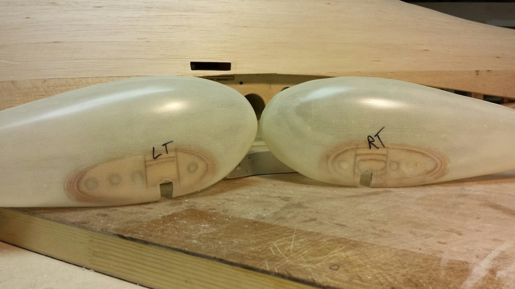

Last night I cut the slots in the pants so they will slide over the axle, and installed the blind nuts. Since I fly off grass I raised the wheel pants up some. I've done that before and it does help on the wear and tear. Unless you hit a pine cone that is. Those things are really hard on wheel pants. ;)

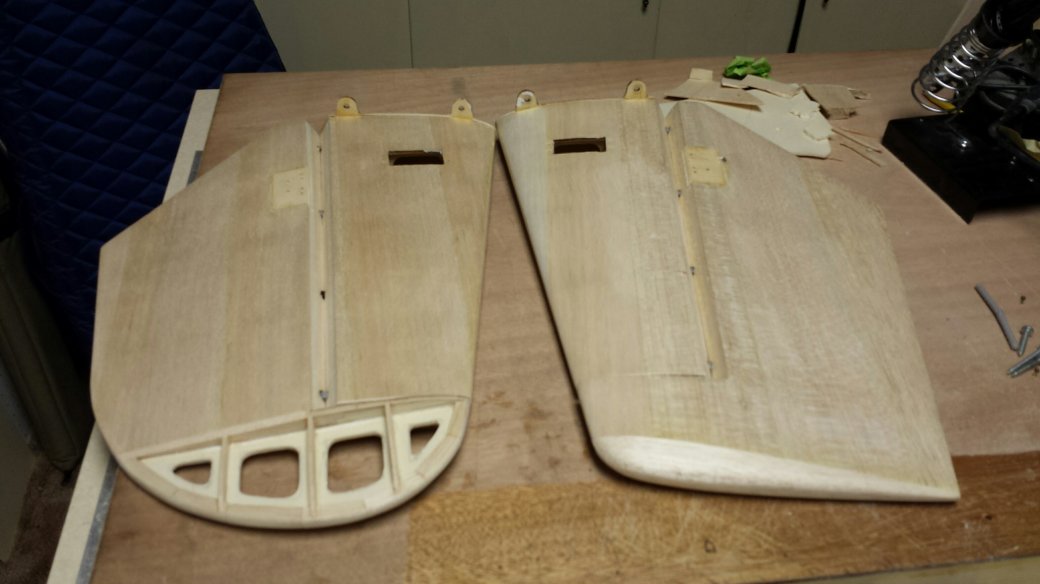

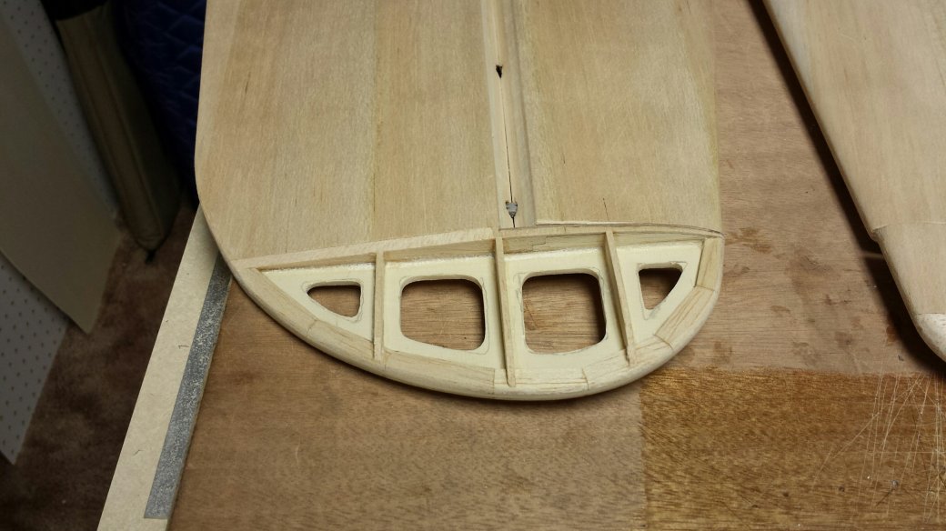

I had decided earlier to round the tips of the ex Yak 54 elevators and wings So they look more at home with the fuse design.
Unfortunately I didn't take any pictures of the process since I was playing it by ear. When I do the other side I will take pics. Here is what the first one looks like compared to the original shape.
