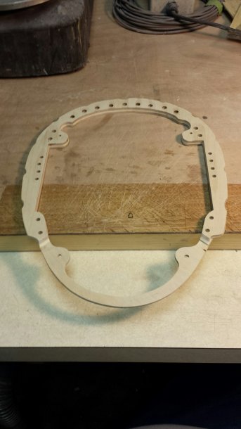

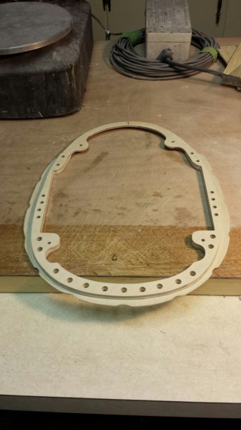

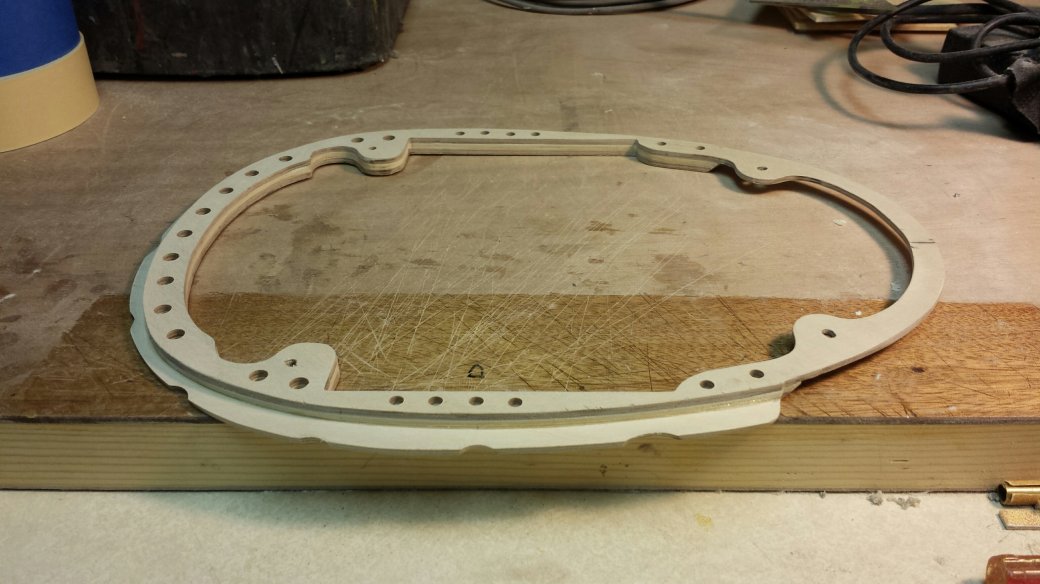

It's been about a week since I posted on the build here. I've been making some test panels and posting in the painting thread, but I have also been working on a cowl ring. This cowl has open cowl vents on the top and sides and I didn't want a flush mount solid ring that you could see from behind when looking in the vents, but it needed to be flush at the bottom. So I ended up making an inner ring with a upper outer ring that is set back a 1/4" so when viewed from behind there is some recess to it. It's heavy and overly complicated, but it should work.
