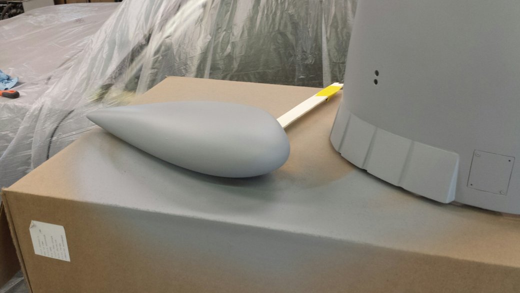

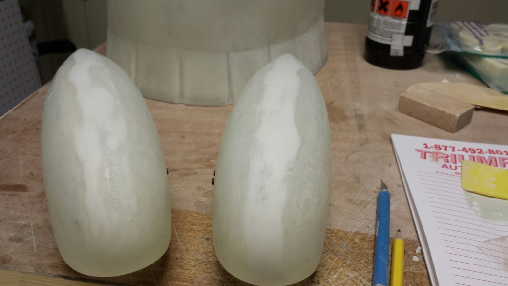

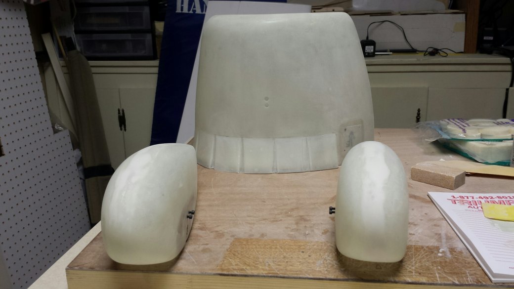

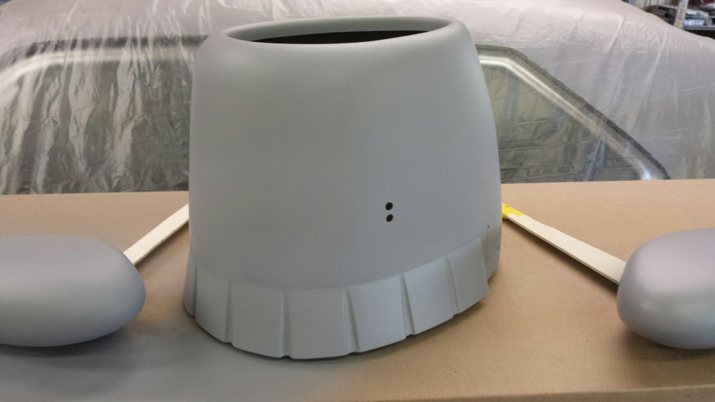

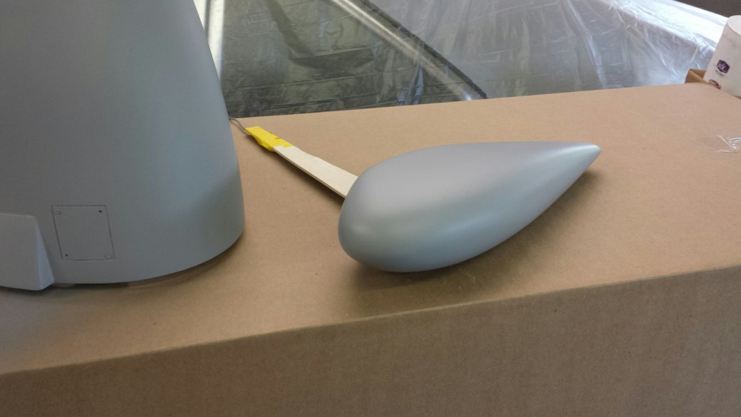

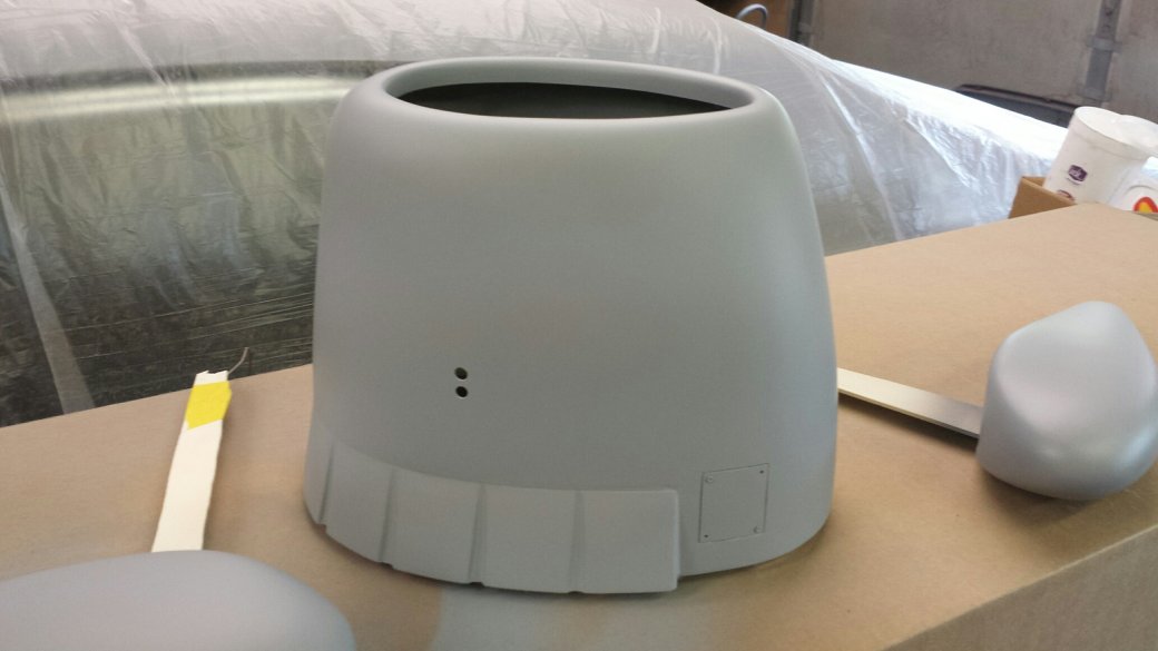

I finished getting the cowl and wheelpants ready for primer tonight. The seam on the wheelpants was really bad. After I sanded it down smooth I ended up using some epoxy and milled fiberglass to fill in all the voids in the seam. After that, I went over it with a polyester glaze, then sanded it smooth.
