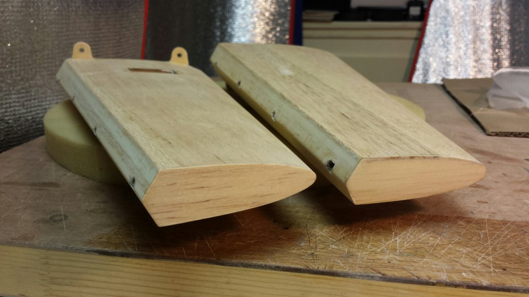

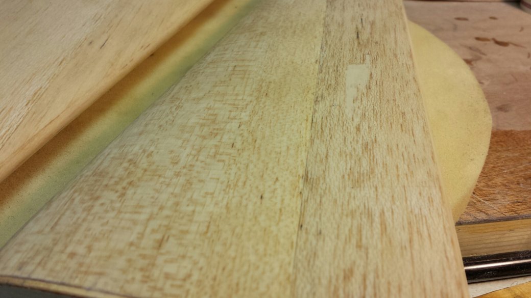

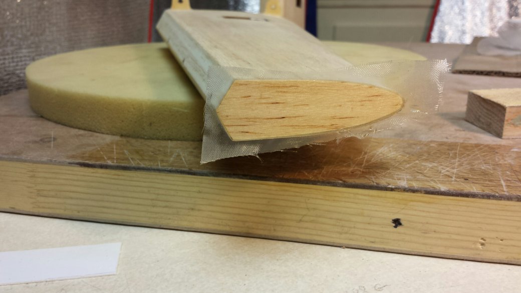

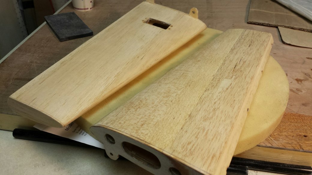

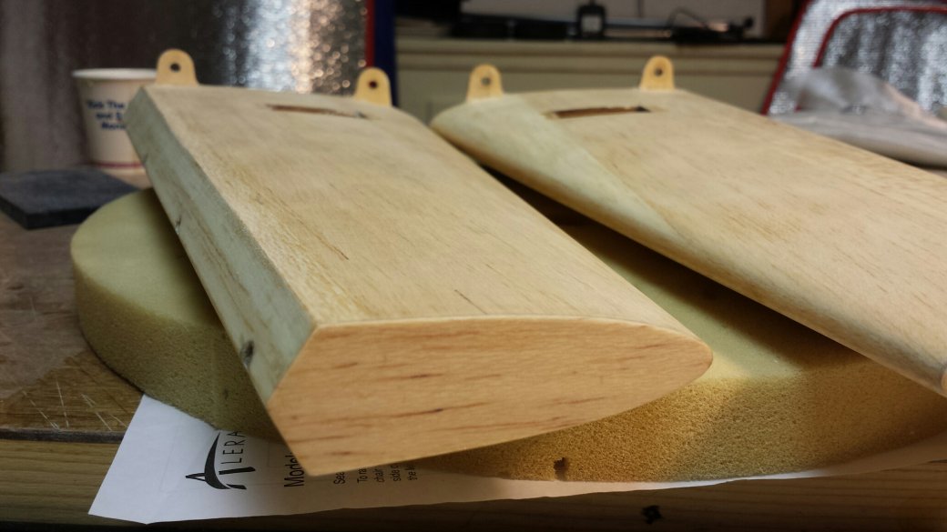

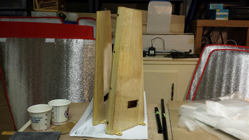

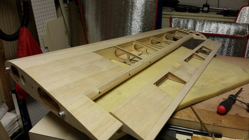

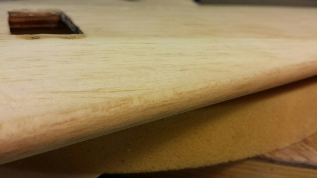

Well progress creeps on. I sanded the second coat of resin with 120 grit and now the stabs are ready for primer. It's hard to tell in the pictures, but they turned out nice and smooth.
I also started getting the wings ready for covering. Last night I removed all the aileron hinges on one wing. I hate that job. It's not that it's that difficult, just a pain. The ones in the open bays are easy, just melted them from the hinge side then give them a twist from behind and pull them out. Some of the balsa blocks they were glued into were cracked or barely attached so I'll need to deal with that as well.
The next step is deARFing wing by fixing the wide gaps in the ailerons at each end and filling all the seams and bad spots to make a nice smooth surface for the Solartex. ARF companies do a pretty good job for the most part, but if I'm going to go through the work of covering and painting I want them to look better than they did when they were on the Yak 54.
Well it is looking good would like to be a little closer and be able to run my hands over the surface and see how good it feels and discuss it with you, nice work.
