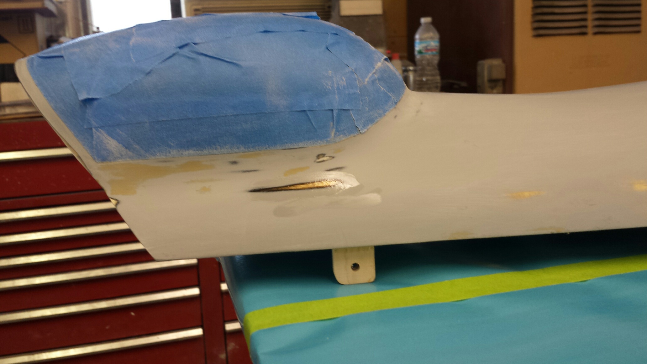

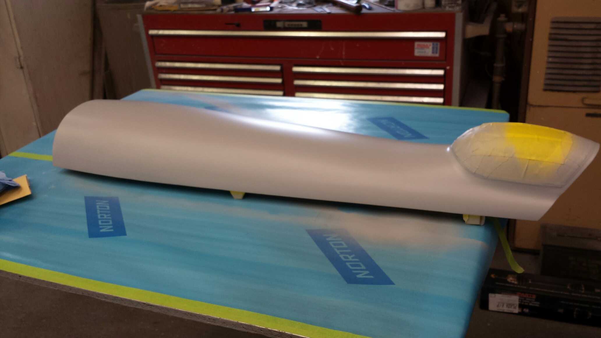

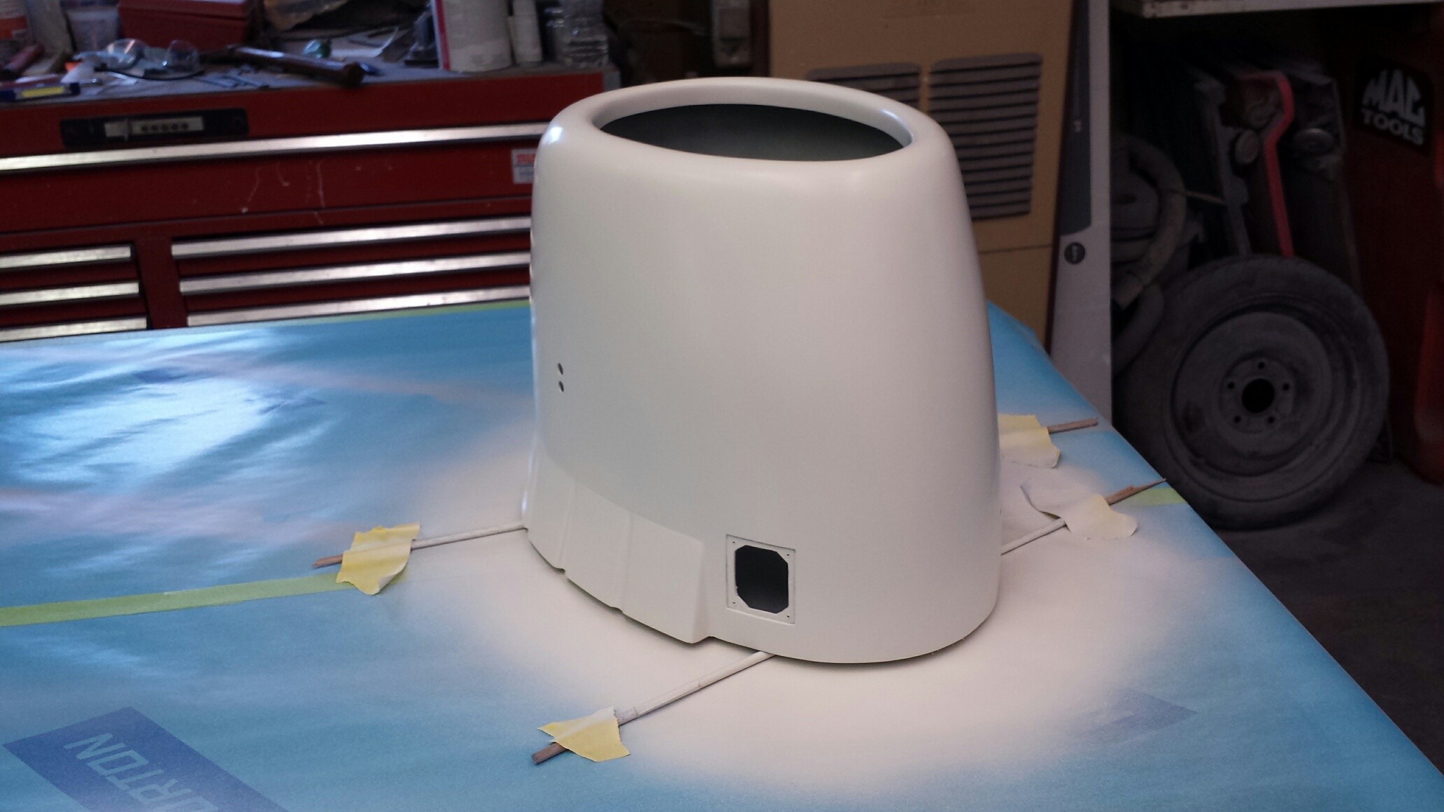

Saturday I put a light coat of primer on the hatch after fixing one small spot where I sanded through the glass and resin and hit wood. It was a tiny spot so I hit it with thin CA on my finger, then sanded it smooth after it hardened. I also sprayed the white on the cowl. That night I hit the hatch with some 600 grit and it's ready to paint. That means everything is ready!

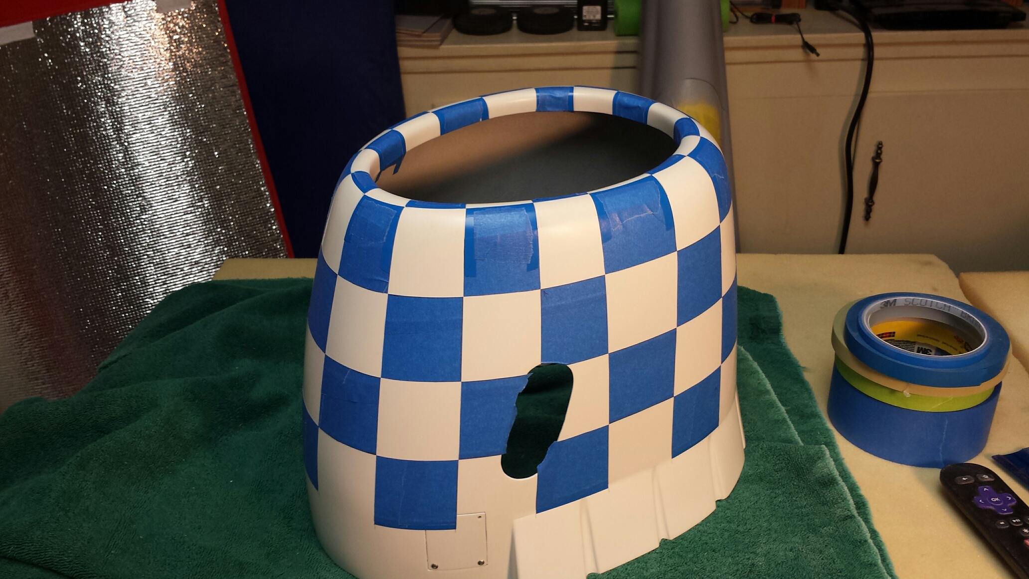

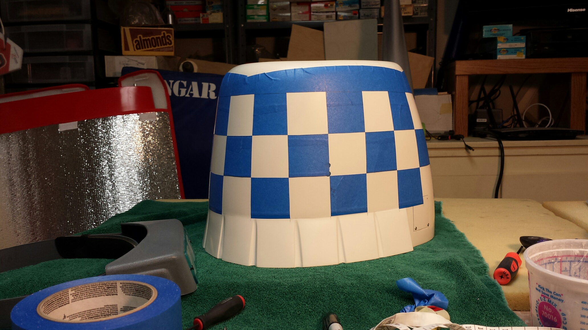

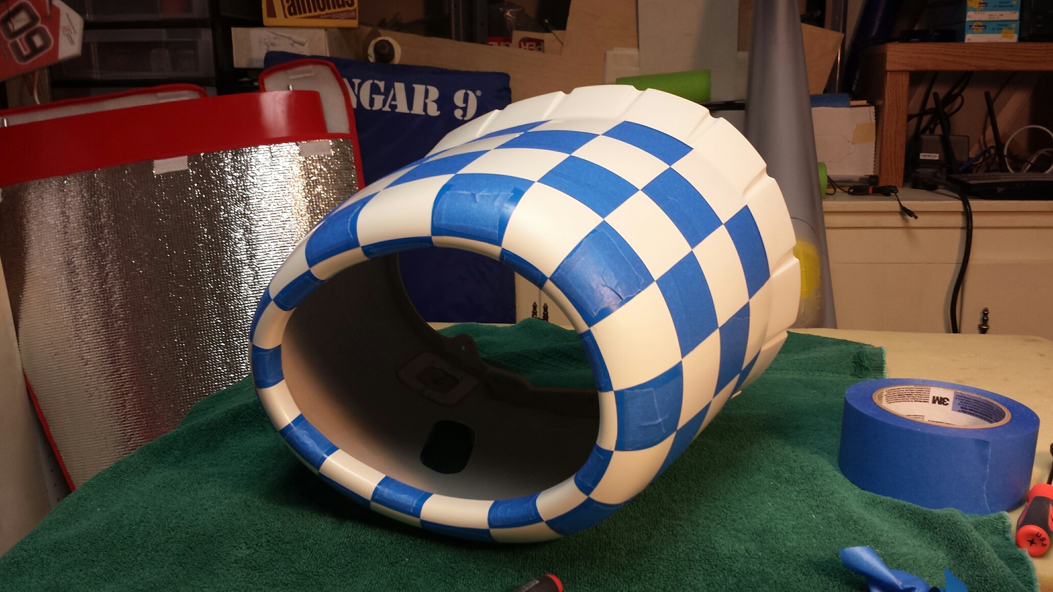

Saturday night I also started masking the cowl for the black checkers. I worked on it more last night and now I don't think I like the size of the checkers, too big. :( The way I did it involved cutting the tape on the drawn lines with an X-acto, so if I want to re-do it I need to sand and re-paint first. So, I think I'm going to finish cutting the squares around the front edge tonight, and spray the black tomorrow and unmask it and see exactly what it looks like before I panic.
That looks awesome. Might I ask how you plan out the checkers so they are the same size all the way around.
Since the cowl gets smaller as it goes forward every one is a slightly different size. I masked the line at the rear where I wanted the checkers to stop, then I measured around the cowl in the back and divided that by the number of checkers I wanted then marked them with a pencil. I then measured forward using the same measurement as the width and made my lines around the circumference of the cowl for all the checkers. The lines that run front to back all get narrower as the go forward so I used a piece of tape and masked each one separately by eye and then drew my lines. When I cut each line I used a piece of tape as a guide.
