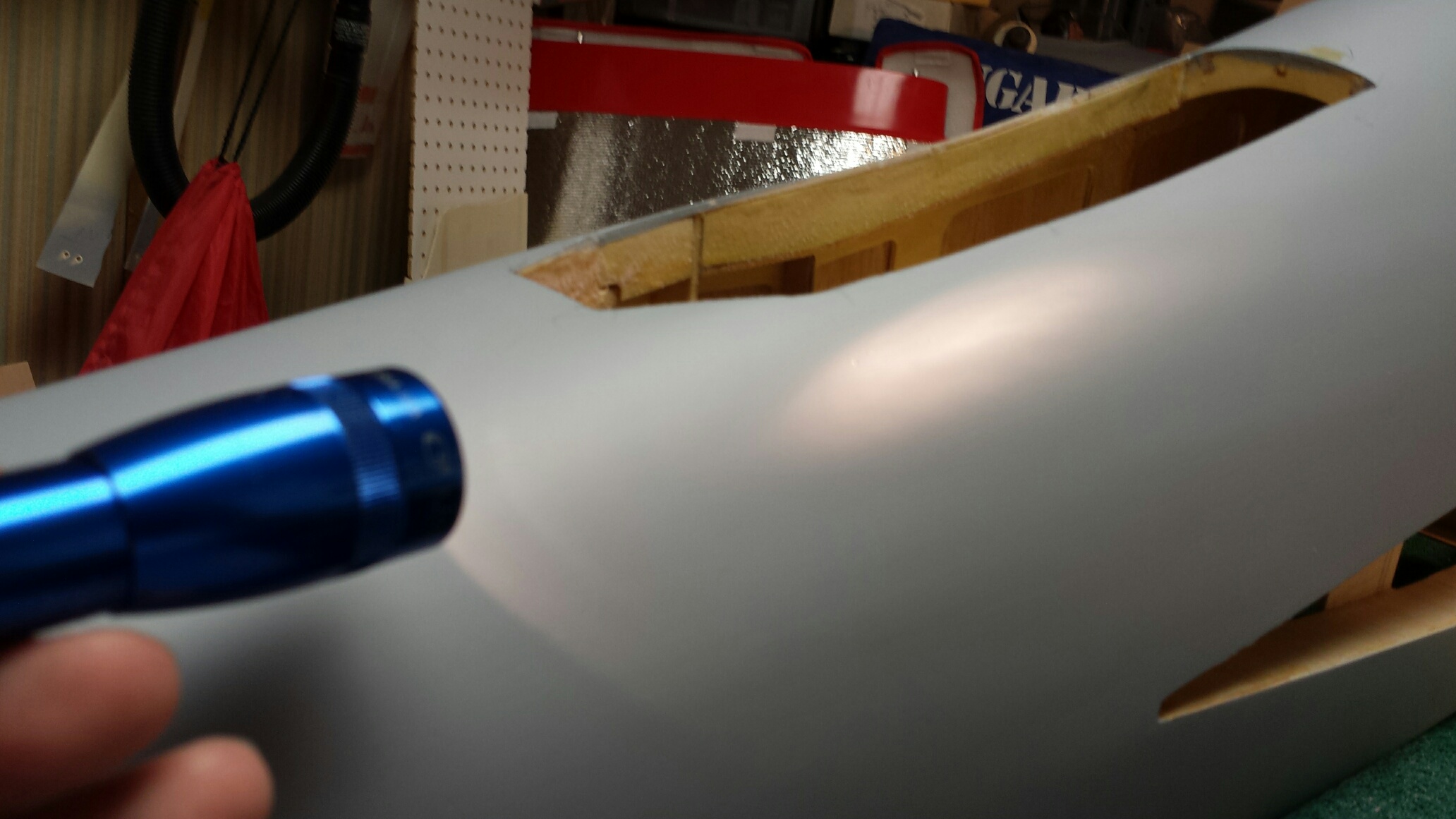

Just thought I'd share a little helpful tip. Anyone that has either glassed an airplane, or painted fiberglass parts has run into the dreaded pinhole. For years now at work I've been using a very simple technique for finding them.
Take a bright beam style flashlight and shine it across the surface of your "unsanded" primer at a shallow angle. The light will make the pinholes stick out like a sore thumb. I like to circle them in pencil "very" lightly so I can hit them with a little filler and no more pinhole.

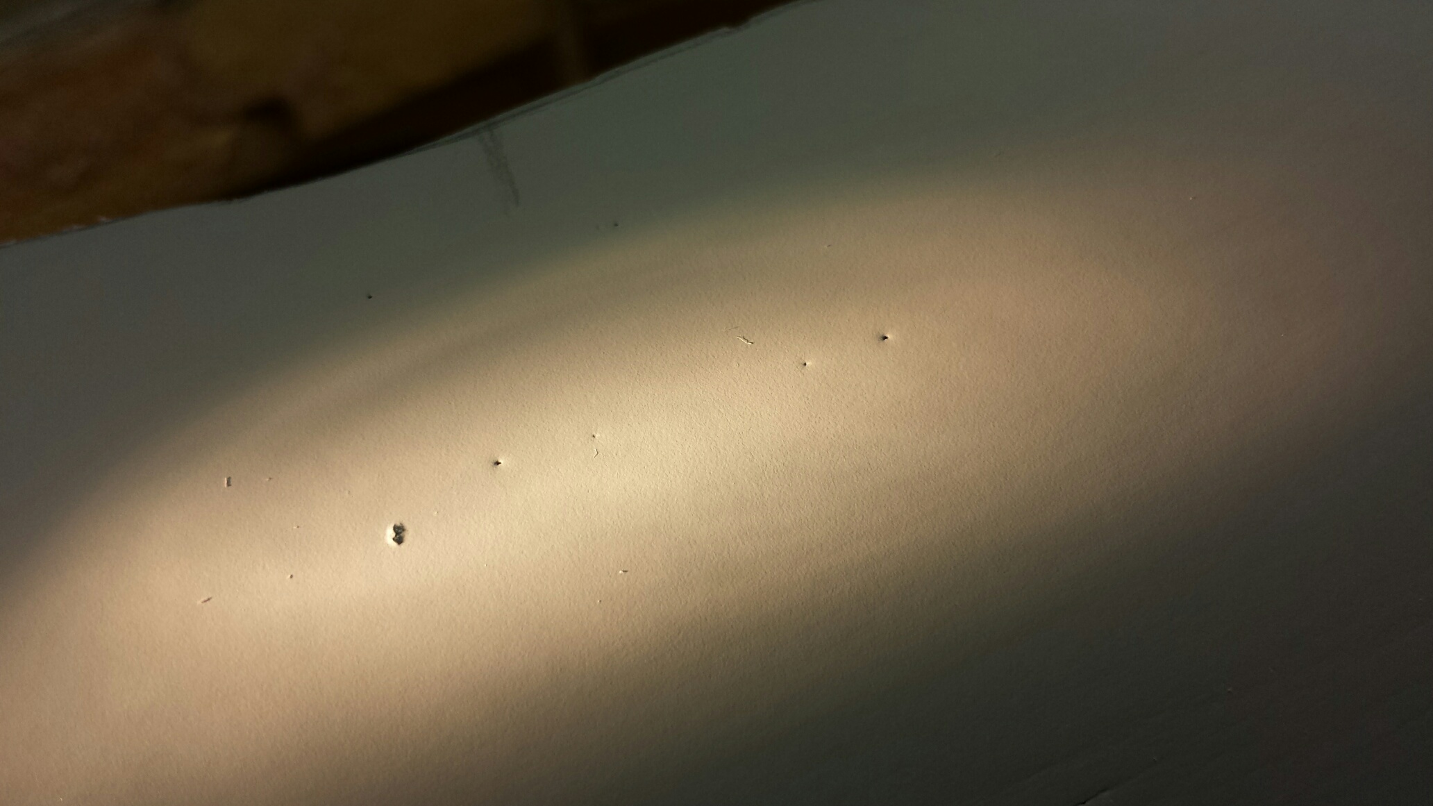

The second photo is a close-up shot of a group of them that shows you how well the light makes them show up. They look massive in the photo, but in reality other than the one to the left they were very tiny. Using this method you can usually kill them all in one shot and not keep finding them as you go.
The flashlight I was using was not the best, but it was good enough for the picture. The one I usually use is WAY brighter.

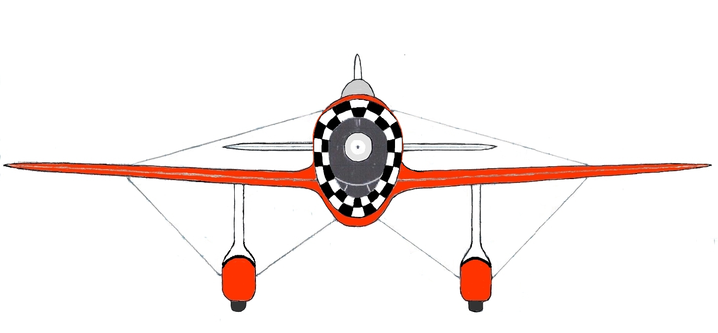

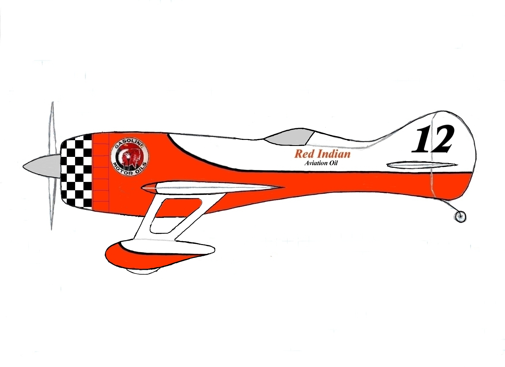

That's what started this airplane in the first place.:) I drew an airplane I wanted to do in fiberglass and toned it down to build this one from wood.
This was my original design. The idea would be to mold the wing inboard of the gear to the fuse like a Byron Corsair, and attach the gear to the end of the wing stub. The gear would be tough to make shock absorbing, strong and reliable, but I still stare at it all the time trying to figure out a good way to do it. I love an engineering challenge.;)

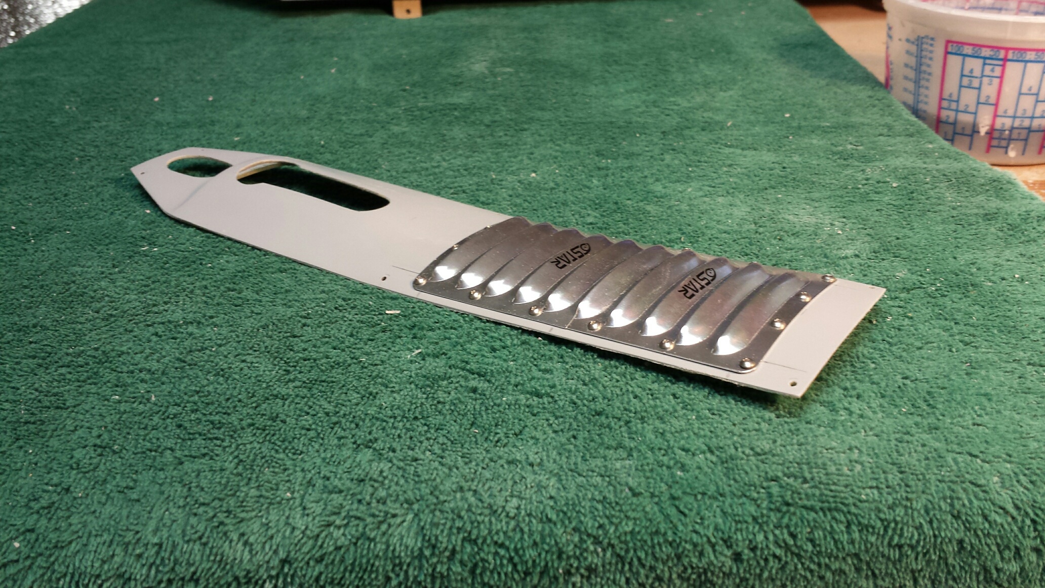

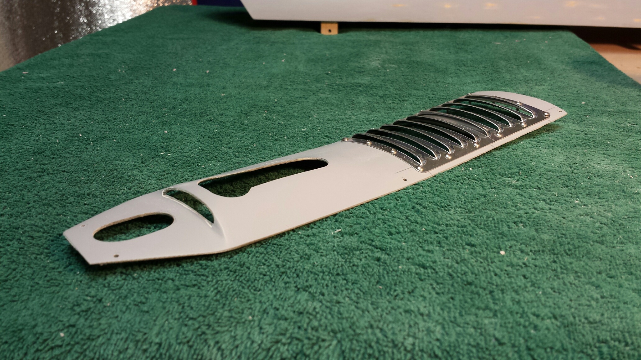

Last night I sanded the hatch and the wheel pants. The wheel pants are ready, but the hatch needs a few spots reprimed. This afternoon I installed my aluminum louvers in the pipe hatch. I cut one louver off of each part to make it look like one continuous louver instead of two separate pieces.

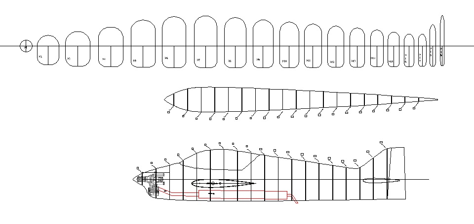

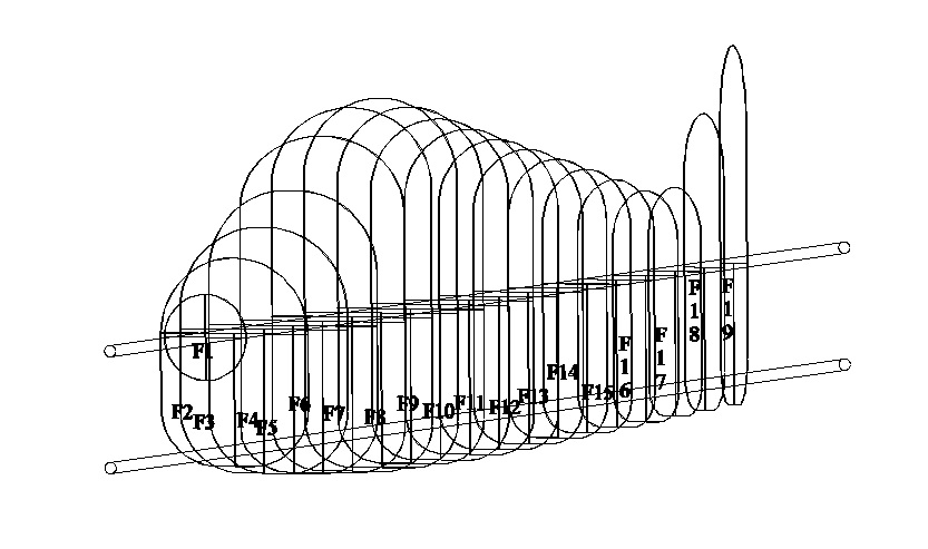

Over the past months I've messed with ideas for a 90" P-40B, a 80" Culp Special, a 80 Tipo (Classic Pattern Plane) and two other 50cc pattern airplanes. I'm really wanting to do a fiberglass fuselage, so I think a 50cc Pattern airplane would be a good subject to mold since it's a pretty simple shape. I'd love to do a 50cc Tipo, but retracts on a 50cc sized one would be spendy, heavy and troublesome. And fuselage mounted gear on a classic ballistic style pattern airplane is just criminal.
The leader at this point is a 50cc size pattern airplane based on a Krill Spark Evo I. Ive got most of the pre plug design work done for that using a DLE55RA. The rear exhaust fits well with the tuned pipe in the fuse
But, like I said my mind wanders, so I may change it many times before any project starts.;)
View attachment 84779 View attachment 84780

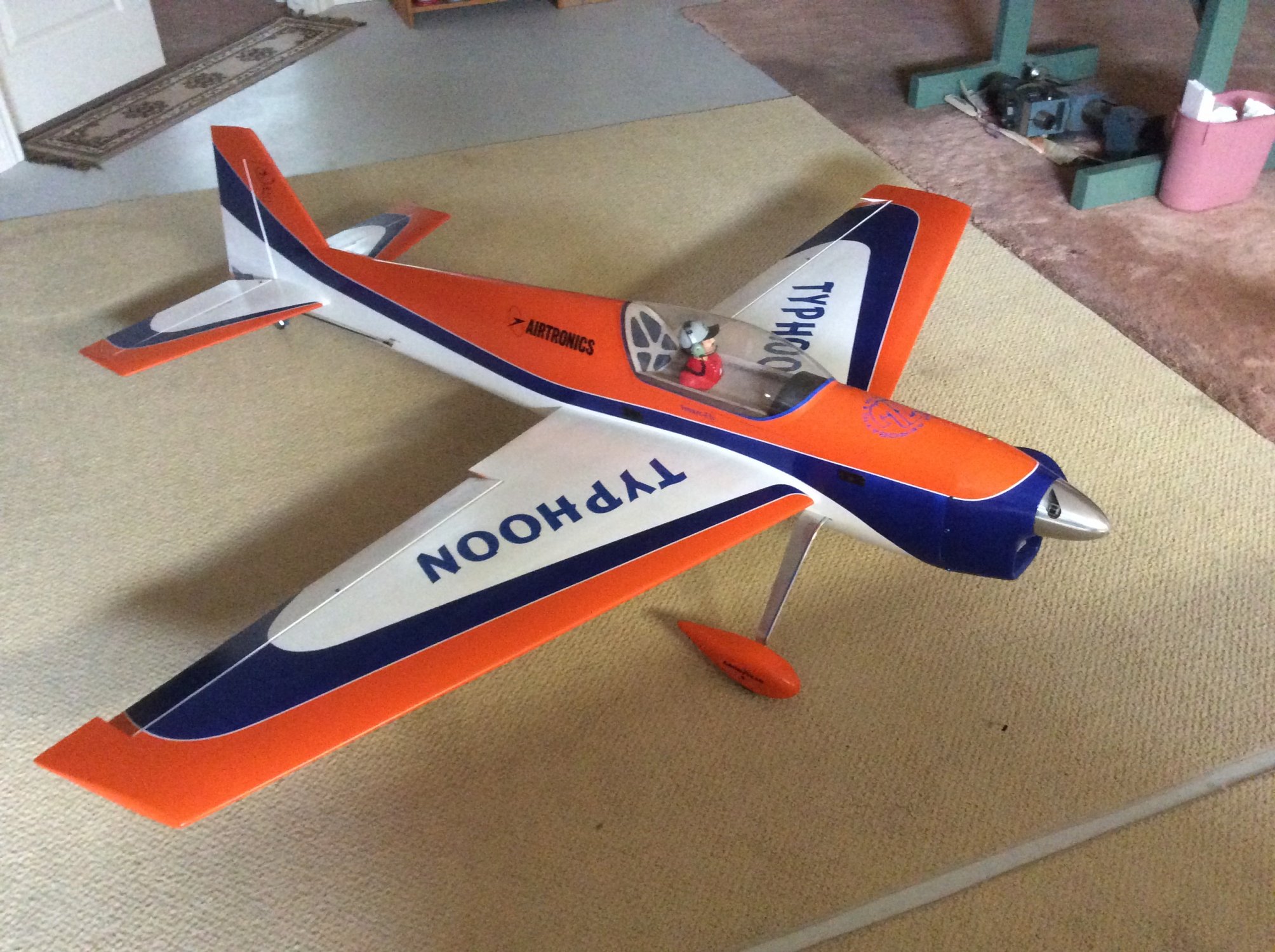

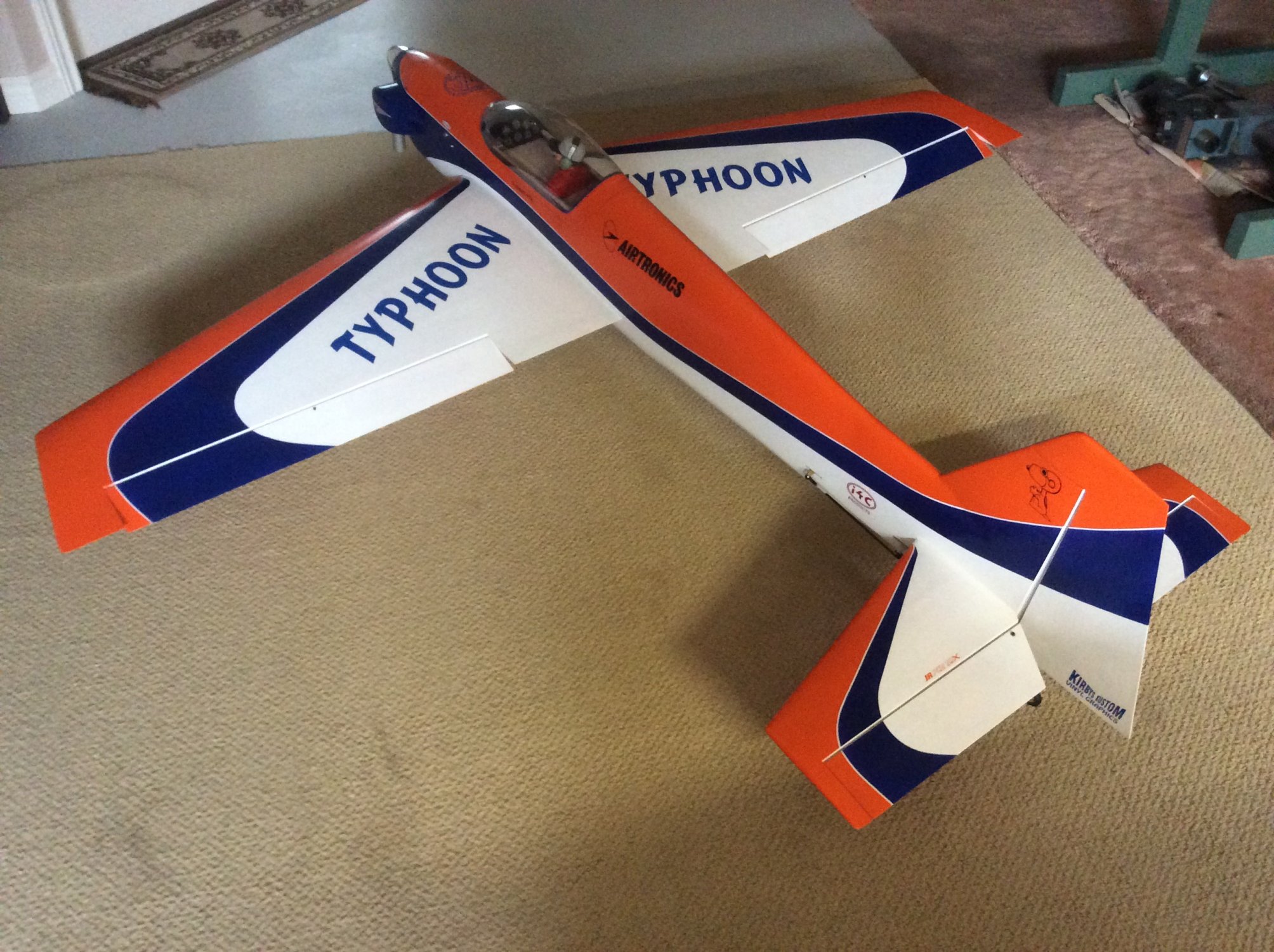

Note quite as fancy as what you are planning but I wanted to fly a pattern plane again but same as you a larger gas size. Looked into retracts but could not find what I was looking for except for a set of retracts from BVM the jet guy. The price was out of my league so I went for standard gear on the fuse, easy to transport and put the wings on with the plane standing on its wheels. It's my own design and I built it a number of years ago with 3w-42 in it. Have not flowen it jet and I do not why. It was a lot of work it took me 3 years to build.
