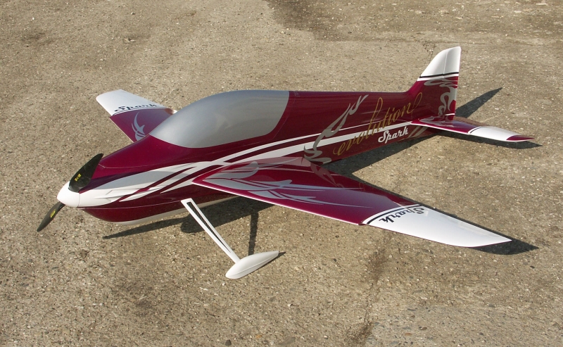

Mine would be similar to this Krill Spark, only bigger and the chin of the cowl wouldn't be so sloped back. I would also use a normal rudder, not their style with the splayed out trailing edge.
