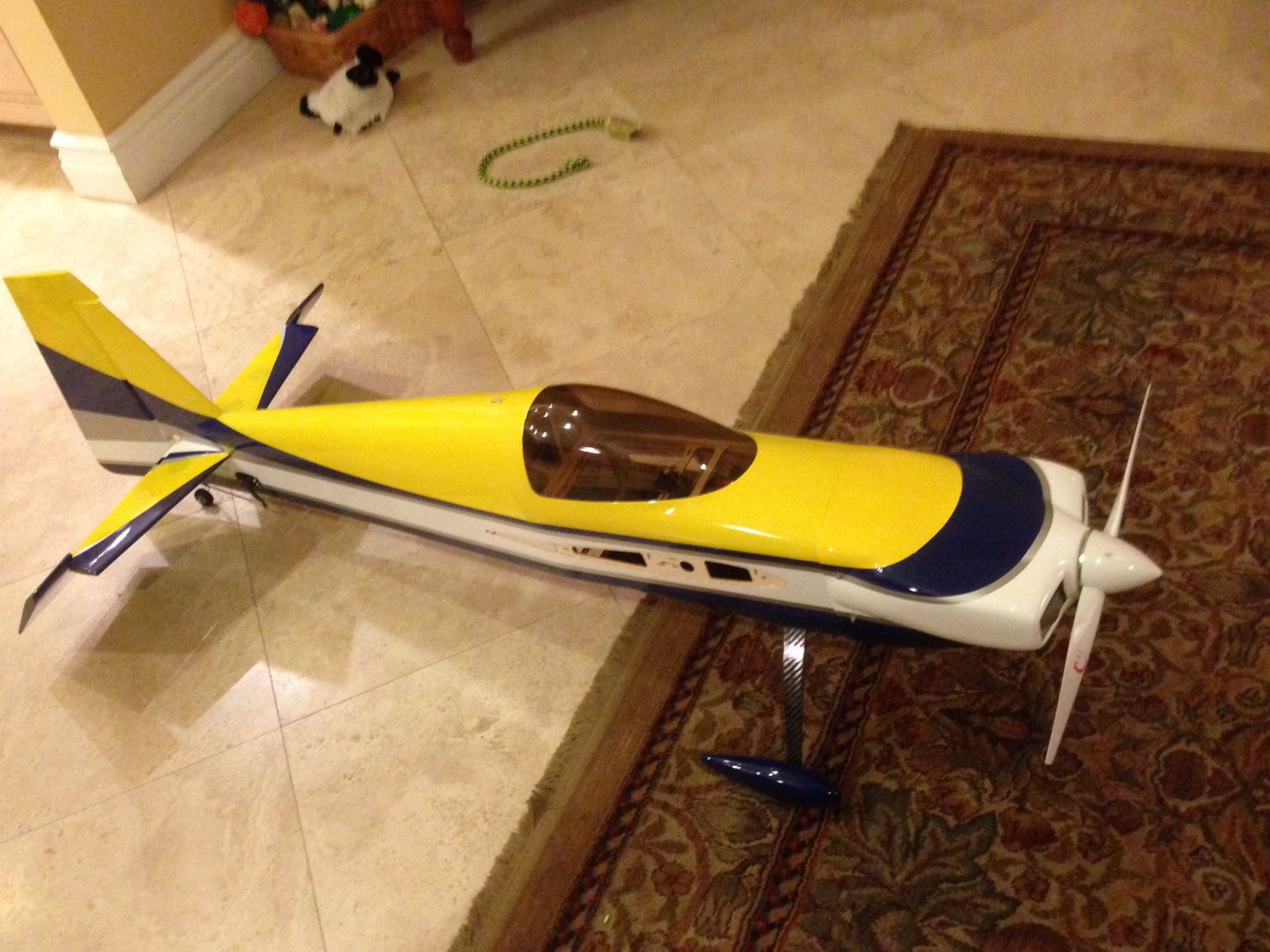

Almost done, just waiting on replacement servo's from horizon... :)
