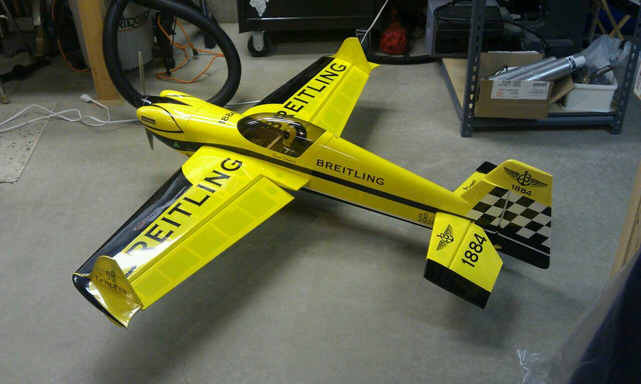

An mxs I did recently in a popular scheme. Owner is my old boss from the hobby shop I worked at in Chicago when I was 15!

Dude that is some sick vinyl do you have a set that looks good on a green mxs? Monster energy maybe?
