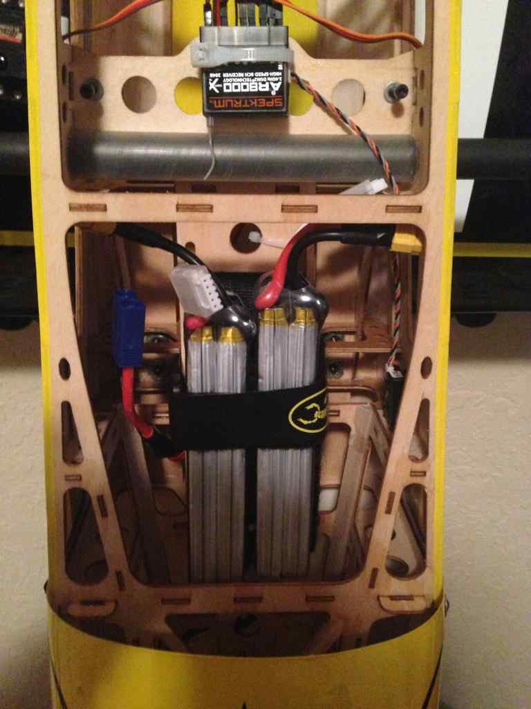

Question for owners of the MXS... Is there enough space in the battery bay to get a couple of 4s 2200mAh batteries side by side?
I'm toying with getting the MXS but dont want to buy new batteries unless I have to, so I would like to use the 4s 2200's that I have from my 48" EXPs but wire in series to make a 8s 2200mAh pack. This would be used in conjunction with a low kv winding version of the Motrolfly DM-4315 (about 360Kv) and spinning a 16x8 prop. Amps would be low so flight time should be acceptable, battery weight would be 500g which I think is ok.
I'm pretty happy that this set up would work pretty well, space to get them in seems fine based on looking at photos but some confirmation would be nice.
thanks:)
thanks:)
Steve,
They'll absolutely fit!!!
I only had 4s2800s to use for a pic, and they fit easily.
Hope this helps
-G
