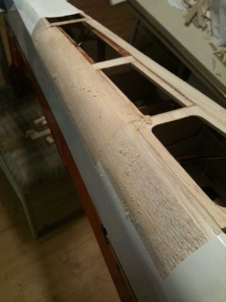

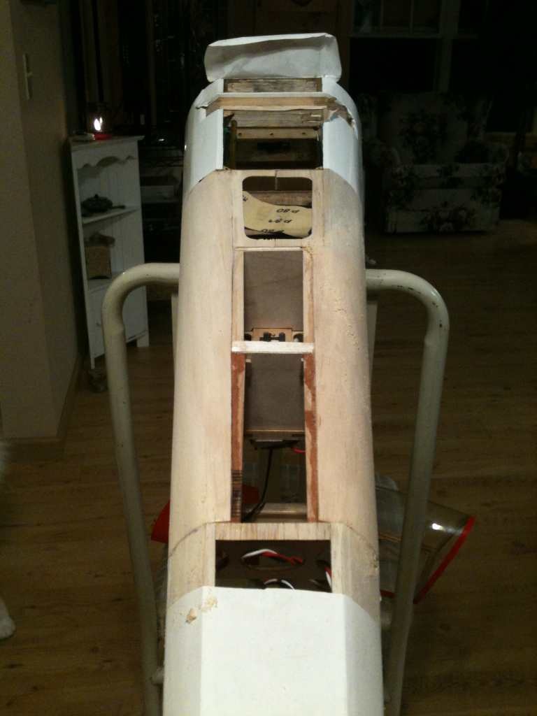

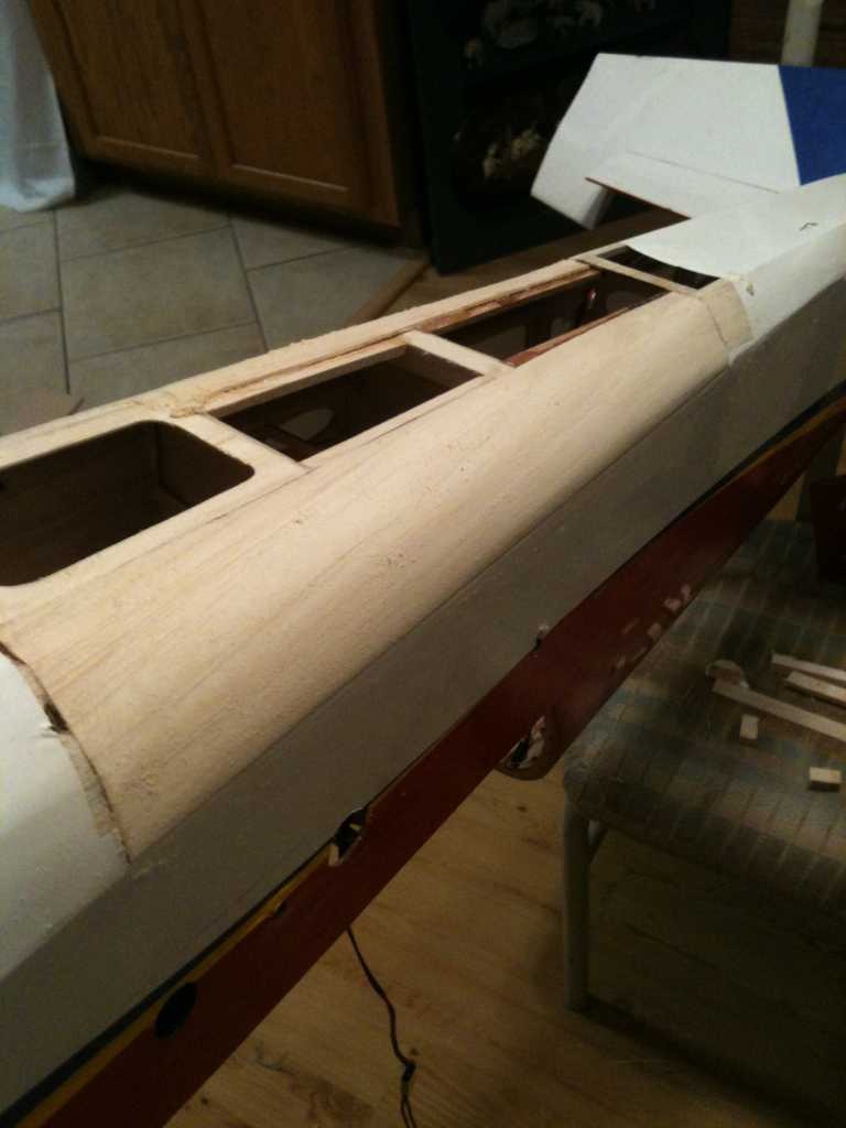

Got mine all repaired structurally, tomorrow I'll put the patching on it. Some of the seams didn't want to cooperate, so they aren't exactly flush. It wasn't pristine when I got it, so I'm not too concerned. This is also my first repair job of this magnitude, so I'm sure the next one will be much better.
SnowDog
Looks good structurally...after major repairs like that, I'm just happy if it flies halfway straight! :)

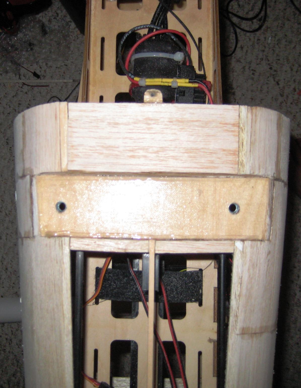

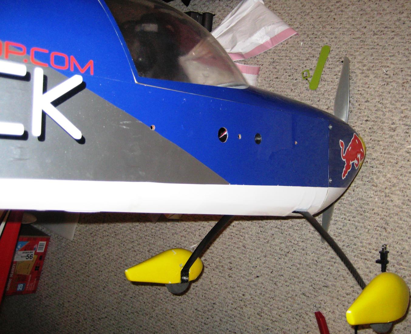

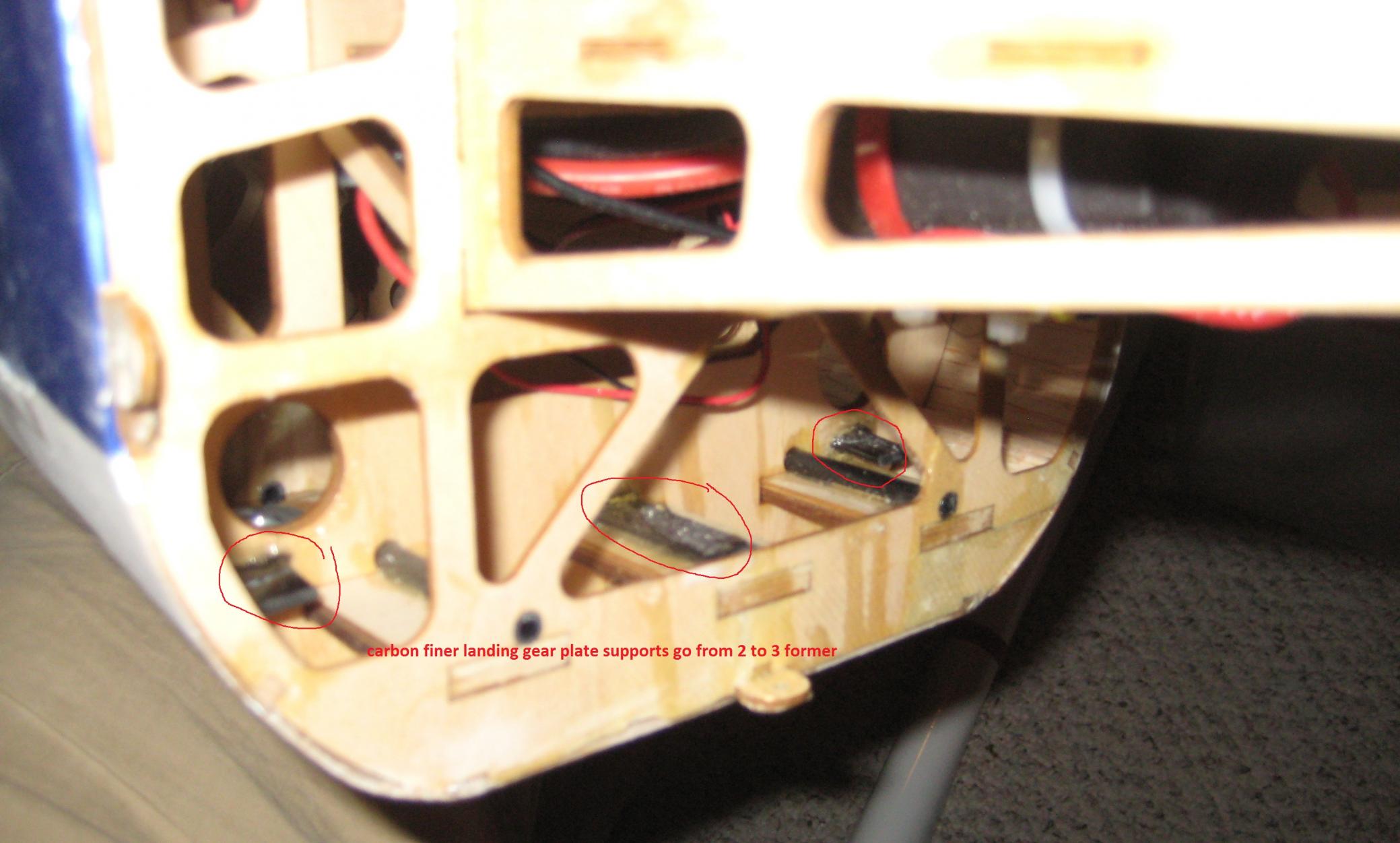

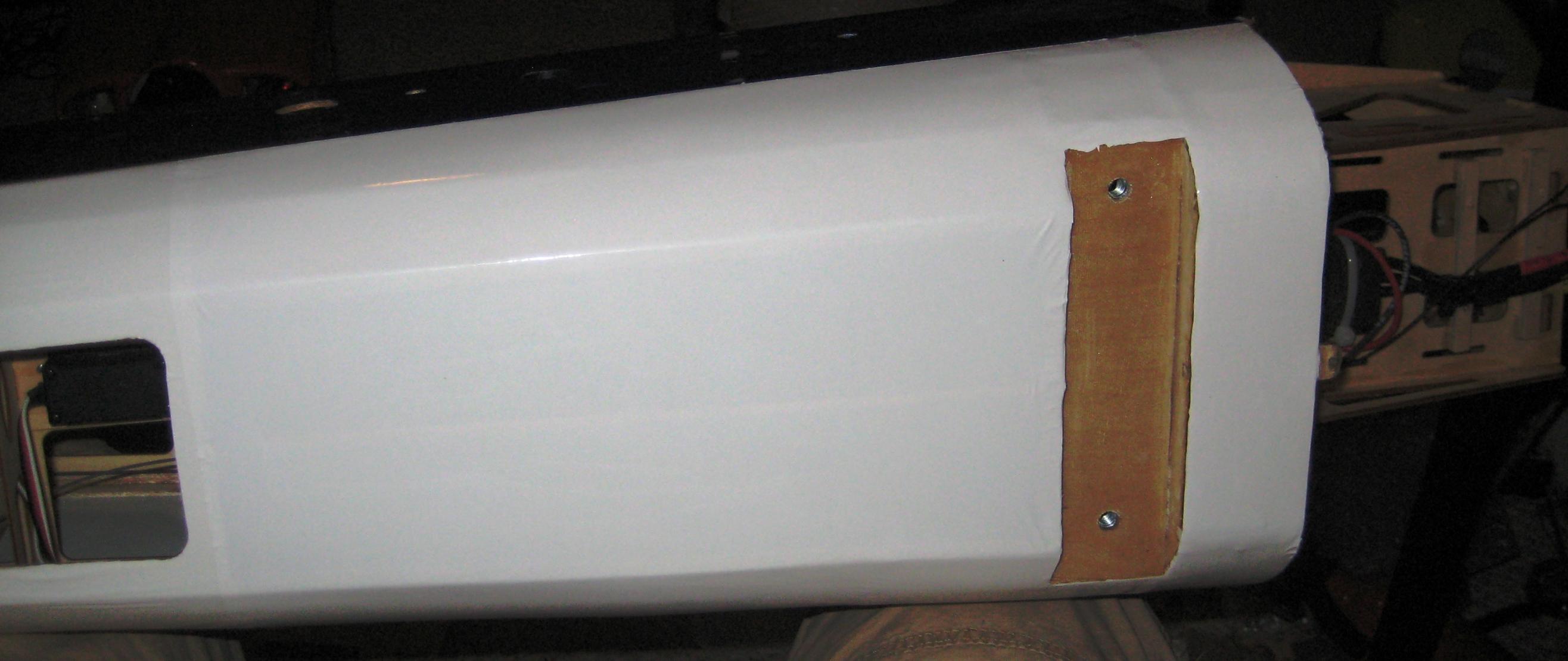

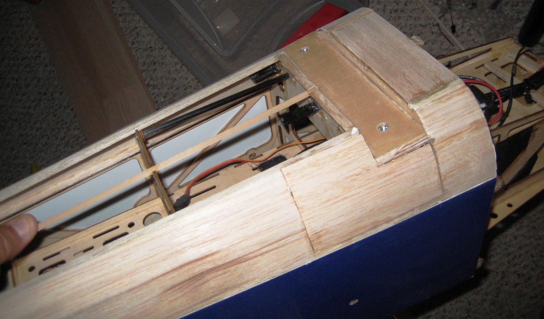

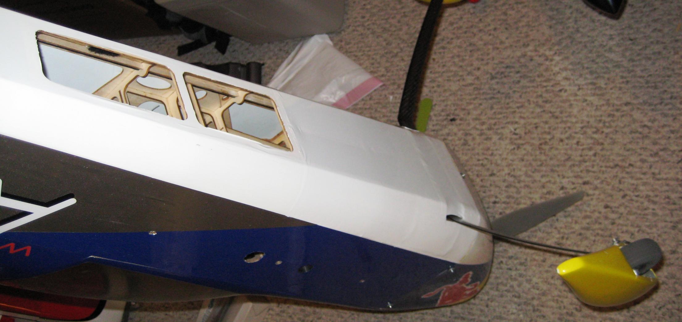

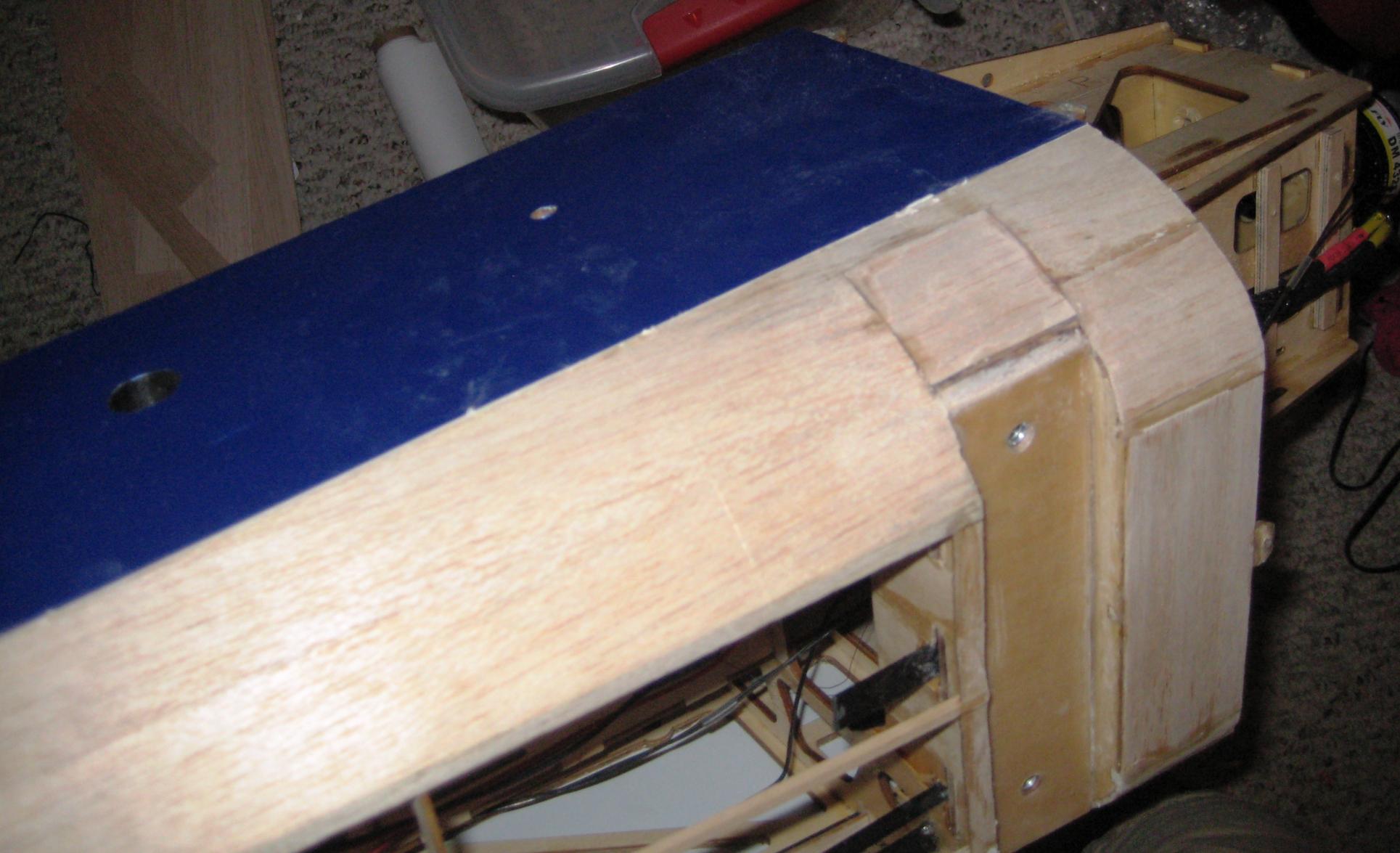

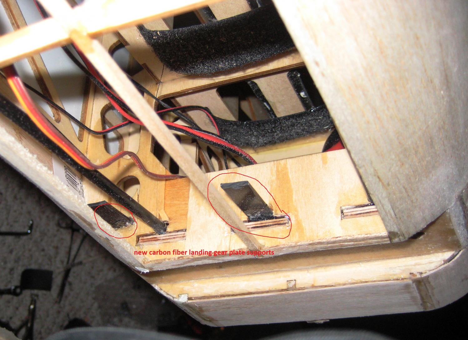

Ok, behold, the final pics of my second 70" Slick landing gear plate repair: (thanks to SteveT for the landing gear plate)
IMG_3797.jpgIMG_3798.jpgIMG_3799.jpgIMG_3800.jpgIMG_3801.jpgIMG_3803.jpgIMG_3804.jpgIMG_3805.jpg
Looks Fine as Frogs hair Gary!!! And glad I could help!! Did it fit ok???
SteveT
needed a little trimming, as I think the 71 is sized different than the 70" The forward slots are different all together than on the 71, hence my carbon fiber supports. Looks like it should hold up real nice though!
