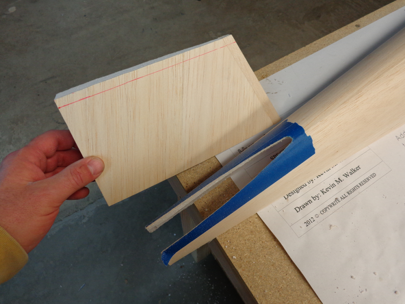

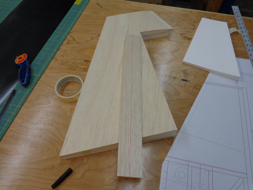

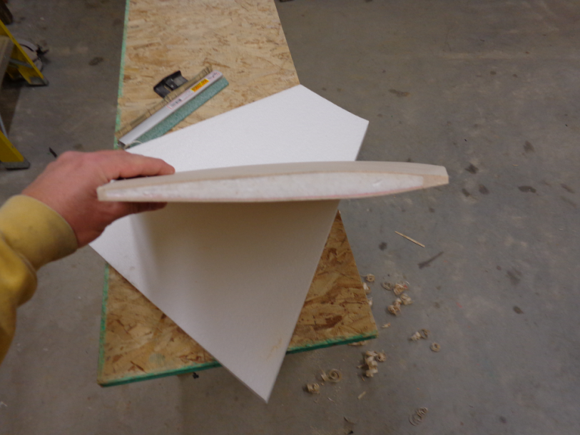

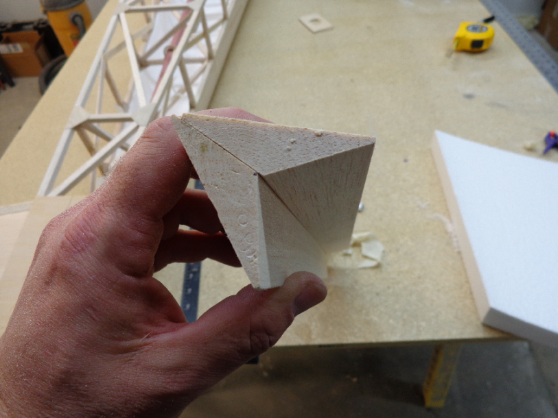

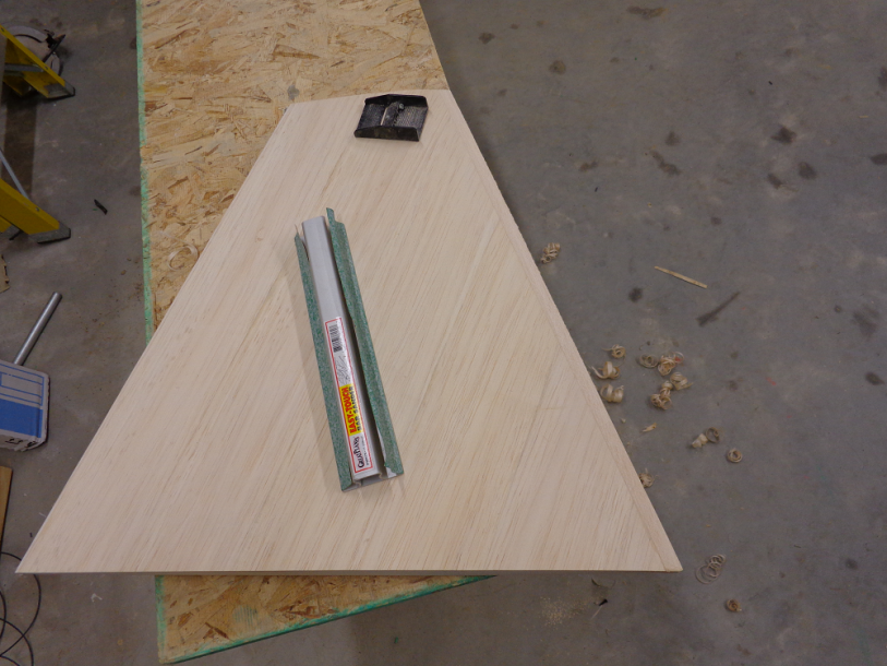

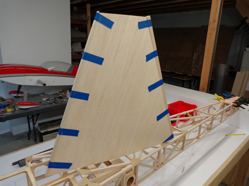

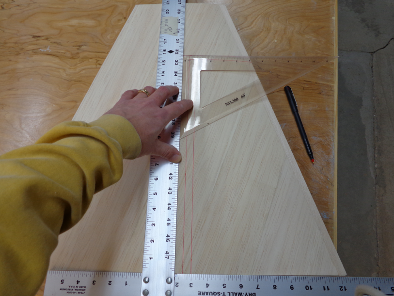

I had pulled the stab from the vacuum bag earlier in the week and add the LE and TE stock. I planed the edges off and did some light sanding. Next I marked out the hinge line and did some cutting. From another build I had some left over balsa hinge stock already cut so I marked out the center line and glued up to stab and then squared it up to fuse.
I used gorilla poly glue for the LE & TE and also on the bottom of the stab that gets fixed to stab ply plate. The balsa hinge stock was also glue to stab with poly glue bit I used the Gorilla wood glue for the balsa to ply areas and lots of tape.

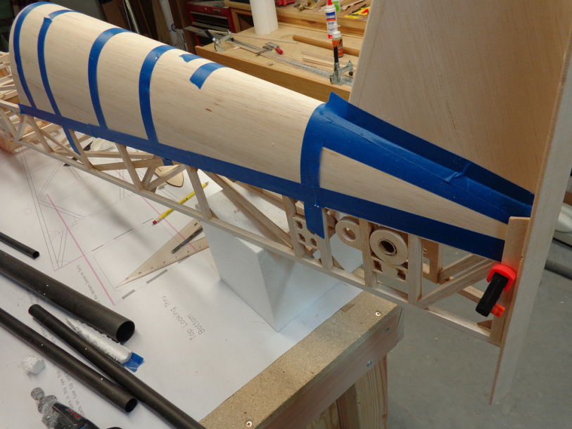

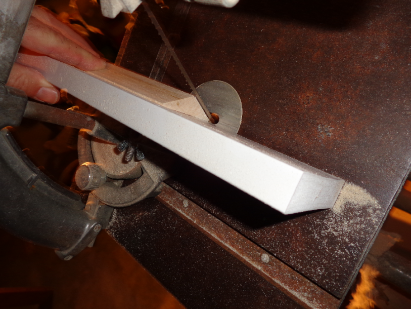

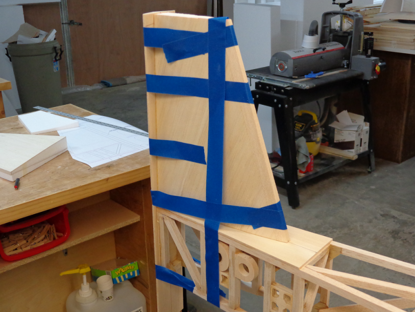

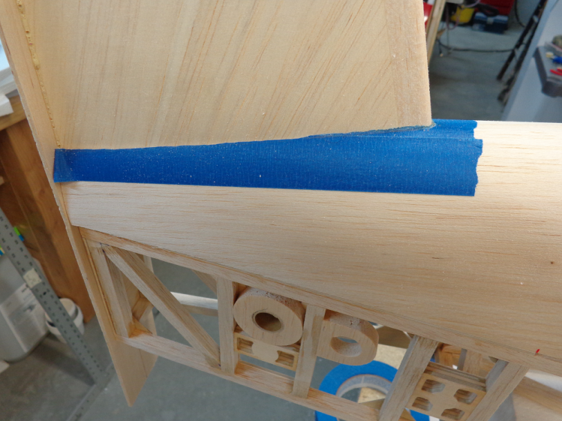

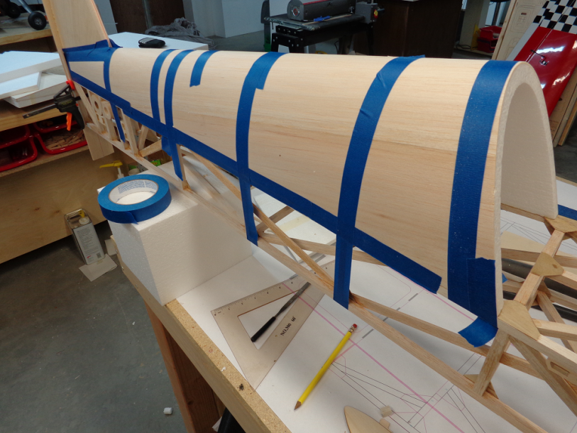

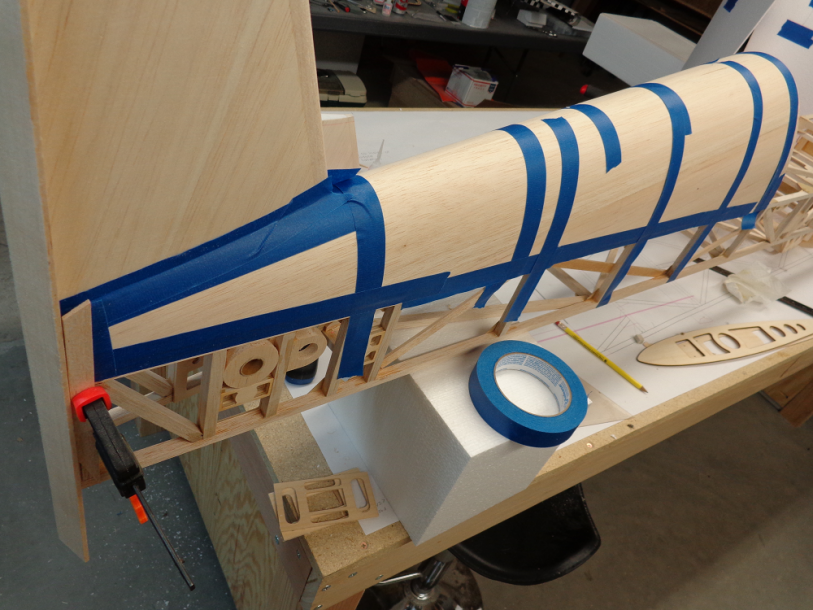

With the fin in place it was time to fit the Turtle deck. For fin cut out on the deck I used the scrap part of the V-Stab. I turned this upside down on the deck and traced around it. When I did the first cut I did so just inside the line and then did a little sanding and fitting. Forgot to mention that for the height measurement I just sat the deck on the top of the fuse and found the 2 points were the front of the fin and deck would meet.
Once I was happy with that fit I marked the cut point to remove material for the ply deck. I used Poly glue to fasten the deck down and taped in place. Running tape down the seams will help eliminate any glue that expands out.

Looking great. Can't wit to see this at Nall. I went back to the poly glue on my belly pan. I'm learning how to use it. It's not the same as most glues. I've got it now so it does not expand out so much..
