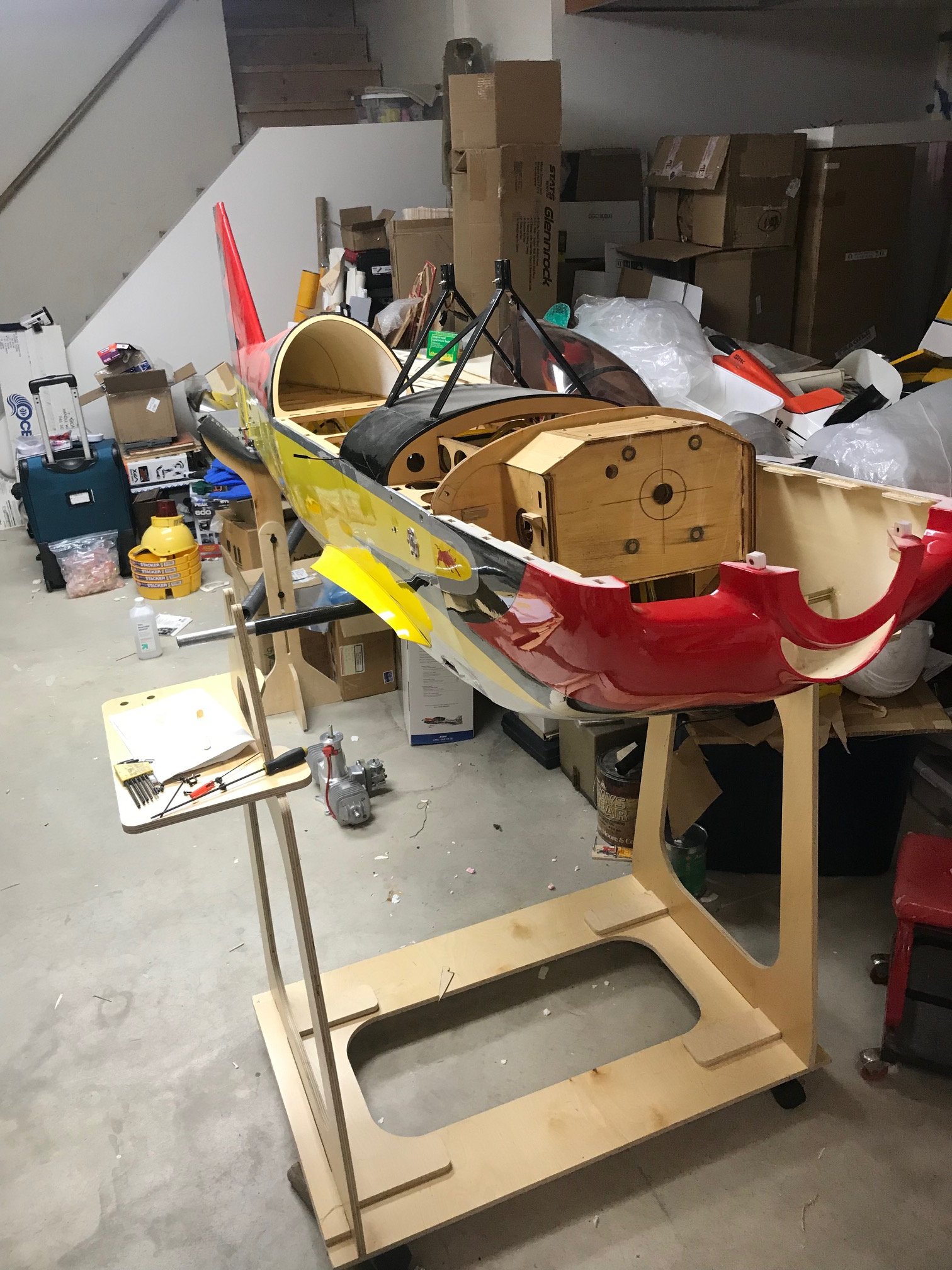

Going to have to add ~ 3 1/2" of 'motor mount' because the original owner had a 3W212 quad installed on it so he of course needed a much shorter motor box
Robert,
I went back through your thread and saw that you've got a '3-ganged' servo setup on the rudder......any particular reason you went with this versus servos in the tail on each side of the fuselage? The latter method is how the original owner of my Ultimate has it setup but I've never been a big fan of servos potentially fighting each other if the setup isn't 'just right.
Bill
acerc
Hi Bill,
I went that way for two reasons, one is that is what was recommended in the manual (three servos) and the other being tail weight. I do believe, after it is said and done, one could use only one or two. With the amount of power the three are pulling (1458oz-in) I think everything else in line would fail much sooner. Half of that would probably be more than sufficient and if it turns out I need to lighten the tail I will pull one of them or maybe even two.
Robert,
I think because the original owner had the big-arse 4 cylinder installed (~12.5 lbs) he needed all the help he could get in the tail to balance it out...
Since the servos he used (and which I'll continue to use) are Hitec 7980's, with ~1100 oz/in of torque for the pair, and I'll be using a DA-150 (~8.4 lbs), moving the servos to a gang setup, along with moving a power expander and receiver setup forward, should help get me close to where I need to be for the CG
Bill
acerc
Robert,
Bill
Sounds like a sound plan. I know mine balanced pretty good the way it is, it will take some flying to tell how close but I have a feeling I will be removing at least one of the servos.
