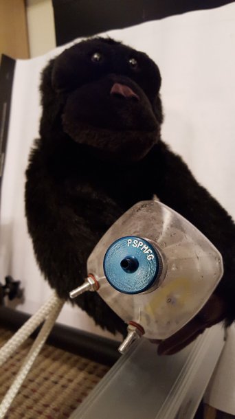

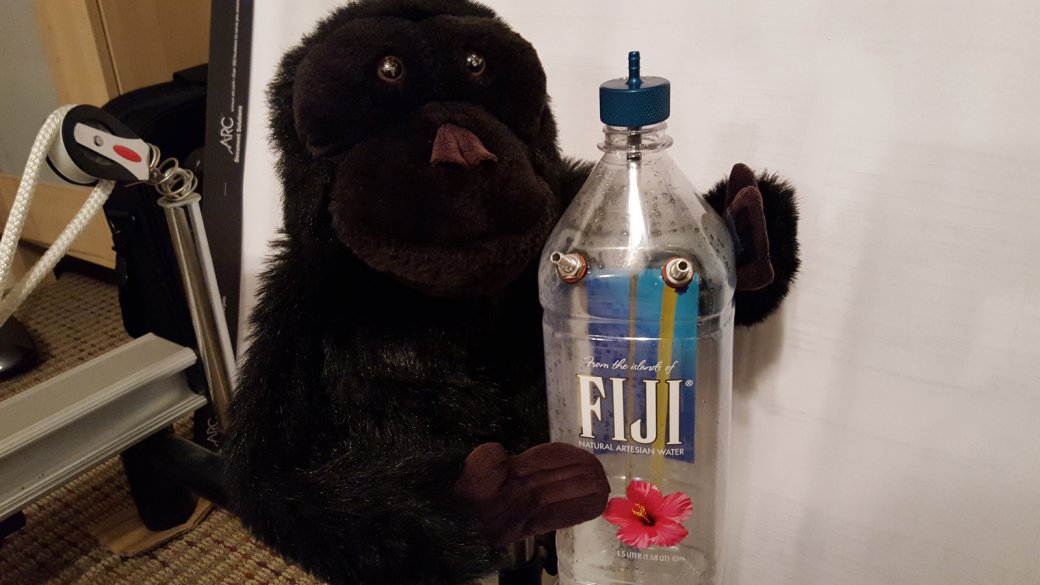

Two of you guys are running the Hitec 9380s? I feel so left out! Okay, well, even though I've seen these water bottle tanks for years and had them in my 3W planes... I never got around to getting a PSP water bottle fuel tank. I tried one in my Sukhoi and it's working great and is 3oz lighter than the included tank. First thing you have to do is get some water from the store and drink it. I put Monkey on that:
Didn't take him long to put the kit together, either. PSP has a video showing you how it's done:
Anyway, Monkey didn't really let the bottle dry out, we'll have to address that:

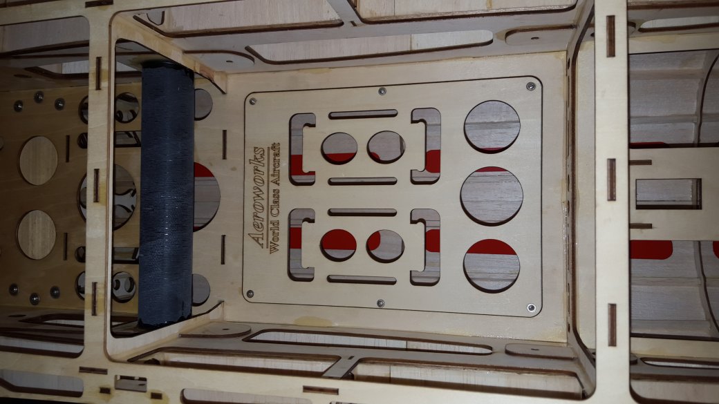

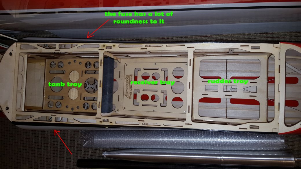

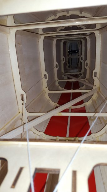

I popped the hatch and the intention becomes clear. Sculpted roundish fuse, bracing, and mostly sheeted. This is really more of a custom kit built in China than what you think of when you say ARF. it really looks like it would go 10 seasons with no trouble at all, as well.
The RX tray is removable, I guess to access pipes, if you have them?
Check out all that sheeting and bracing! And, the strings for the elevator servos, nice:

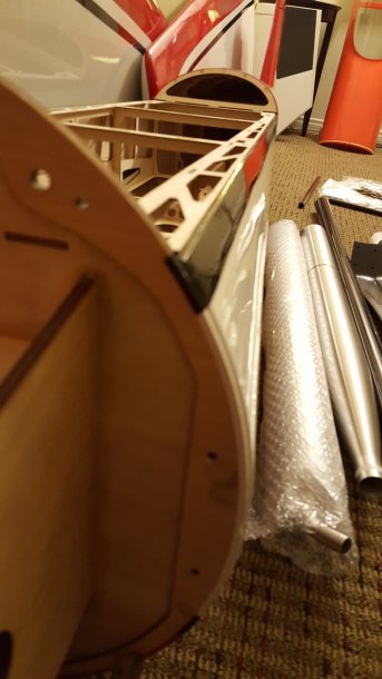

There does seem to be a pocket in the tail for push/pull rudder servos:
Trying to get a shot that shows that rounded fuse:

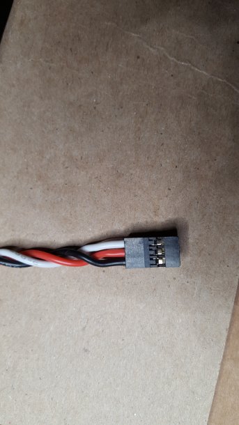

I've been using 22gage extensions, direct soldered and dean's, since pretty much day one. But, with these HV servos and LiPos I even want more. I found these 20gage, gold connector, extensions at www.taildraggerrc.com . I have a tough time crimping 22gage, I'm impressed that they can get 20gage in an RC connector:
