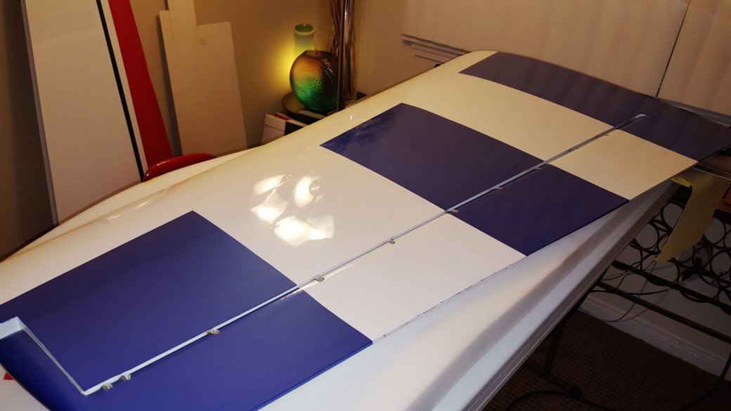

Then he admits it, he was trying to pull off the black checks on the back of the wings and all hell broke loose. Turns out AW really irons the covering down bombproof style now. Lapped covering and leading edges of the wings have the covering pretty much permanently attached. Don't even try to take any covering up unless you're ready to recover... Monkey will tell you! So, Monkey says, "Don't start throwing poop around, I'll have this recovered in a flash."

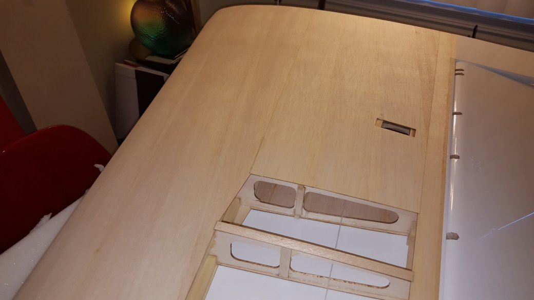

Good thing is I get to show you a few things about how the plane is built, and also I get to thin CA the hinge balsa blocks. :)

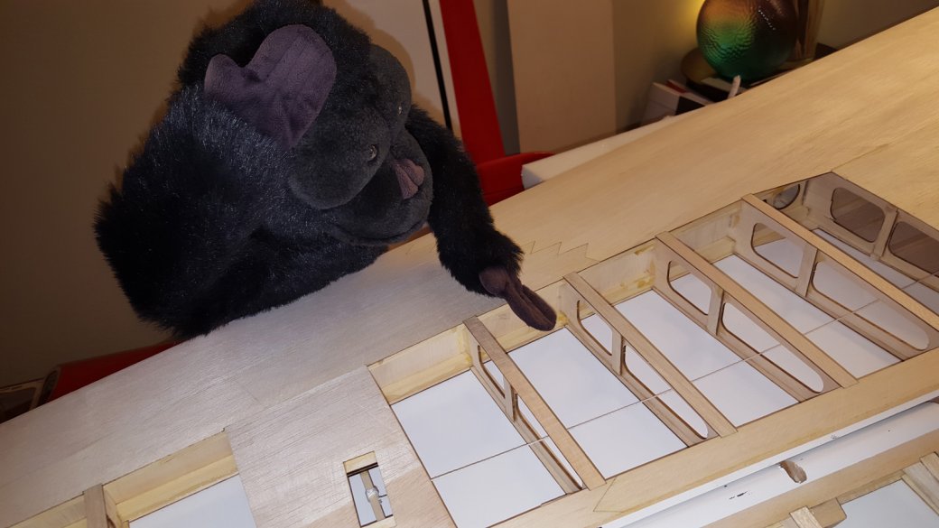

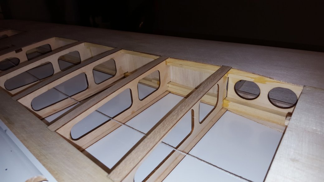

This first pic not only shows the materials, design and workmanship, but also probably shows why these wings are 2-1/2 oz heavier than the Sukhoi wings (other than being larger). They are built as strong at the tips as they are at the point the wing tube stops. The spar stays beefy all the way out to the tip. There's no flex in these tips unlike my Sukhoi (not saying there is anything wrong with my Sukhoi, it flies totally awesome). Again, this plane just looks like it will hold up to many years of flying.
Look at that balsa, like a high quality kit:

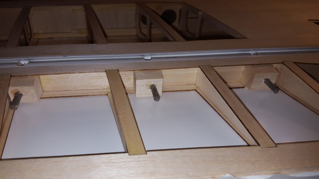

Balsa hinge blocks, I poured a few drops of thin CA on these as long as I had the covering off:

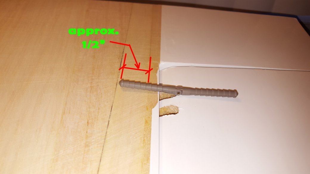

The hinges toward the root get less and less penetration into the wing:

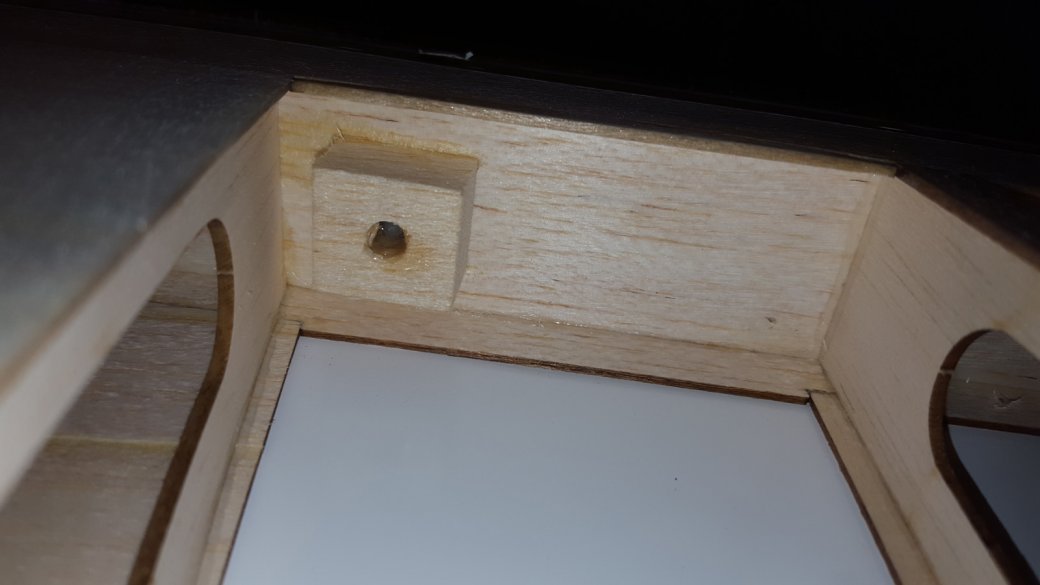

The last hinge on the root side gets about 1/2" of pene.... not sure where naughty will go with that... let's call it embedment. haha

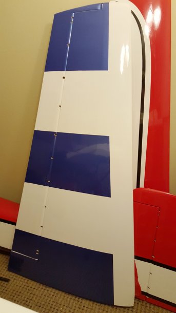

Thing is, he's still got it, so I guess it's all good. Only took him about an hour to make things right. He knows these stripes are easier for me to see in precision rollers, he was just trying to help me out, is all. :)

Hey, as long as you are satisfied with 1/2" of penetration, that is all that matters, right?

Thanks about the stripes. :) And, yeah, the hinges look odd at first, but do seem like they'll hold up forever (if done right, I'll get into that later), like everything else on this plane.
