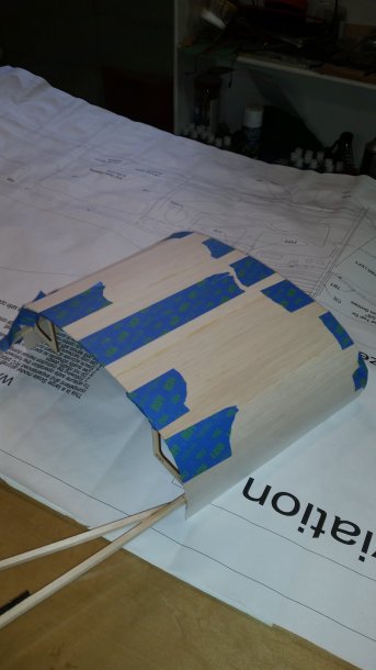

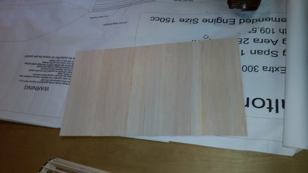

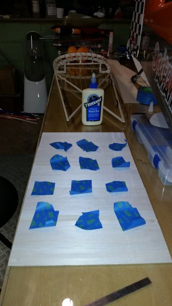

I got the front sheeting prepared. Will be gluing the sheeting down tonite .
Started by removing the tape holding the seams. Then a little 220 grit sand paper on a hand sander, cleans up the ridges, if any and removes some loose balsa hairs. My found big bottle of wood glue. Also an acid brush. A little wood glue kinda goes along way, sorta.... But once I started setting the sheeting, I took some of my favorite expensive blue painters tape and started to lock the sheeting to the frame. It started to lift in a couple places, so just a quick hit of thin super glue helps hold it all together. I will remove the tape tomorrow after work to view the finished piece. I will have some sanding to do on the front of it, since the top half of the cowl is a little lower than the hatch top. Will see how bad it is to start with, and then decide if I'm sanding it down or not.

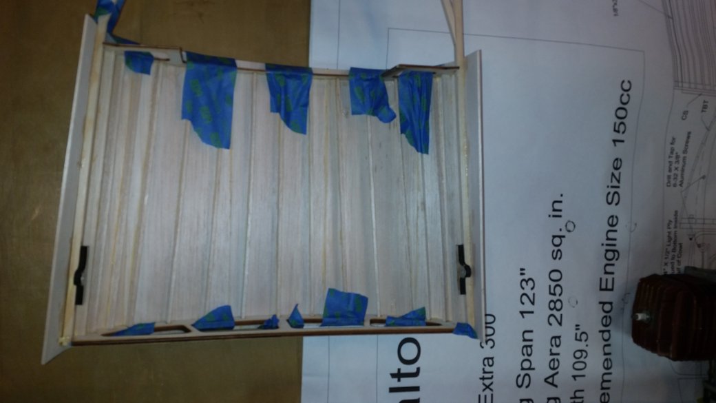

20141117_152727.jpg 20141117_152740.jpg 20141117_153328.jpg 20141117_155109.jpg 20141117_155135.jpg

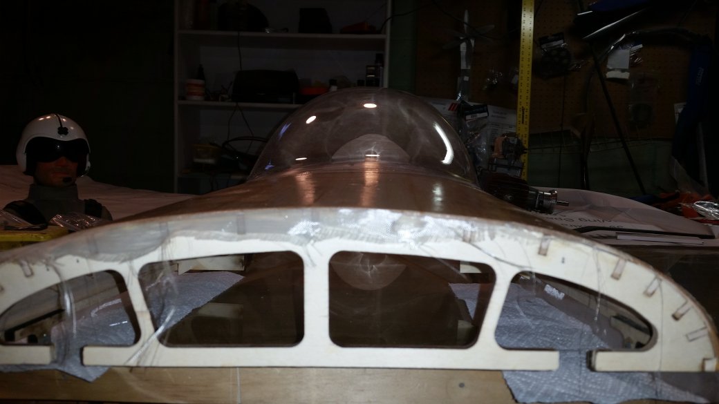

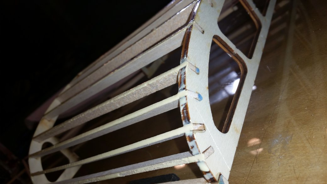

Got a place or 2 to clean up. But all in all, I'm pretty happy with it. I'm going to have to stop work on this, since I'm still waiting for the new rear canopy former. I keep breaking glue joints on the stringers of the hatch. Broke 2 glue joints just in sanding the forward and aft edges down.

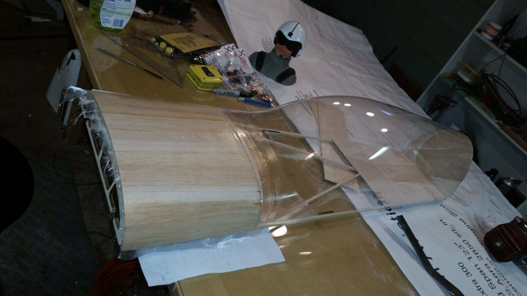

Look out Jackson!! I still dont believe that Im not working or building a heli! But instead, I trimmed the canopy to fit the hatch of my Dalton.

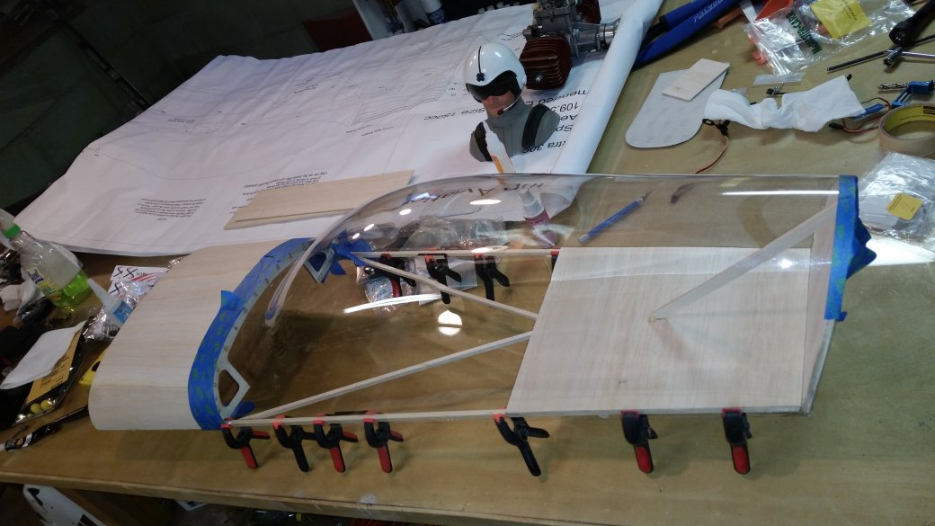

I sanded a recess in the fwd sheeting for the canopy to rest in. Then drew a line, leaving a little to trim off after gluing, and cut the canopy out. It may not be perfect, but it will be flyable this year. Then I can finally get the monster 3W 164 2 holer tuned in.
I used Zap Goo to mate the canopy to the frame. Some blue painters tape to keep it from shifting, then some clamps in strategic places. :)
