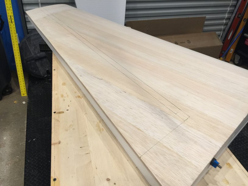

Here's another way, I used it on my last build and had good results. Didn't have access to a bandsaw and my little scroll saw wasn't up for the job. I marked out the top and bottom of my wing, I then used a straight edge and exacto knife to make my cuts on both sides. This next part kinda sacked, but I pick the 1"strip away from the foam. After the balsa wood was gone I used my hot wire knife and followed the balsa wood as a guide cutting the surface free. Followed it with a 24" sanding bar to clean it up.

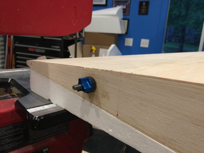

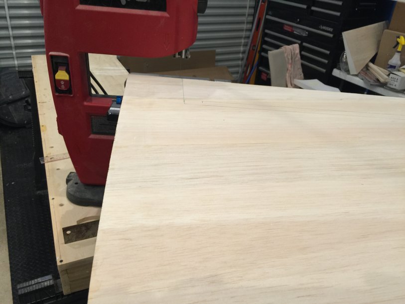

Here is how i just did the wings:

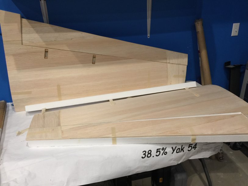

This is the left wing. I marked out the 1" strip, the left wing top faces up, and this will allow you to enter the band saw from the TE and from the tip, with no problem.

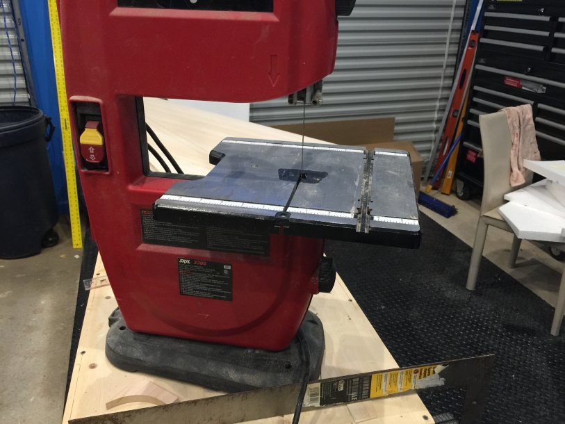

The band saw, from Lowes.
Here is the left wing, and we are 1st cutting the root side of the aileron, entering from, the TE of the wing.
I then entered from the Tip of the wing, all the way to the cut side, parallel to the root of the wing.

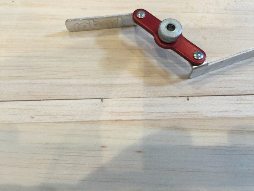

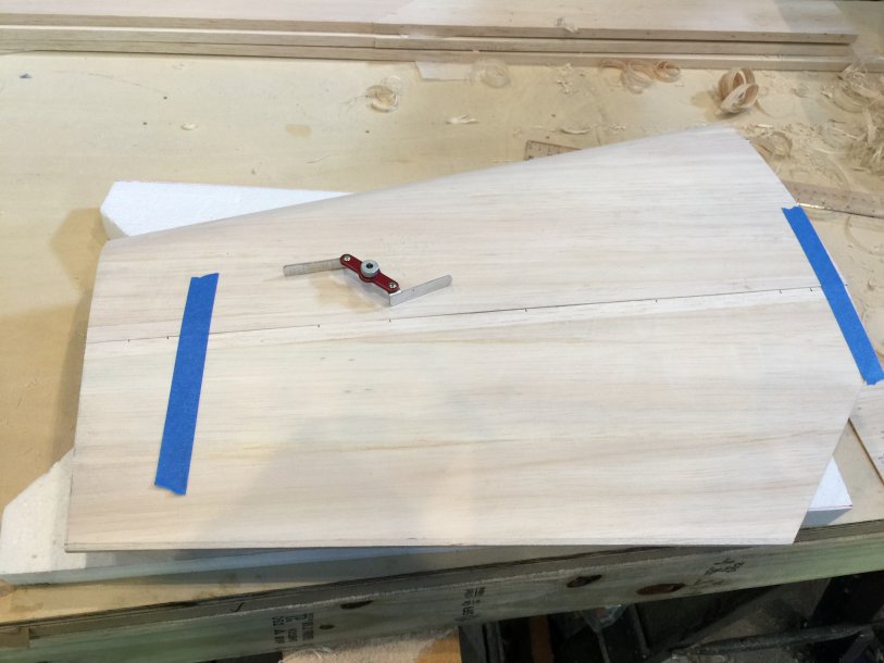

The stabs are almost ready to have hinge line beveled. 1st step, after sanding the 1/2" balsa flush with the sheeting, I then will mark the area of the hinge points. On each stab, there will be 8 Robart point hinges. The hinges, from the tip, will be at 1", 2", 4", 10",12", 16", 20" & 21"
Then Once i mark the points for the hinges, I then will use this drill guide, from RObart, and drill on both sides of the hinge line, into the balsa. Once this is marked, then I will draw a line on the hinge line, that is central line. This will be marked with a black marker, that is thicker than a fine felt sharpie. This line, I will not want to sand down. I then will draw 2 more lines/angles on each side, of how much to sand off, the rest is elbow work!! Pictures to follow soon....
