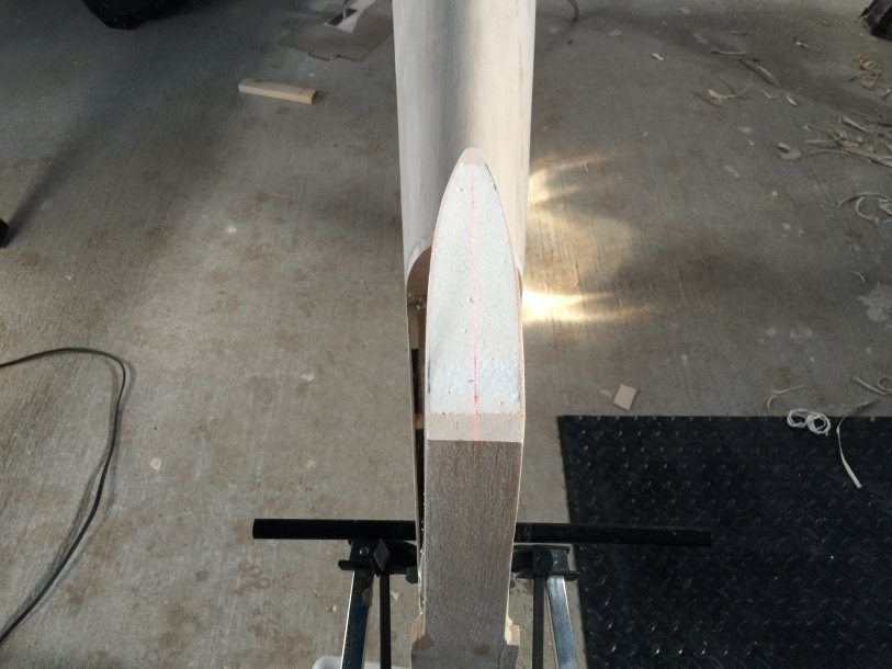

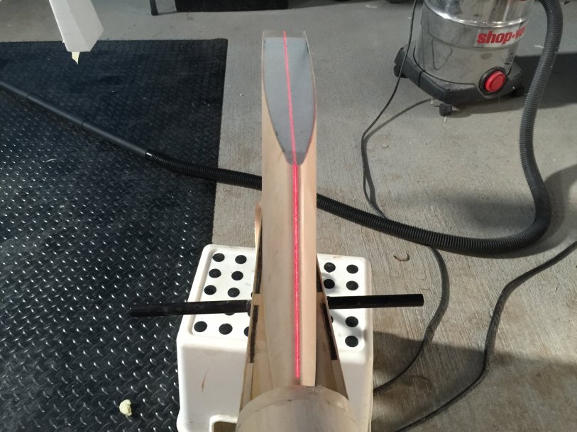

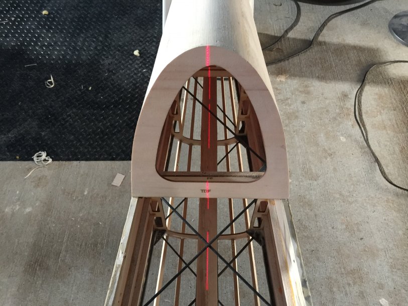

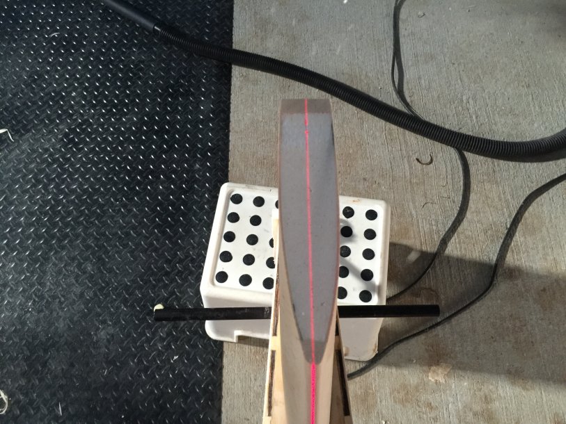

Hi James, When I glued on the fin, I used a laser light, but from looking at it, looks like the fin is on straight, but i can look at it again.
I have a good reason to believe it was that left stab was off. So with that left stab having up elevator, relative to the right one, it would cause it to roll to left and for the left wing to drop.
I let you know wednesday if the problem is fixed!!!

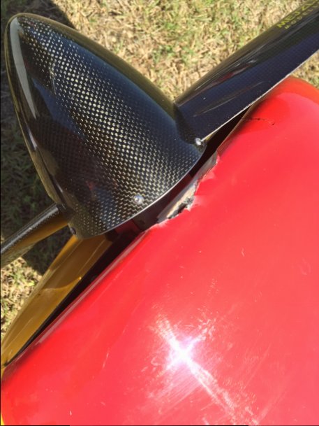

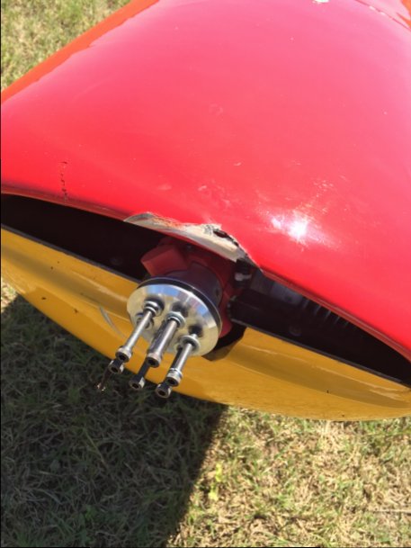

On that Friday, I was flying my Dalton 300 ML, which is my #1 plane, has about 300 flights on it. On Friday, I flew it once, did the INT sequence 3 times, then landed her. Refueled her, and took off again.
I did the sequence once, and then started to do a 2nd sequence, I did a snap, and then heard a God Awful sound. I immediately landed her and noticed there was a problem....

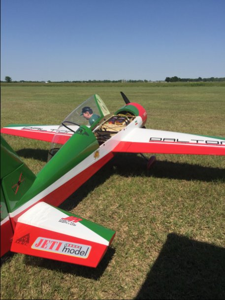

SO, this airplane became out of commission, and I brought out the Yak.
This airplane, unfortunately, was not trimmed out. SO is spent most of that Friday, trimming her out...
The biggest issue I was having with her on Saturday, were the snaps. They were not dialed in.
