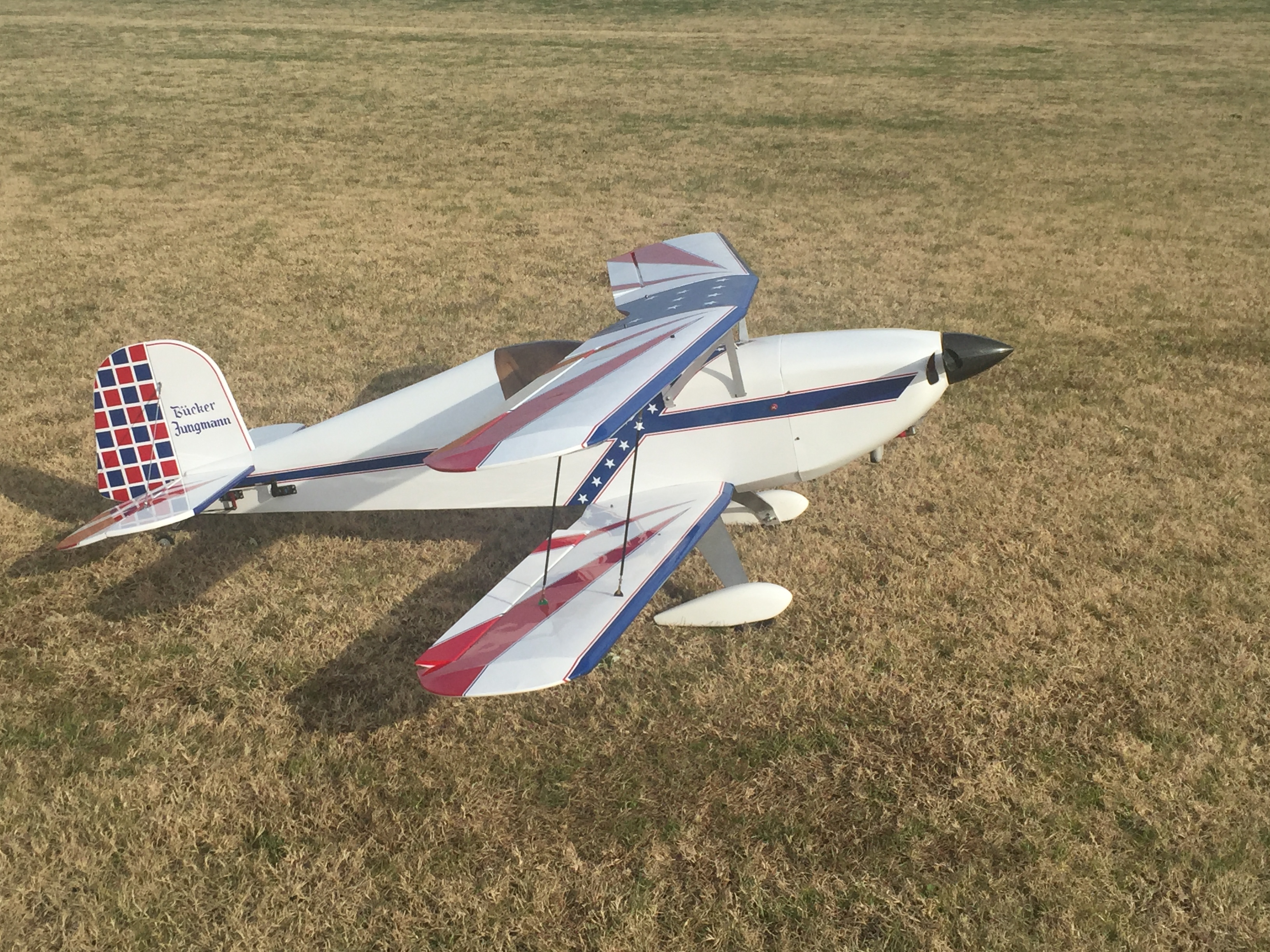

  8. I took a set of Dave Patrick's Bucker Jungmann plans from the Goldberg kit and enlarged them from 62" to 86". I had a kit so I was able to take the critical fuselage shaping formers and trace them to enlarge them. Cut new larger formers to keep the fuselage shape. Instead of using lite ply for fuselage sides like the original kits, I made a 3/8" balsa truss sheeted with 1/8" balsa (like a Carden kit). The key was getting a design that worked with available cowls. I started out sizing it to fit a Dave Patrick Extra 300 cowl (shooting for the same width) but that cowl was not right in the vertical dimension. Ended up with a 33% Hangar 9 Edge 540 that just happened to fit perfect. Totally by chance!! Wing ribs were cut by hand which is not at all difficult to do with the right tools/methods.
    I do have a Goldberg Ultimate kit with plans and might be interested in doing something similar to the Bucker. I'm generally flying bigger planes these days so I'm not too keen on the idea of going from 54" to 60". now something like 54" to 75-80" might be worth further consideration. If you're not interested in that, I might be talked into just doing a fellow modeler a favor and tracing the critical pieces and sending you the paper to enlarge.

    Here's my Bucker: 86"wingspan at 23lbs. with a DA-60 for power

    Very nice biplane and very nice of you to offer to help a guy out! :way_to_go:
