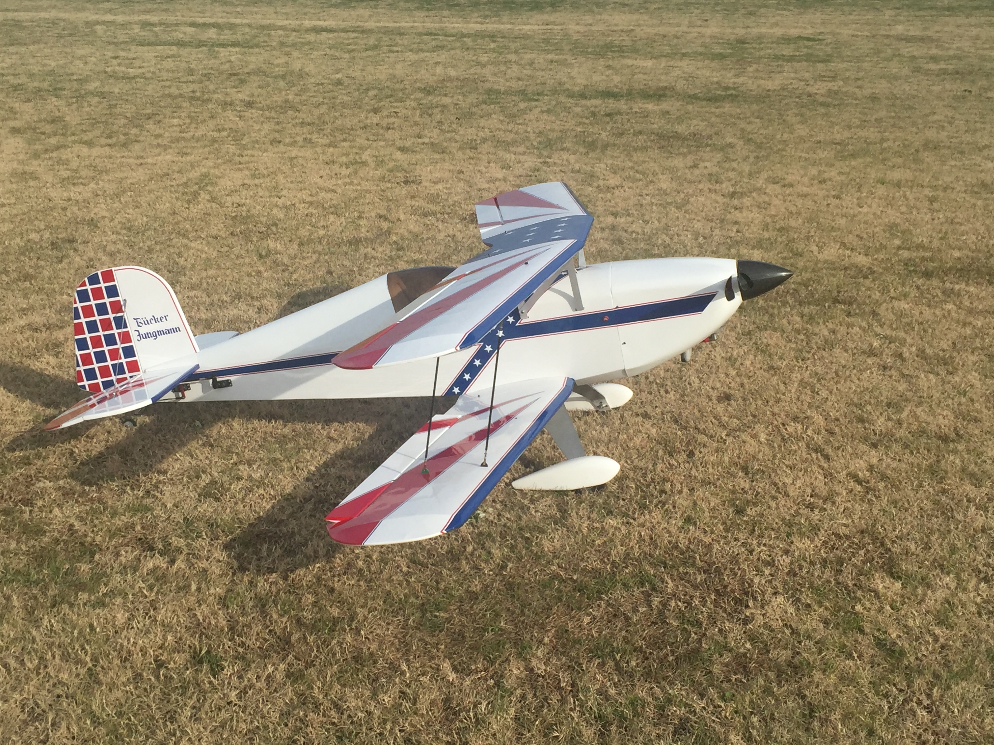

I took a set of Dave Patrick's Bucker Jungmann plans from the Goldberg kit and enlarged them from 62" to 86". I had a kit so I was able to take the critical fuselage shaping formers and trace them to enlarge them. Cut new larger formers to keep the fuselage shape. Instead of using lite ply for fuselage sides like the original kits, I made a 3/8" balsa truss sheeted with 1/8" balsa (like a Carden kit). The key was getting a design that worked with available cowls. I started out sizing it to fit a Dave Patrick Extra 300 cowl (shooting for the same width) but that cowl was not right in the vertical dimension. Ended up with a 33% Hangar 9 Edge 540 that just happened to fit perfect. Totally by chance!! Wing ribs were cut by hand which is not at all difficult to do with the right tools/methods.
I do have a Goldberg Ultimate kit with plans and might be interested in doing something similar to the Bucker. I'm generally flying bigger planes these days so I'm not too keen on the idea of going from 54" to 60". now something like 54" to 75-80" might be worth further consideration. If you're not interested in that, I might be talked into just doing a fellow modeler a favor and tracing the critical pieces and sending you the paper to enlarge.

Here's my Bucker: 86"wingspan at 23lbs. with a DA-60 for power

Always loved flying the Goldberg Bucker. I still have one that is need of recovering at some point. Looks like you did a great job on that enlarged Goldberg Bucker!

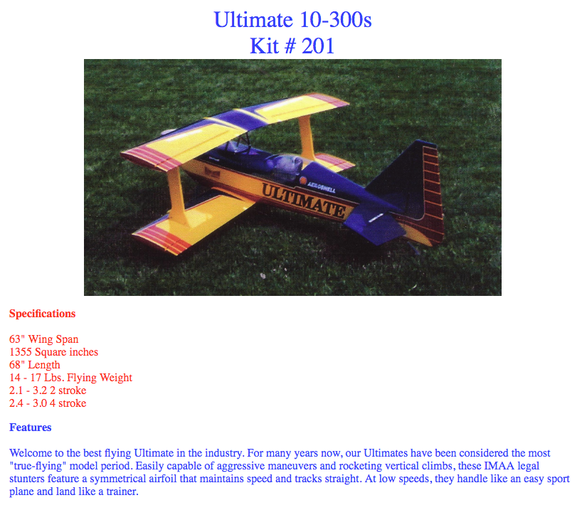

I heard back from Patrick at precision Cut Kits / Solo Props. He's sending some more information with respect to the accessories that are available for the kit. here's what I have so far. Will post additional information as it becomes available.
From Patrick @ PCK
Rob,
Yes all the Pro-Line Aerobatic was called Ohio R/C. I am not sure of anything changed or modified the original prints look like they are like they were designed. Enclosed is a old ad picture and some specs on the #201. I haven’t finished going through all of the Pro-Line items. Some things are no longer available due to the company that had produce the parts has gone out of business, mainly tail wheels. I can send you a list of what I have for the #201 with current prices if you would like.

See the details in the attached graphic
