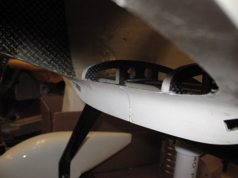

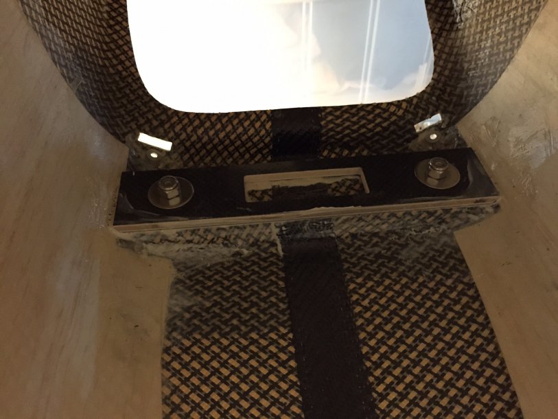

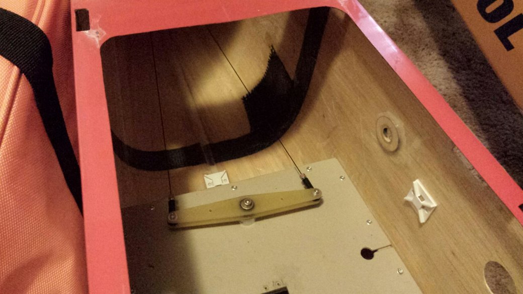

Wacobipe can you post a picture of your gear plate from the inside of the fuse? Trying to make sure I'm doing it right. Thanks!
Wacobipe
@Jlc here you go...let me know if you need another angle/view. I had to round the underside of the plate where it meets the fuse sides.

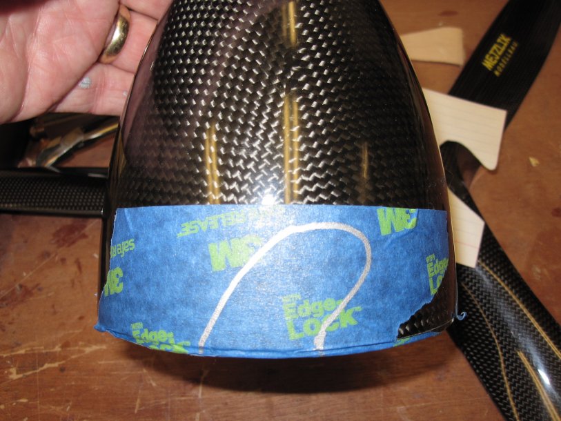

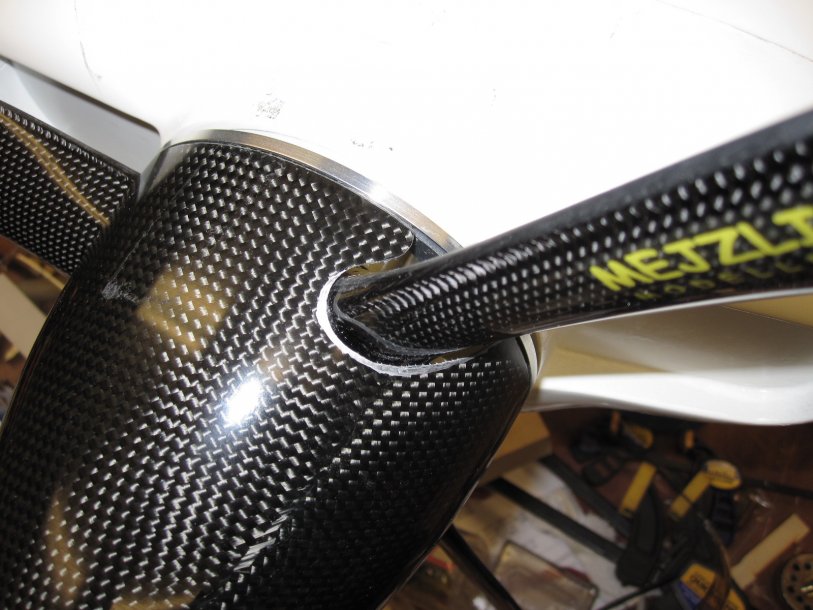

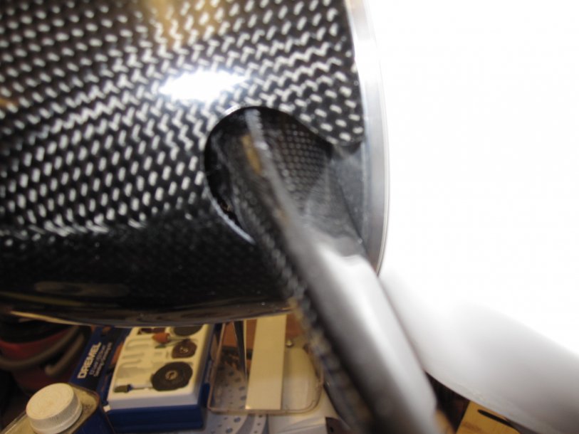

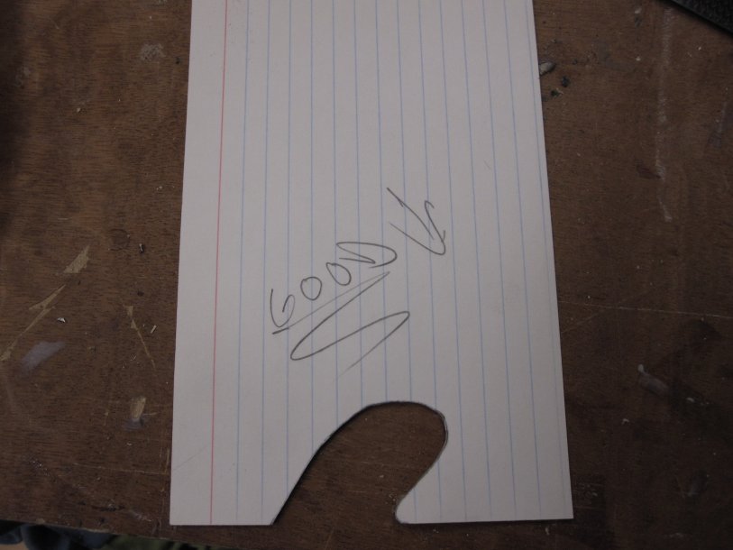

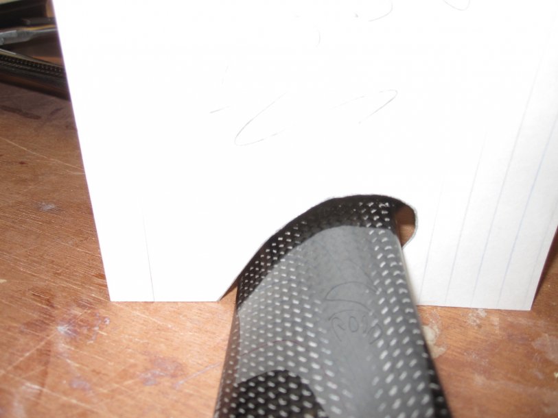

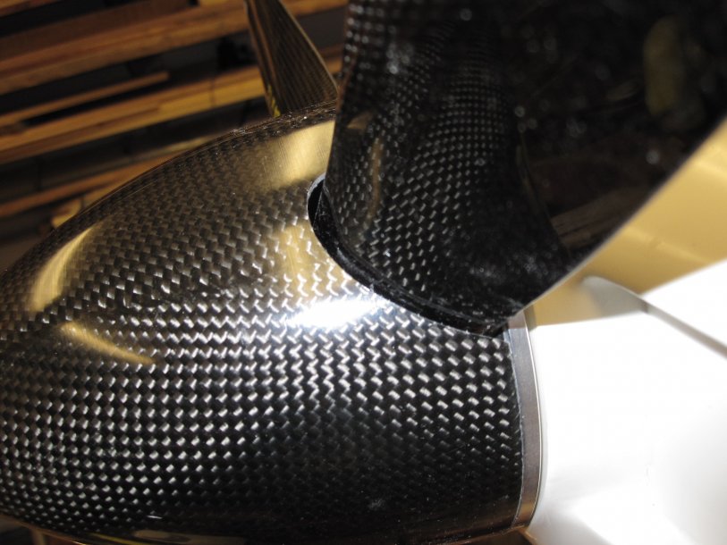

What do you know...I actually found time to work on the Raven a bit this evening! So I trimmed the slots in the spinner to clear the prop and wanted to share my process...
I start with note cards and cut a single slot until I get the fit I like around the prop..this usually takes 3-4 cards to get the fit the way I like.
Once that is satisfactory I trace that on the spinner every 120 degrees (in the case of a 3-blade prop). I then use a coarse sanding drum on a Dremel tool to begin slowly removing the material but leaving my traced line and a bit of extra material all around...
Once I get it roughed out then I start test fitting and slowly relieving material on the spinner until I get a nice fit all around!

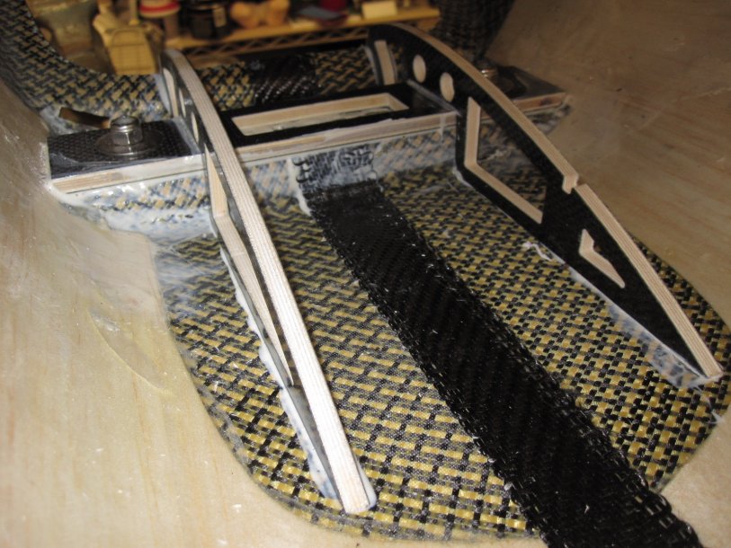

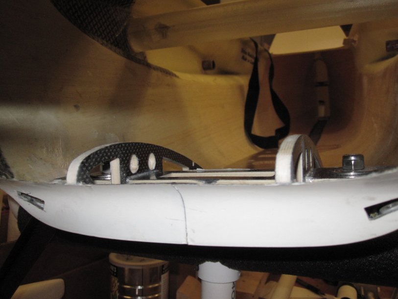

Worked on a few things to update you on in the last couple days. I got the landing gear plate reinforcement ribs fitted and glued in place (it took a lot of grinding/filing/cutting to get them to fit properly...which was interesting since everything else on this plane seems to fit like a glove)....bot I got it done and glued in.
