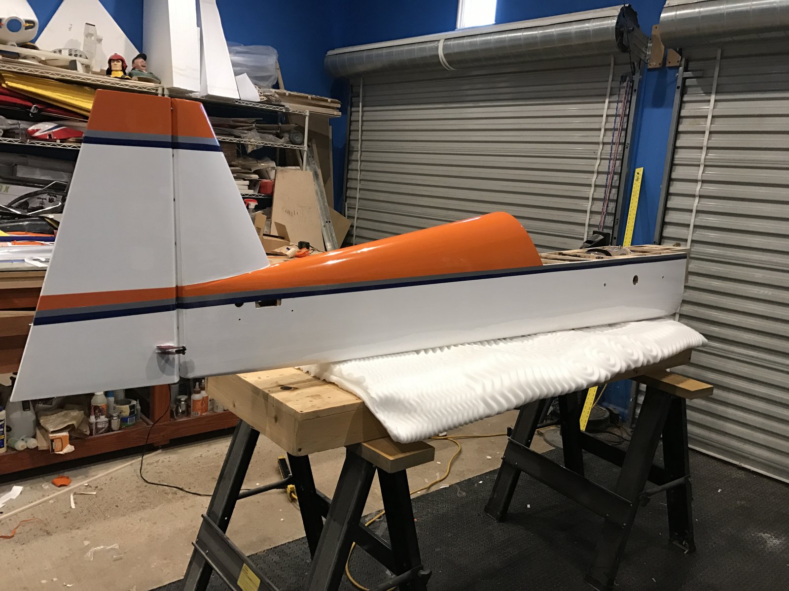

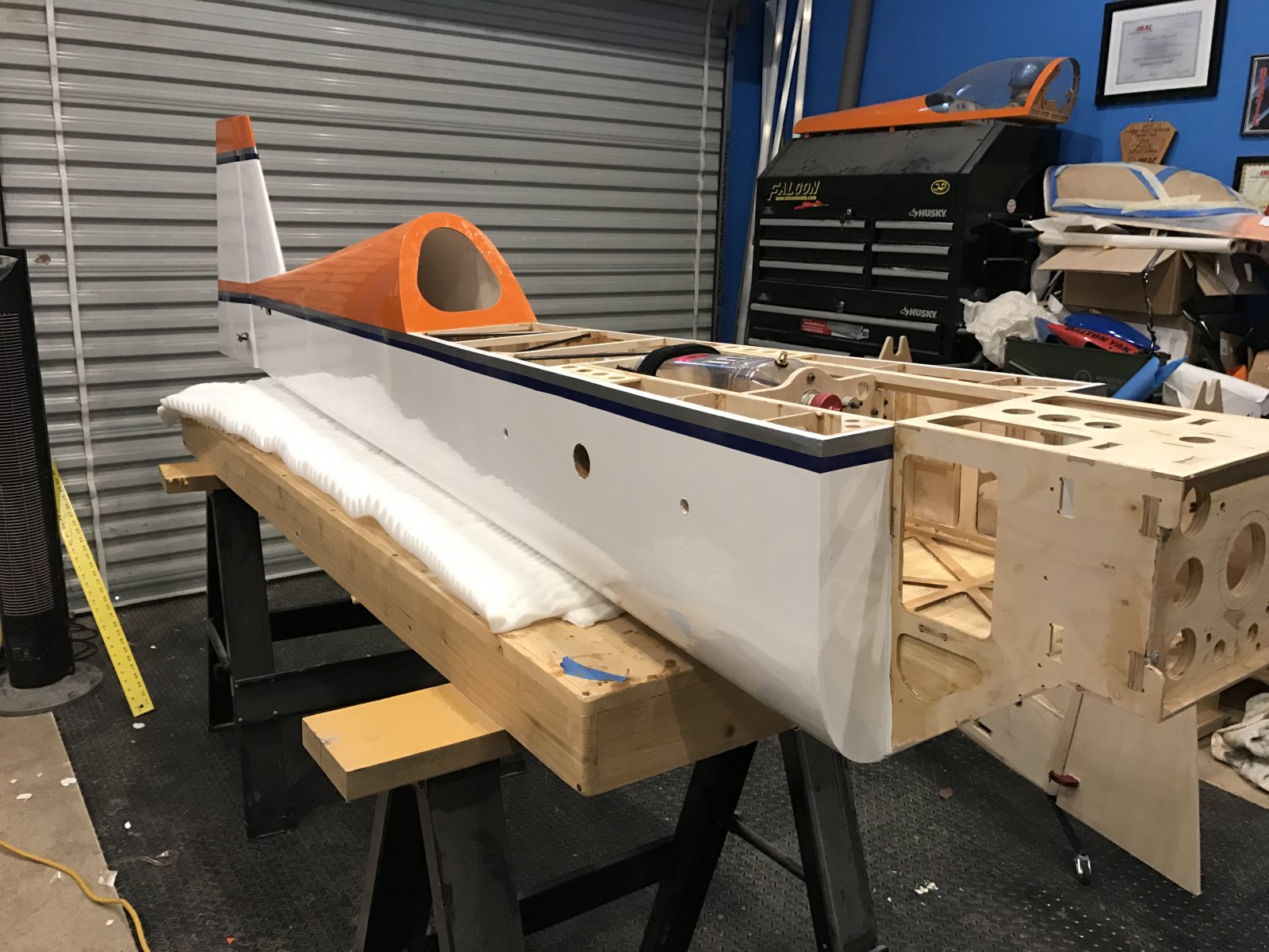

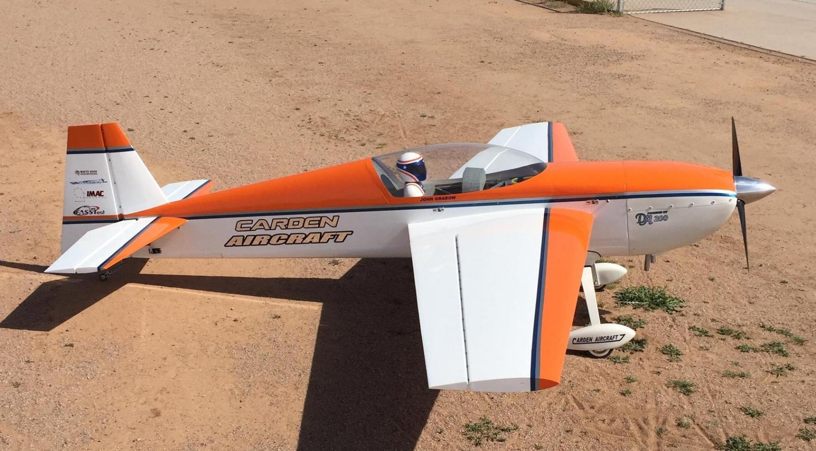

Got the stripes on this morning. Now, to install the LG and tail wheel. Next will be to cover the fuselage on the other the Carden, and the wings will be last.

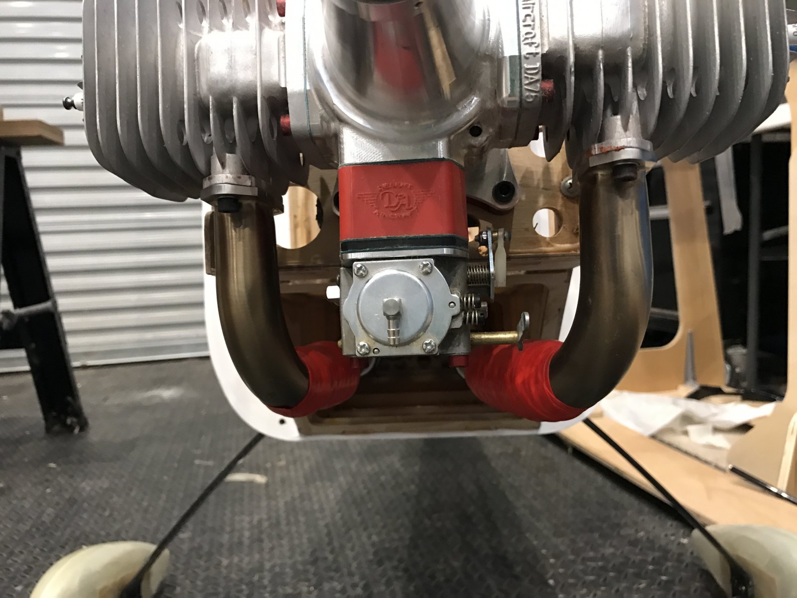

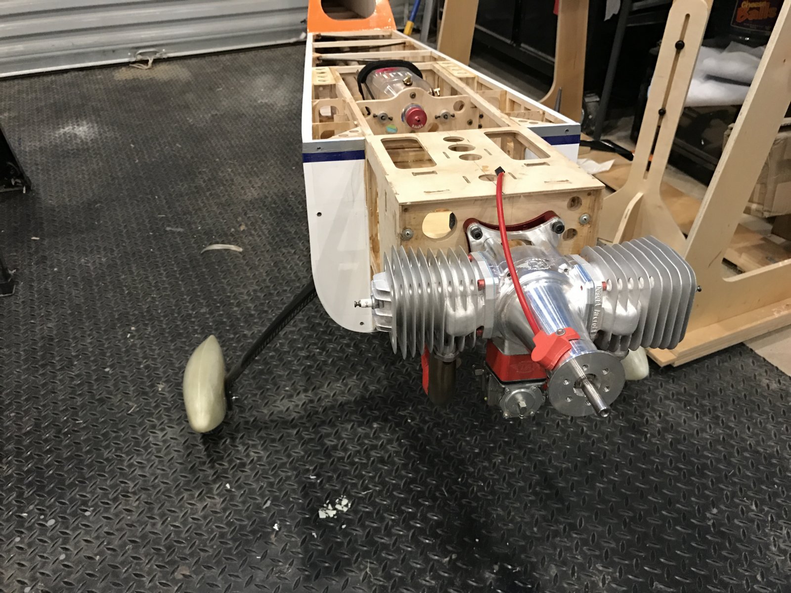

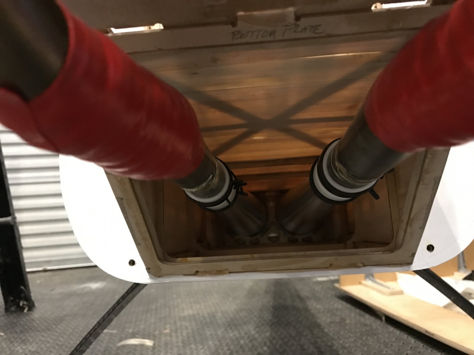

I should mention that I did a great deal of research, trying to determine what the ideal header length should be, for a DA 150 with KS 1090 tuned pipes. Klaus from K&S told me about 15". Then, I communicated with Dave at Desert Aircraft, and he told me, the header length can be 12", or at least, that is what they determined from testing with this set up.
DA says:
"We use the standard length (12”) headers from MTW with the KS1090’s. The headers were shorter a few years ago, but most customers preferred them at 12”. Shorter can sometimes give a bit more rpm, but the power curve can get “peaky”.
Prop selection is a factor for optimal header length. A general theme for proper tuning is smaller props/high rpm need shorter headers and larger prop loads/lower rpm need longer headers.
Thanks
Dave"
I ended up cutting mine to 12.5", figuring, if I had to, I can come back and cut 1/2" more if need be.

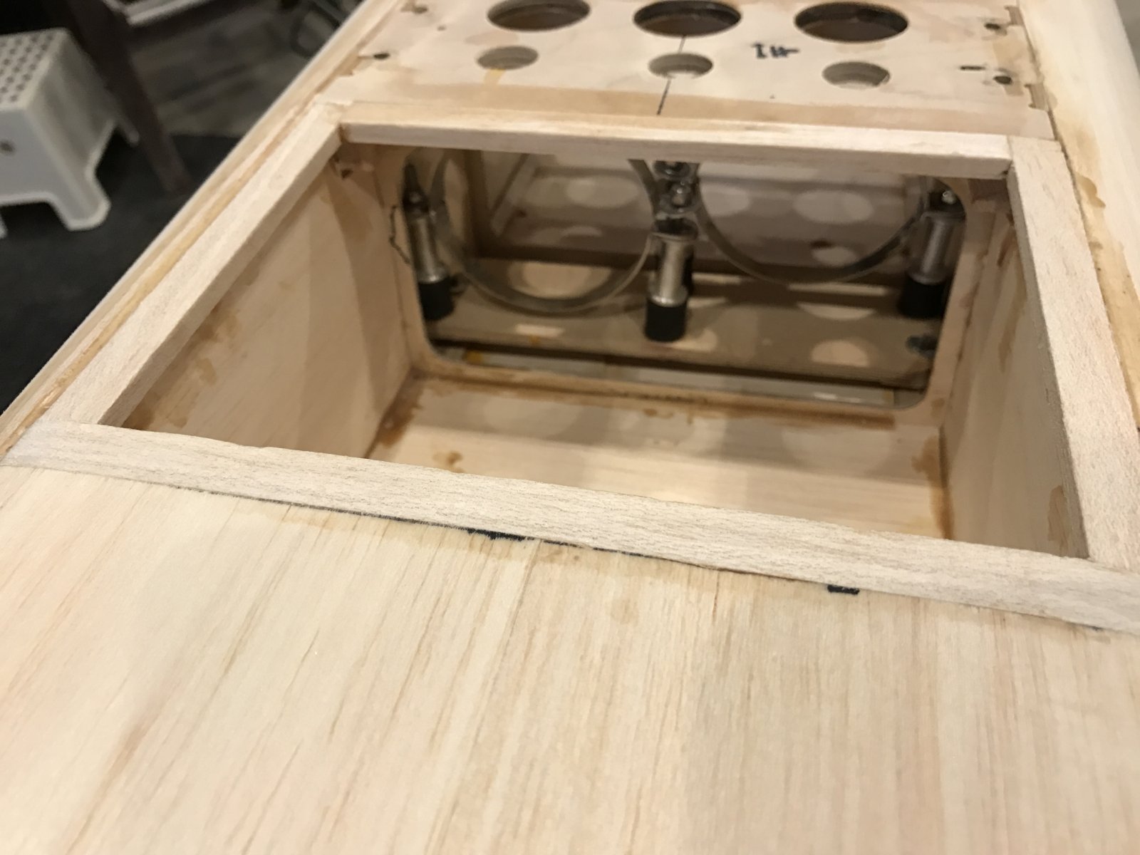

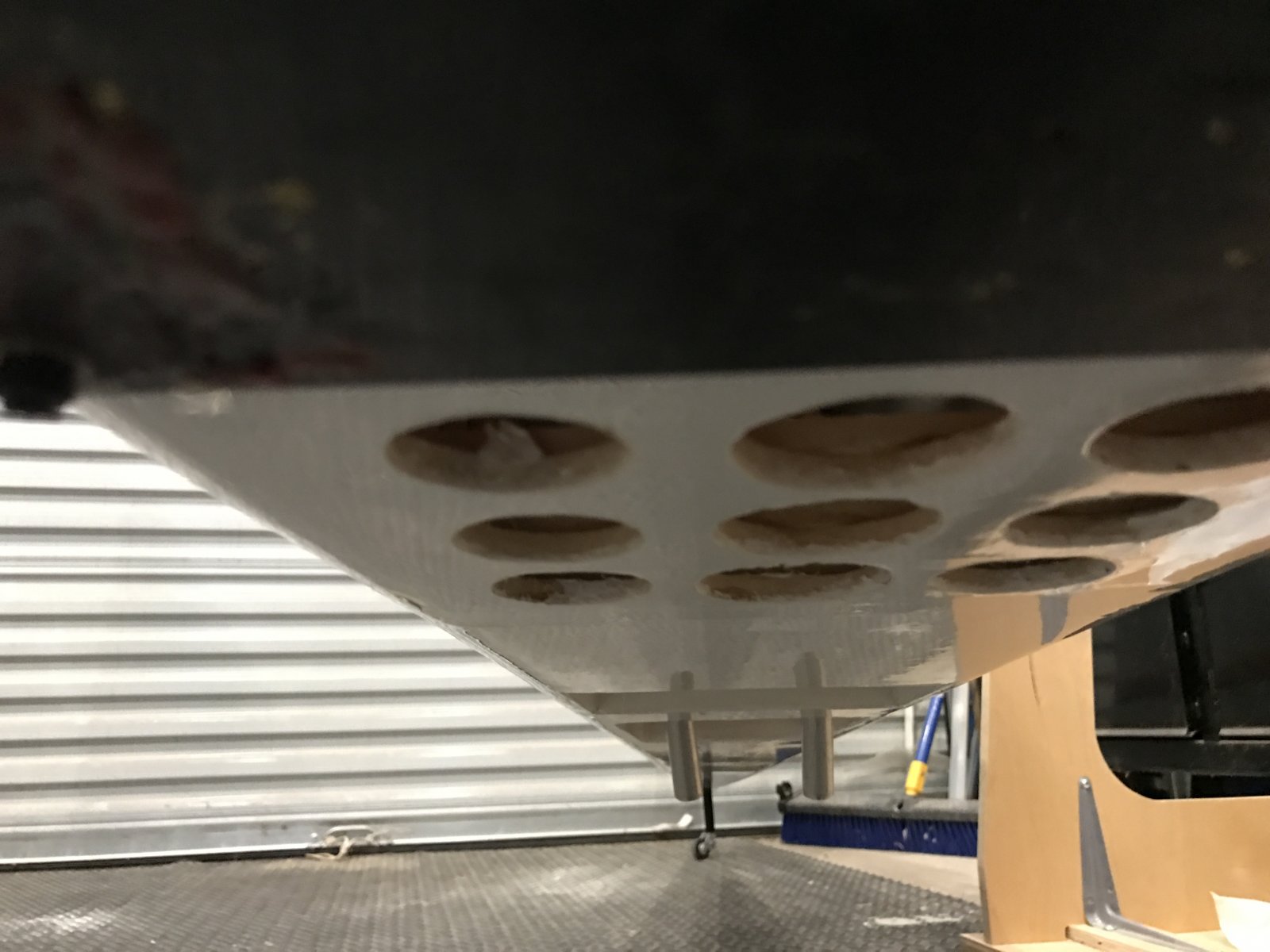

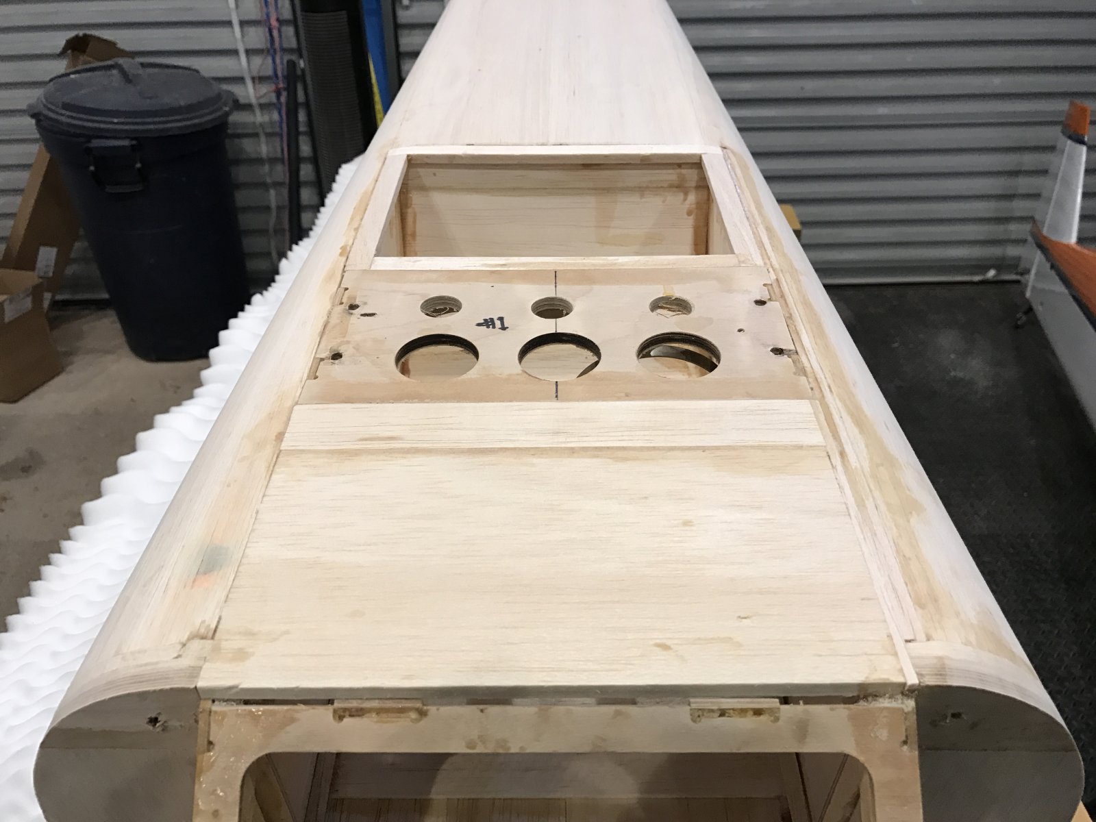

Looking to start working on covering fuselage #2, and I realized, I did not finish the bottom of the fuselage.

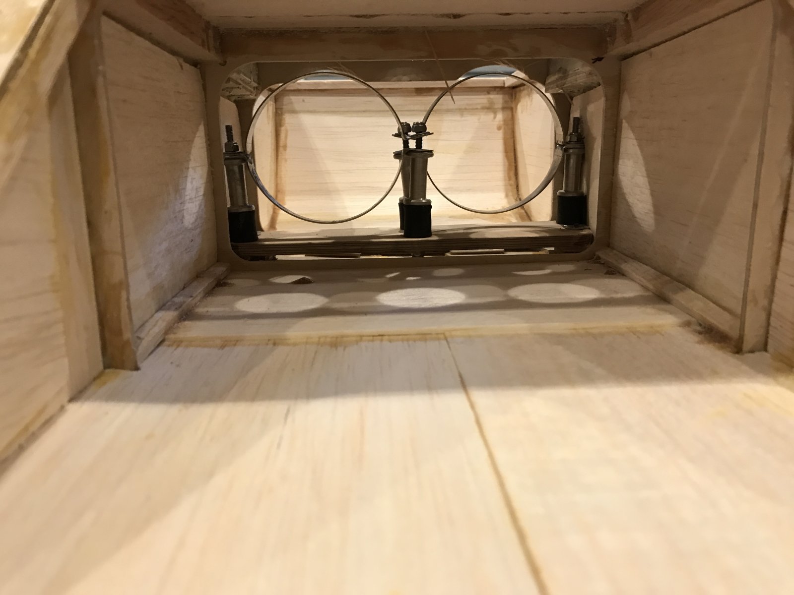

this area in front of the Gear plate is not open, and I was trying to figure out a strategy to help improve cooling and venting in the canister tunnel.

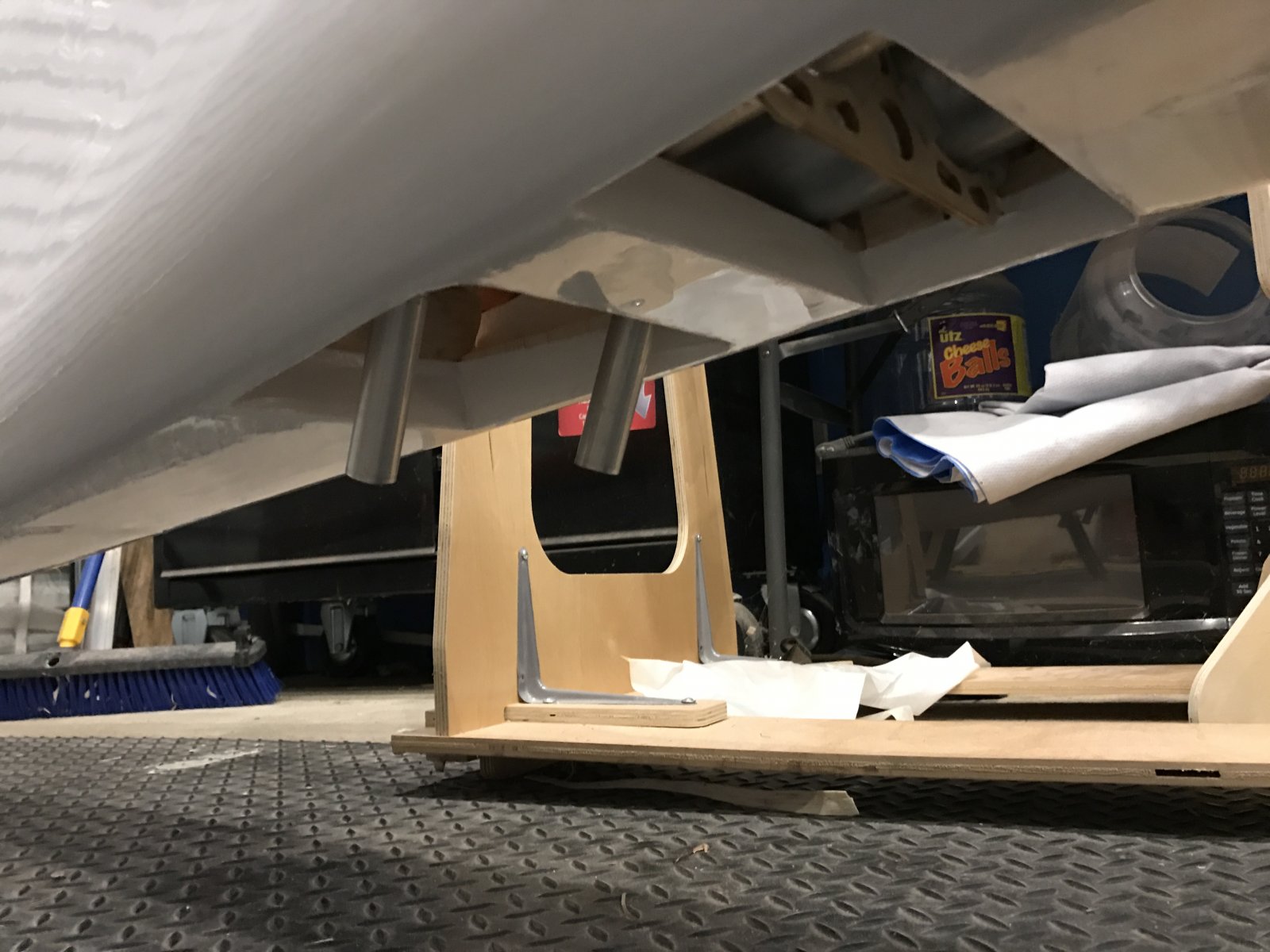

Now, this is the open area behind the gear plate, and this is the location of where the canister stingers exit.
