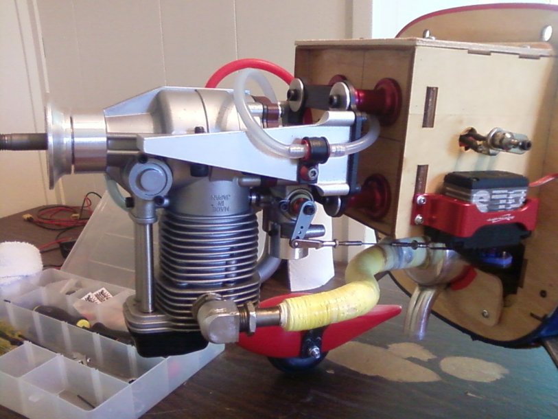

I was posting the OP. But! I have used it there also and then drill and tap for 4-40 x 3/16 button head screw to each end so your pipe or can wont turn with vibration. Also wrap with Teflon tape. Here is a example but not a gasser. The exhaust temps are higher though because it is a 4 cycle.
Dimes, what kind of hose are you using to couple to the canister there? I have a situation with a head for my DLE85 and was thinking about a high temp hose with a braid on the outside or something.
That is a NMP flex header which is like the ones OS and Saito has. It was known to fail early on if not properly installed or some measure to prevent excessive tension and torsion over the bends placed in it. I have thoroughly wrapped it with heavy duty Teflon tape to better absorb vibrations and thermal shock. With my experience in using the NMP in the past this one has outlasted any other previous ones I have used. I would get about 3 or 4 gallons before a failure. That one has a little over six to date and shows no sign of pending failure. There is no "coupler" . The end of the header has a round fitting welded to it. It is inserted directly in to the opening of the canister with a custom made Teflon bushing to act as a seal. I used the shellac to help seal it all up.
