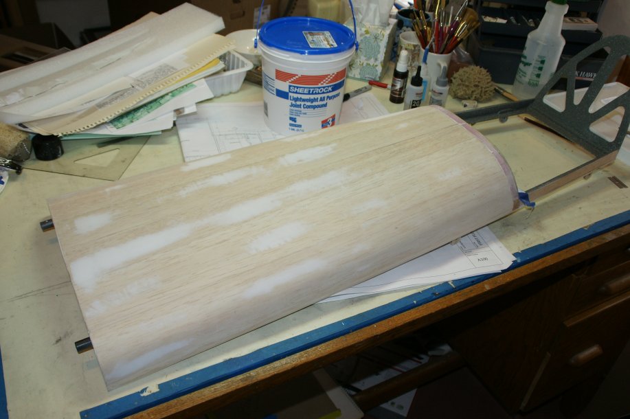

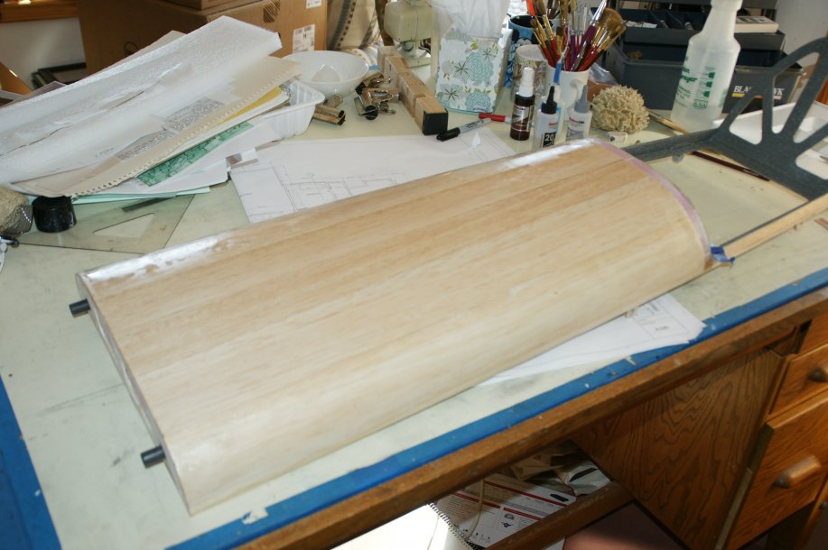

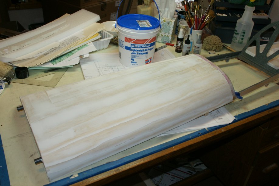

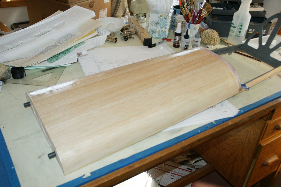

Figured I'd throw these here as well...Finished glassing the new single seater Raven canopy. Sanded a bit with 150 then applied lightweight joint compound and sanded again. It is now baby-butt smooth and ready for some primer. The joint compound only added 1 oz, which surprised me, but then again, damn near all of it was sanded off.
1st pic is glassed, then joint compound applied, last is sanded. First time I've tried this method, BIG THANKS to you guys :cheers::cheers::cheers:
Oh...another thing that seems to be working great as a sanding block for curved shapes is a piece of pink foam board. It is stiff enough not to bend into small depressions, but has a little flexibility to help with the curves.

Looks great. Did you use two coats of resin?
Pistolera
HEY!..GET OUTTA MY TREE!
Nope.....just one coat and scraped off as much as I could before it started kicking off. There was a LOT of FG weave showing, but the JC filled it beautifully. I used 2oz glass as that's all i could find around here.

Dang, that I really nice. I looks so...."factory" built.
